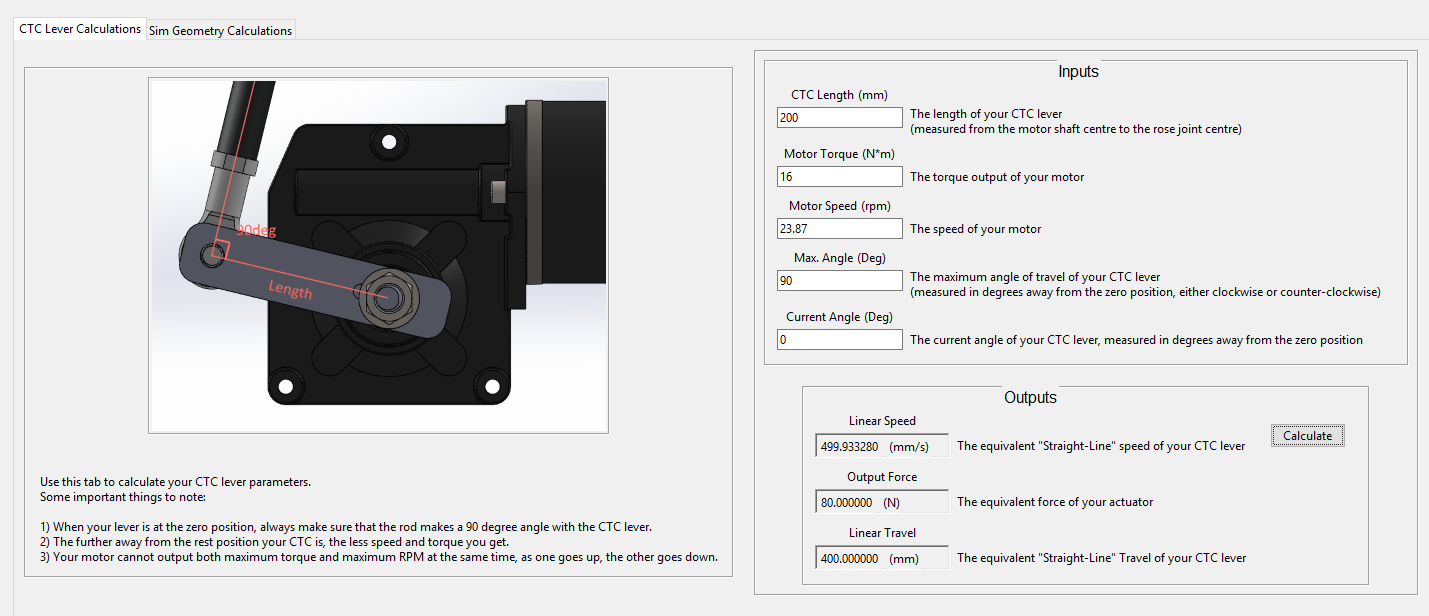

    I am currently in the planning and design phase of a motion platform build. Using the FAQ, SimCalc, and other resources, I have what I believe is the math required for a successful build. Please provide a sanity check and input on the following math.
    Known Values
    Lever CTC: 200 mm
    Mass: 160 kq
    Newton force required to move specified mass
    Speed of Movement (a): .5 m/s
    Mass (m): 160 kg
    Newton Force Required = ma: 80 = 160 * .5
    Newton force of 80 is required to move 160 kg mass at a speed of .5 m/s
    RPM required for given velocity and CTC lever
    The RPM to Linear Velocity formula is:
    v = r × RPM × 0.10472
    RPM = 23.87 = .5 / .2 / .10472
    Where:
    v: Linear velocity, in m/s
    r: Radius, in meter
    RPM: Angular velocity, in RPM (Rounds per Minute)
    23.87 RPM is required at the motor to produce .5 m/s of movement with a 200mm CTC lever
    Torque required to lift mass with 200 mm CTC lever
    Torque = F(r) = 80 N x 0.2 m = 16 Nm
    Where:
    F: Newton Force
    r: Radius, in meter
    16 Nm of torque is required at the gear box output.
    So the final conclusion as the math shows, I will need 16 Nm of torque at the gear box to lift 160 kg at a speed of .5 m/s. I will add 25% to make it 20 Nm to compensate for system loss. I understand that as the angle changes from the 90 degree position, more force is required. I will probably rerun the calculations with the current angle at 30~45 degrees to ensure proper force at both ends of the cycle. I also ran these number through SimCalc and had very similar results.
    Any and all input will be greatly appreciated.

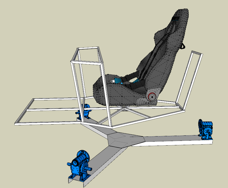

    I have not recalculated the math yet but plan to this weekend. In the mean time, I have been working on a SkectchUp drawing of the simulator configuration I have in mind. the motors will be, I am guessing, about 1 HP AC motors. Please provide input.

    @mprofitt will this be flight or racing sim?
    I'm thinking your motors might need to be closer to the centre of the platform (sort of under the seat base), but I must admit, I hav'nt really given these steward platform type systems much thought. I'm thinking more along the lines of a balanced frame type setup which will take a lot less force to move.
