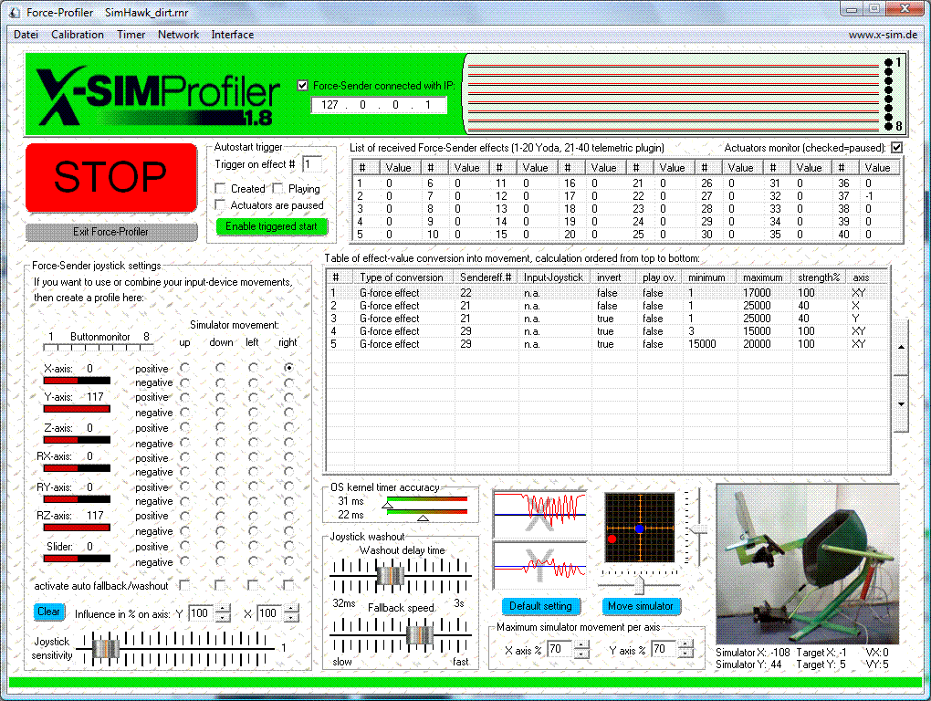

    Please make a new video of the calibration procedure.
    Checking out the valve configuration is quite easy with a joystick connected.
    You have to set the matrix to FESTO configuration (by button)
    Connect a joystick (or wheel), assign joystick influence to x and y axis to 100%, assign the joystick axes, then press start simulator and move the joystick to see if your simulator follows correctly the joystick movements.

    I can not do the calibration with the joystick, the red dot that moves him the simulator does not move
    I'm sorry, I really difficult to understand.
    with my matrix, the calibration is good,i think.
    my axis are shifted just 45 degrees.
    for the speed, I find it very fast, is the video, which is slow.
    I make a new video ...

    j'ai l'impression que c'est instantané je n'entend qu'un bruit
    j'ai choisi les axe a gauche, mais cela ne fait rien quand je bouge le joystick!
    le point reste immobile
    vue du force profiler
    http://www.youtube.com/watch?v=jVGAIg35b94
    je déplace manuellement le simulateur: avant, arrière , gauche, droite , et centre (horizontal) puis avant:
    http://www.youtube.com/watch?v=X2Ks4_Jg55E
    vue de coté:
    http://www.youtube.com/watch?v=XiN7LfcjPk4

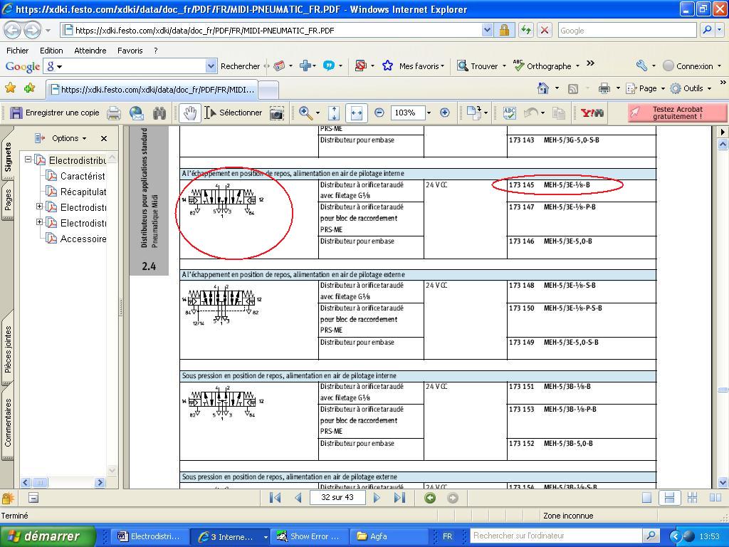

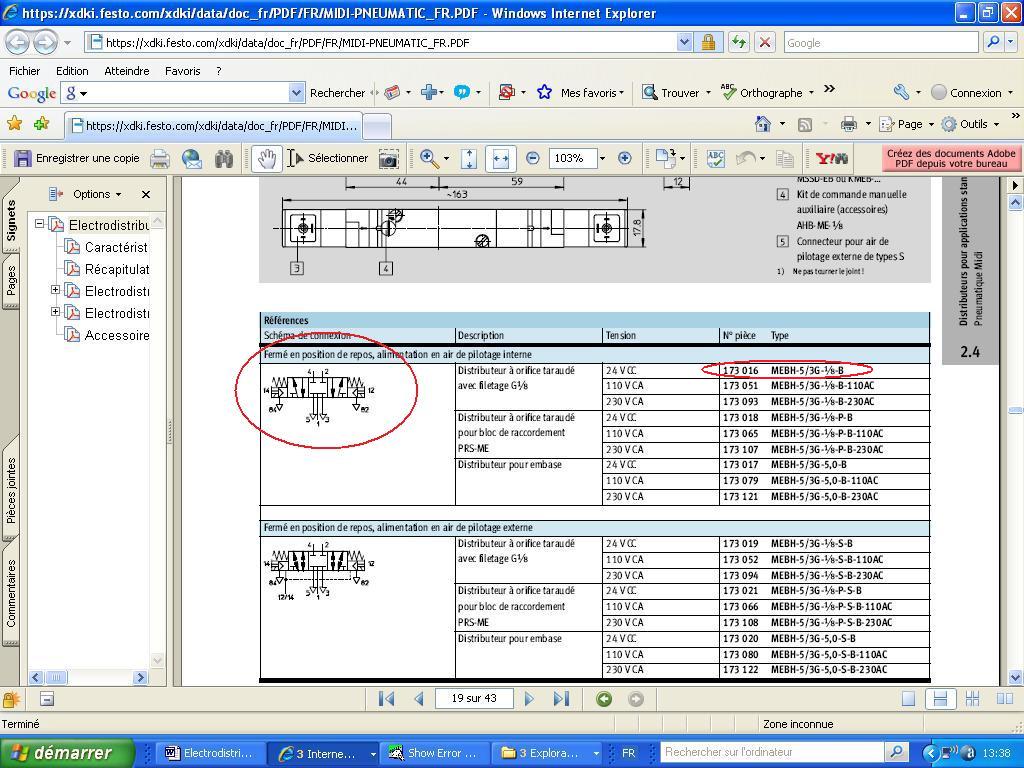

    i found a problem with my distributor:
    my distri:i think it's not good :(
    is it possible to use it anyway?
    because I did not pay, and given the price!
    this one is ok isn't it?
    it was very difficult to buy 5/3 center close on ebay, have you some link or info...
    thanks

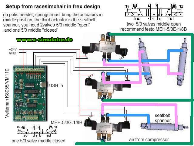

    This diagram is an alternative design for a FREX is not it?
    I think it is better to use the solution with 4 X5 / 3 center closed.
    I will use more speed, and therefore 4 dealer 5 / 3 center, is better!
    no photo with this solution?

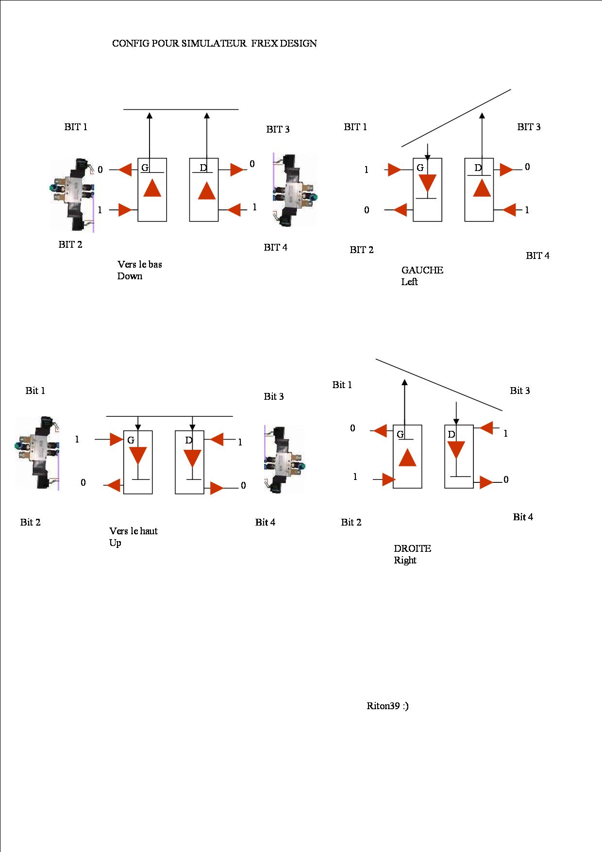

    Here is how I did my wiring, with the same logic, how do with 4 distruibuteur?
    distributor 1 :bit 1 /2
    distributor 2 : bit 3/4
    distributor 3: bit 5/6
    distributor 4: bit 7/8

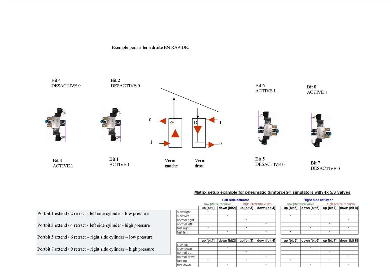

    I made a new document with an example
