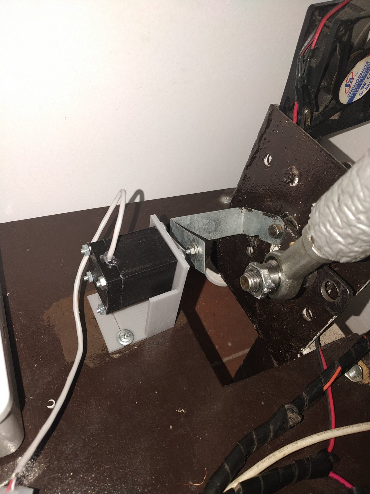

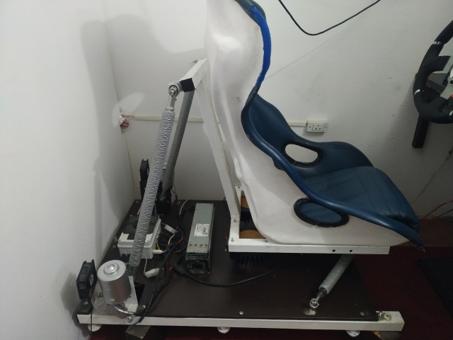

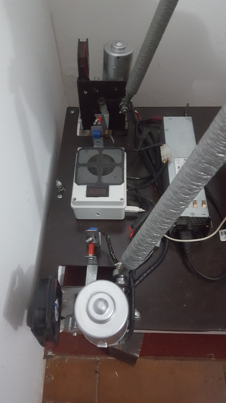

    I would be missing to place one of these bars ... with only one is enough ??
  2. Pastrana
    Pastrana Member
    Oct 30, 2015
    91
    Argentina
    386Coins
    +44 / 0 / -0
    Hello Juanjo !!! With just one bar is enough.
  3. Juanjo1986
    Juanjo1986 Member
    Jan 6, 2016
    53
    Comerciante.. Copiloto Rally...
    Argentina
    463Coins
    +18 / 1 / -0
    perfect..
    Now it has to be to the center of the pivot under the armchair and the other end to the chassis in any position? Does it have to be a long one?
  4. Pastrana
    Pastrana Member
    Oct 30, 2015
    91
    Argentina
    386Coins
    +44 / 0 / -0
    Always to the center of the pivot axis of the seat, in relation to the chassis, the place of anchorage in the seat in any side.

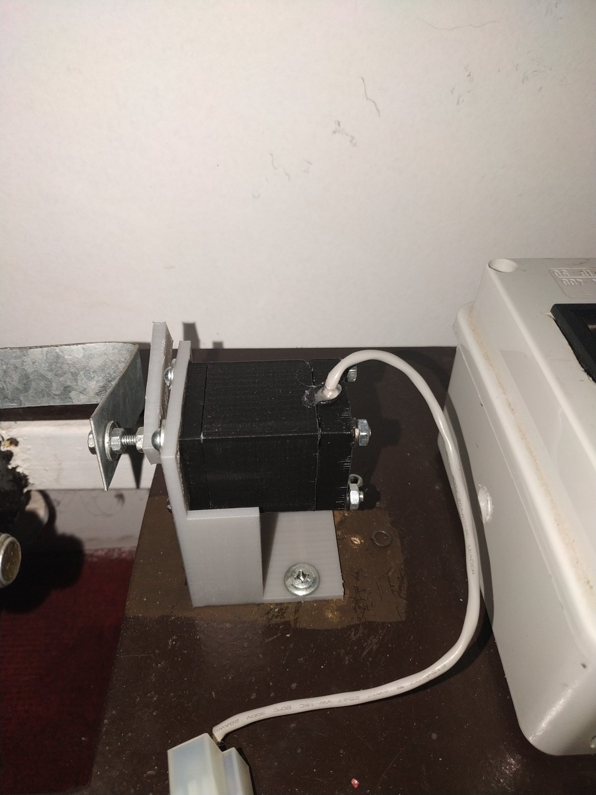

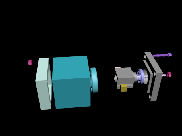

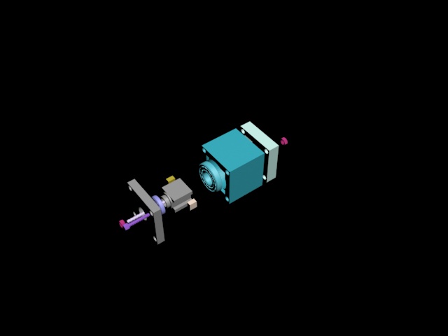

    I have built some Printer 3d, potentiometers with hall sensors if anyone is interested I have uploaded to Thingivers
    I have built some potentiometers with hall sensors.
    materials
    1 bearing 624z
    1 bearing 608z
    1 hall sensor
    2 magnet neodimio 5x5x3mm
    1 nut and screw M3 x 40mm
    4 nut and screw M3 x 50mm
    https://www.thingiverse.com/thing:3608543

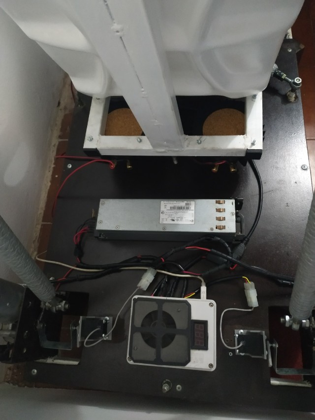

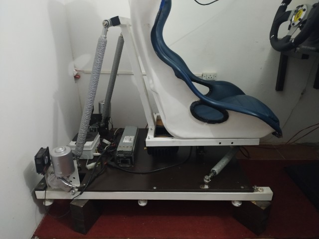

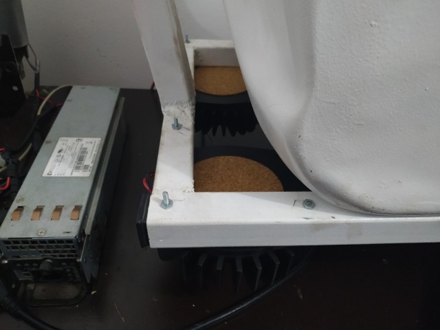

    This is the simu, the last addition was potentiometer with sensors hall and bass shaker
  7. Adri.monti
    Adri.monti New Member
    Aug 19, 2020
    21Coins
    Spectacular, very nice project, ask, what sensor hall did you use? any recommendations when building the potentiometers?
