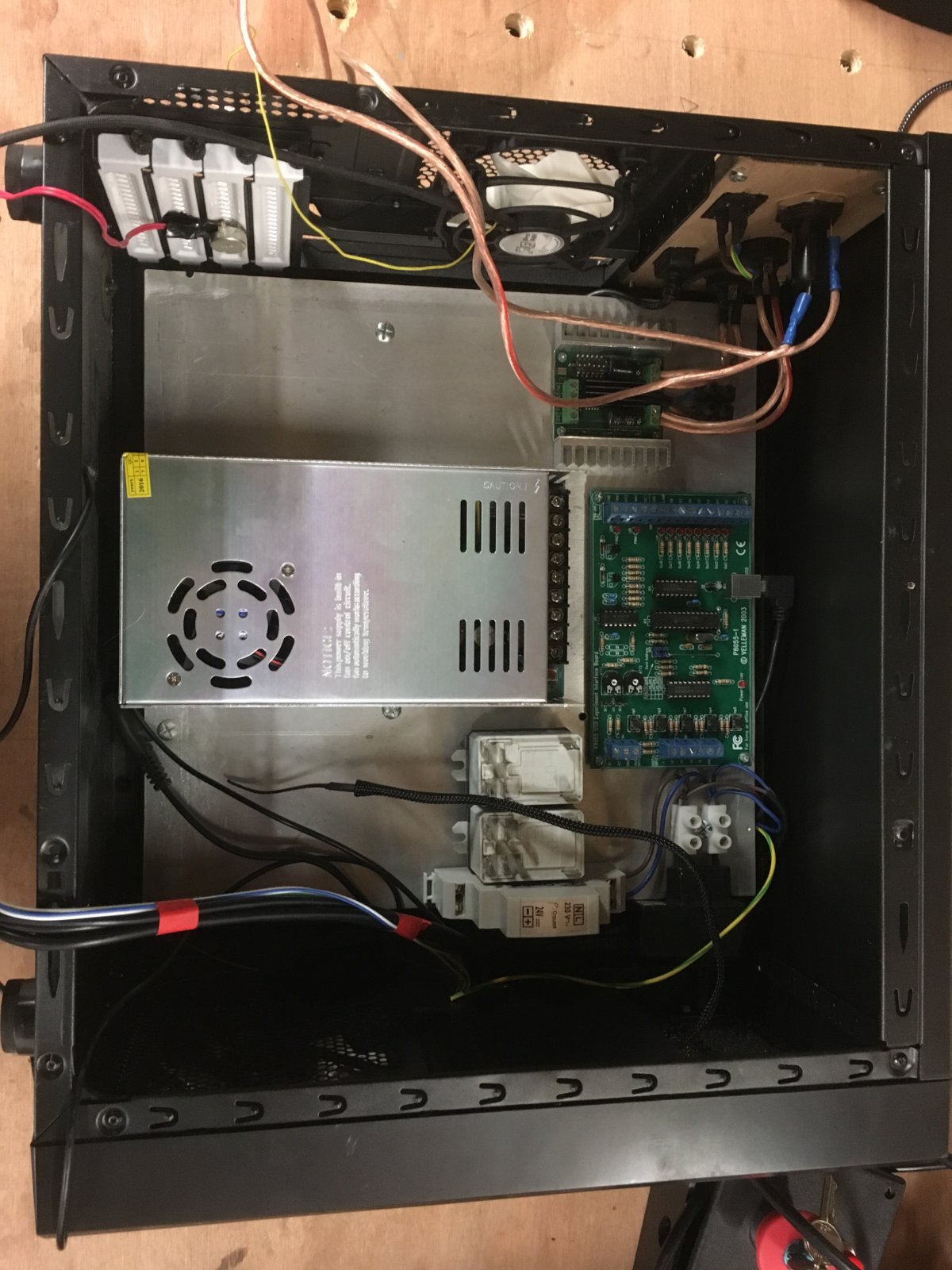

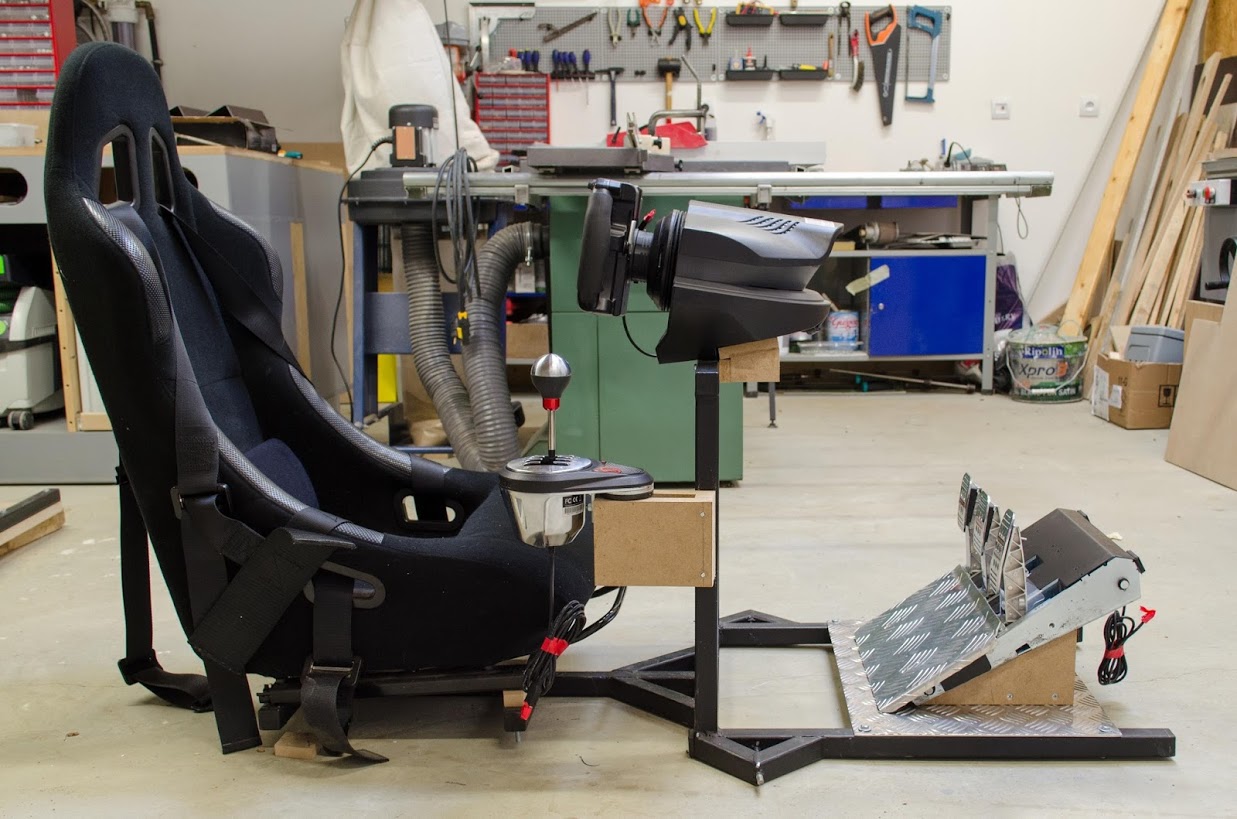

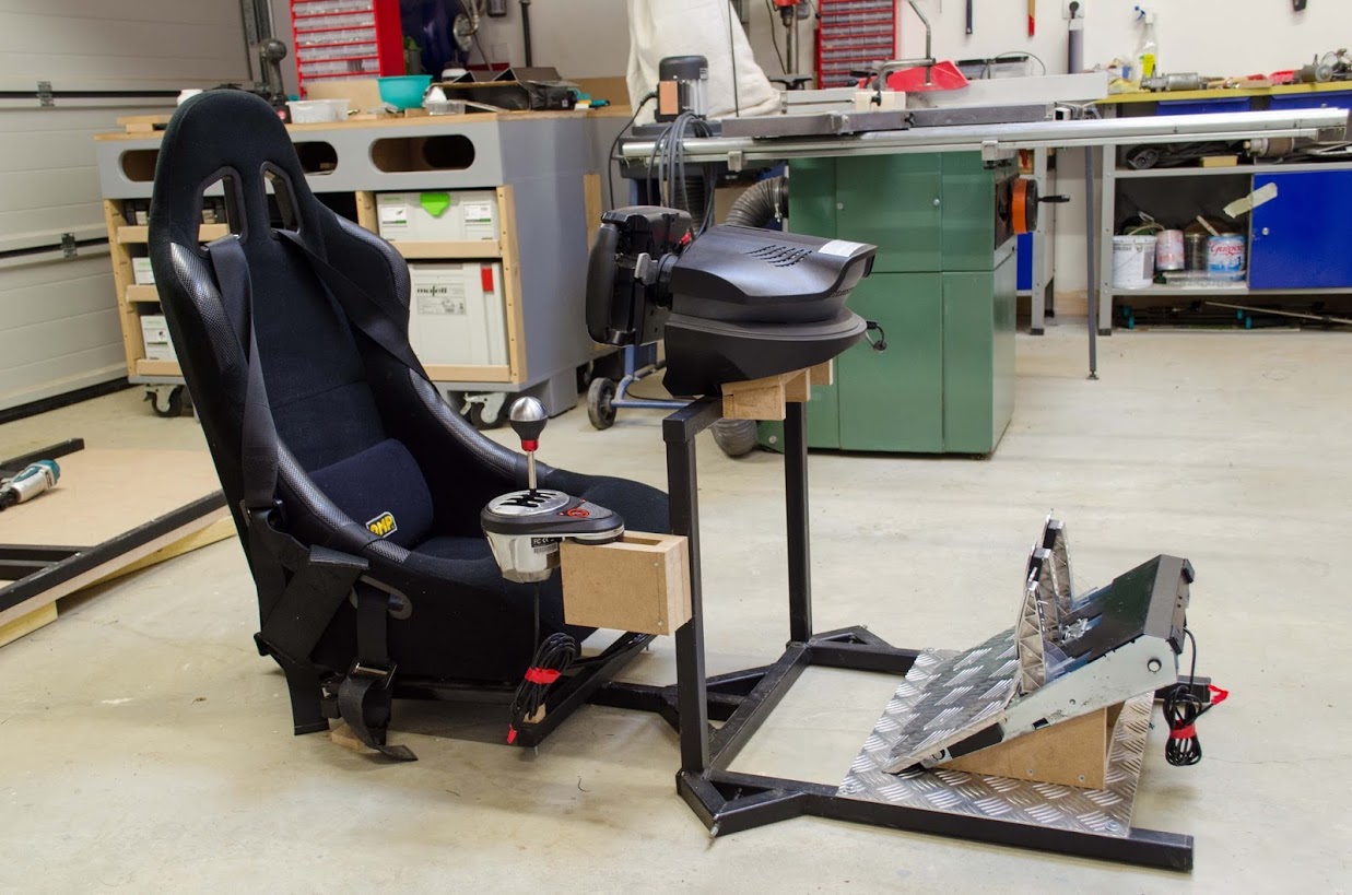

    Here is my old electronic box that I had to make with an old PC case.

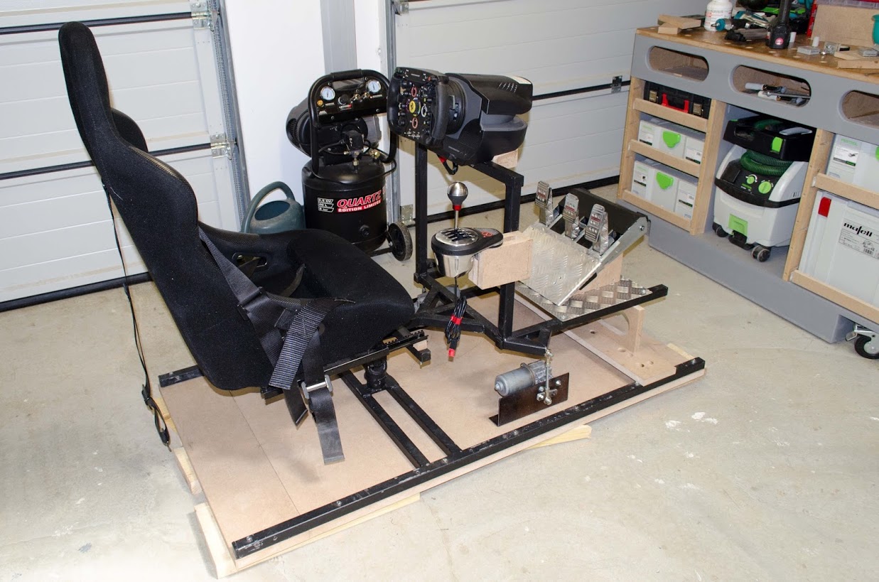

  12. djboss001
    djboss001 Member
    May 25, 2014
    47
    Test engineer
    - 34Coins
    +17 / 0 / -0
    Hi everyone,
    After a long period of downtime with the simulator, I'm back to building with a new configuration. The base is now on wheels, and the mounting of the motors and potentiometers is now much more robust and reliable!
    Here is a video while waiting for the next part:
  13. djboss001
    djboss001 Member
    May 25, 2014
    47
    Test engineer
    - 34Coins
    +17 / 0 / -0
    And an another test with the harness attached to a fixed part, to simulate the compression effort of the rib cage during braking. It works very well!

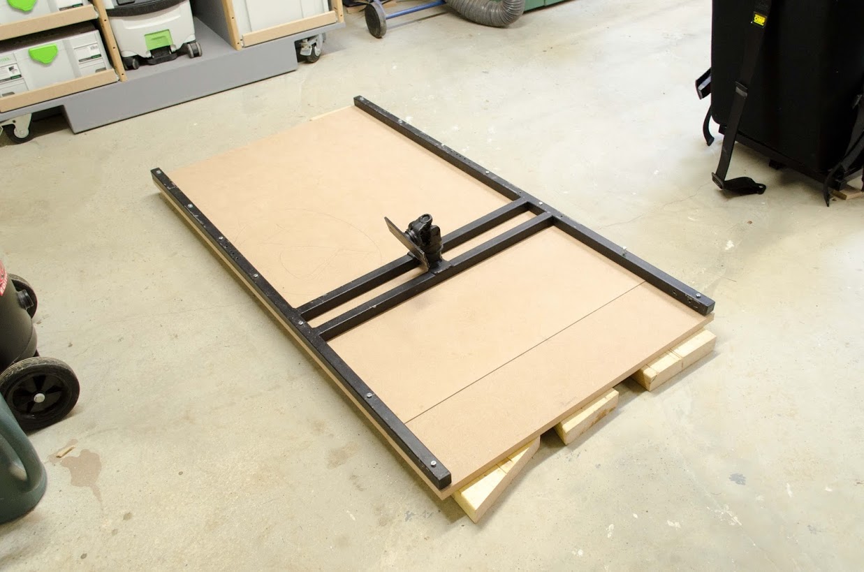

    Ron Paulk is proud

    And what's more, it can be hung on the wall when not in use.
    And in work mode:

    @SimPotato : Impressive guy ! But I prefer woodworking, which requires much less expensive tools.
    Some news: the construction of my new version of the cockpit is going well. Before the video demonstration, here is already a list of actions done (may be useful for new pilots ;) ) . .
    To begin with, here is the list of materials used:
    - Arduino Uno
    - Sabertooth 2x32A
    - Power supply 24V 20A with 2 battery 12V / 7Ah in parallel
    - 2 motors smolka 24V with disconnected ground potential.
    - 2 potentiometers PPC27
    - 1 PC for gamer (Ruzen 2600X / RTX 2060 super / 32 Go DDR / 2 To SSD)
    - Wheel Thrustmaster TS-PC
    - Paddles Heusinkveld HE pro
    - Screen 42" Samsung

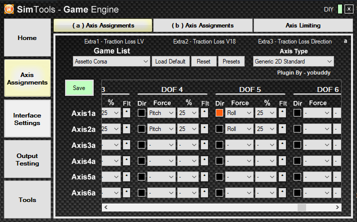

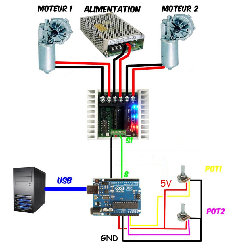

    General wiring diagram :

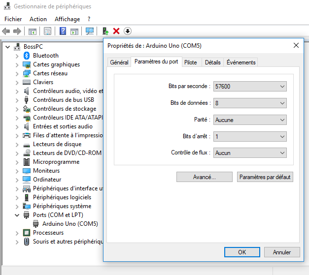

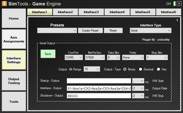

    Download and install the following software:
    Jumper configuration of the sabertooth with 1 and 2 OFF (115200 baud) :
    Then :
    - Launching Plugin updater, setting up plugins and patching the games (Assetto corsa, Raceroom and Dirt Rally)
    - Activation of the DIY license
    - Launch GameManager and GameEngine, green sync OK

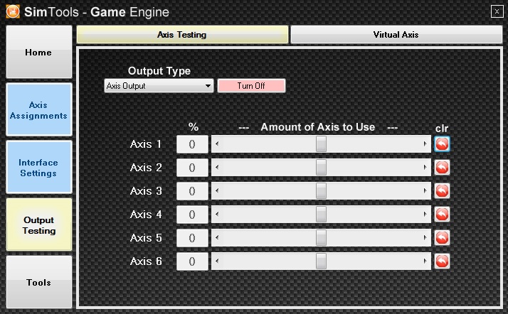

    GameEngine configuration :
    - Save the configuration
    - In Output Testing, I do Turn On and select Axis Output, I move the Axis1a sliders a bit: It works!
    - Calibration of motors with potentiometers :
    To calibrate (by calibrate I mean to put the crank in the starting position when the potentiometer is at its average value) here is the simplest method:
    - You make sure that the gear wheels of the potentiometer and the motor are not in contact.
    - You run output testing in Simtools without touching any slider (the potentiometers will try to get to the average position = 512)
    - You turn the potentiometer slowly which will make the crank turn more or less quickly
    - Once your crank is in the desired position and the pot is in the middle position (no more movement of the crank), you make contact between the gears again.

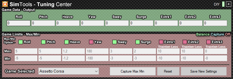

    - Activation of effects in the game (Assetto Corsa) :
    - So I have 5 effects activated:
    - Sway 80%
    - Surge 80%
    - Heave 25%
    - Roll 25%
    - Pitch 25%
    And let's play !

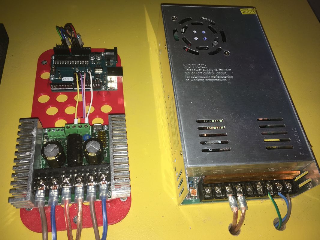

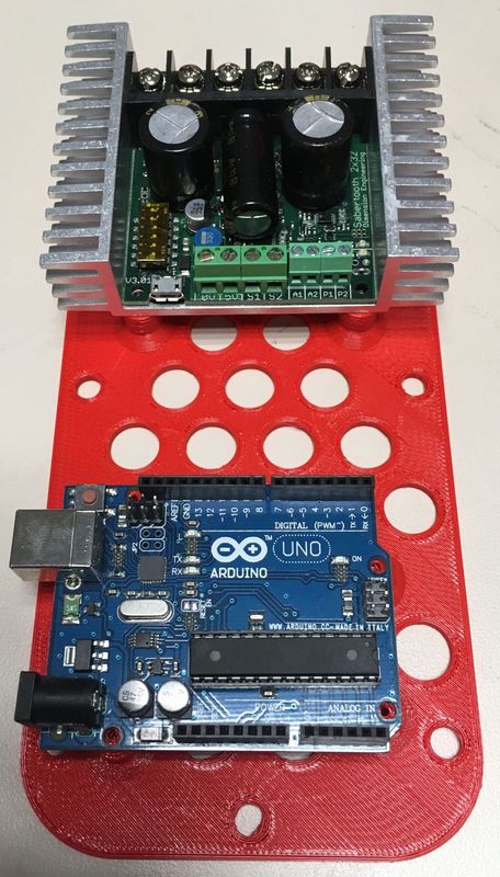

    Installation of the arduino on a 3D printed support :
    And with the power supply :

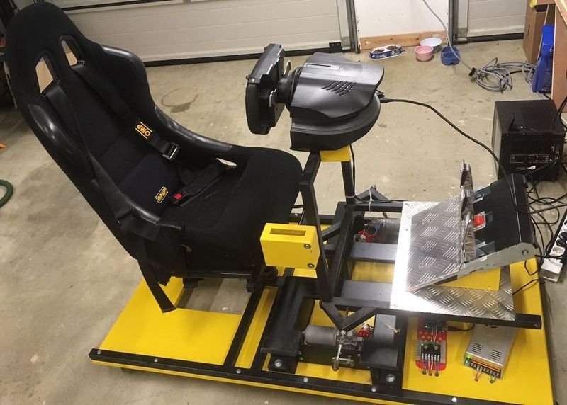

  19. djboss001
    djboss001 Member
    May 25, 2014
    47
    Test engineer
    - 34Coins
    +17 / 0 / -0
    View of the cockpit structure before installation of the new steering wheel and pedals : hm9y.jpg

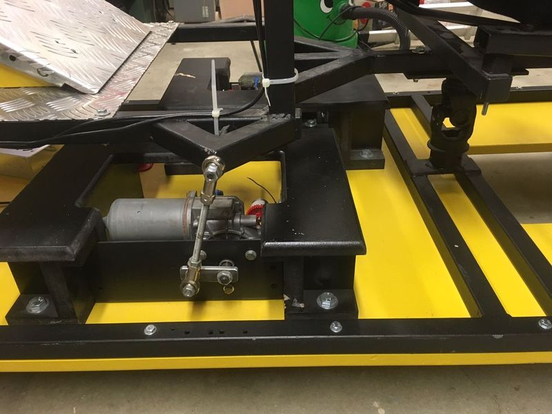

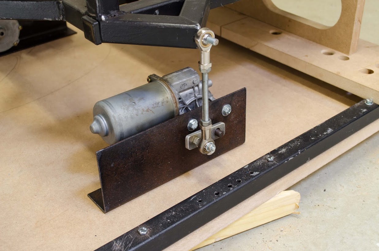

  20. djboss001
    djboss001 Member
    May 25, 2014
    47
    Test engineer
    - 34Coins
    +17 / 0 / -0
    Detail of the motor attachment and connection to the mobile structure : 1jow.jpg
