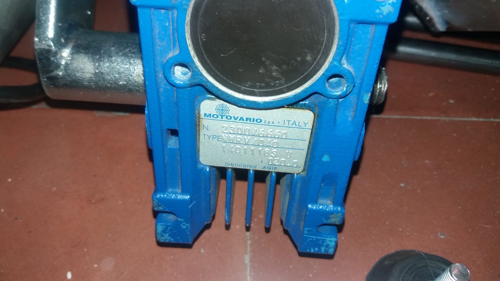

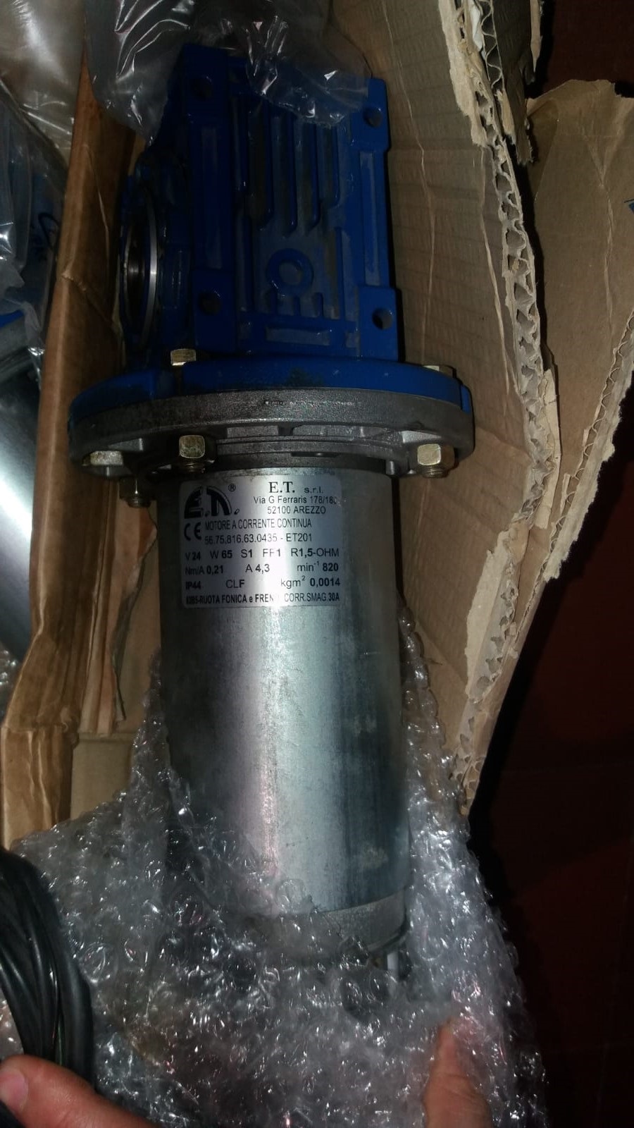

    ESPAÑOL -> Aquí un adelanto del cockpit... ESTOS MOTORES QUE ESTOY UTILIZANDO SON DE PRUEBA POR QUE NO ME SIRVEN POR SU POCA POTENCIA (W).
    ALGUIEN SABRÍA SI ESTA CAJA REDUCTORA SIRVE SI CAMBIO DE MOTOR DE MAYOR (W) ?
    CUANTO (N) TIENE ESTA CAJA REDUCTORA SABRÍAN DECIRME ?
    Saludos!
    ENGLISH -->Here is a preview of the cockpit... THESE ENGINES I'M USING ARE TEST BECAUSE THEY DO NOT SERVE ME FOR THEIR LOW POWER (W).
    SOMEONE WOULD KNOW IF THIS GEARBOX WORKS IF YOU CHANGE THE MOTOR OF GREATER (W) ?
    HOW MUCH (N) HAS THIS GEARBOX WOULD YOU KNOW TO TELL ME ?
    Greetings!

    I think those engines are powerful enough to move your seat, but not with the entire structure including pedals and steering wheel. Try to modify the structure so that it only moves the seat and shortens the radius of the gearmotor to 6 cm so that the movements are shorter, you will also gain more power.
    Version Español
    Yo creo que esos motores son suficientemente potentes para mover tu asiento, pero no con toda la estructura incluyendo pedales y volante. Intenta modificar la estructura para que solo mueva el asiento y acorta el radio del motoreductor a 6 cm para que los movimientos sean mas cortos, tambien ganaras mas potencia.

    Thank you!!! for your great help, as you will see the structure is very heavy so it will be modified ...
    Regarding the engine:
    the reducer is large, so changing the engine for a greater (W) would change the force to move the entire structure, I want everything to move to make it more real.

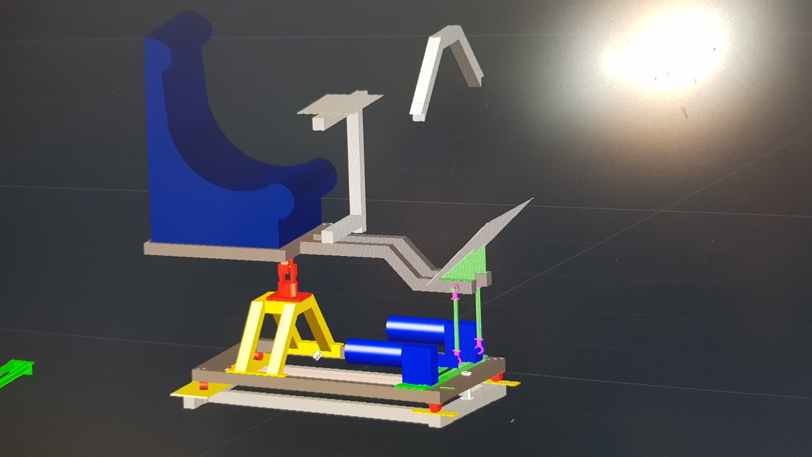

    Hello friends of xsimulator today I present my new design, inspired by other simulators. I hope you can advise me on the structure of the simulator since I am not a design professional.
    Español:
    hola amigos de xsimulator hoy les presento mi nuevo diseño, inspirado en otros simuladores. espero que me podais aconsejar sobre la estructura del simulador ya que no soy un profesional en diseños.
