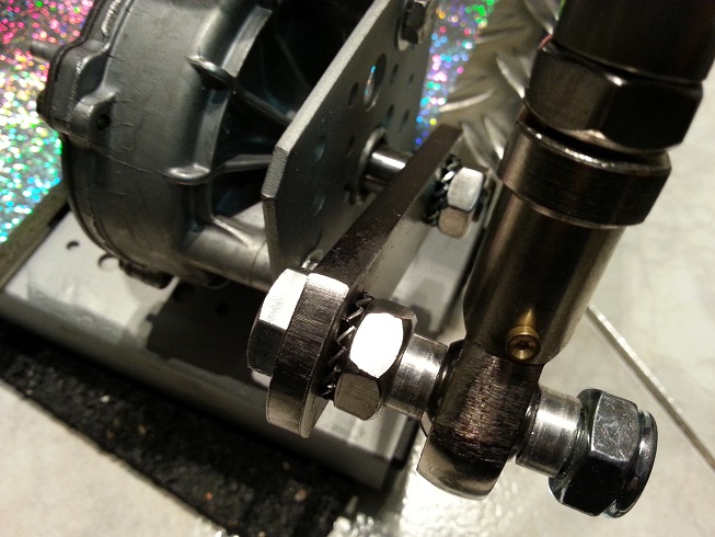

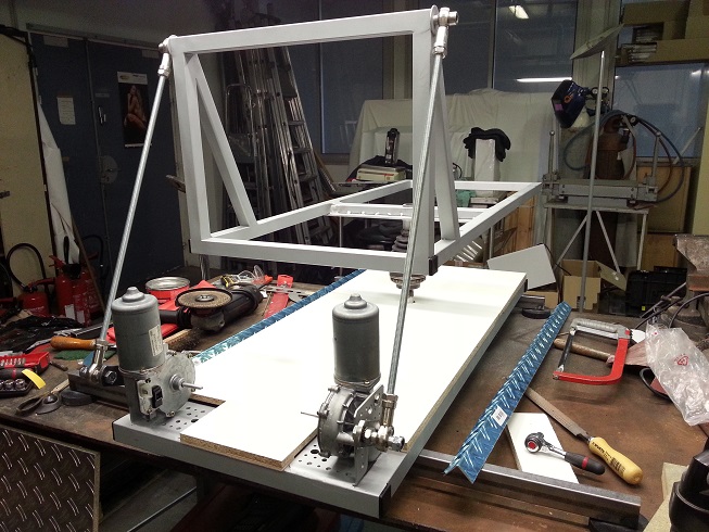

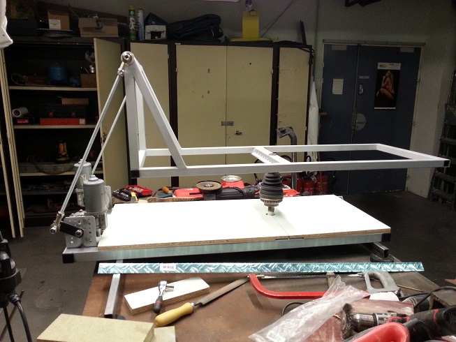

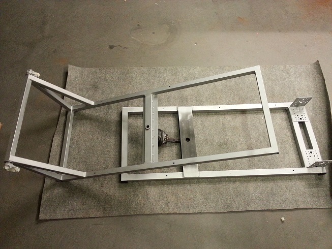

    Here is the assembly and design.
    [ATTACH = full] 23923 [/ ATTACH]
    In Les Grandes Lignes these are the dimensions.
    Floor part, 105cmx43cm in square tube of 3.2cmx3,2cmx100cm or 5 bars of iron.
    Portable part, 105cmx43cm in square tube of 2,5cmx2,5cmx100cm Or 6 bars of iron.
    The height of fixation of the bras by the kneecaps is of 35cm.
    The height of the two horizontal planes and of 21 cm the all welded by the cardan of car.
    After, sanding, filling, and cold galvanizing in paint bomb.

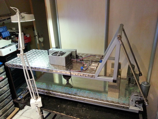

    [ATTACH = full] 23924 [/ ATTACH]
    Installation of the floor in cp of 10mm and installation of white motors ...
    [ATTACH = full] 23925 [/ ATTACH]

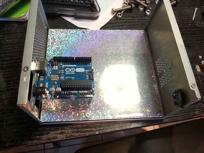

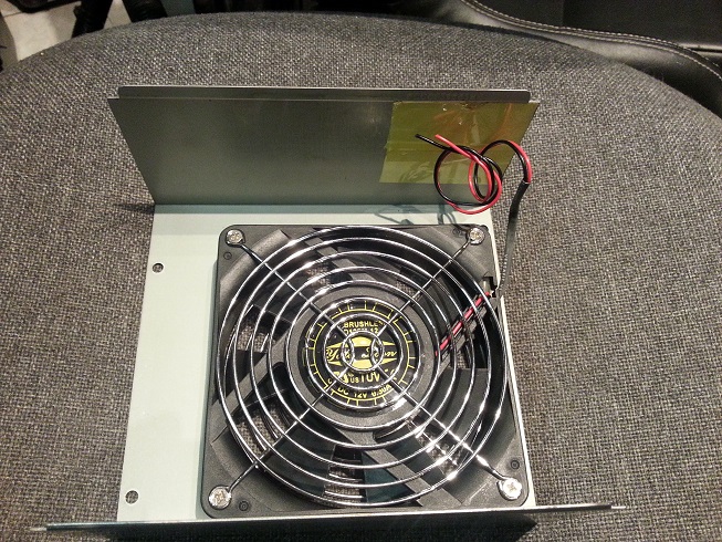

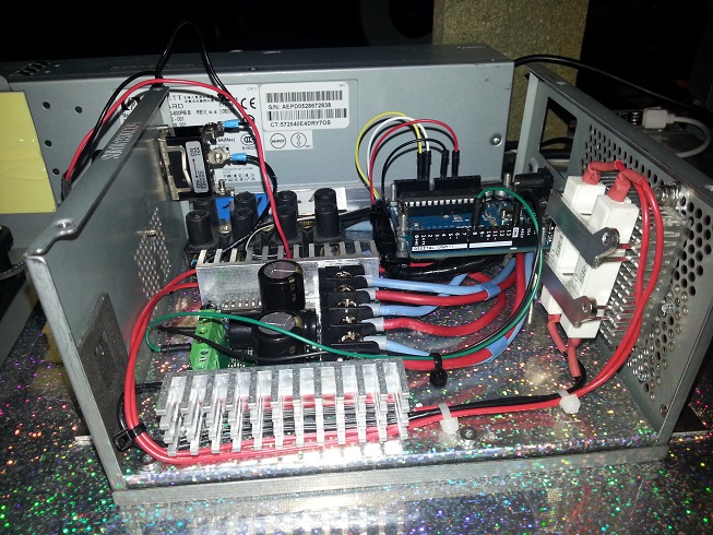

    Now here is the electronic box. The support will be an old pc power supply.
    [ATTACH = full] 23926 [/ ATTACH]
    [ATTACH = full] 23927 [/ ATTACH]

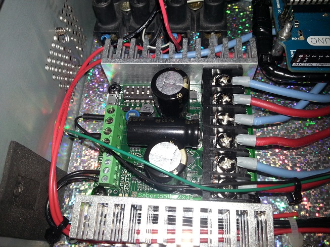

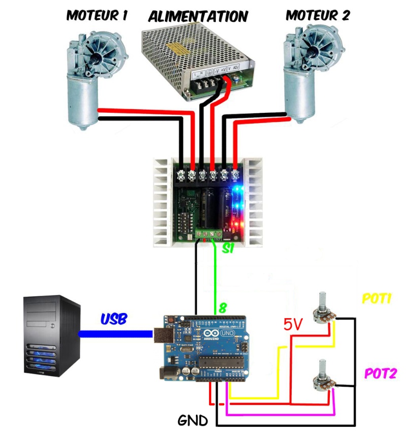

    Wiring of ARDUINO and SABERTOOTH
    [ATTACH = full] 23929 [/ ATTACH]
    The electrical wiring plan [ATTACH = full] 23934 [/ ATTACH]
    The SABERTOOTH 2X32A
    [ATTACH = full] 23928 [/ ATTACH]

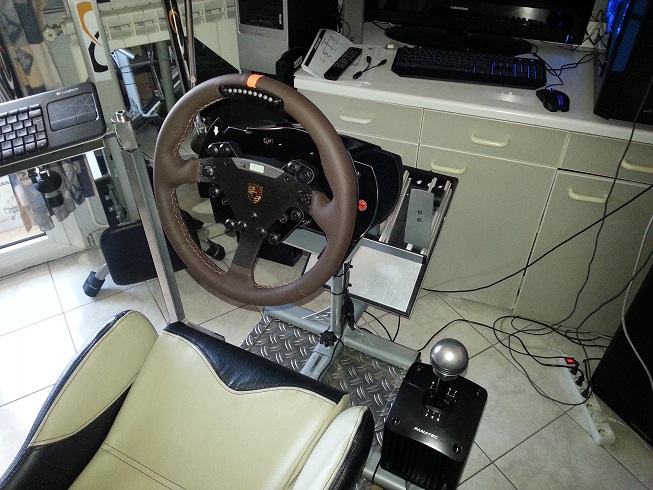

    Fixing my Playseat to the chassis, finally it takes shape ...
    Will remain, more than to look at the program part Arduino, Sabertooth, and management xsim Where simtools [ATTACH = full] 23932 [/ ATTACH]
