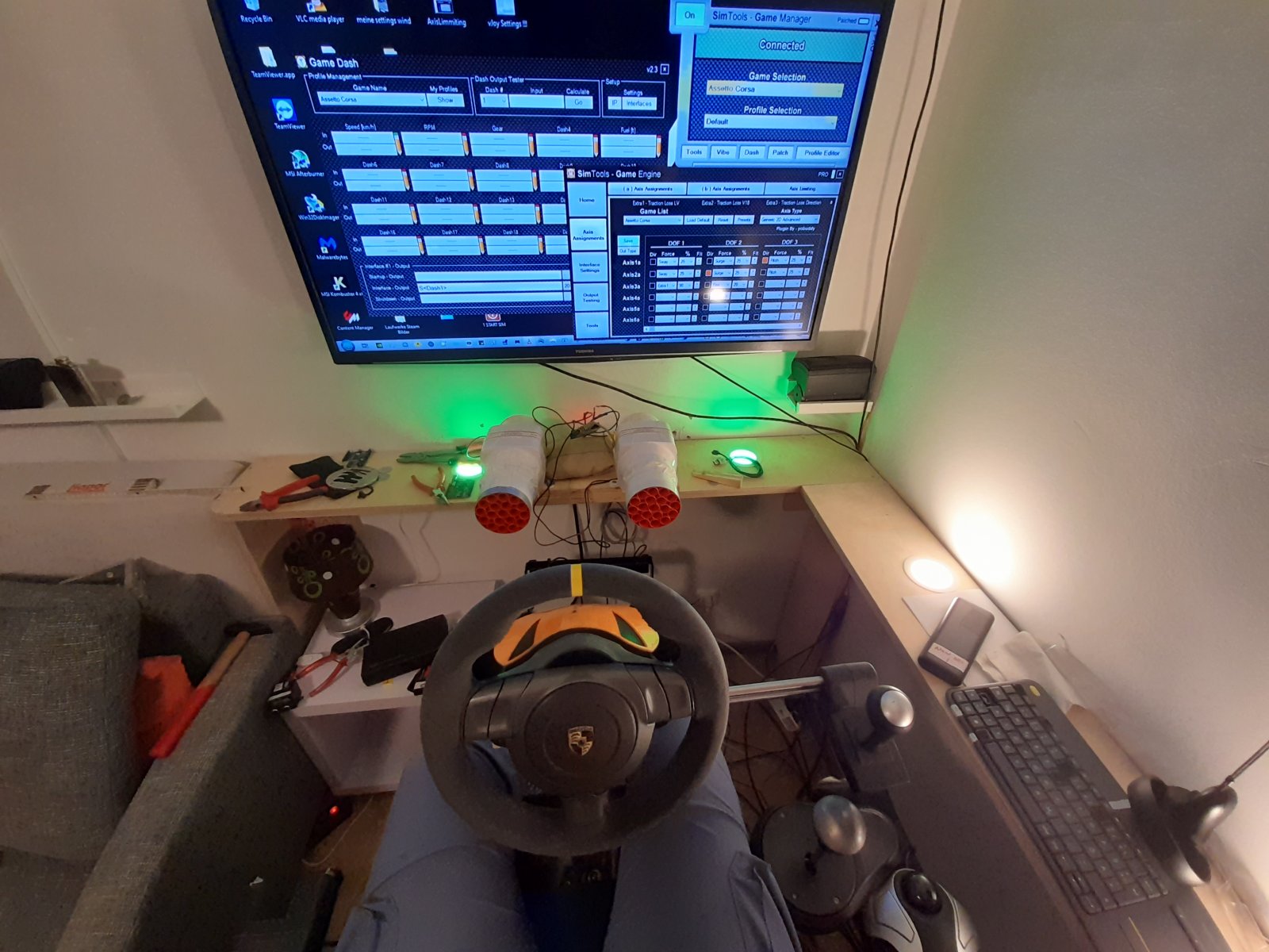

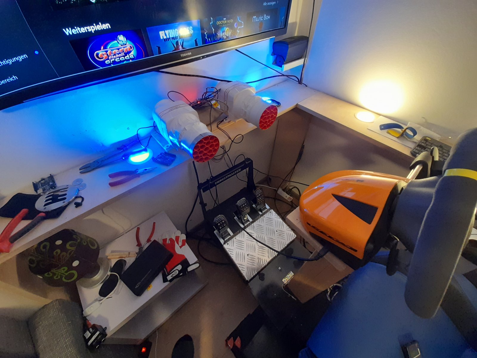

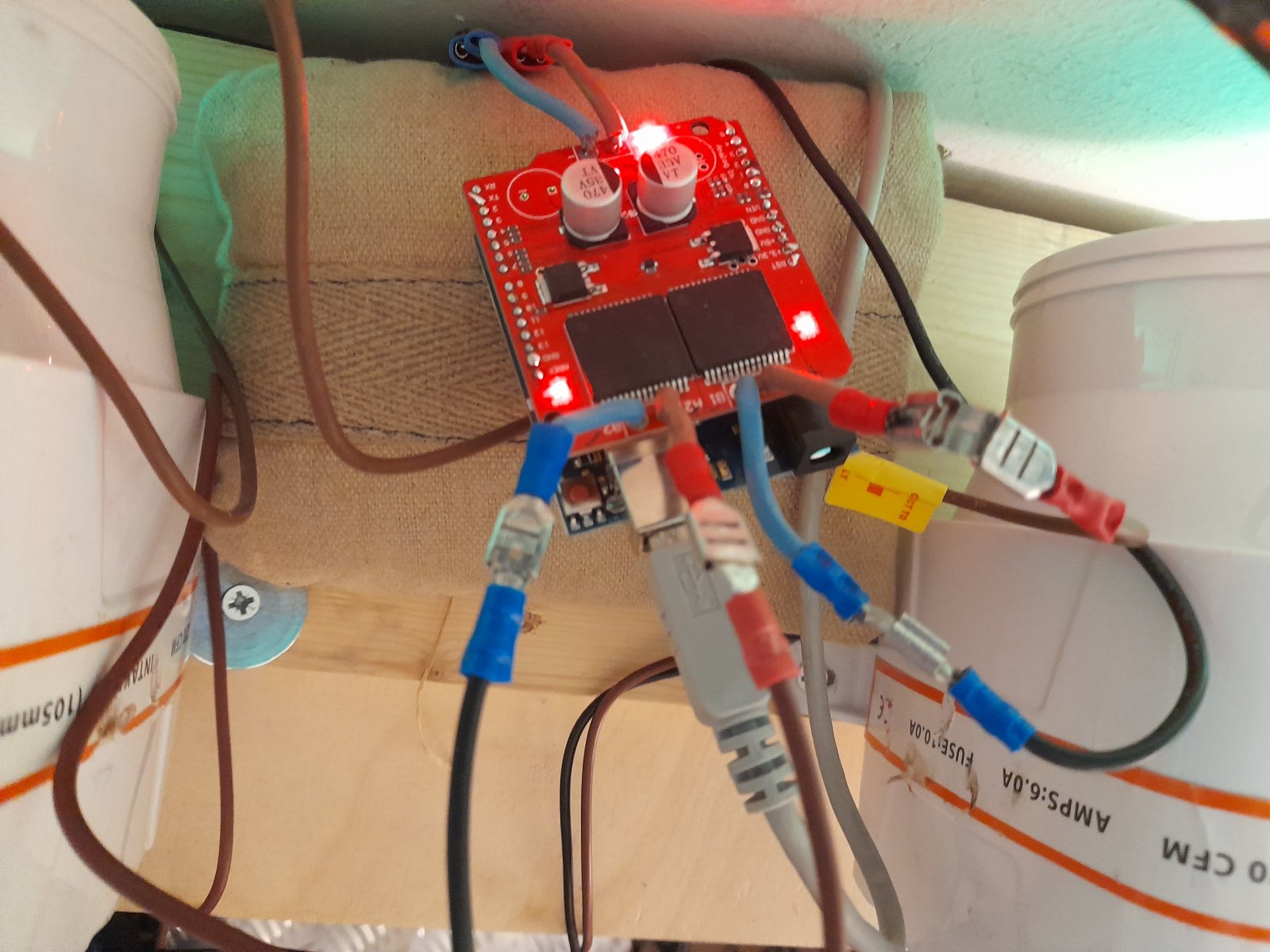

    Hi ZED & hell YEAH new status :)
    I have a lot to do in my job and with schooling my son a.t.m.
    I was to tired to do a lot in the evenings ... :confused:
    BUT: I soldered the pins right after your pre last comment. AND there it was ... fans in motion !!!
    Look at the funny artful bubbles I created on those pins - soldering something as close as these pins for the very first time (will say I suck at soldering :cool:)
    The wind is only tested in Assetto Corsa at the moment. I can say it works :cheers increasing and decreasing as it should with the kph driven by my car.
    I think it only works right when I delete the MATHs line completely as it would be at 1 .
    My PSU is for 400W max. and I run all my three 160W motors and the two fans with it. Every time it is challenged too much over its maximum it has a stopping hick-up. The MM gets that hick-up in power too and than it is running at the last speed as before that hick-up until I push the GERÄT's emergency power off button. Once I release the em.pow.button the wind blows with the right force again until ... :rolleyes:
    So no big problems to see at the moment because I think I have one PSU lying around for the fans :D
    hug:
    ... and I will try the new .ino file today.
    Yours ART FLY

    Hey Art, so happy to hear you got it all going! All that other/new/replacement .ino does is default to zero speed on reset or power up. I did that so people had to consciously choose to have a wakeup speed for those with VR and plugins that may not support wind. There’s no other difference between the version you have and the new one. If you’re happy with the built-in idle speed on wakeup of the older version, you’re good to go!
    And it’s tough sometimes to include the important details not knowing others’ experience levels. When you work with this stuff a lot, you forget that others may not have a background where they understand all the stuff that gets rolled up in saying something like “pop the MM onto the Arduino”. If everyone included all the detail, unfortunately it would blow things up the other way and take forever to post “simple” concepts. It’s a real problem with so many having such different backgrounds. We can use a shorthand of sorts to describe things where we assume, sometimes wrongly, that everyone understands what we mean.
    Photos, screen grabs, and questions/reports are really helpful, though, and I apologize I didn’t spot the lack of solder first view. I just saw the MM mounted on the Arduino in the thumbnail and it looked good from what I saw. It was only on looking closer after you were still having issues that I spotted the lack of solder. But that’s where detail on the part of those who might be missing that background gets important. It’s why I was asking for a breakdown and details of what things worked and what didn’t. That helps close the loop and both sides to understand where problems can be.
    But glad you got it going!

    :cheers Cheers and the rig looks good!

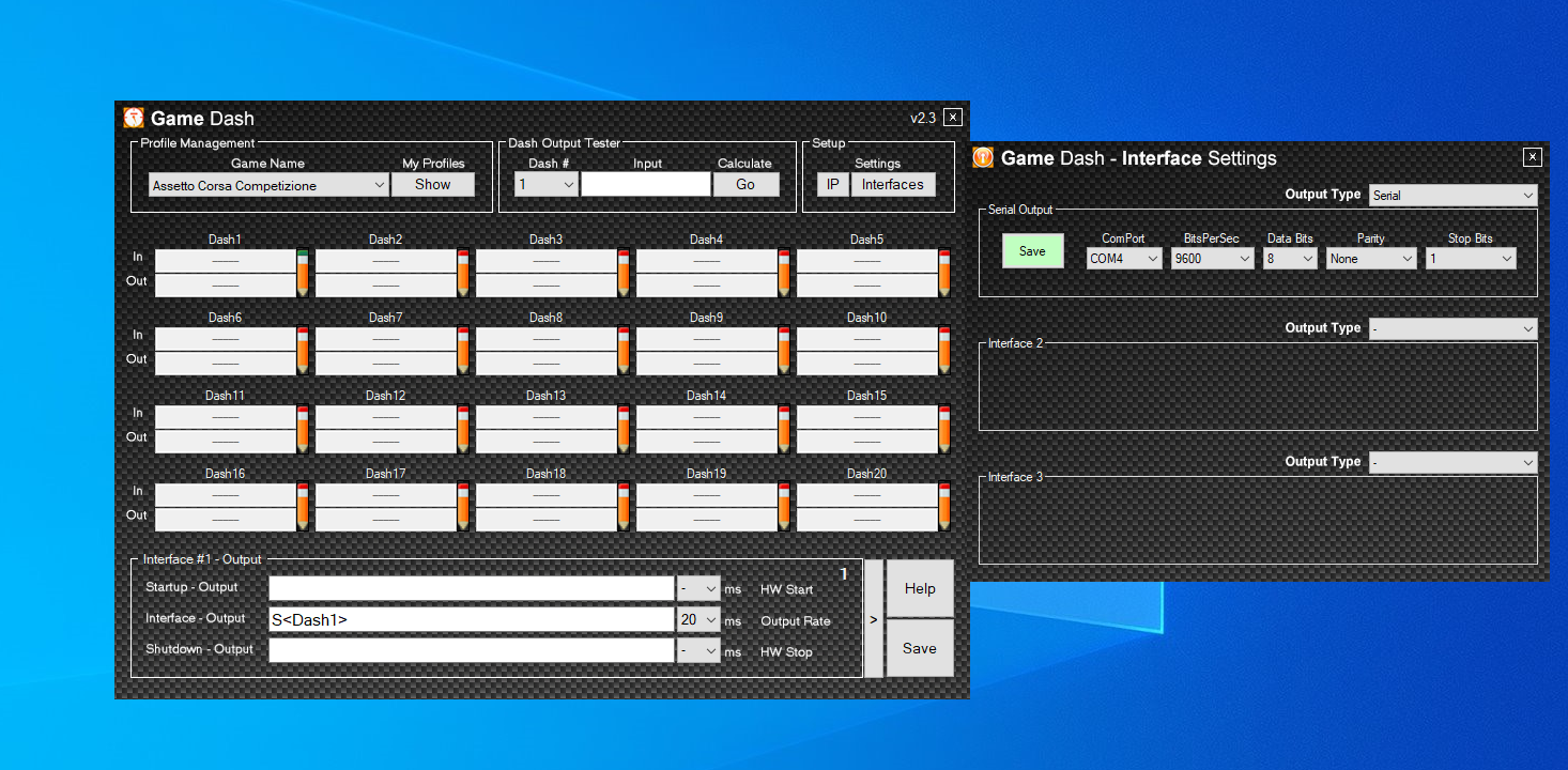

  11. Alexander Monefeldt
    Alexander Monefeldt MPRSupercharger
    Feb 27, 2021
    154Coins
    This is my current setting in GameDash
  12. Zed
    Apr 4, 2017
    1,040
    USA
    5,847Coins
    +1,043 / 4 / -0
    Alexander, do you have any math in the command editor (the pencil) for Dash 1? There’s lots of examples in this thread of configuration in Game Dash. Since your system accepts manual commands, it sounds like you just need to sort configuration in Game Dash and SimTools.

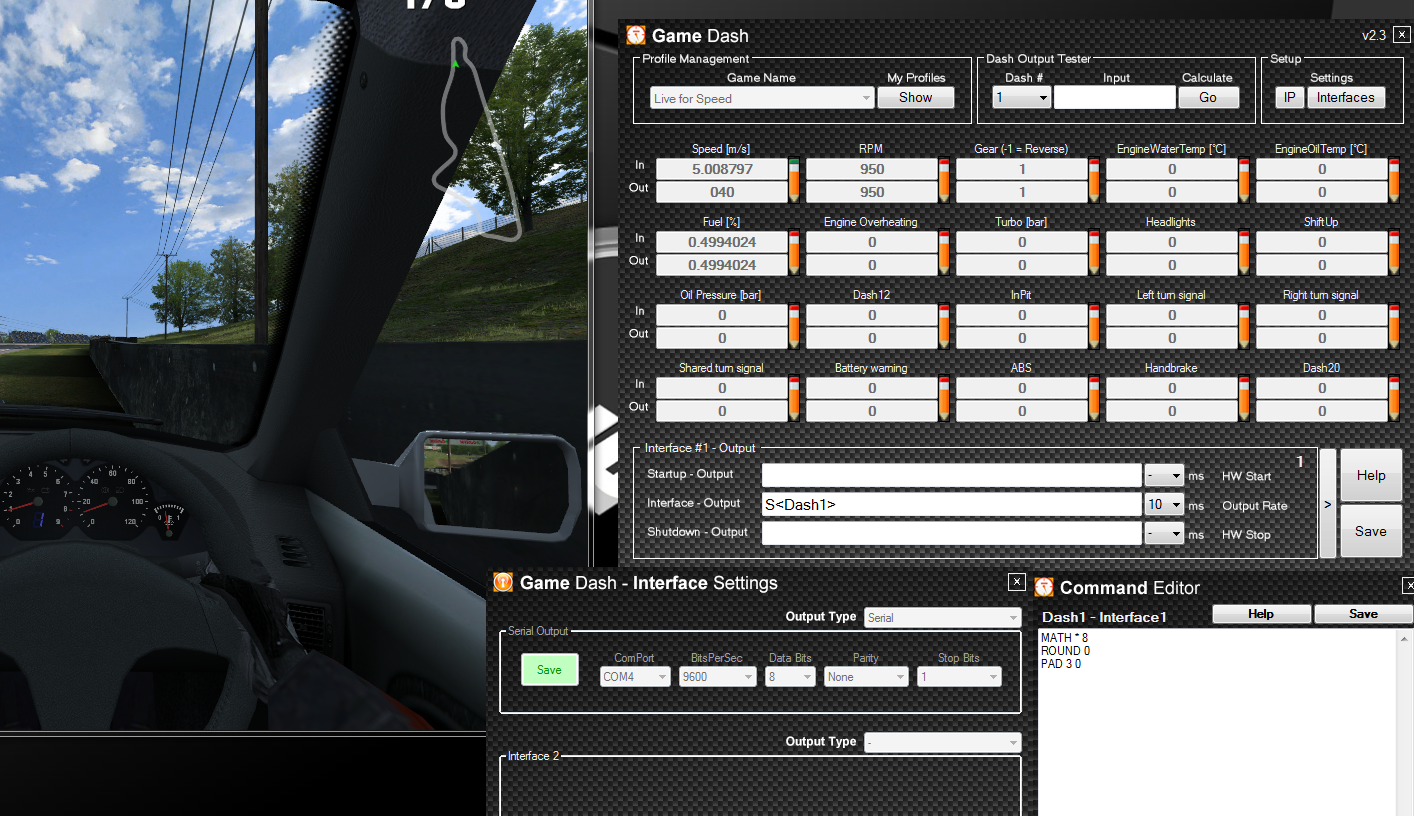

    so, it finaly works in LFS
    I had to reinstall sitools, game dash, plugins and it is alive but I cant get it working on Warthunder
    any ideas?

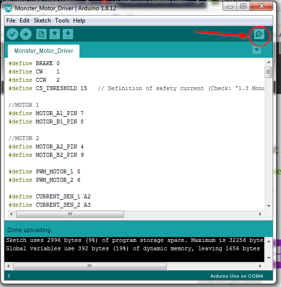

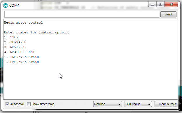

    It might help some people. It took me a while to find it.
    Moto monster test:
    • Check the video below:
    • Download Arduino code attached (moto monster test program.rar)
    • Connect your multimeter instead of motors (if you dont have spare motors)
    • use monitor function in arduino
    • Use + / - on your keyboard to increase or decrease voltage
    • Check the output both ways CW and CCW
    I hope this will help
