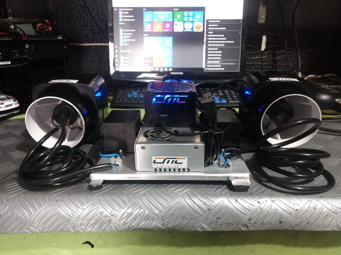

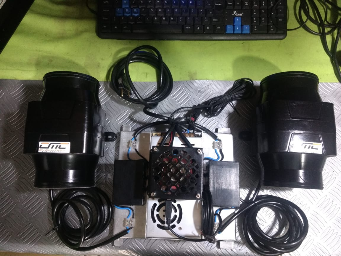

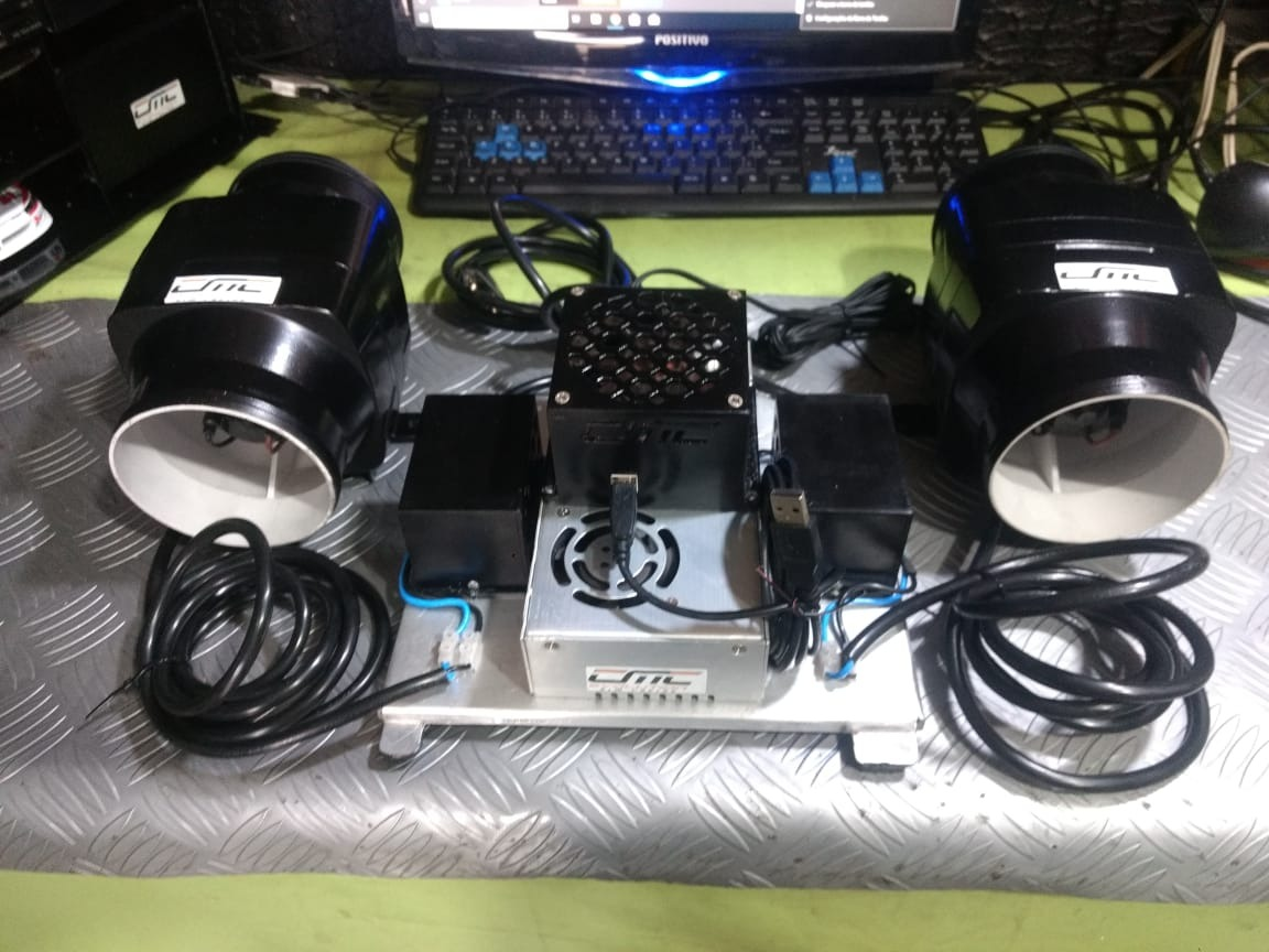

    hello friends, I've come to show you how my wind simulator got to you! If someone wants to use my box made in 3d printer just talk to me that I make the file available! This box is for the arduino with 80mm cooler. I made it personalized with my logo. But I can withdraw if that is the case. I also want to thank the @SilentChill for having made available the Arduino code that made it very easy for me! And to all involved in this wonderful project.

    Nice job looks great :)

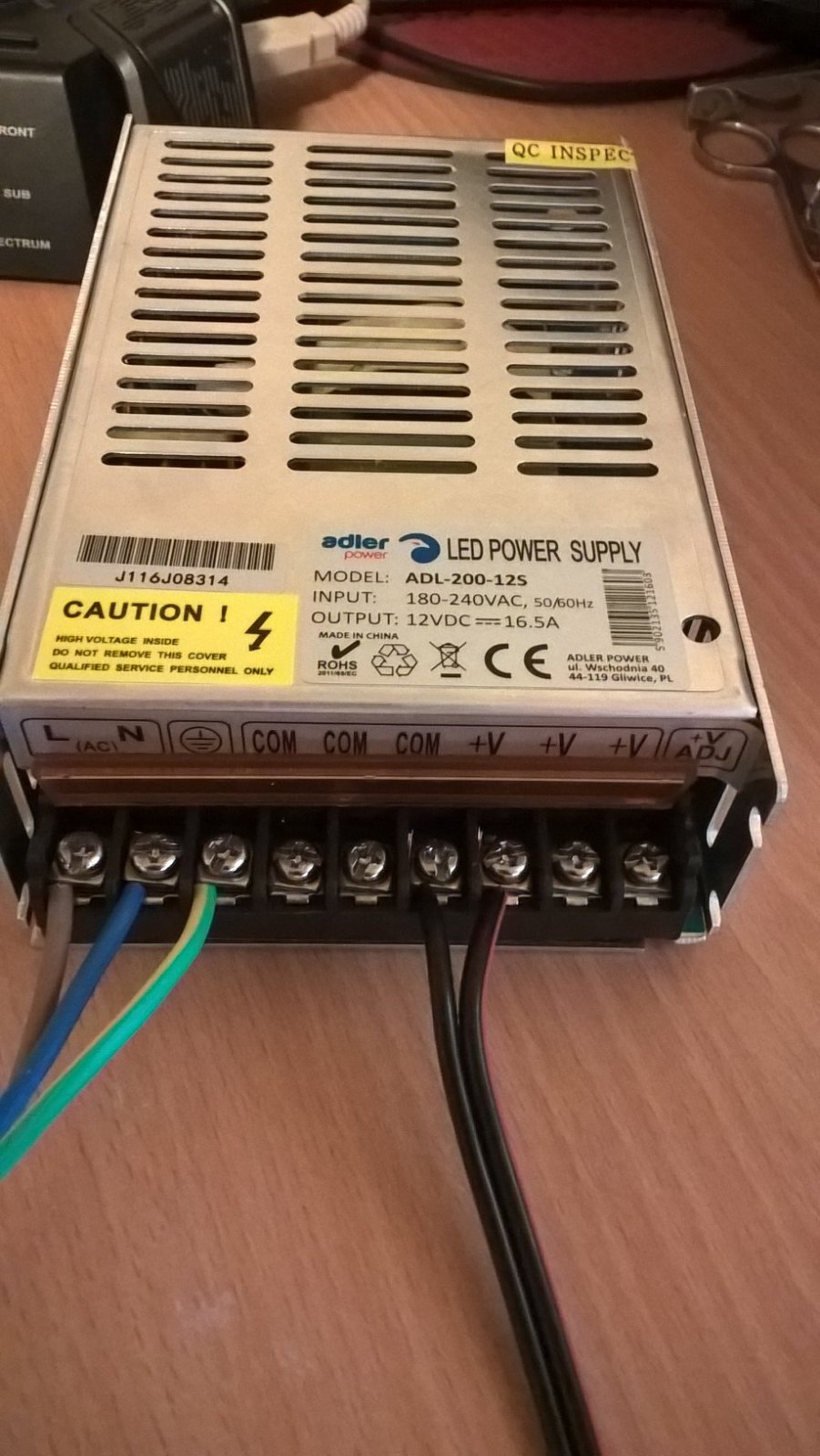

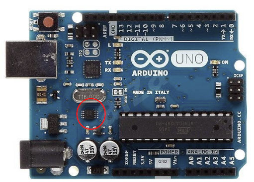

    Hi Guys. I love the project ,that way I decide to build it and add to my rig.Its second arduino uno I brick/damage? After upload the sketch to the uno and power up software and the game it works for 10 minutes and stop working . When I checked the green led on is not on anymore. I try to upload sketch again , separate monster moto from arduino and got the message "
    avrdude: stk500_recv(): programmer is not responding
    avrdude: stk500_getsync() attempt 1 of 10: not in sync: resp=0xdb
    I try to reset arduino but nothing working??
    This is my second uno ,one from ebay,one from jaycar (local store)
    Any sugestion guys ,is it chance monster moto is faulty and damage urduino or do I do something wrong.
    Everything worked fine for few minutes so I belive all cables are solder ok , no any burn smell ,is just stop working

    Well, you are using inductors like original POST sugest?

    here besides having put the heatsinks on top of the MM chip I also put a 12mm fan on top

    I didn't use fan or/and heat sinks. Is that means my monster moto overheating? What about Arduino ,is it damage because I didn't have heat sink and fan?

    I have the same type power supply. Is it possible that it couse the problem with Arduino? I saw the sets for sell pre assembled and similar power supply like the one we have. Doas anyone use led power supply with success for our project?
