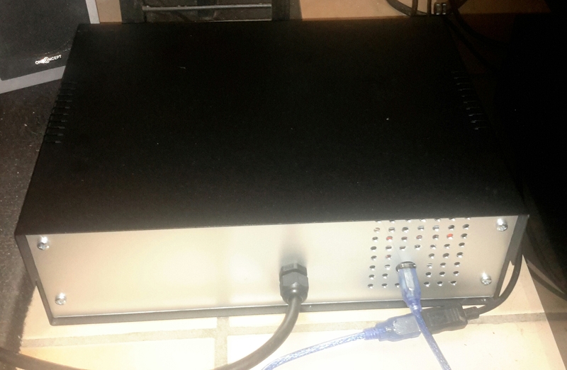

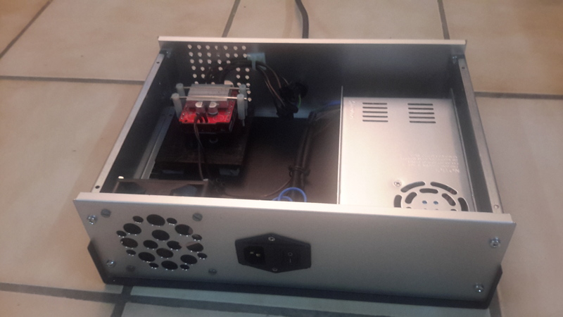

    Look's nice! What is the black box for? behind the fan's...
  17. imagebuff
    imagebuff New Member
    May 17, 2017
    26
    Tomball TX
    269Coins
    +8 / 0 / -0
    Thanks! The black box you see is the cowling for the three iNuke rack mounted amps for the simvibe system

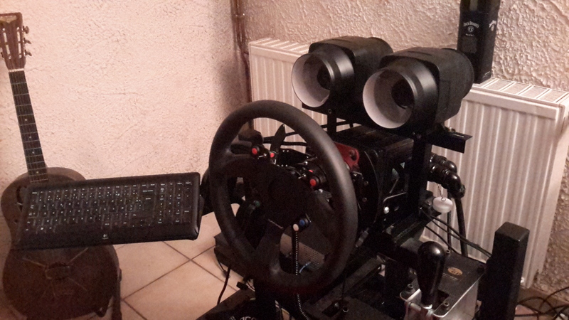

  20. MrJack
    MrJack New Member
    May 1, 2016
    24
    184Coins
    +13 / 0 / -0
    2DOF, SCN5
    Thank you very much for your job and your participation :thumbs Very cool , thanks .. :thumbs
    It's very fun ! This is my new setup .
