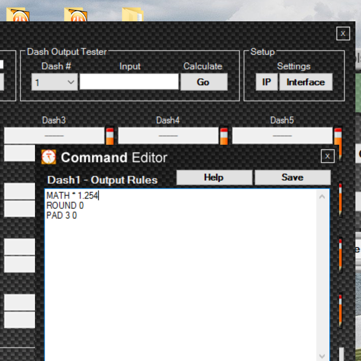

    When I changed the MATH values, I did not touch the values of ROUND and PAD, I left them as I saw in the photos in this thread, I went to intervene only on MATH, so:
    If I change MATH, should I also change ROUND and PAD values?

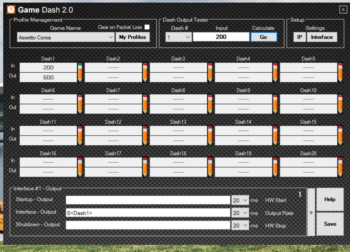

    Talking about Math, i put 200 on output tester:

    I did some tests, tried to put the value of MATH using the comma instead of the point, (1,254 instead 1.254) it seems to work better , the blowers do not start at full speed, but there is always something that does not come back to me.
    I thought it would be possible to vary the working range of the blowers to match their maximum speed with that of the car in use, but it seems to work the other way around.
    I mean:
    for ASSETTO CORSA, if i use a MATH value of 1, the blowers travel one by one with the speed of the car up to 255 km / h, then from 255 onwards remain at the same level, and so far all right, but if I use a car that reaches 320 km / h and set the MATH value of 1.25, (which I find 320/255), the blowers do not reach the maximum speed at 320 km / h, on the contrary , they reach their maximum speed before 255 km / h.
    It seems that to move the maximum blower limit above 255, I have to decrease the value of MATH under 1, not above, for example, if i bring the MATH to 0.5, the blowers start slower and reach the maximum speed well beyond the 300 km / h.

    You have your MATH equations around the wrong way. In that screen shot it looks like you are using MATH * 3 because you are inputting 200 and outputting 600.
    If you used these settings in AC then you would reach maximum fan speed at 85KPH in game.
    The formula you want to use is 255 (Max speed in 8 Bit) divided by desired top speed in game, this will give you your math value that you use in the MATH. I will define the top speed as TS in this equation, and I will define the math value as MV. so it is 255/TS=MV
    So then in the math field you would use MATH * MV based on the results of the previous equation.
    So in your example, if you wanted the blowers to reach top speed at 320KPH then you would do 255/320=0.796875. so round that up to MATH * 0.8 to make it easy for this example.
    So then if you input 320KPH then that gets multiplied by 0.8 so it looks like this. 320KPH in game multiplied by 0.8 equals a value of 256 sent to the Arduino. (320x0.8=256)

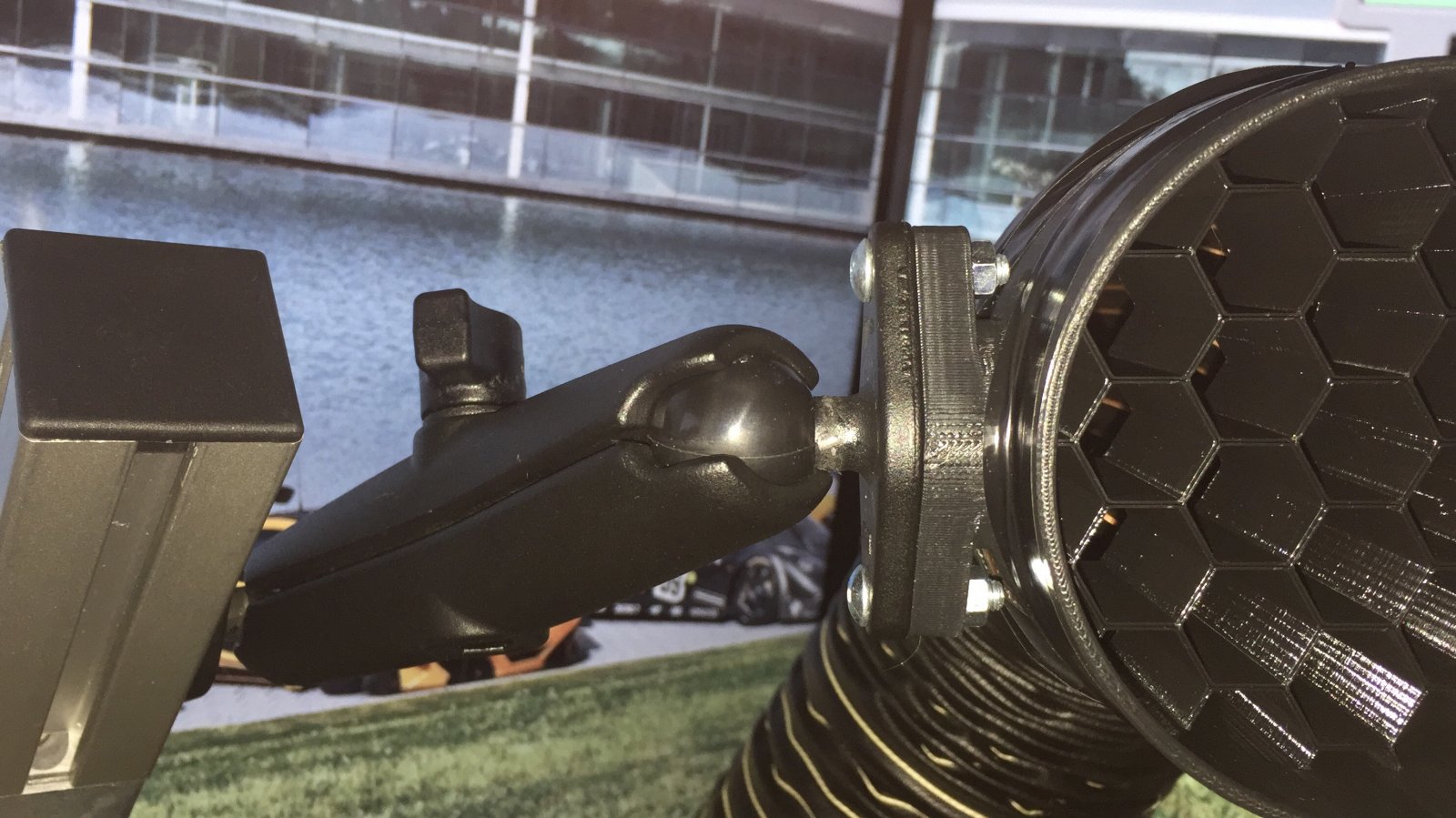

    By the way, yesterday I installed my airflow straightener on the ducts.
    The air has become more powerful and directional. I have to do some tests, however, because before, with the free duct without anything, the air was turbulent and the effect I liked, now it is more orderly and directional, similar to the air conditioning in the car. I do not know what to prefer .....

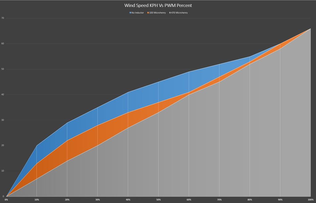

    Yes, you can run them at 8KHz with any wind simulator that has inductors.
    The slower speed isn't actually a problem because it makes the blowers more linear, at full speed they should run the same speed as without inductors, but down low they will run slower with inductors but it gives you a nicer fan curve.
    I plotted it here.
    The blue is with no inductors, the orange is with 100uH inductors and the grey is 470uH inductors.
    Without the inductors you will see the blowers will speed up really quickly down low, but then the fan curve will flatten off and you don't get much difference in the midrange.
    With the inductors you will see that the fan curve is pretty much a dead straight line so it will ramp up perfectly with the speed of the car.
