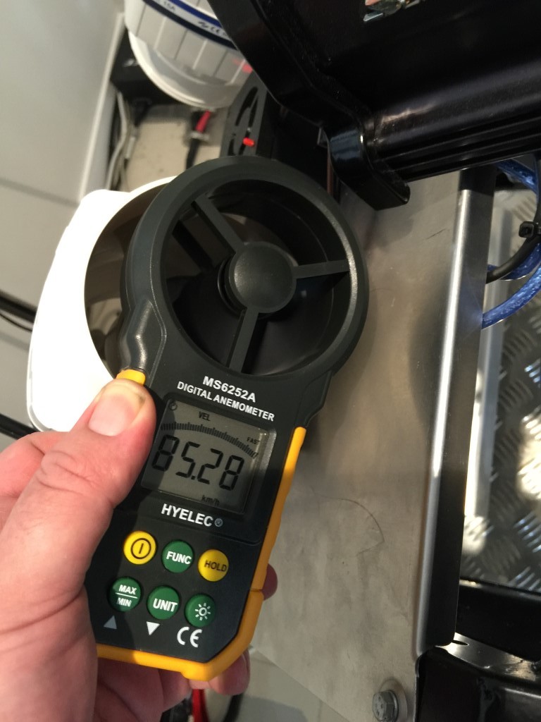

    BTW, did you actually measure the 340CFM? or are you just guessing at that by the percentage increase from 12v to 15v?
    When I tested it with my Anemometer it is not linear. On the TMC blowers I get 80KPH at 12V and 85KPH at 13.8V. That is a 15% increase in voltage but only 6% increase in wind speed.
    So you wouldn't be getting 340CFM, more like around 300CFM because it seems to be about 40-50% of the extra voltage you put in actually gets converted into extra speed. So when you got to 15V you are increasing the voltage 25% and because it is only 40-50% efficient then you are only seeing around a 10% gain.
    It's not a massive deal, my airflow straighteners and velocity stacks add way more speed than the little bump you get from increasing the voltage. The airflow straightener give a massive 60% improvement at 600mm
    This is without the airflow straightener and velocity stacks at 600mm, 28KPH
    And this is with the airflow straighteners and velocity stacks at 600mm, 45KPH
    The PSU's on my wind simulators do have a voltage trim pot and I did think about "Overclocking" them to around 13V but in the end it is not worth it for the small gains you get, you are far better off with the airflow straighteners etc.

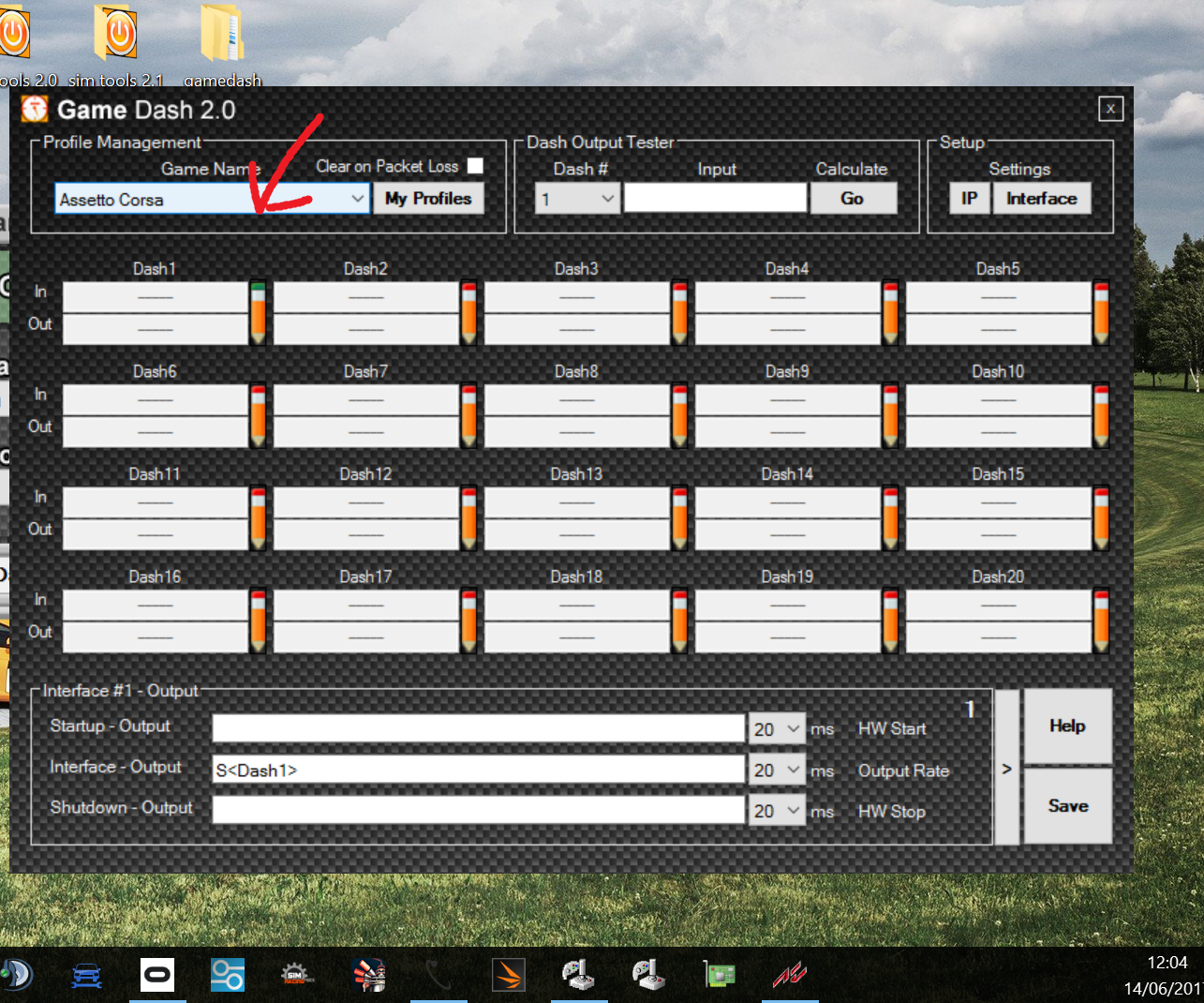

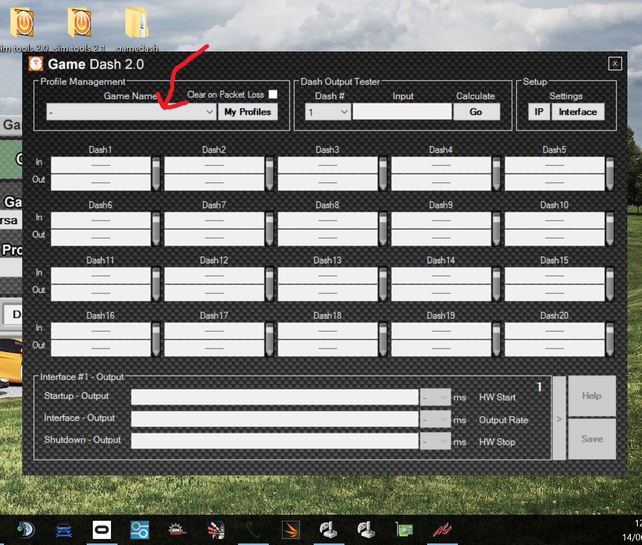

  18. IIISLIDEIII
    IIISLIDEIII New Member
    Jun 4, 2017
    12
    italy
    67Coins
    +7 / 0 / -0
    Every time I leave the track and go back to the main menu (I'm referring to Assetto corsa,I have not tried yet with other games but I think the same thing happens), the gamedash loses its profile:
    Every time you have to go manually inserting it before going back to the track:
    does it happen to you too?
    It's not a big deal, but it would be more convenient if you could avoid it.
  19. Avenga76
    Avenga76 Well-Known Member
    Jun 29, 2014
    518
    Network Engineer
    Auckland, New Zealand
    3,262Coins
    +859 / 6 / -0
    I think I noticed that that other day when I was testing the 8KHz code.
    I didn't think anything of it at the time, I was using No Limits and I think it did the same thing.
    Might be a game dash bug.
