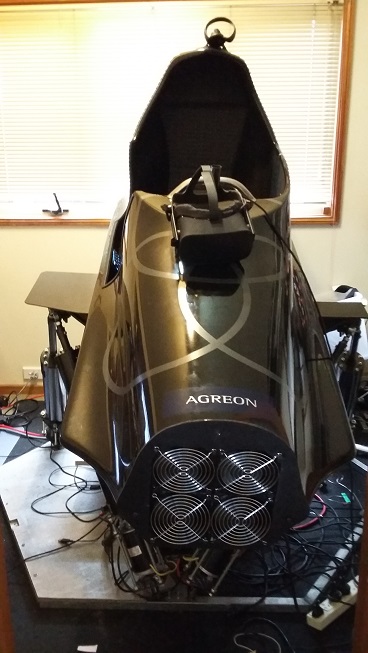

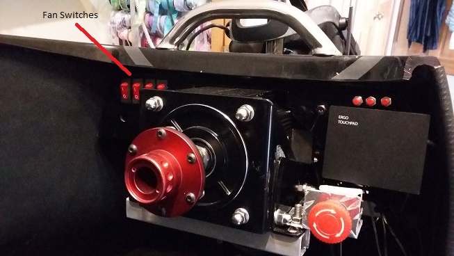

    With 12VDC, you will likely get a jolt if you put your tongue across the source, but normally you will get nothing. As the voltage rises to around 50VDC you will certainly feel it (ring tone). This artical may help.. https://www.electronicproducts.com/..._human_body_AC_or_DC_current_and_voltage.aspx Basically your quite safe with 12vDC :). On topic, I actually have 4 x 120mm 240VAC fans in my new sim - They work great being quiet and powerful. I am a Qualified Electrician - although sometimes misread posts :rolleyes:. I decided just to control them by four switches in the sims . I find this works OK and importantly keeps me cool.

    I used the 240v fans only after testing lots of different fans including 12VDC. The AC fans pushed the most air and were noticeably quieter in operation - Maybe its just me, but I hate noisy fans - decision made and I know what I am doing with AC power. I was never going to go to the trouble of controlling them via other means except switches - they are mainly for cooling and when I want them on, I want them to stay on as it can get darn hot in my sim room in Australia :) . But they do help with immersion even as they are. What I'm tying to say is any fan will help with immersion, even it is not controlled.

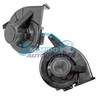

    At 12v you can use the fan of the cabin of any car, usually they have the shape of a conch, I tried one and had a maximum consumption of more than 20 amps, it is amazing the air that is at maximum.
    A 12v puedes usar el ventilador del habitaculo de cualquier coche, normalmente tienen forma de caracola, yo probé uno y tenía un consumo al maximo de mas de 20 amperios, es alucinante el aire que echa al maximo.

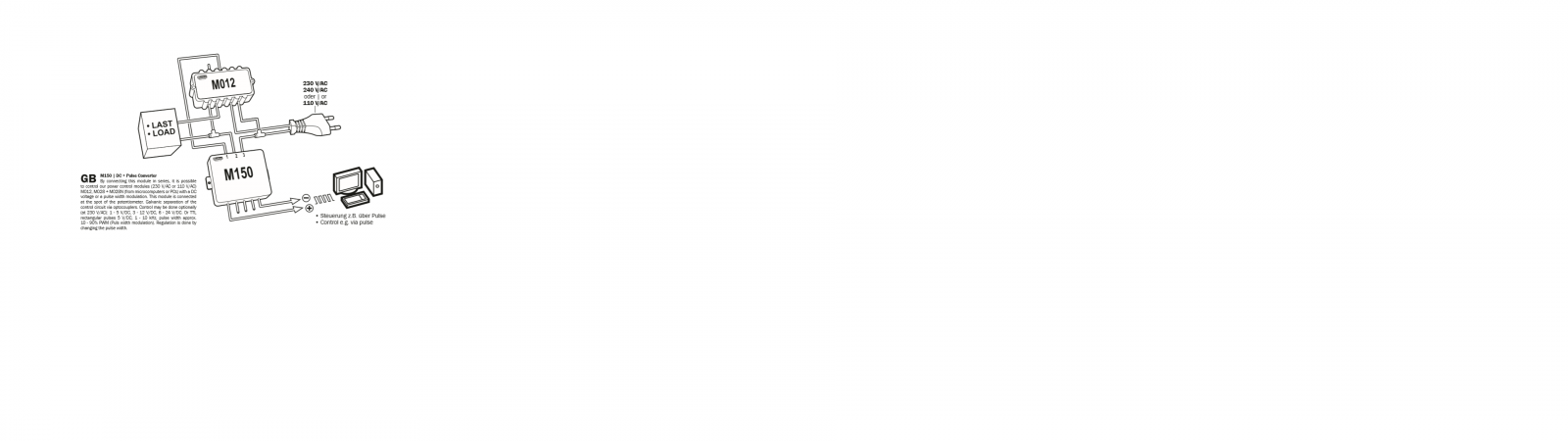

    I bought this module M012 to control my fan 120 v ac , but i think i need this module M150 to control 1-5 volt DC with Arduino uno to control M012 .
    What did you do finaly ?

    Finally I used a 24v motor because of the simplest way to go.

    I use this way because at my work I had a couple of those fans 120v for free $ but with the control it realy more expensive !!!
    For the moment, I have a single switch on my dash ( rig) where i can put on /off to eliminate some fogging in my VR headset !
