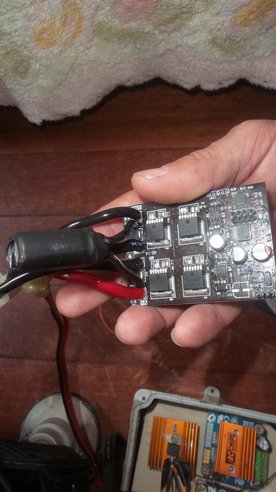

    Good evening @RufusDufus here is the end result of a more Arduino simulator mounted with Simtools more SMC3 with Chinese H bridge!
    Although I have not had much success with Chinese plates.:(
    Chinese card does not support this type of weight motore.
    I need to use a Brazilian board, Blackmoon - DC Motor Controller
    But my Arduino code, SMC3 is not compatible with this board would be grateful if someone would write a new code to use this new card that was produced in Brazil.:sos http://www.gotronics.com.br/products/blackmoon/ @RufusDufus

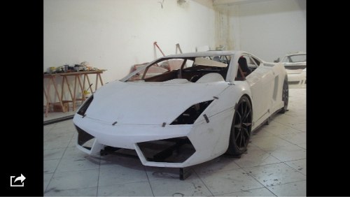

    Good Morning ! @ I am reopening this post because I am intent on making a Gallardo lamborghini in real-scale fiber.
    And I'll use 4 engines in this car instead of the shock absorbers.
    My Question is as follows!
    I am using an Arduino R3 with code SMC3 with placaca Driver BTS7970 Chinese, but the SMC3 code has only 3 axes.
    Can I use two Arduinos with code SMC3 to build my simulator?
    The intention is an arduino command 2 front axles and the second arduino to move the 2 rear axles.
    If this is not possible could it include 1 more axis in the SMC3 code?
    Because the SMC3 code contains only 3 axes.

    You could just use 2 Arduinos, they are readily available and pretty cheap.

    I use an arduino in the sim tools Game Engine interface 1 and the second arduino in interface 2 it?
  15. noorbeast
    22,048
    153,884Coins
    +11,154 / 57 / -2
    Yes you just configure each arduino in the interface settings, members like @SilentChill are doing it that way to use the SMC code to control 6DOF rigs.
