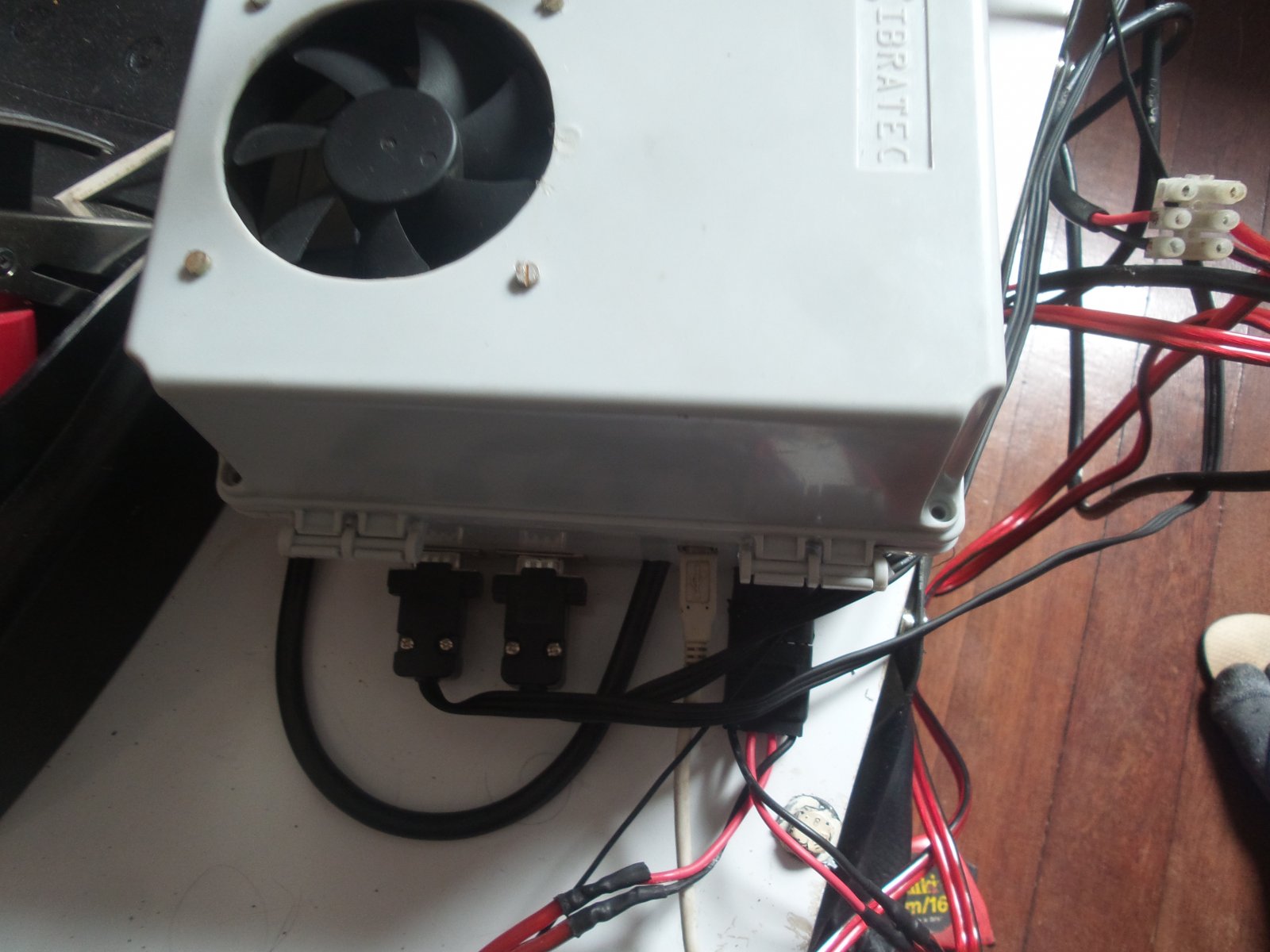

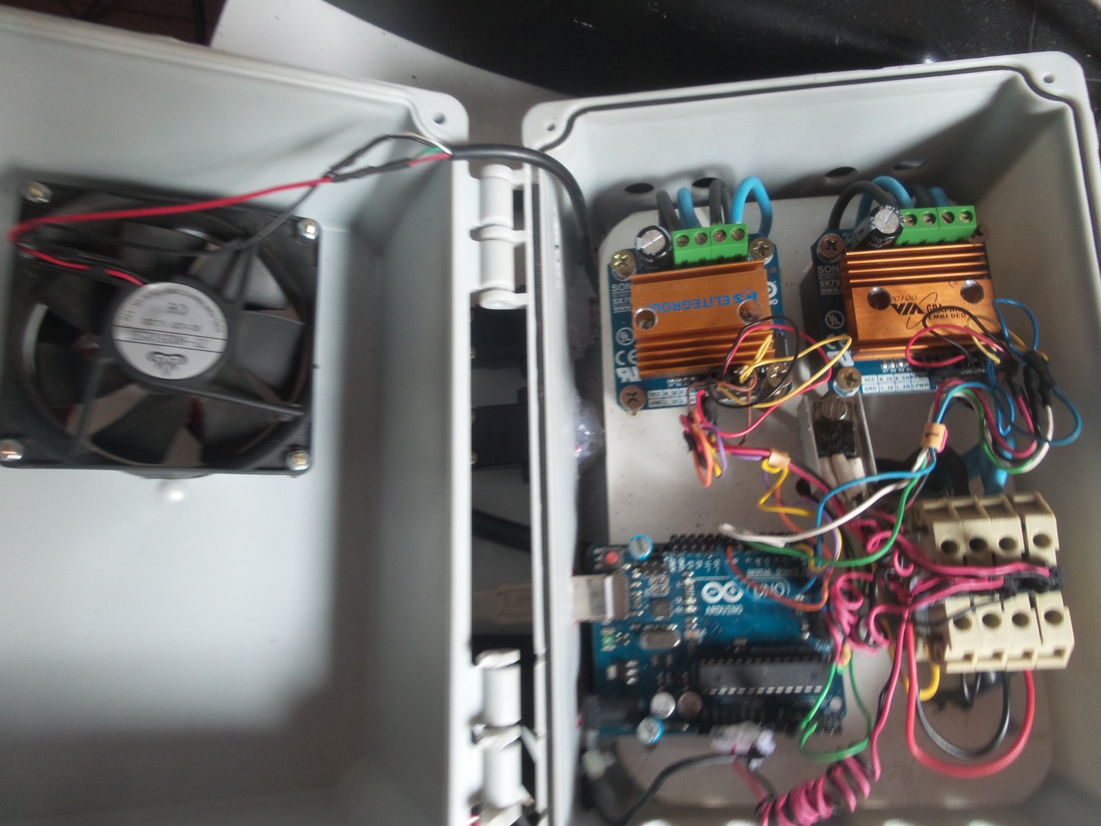

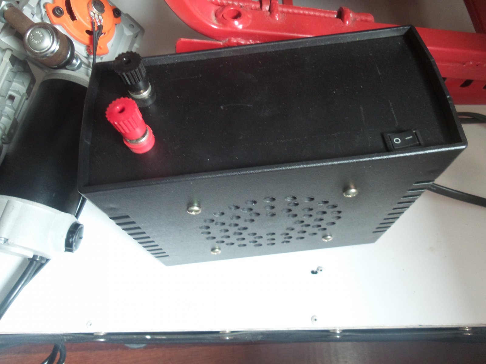

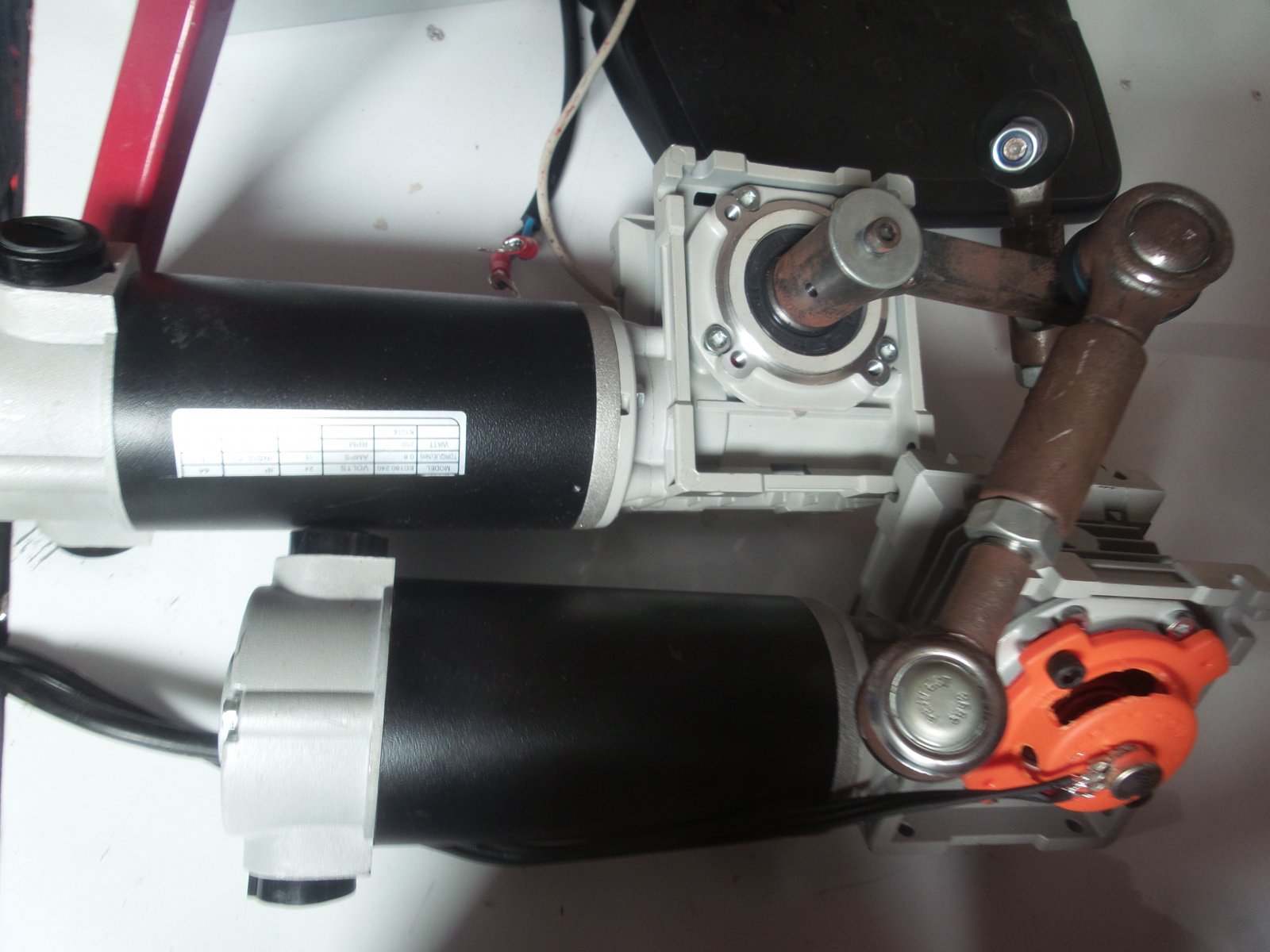

    Thanks for the quick response! ;)
    I did the tests with the multimeter and has no contact with the motor hull.:sos
    I will send photos of my equipment.:)
    20150216_125009.jpg 20150216_125018.jpg 20150216_125028.jpg 20150216_125037.jpg

    have you tried to power on your electronics with no motors connected to see what happens?
    if it works ok try connecting one motor at time. if not try another power supply at 12V without motors connected again.

    When I turn on the plates only works!
    But when you connect the source to the motor does not work.
    I have 2 sources of 50A 24V, 4 engines of this that in the photo.
    I've only had all the components even the Arduino.
    Also changed the H bridge to see what was happening and nothing!
    did not fail to test the connected source without running the engine and ran everything, but when I turn on the engines and the SMC3 GameEgine works for about 2 seconds or less and giving the message that something caused the GameEgine stop working !

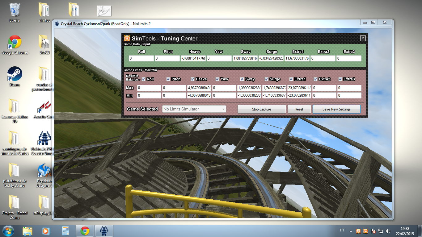

    how do I get the platform movements is smooth?
    My engines are 24v 250wts Reduction 1/25.
    The movements are very sharp especially in NoLimits game.

    Ok at a guess you need to tune the Min and Max in the Tuning centre.
    20,557
    145,160Coins
    +10,780 / 52 / -2
    Can you please post pictures of your Settings and Tuning Center in the SimTools Game Engine.

    is how you give me a hint on how to set the Tuning center?
    how do I save? did not quite understand this part!
    • Optimistic Optimistic x 1
    20,557
    145,160Coins
    +10,780 / 52 / -2
    The basic info for Tuning Center settings is here: http://www.xsimulator.net/tuning-centre/
    Keep in mind that the Tuning Center is working with whatever % you set in the SimTools Game Engine.
    Increasing the Min/Max numbers will slow how fast the rig reacts for that force and decreasing them in value makes the rig respond quicker. By unchecking the tick you can set the Min/Max at different values, which is useful for simulating things like gear shift.
    So you can increase the numbers for whatever force feels too sharp, Sway, Surge or Heave.
    The simplistic approach is pause the game, follow the steps 1-6 in the link, test it, then tweak individual axis settings one by one. However the best approach is to set the % and tweak each axis settings one by one.
