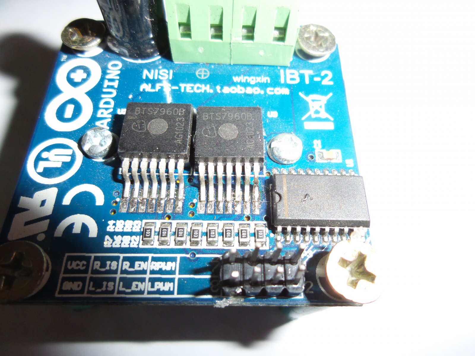

    Boa tarde!
    Eu estou usando o Arduino R3 com o H Ponte BTS 7960.

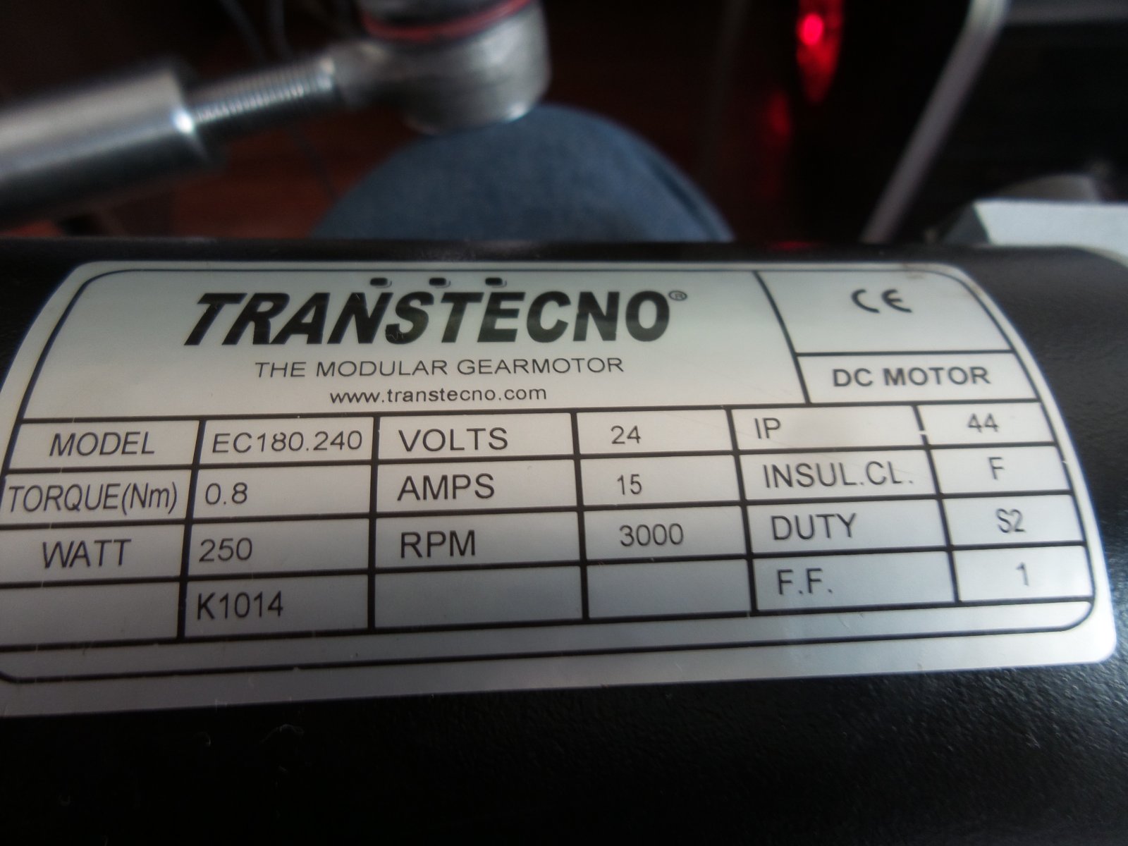

    Estou usando 250wts 24v motores 15A.
    O código que estou usando é o que mostrou ufusDufus me. http://www.xsimulator.net/community...3dof-motor-driver-and-windows-utilities.4957/
    O problema é que quando se aumenta a potência do motor por SMC3 a ponte H esquenta e funcionando!
    Gostaria de saber qual H Ponte poderia estar usando para motor com grande amperagem!
    Vou postar uma foto do motor que eu quero usar.
  3. bsft
    do you have heatsinks on the big chips or some fan cooling on the h-bridge?
    Otherwise, as on SMC thread.

    Thanks for the rapid responses! @bsft
    Is bridge has a large sink beneath them!
    So I'll have to put a heatsink on the right BTS70760?
    Between the BTS and the sink have to put some thermal paste as well?
  5. bsft
    Photo please

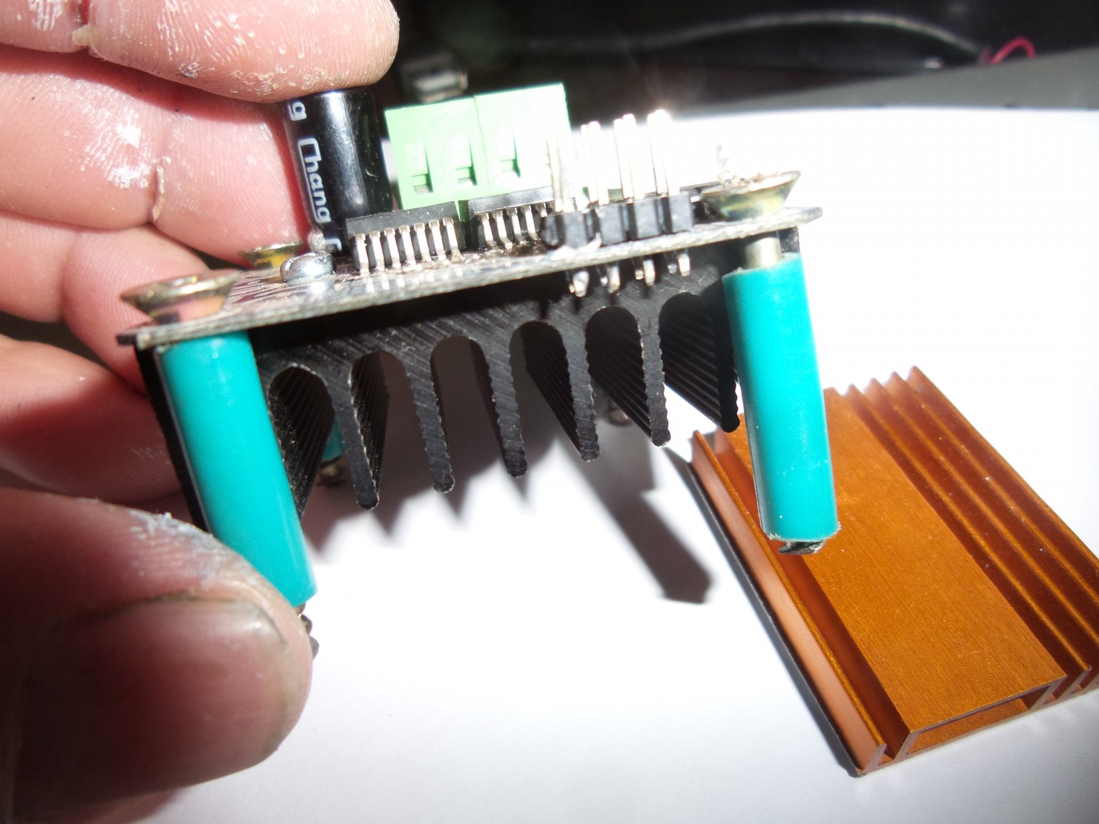

    [QUOTE = "BSFT, post: 65,841, Membro: 4876"] Foto por favor [/ QUOTE]
    esta é a ponte H eu estou usando! 20141206_225107[1].jpg 20141206_225156[1].jpg 20141206_225107[1].jpg
  7. bsft
    oh , ok then , there is a heatsink on the bottom. Maybe try raising the board up higher and get a stronger fan to try to cool it.

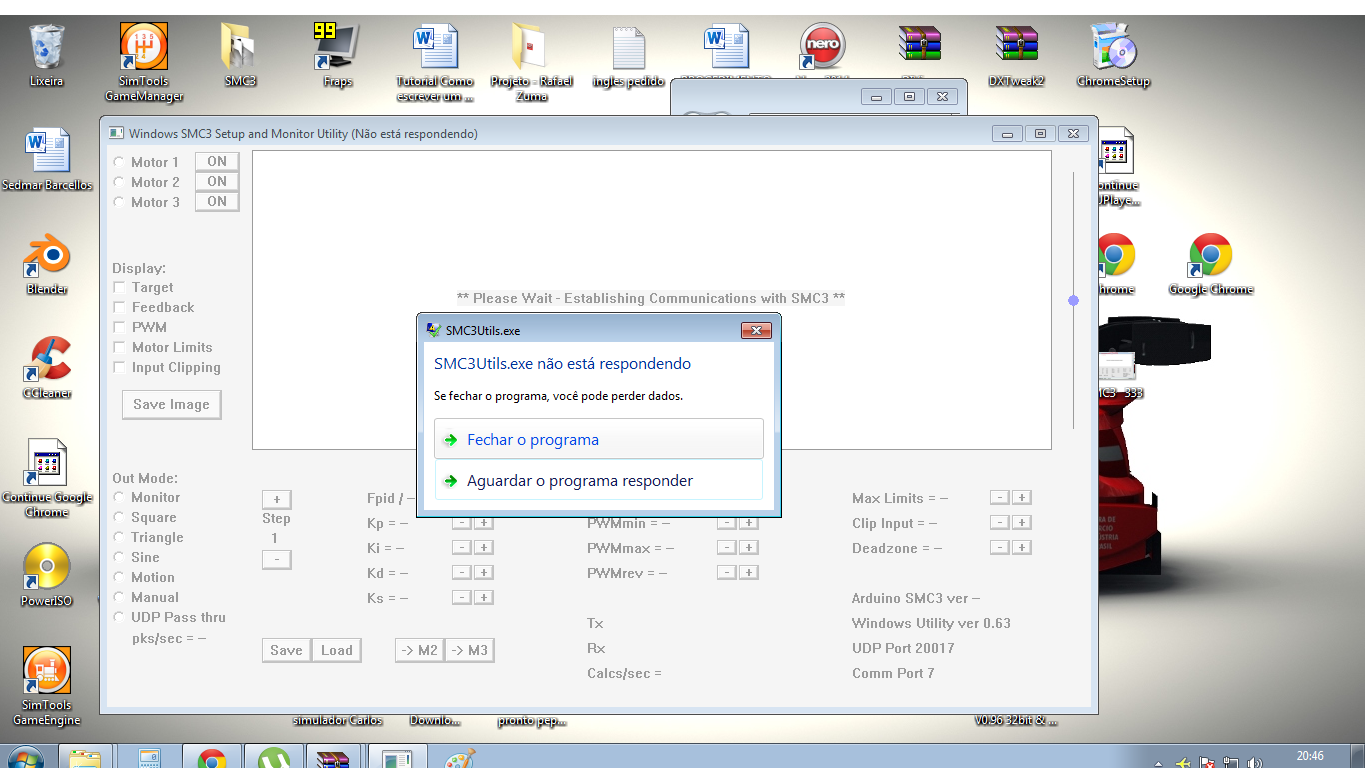

    Good evening! @bsft @eaorobbie @RufusDufus
    Personal'm having an error with the GameEgine.
    (GameEgine Error stopped working) then the GameEngine closes.
    It works normally for a short periudo and.
    To back up and running have to remove the USB cable and reconnect Arduino again and reopen the gameEgine!
    You know how I can fix this?
  9. Pit
    3,007
    30,499Coins
    +3,097 / 31 / -0
    @Claudemir : did you do something especially before SimTools stops working? Which Arduino code are you using?

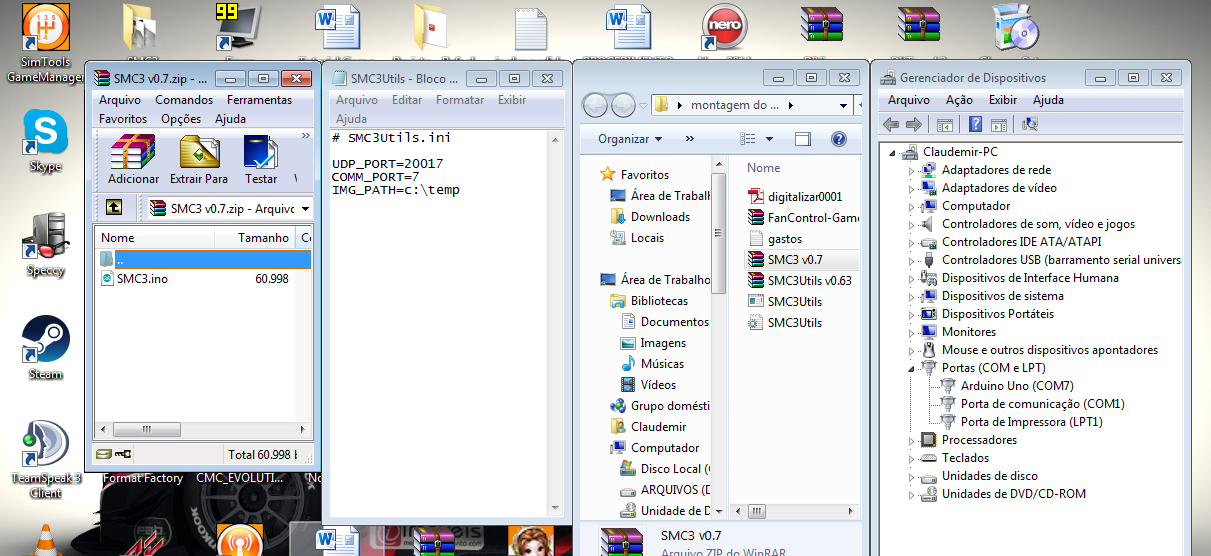

    @Pit
    I'm using the SMC3 v0.7 with SMC3Utilsv0,63.
    Arduino R3 MODE2 24v engines.
    image of the following errors below! configuração arduino.png configuração arduino.png erro SMC3.png

  13. Pit
    3,007
    30,499Coins
    +3,097 / 31 / -0
    First please use only smc 0.63 code and utility. Second your smc settings are very extreme, Fpid 10 instead of 1 or 2, kp 815? Or it is 315? If 815 it is way too much. ks, ki, kd - do you need such high values? Are you sure what you are doing? And Pwmmax and min, same values here makes no sense.
    PS: please check the com port baud rate, too.
