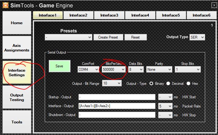

    It looks like you missed the change to baud rate that was made in v0.6 and above. SMC3 now runs at 500k baud. If you set Simtools to 500k baud then the game engine should connect to the Arduino. (Make sure you shutdown windows SMC3utils first as only one program can use the comm port at a time)
    I see in one of the screenshots you are trying to use UDP pass thru mode....
    Please note: Simtools can control the Arduino either directly via the comm port (normal setup) OR indirectly via SMC3Utils using a Network UDP port (UDP pass Thru) - this is because only one program can use the comm port at a time.
    To use UDP mode you have to disable the comm port in Simtools and setup a Network UDP interface instead.

    how to set Simtools to 500k transmission?

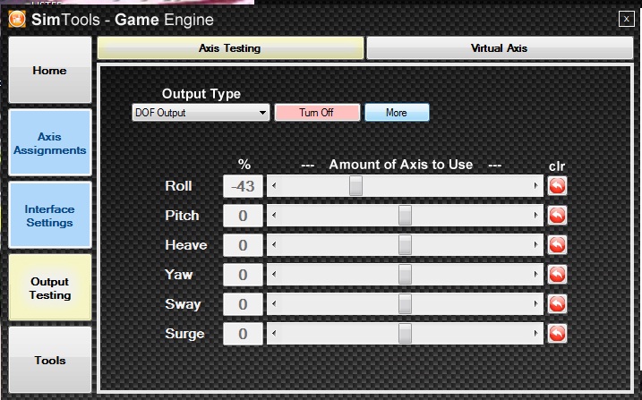

    Apply to transmission over 500k is not safe!
    When I open the Simtools applicable to Bits blank.
    And also in (Amount of Axis To Use) engines begin to move starting from 43%! and have as few movements in roll and pitch. why?

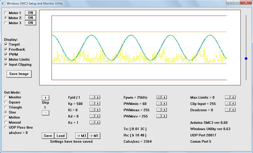

    Don't you have an option for 500000 baud? I think it was added to one of the more recent versions of Simtools, are you running the latest version?
    From the chart it looks like you have the PID tuned up quite well.

    Version 1.1 will give you access to these higher baud rates.

    Yes 500000 contains the option to apply but does not get saved!

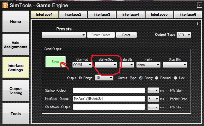

    yeah I'm with simtools version 1.1!
    50000 braud apply but is not saved.
    When I close and open again the game engine the brand is no longer with the value applied to it.
    It's not like I'm saved!

    Ok just tested mine and changed the baud rate to 500000 saved , and exited the game engine totally, and reloaded it and presto the baud rate was blank.
    Could someone else please confirm this too. You might have a bug that you can report to Yobuddy, bugger.

  11. yobuddy
    5,446
    51,259Coins
    +5,192 / 19 / -0
    I can confirm the problem and will fix it later today!

  12. yobuddy
    5,446
    51,259Coins
    +5,192 / 19 / -0
    Error fixed! Will be in next release!
    Nice bug find! @Claudemir
    What was the problem?
    The combobox contained "500000 " with a space.
    It saved as "500000" without the space.
    It then could not match "500000" to "500000 " because of the space.
    Space Removed!

    As a final note, I think you may get smoother motion if you increase PWMmax a bit with Windows SMC3Utils. Also reduce the deadzone setting as much as you can.
