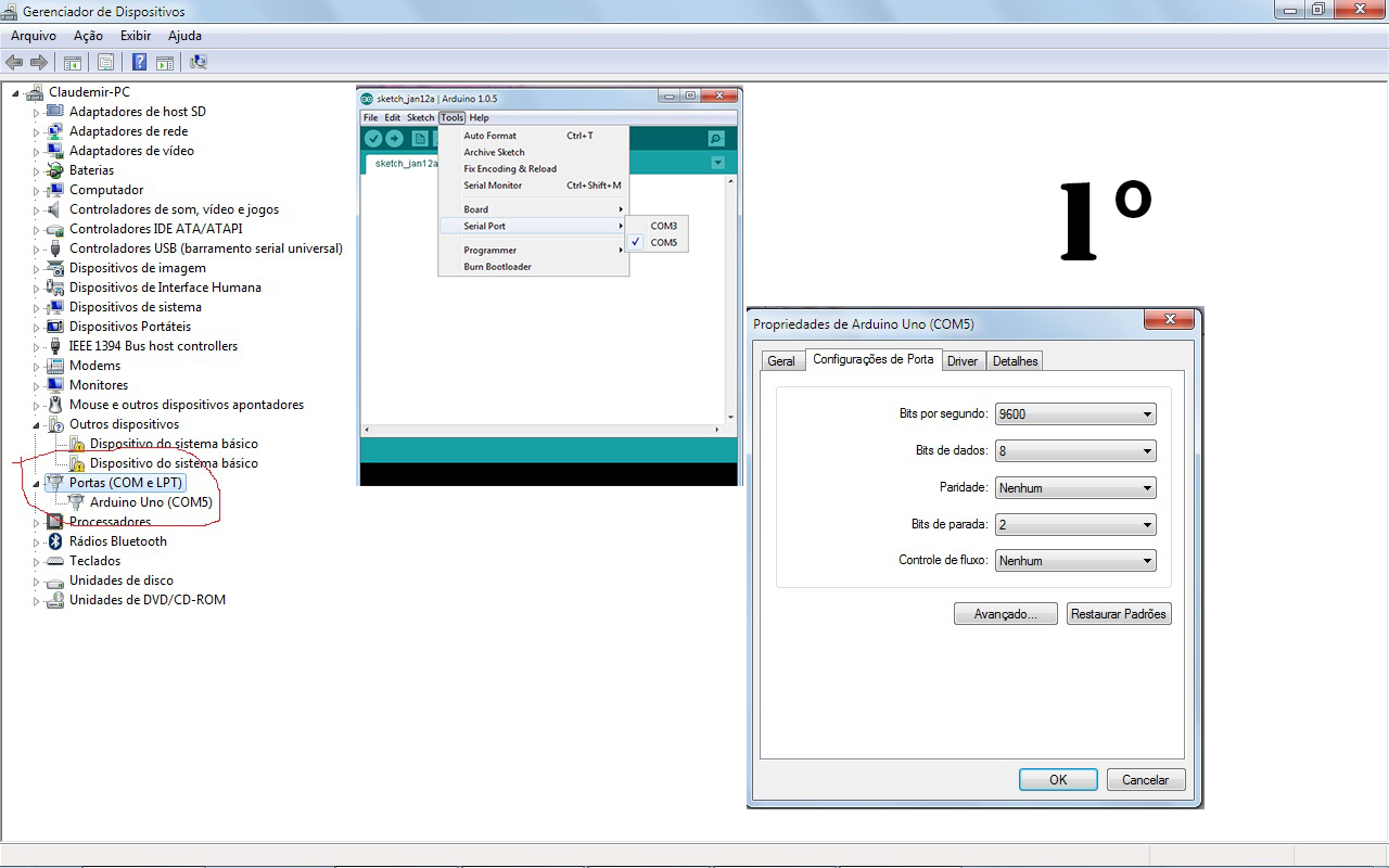

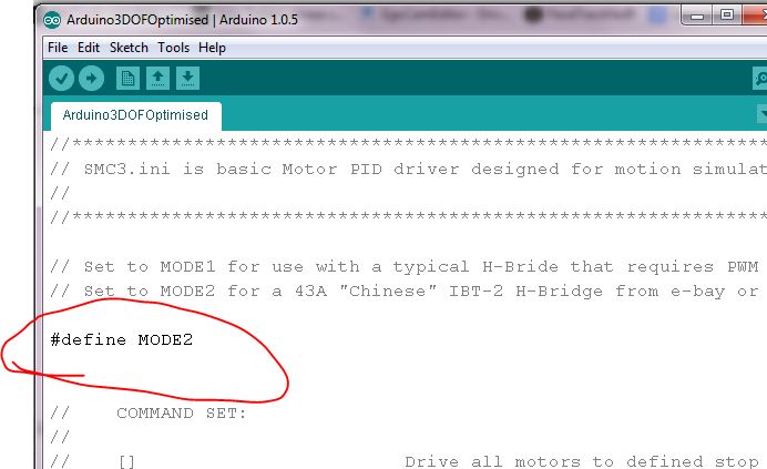

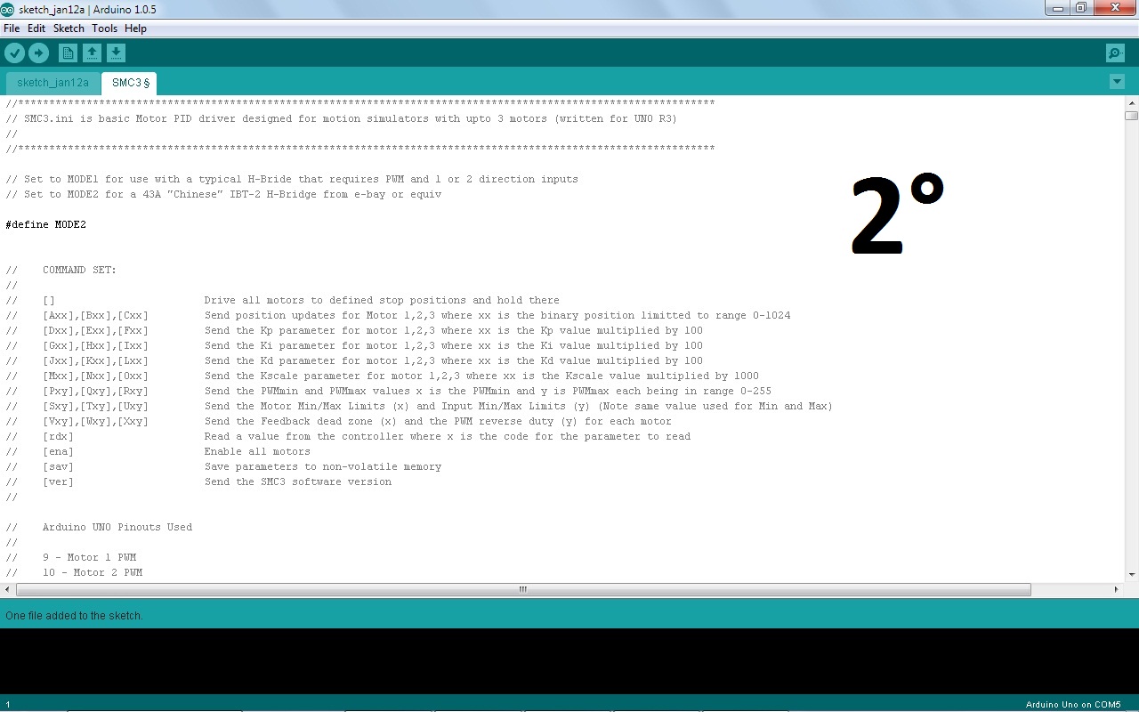

    how do I switch to IDE mode 2 in SMC3 setup?
    did istalaçao of fois alright! could not do more to move the engines yet! do not know if I chose the right way! Any tutorial for this, I do not know how to change the IDE!

    Edit the code at the top to say MODE2 (no space) as in picture below before you upload to the arduino.

    168
    23Coins
    +33 / 1 / -0
    OK!
    Unable to move the cattle engines.

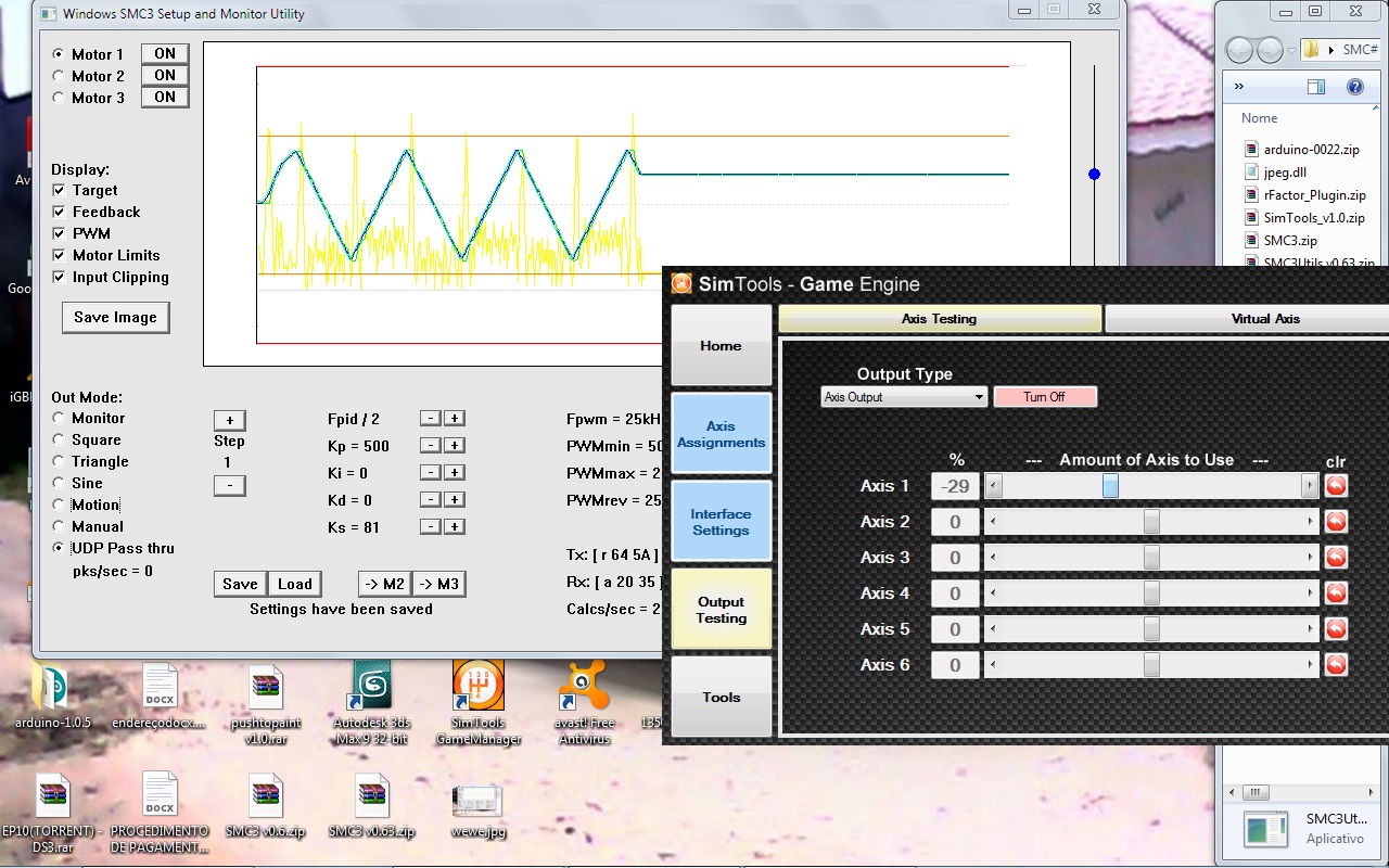

    Start 1 step at a time, and let me know where you get to.
    Step A: Shut down Simtools both Game Engine and Game Manager
    Step B: Program the Arduino (don't worry about wiring up H-Bridges and feedback pots yet)
    Step C: Run Windows SMC3 Utils on the same machine as you have programmed the Arduino. Check that it starts up and doesn't report any communications errors
    Step D: You should now see the chart being updated on screen, select square wave or triangle wave and the blue line should change
    Step E: Disconnect the Arduino from power/computer and connect the feedback pot if not already done
    Step F: Reconnect Arduino to computer and run Windows SMC3 Utils again - now you should be able to turn the pot and the green line will change on the chart
    Step G: Disconnect the Arduino from power/computer and connect the H-Bridge and motors and motor power (if you can find a toy motor and 9V battery that is a good safe test at this stage)
    Step H: Reconnect Arduino to computer and run Windows SMC3 Utils again.
    Step I: You now have to get some useful parameters setup, as a start try Kp=400, Ki=0, Kd=0, PWMmin=0, PWMmax=150
    Step J: Now when you turn the feedback pot from one extreme to the other the motor should slow down, stop/change direction, and speed up again.
    If you can get to this point then you are ready to put the motors and feedback pot on the sim and configure that... Follow the steps below:
    8. Set Kp to about 400
    10. Do the above for each motor
    Now you are ready to get Simtools setup. *** Make sure Windows SMC3 Utility is not running while you are trying to use Simtools ***

    Hi Claudemir, That's great, sounds like you have the motors working?

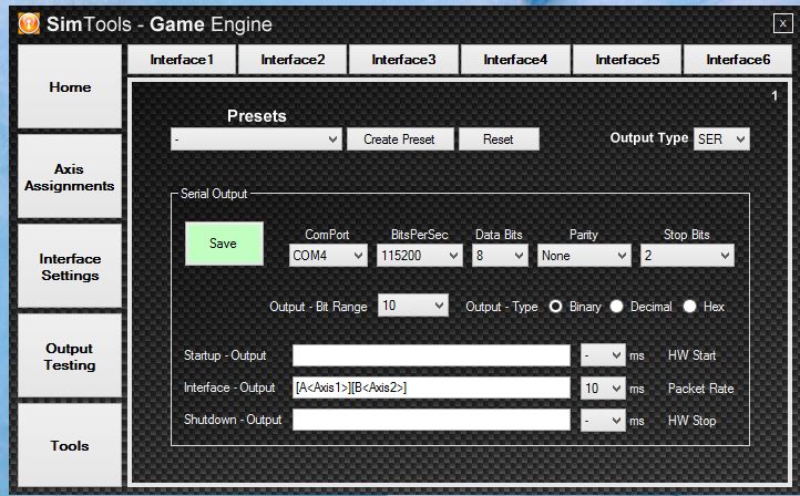

    To get simtools setup with the SMC3 you need the following in the Interface Settings: (Typically the Interface 1 tab but any will do)
    The Interface output string is: [A<Axis1>][B<Axis2>]
    If you have three motors use: [A<Axis1>][B<Axis2>][C<Axis3>]
    No spaces anywhere.

    Hello all right? good today did the testing of engines with pots when turning the potentiometer can manually control the direction of them and also keep them stationary, this indicates that the motors are connected correctly right? al plugged the arduino simtools installed on your computer and applied the settings that u gave me the GAME ENGINE like this here in the photo, I will do more when output test nothing happens or an engine moves! what to do you have a complete setup sim tools that I can use? I do not know anything about programming thanks!
  9. Claudemir
    Oct 22, 2012
    168
    23Coins
    +33 / 1 / -0
    Hello could make the motors move with the sim tools
    My mistake was deichado Egine space on the Game setting. But now it's running to see the video!

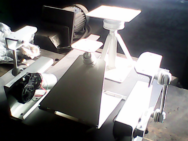

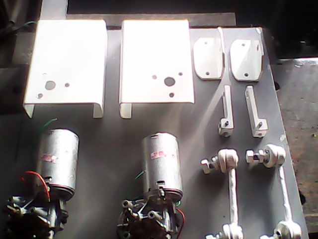

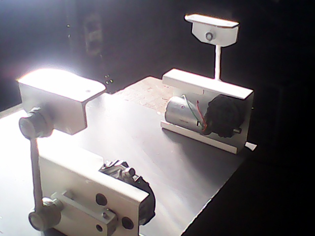

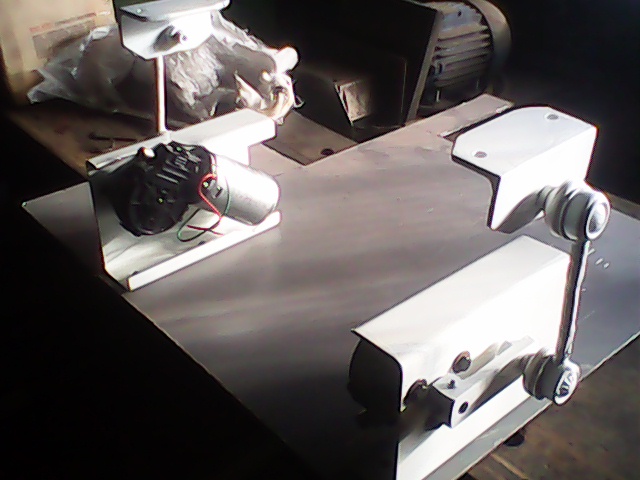

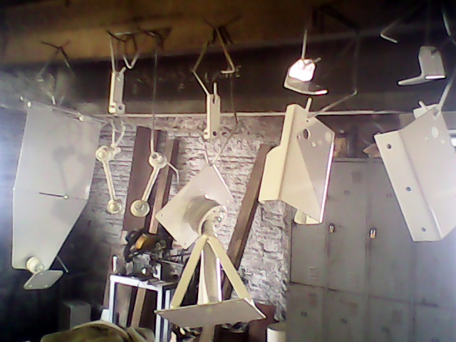

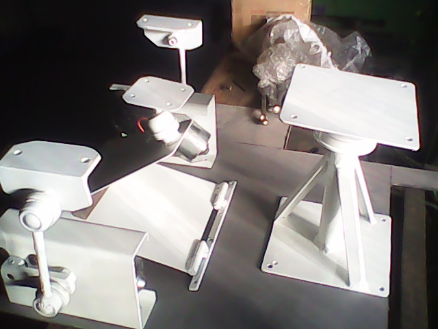

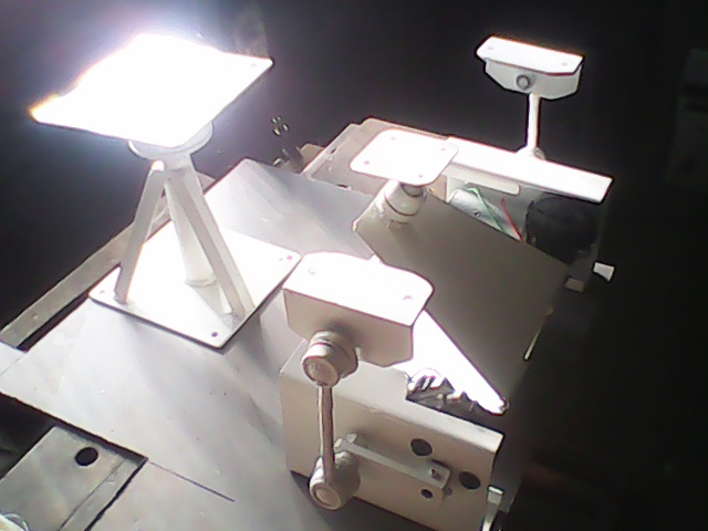

    New Photos of mechanics is already ready.

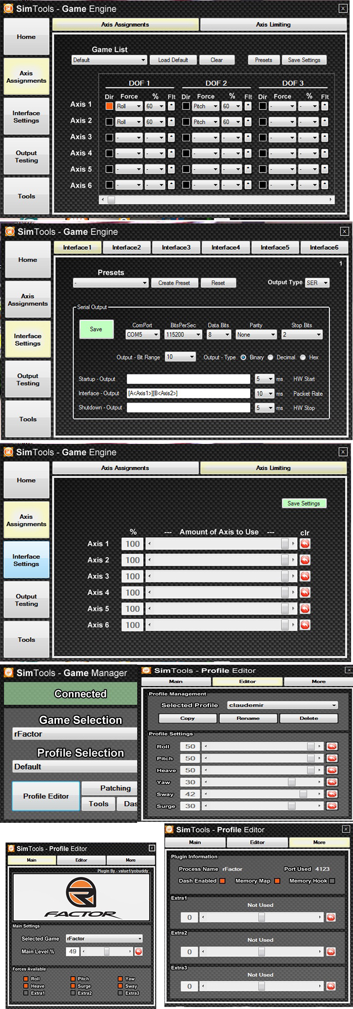

    20,488Coins
    +1,687 / 23 / -2
    Your video show the motors and not moving at the same speeds or at the same time as is needed for a true pitch or roll movement which will lead to bad motion cues, be nice to see the whole rig move with you on it.
  15. Claudemir
    Oct 22, 2012
    168
    23Coins
    +33 / 1 / -0
    yes but the question is, which of to realize that when I put the game to run with the controls are delayed exp: it accelerates the arms of the motors should move up and the brake should move up and down but it does not !
  16. Claudemir
    Oct 22, 2012
    168
    23Coins
    +33 / 1 / -0
    Because the game engine does not simulate the Heave, Yaw, Sway and Surge?
    The Roll and Pitch are working!
  17. RufusDufus
    RufusDufus Well-Known Member
    Jul 21, 2013
    681
    Adelaide Australia
    16,314Coins
    +1,016 / 10 / -1

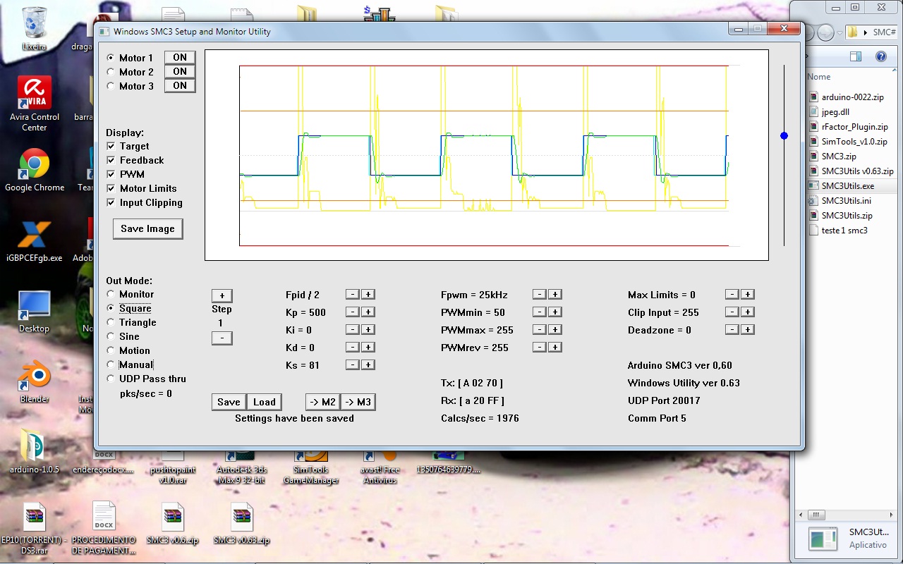

    Hi Claudemir, what game are you using? As far as I am aware all Simtools plugins have the 6 basic DOFs: yaw, pitch, roll, heave, surge, sway.
    As for the motors not responding too well, my guess is either the values in the Simtools tuning center are not right yet, or you haven't got the PID parameters in the Arduino motor controller right yet.
    Are you still using the Arduino SMC3 motor controller? If so use SMC3utils to setup the parameters for the motor so they run smoothly with that first - you can output test signals to try. Values of say Kp=500, Ki=0, Kd=0, PWMmin=50, PWMmax=200 are probably good starting points.
    If you post screenshots of the Simtools Interface Setup tab, Tuning Parameters, and SMC3utils parameters, etc we may be able to spot anything that doesn't look right.

    Yes you need to use SMC3utils to setup the motor parameters for best performance.
    The setup steps I gave in post #46 are just cautious settings to make sure nothing gets broken while setting up. Once you are happy with the setup you then need to adjust the parameters for best operation. Looking at your video you are ready for this step.
    I would suggest stopping Simtools and running SMC3utils again and changing the controller parameters. Select the "Sine Wave" output and adjust the settings until the motors move well. Try the values in post #59.

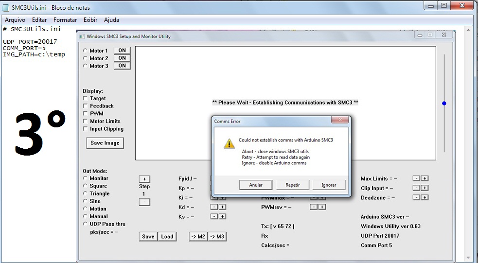

    OlaRufusDufus
    I'm posting this with the settings
    Because SMC3Utils does not respond?
    I edited the notepad but nothing happens.
    With the new 0.6-SMC3 will not communicate with the game engine!
    What did I do?
