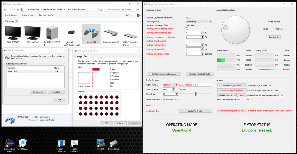

    And finally, here is the bloody update. Gawd, let's hope this one goes through.
  13. Nick Moxley
    17,057Coins
    +2,507 / 30 / -2
    Sweeeet, I see the Axis and stuff is coming along nicely.
    Thanks for sharing. :cheers
  14. mrbean_phillip
    mrbean_phillip New Member
    Nov 19, 2013
    16
    546Coins
    +23 / 0 / -0
    Cheers Nick, no dramas.
    Yes, all the analog inputs are working fine now, Mika is currently busy coding the auto-configuration stuff for the servo setup. So very good progress.
    The filters will follow towards the middle to the end of next week, thereafter smooth sailing to do debouncing code for the binary inputs.
    Almost there, I will keep you guys posted.

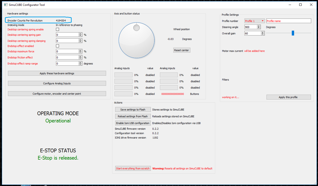

    I will leave these screenshots here for now.
    History in the making. Look at the encoder selection and the associated resolution in the GUI. ;)
    I couldn't drive with the AKM53G/ BiSS today though, as the servo uses NEMA mounting it seems. I have a bracket that I will probably modify tomorrow. Will give it a good go then.
    I have, however, been murdering the Moocedes around SPA today, got a good few hours in on the alpha Mika sent yesterday. Was running with the other servo I got off Davy Watts last time, the AKM53K with the 40k encoder. No issues whatsoever, tracking stayed true and accurate, even though I tried to induce weird behaviour. Even at max current and torque, it performed flawlessly.
    New IONI fw has a few neat new and enhanced features, and it compliments the OS FW of the Simucube very, very well.
    Considering it is alpha, I have to be honest and say, even this early, I find it outperforms MMoS in terms of latency, as well as improved feel and response. Of course, the AKM53k is a superb servo also, and I luv that I can hit it hard with friction, inertia and damping, changing the complete ffb behaviour, but still retaining huge amounts of fidelity.
    This all without Tero's new special ffb filter - woooo.....good times coming.
    More feedback later, I will do a few more hours testing tonight, but I suspect the base fw is very solid at this point. GUI also working seamlessly with the Simucube fw now, seems Mika has squashed all the bugs I had earlier.
    Laters, have a great one!
    PS: I think next weekend, I will wire up the MiGe with an extra SinCos encoder I have. Will be a pretty radical combo that too, what was it, 1M CPR if memory serves :)
    Beano

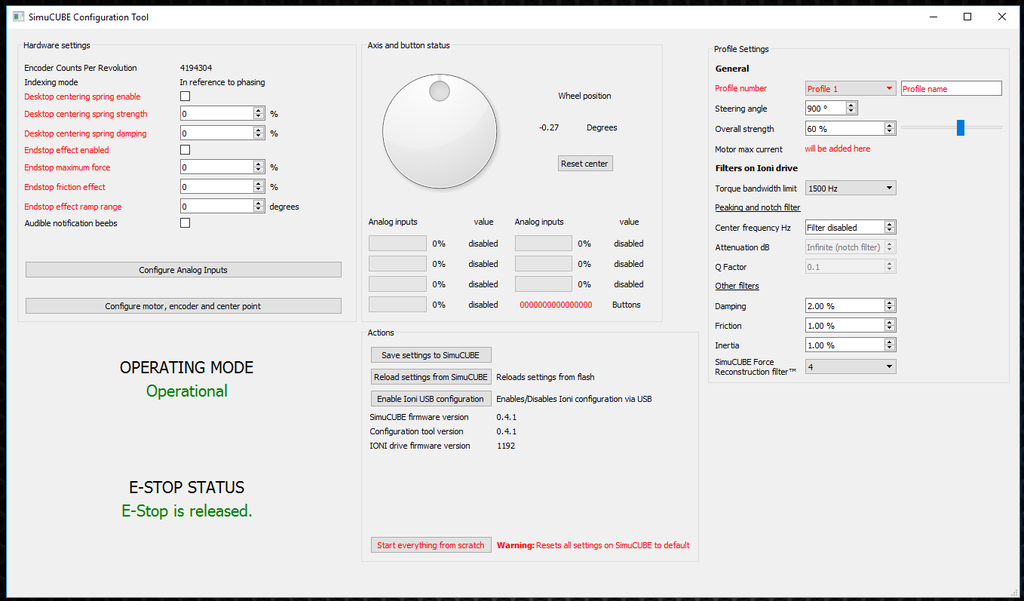

    It's happening :)
    1st Closed Beta 0.4.1
    It is quite common on this forum to find those that doesn't believe in the contribution a good wheel can make.
    Let me show you the consistency you can have with a low-latency input device, with quality FFB - in the below screenshot, I am doing groups of 4 laps each (1 outlap/3 hotlaps) testing in the Moocedes around SPA.
    I am running around 20NM torque here, weather was at 24deg C track temp.
    Consistency through the roof. The slight variance between the different groups, eas me playing with the rear toe to stabilize the back due to a very loose oversteer on/off throttle set I developed.
    I will just leave this here. Please note I am no alien, just an old fart with poor eyesight ;)
