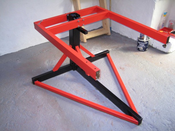

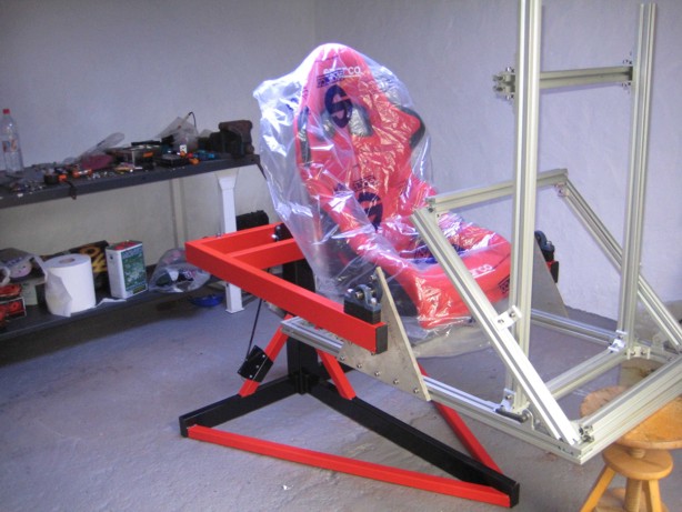

    Hi

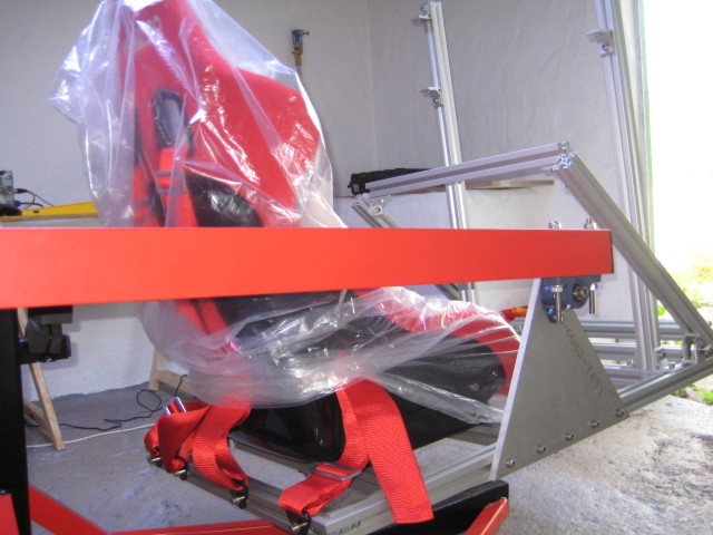

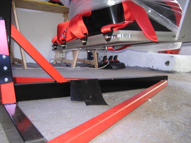

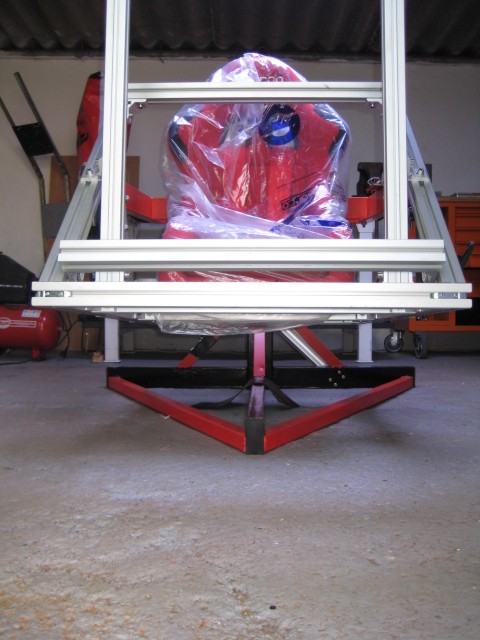

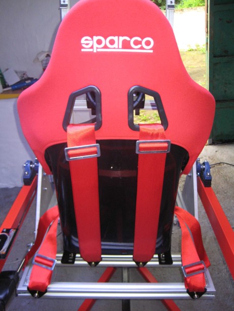

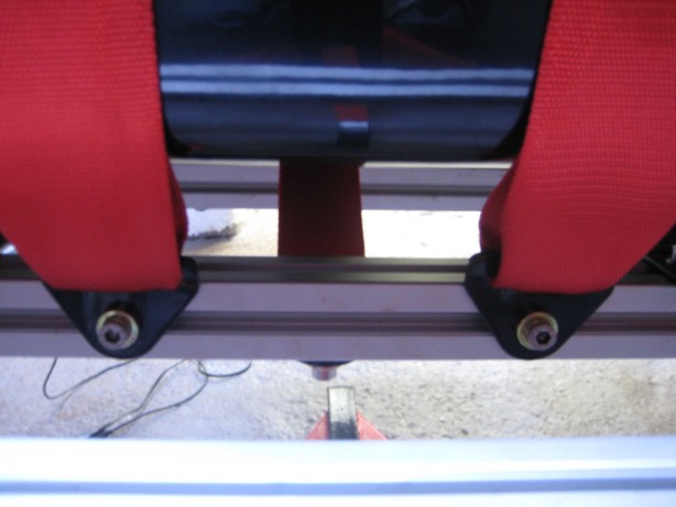

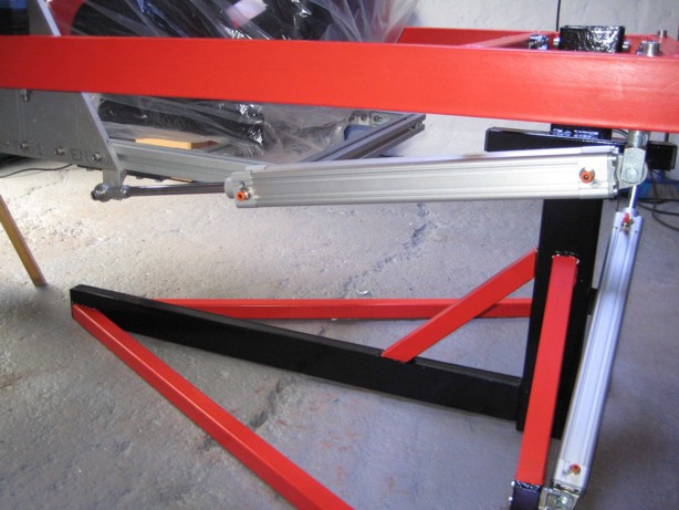

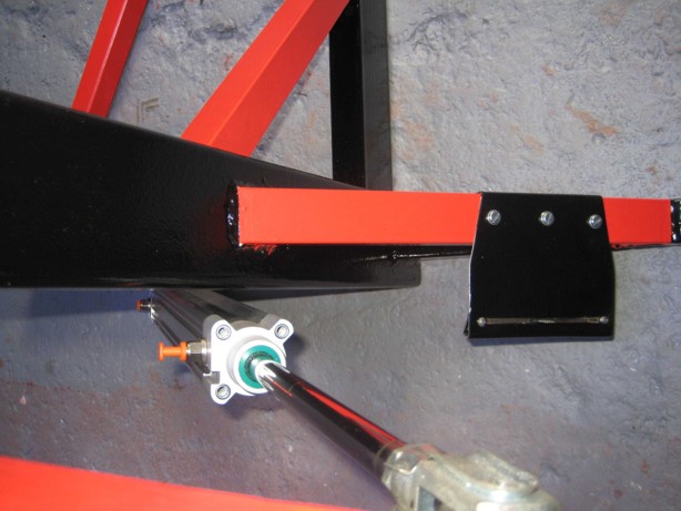

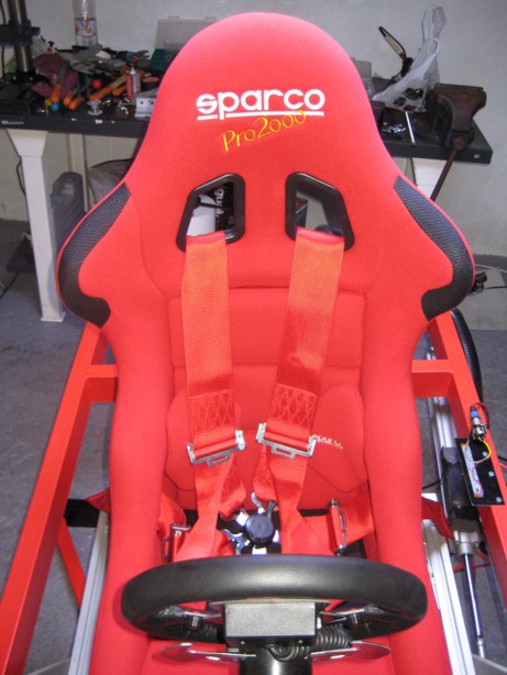

    After being developing for some time my simulator project, here I show some photograf's of it.
    I have not finished yet the mounting process of all the peaces, but I have them all.
    I hope to finish soon. Thank's to all the guys from x-simulator that have helped me in the consturction of my simulator.
    Best regards
  2. tronicgr
    tronicgr
    Is this going to be moved from pneumatics? :eek:

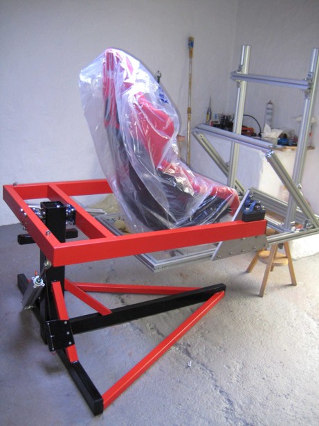

    And another thing. I think you have raised a lot the seat, and most likely you will be getting false cue movements. For example if you press the brakes you will be pushed on the seat while the exact opposite should happen!
    I would advice you to lower the seat 20-30cm if possible. It will also improve the balancing stability of the platform with the driver on it. BTW how you are going to climb in that thing??? :?
    Regards, Thanos

    Hi Thanos
    Thanks for your coments!

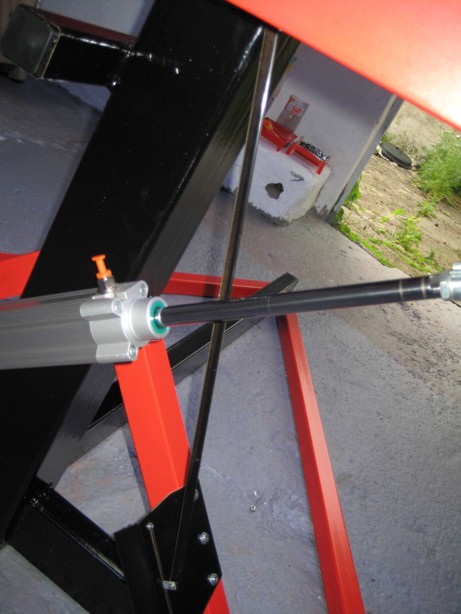

    Yes is a pneumatic system
    I already tought putting down the seat, but for the moment I can´t do it because the cilinder I have is too long (400mm). I have been thinking of reducing it to 300mm or less because I don't need so much lengh. Your example is not valid, because by pressing the brakes the effect is correct though the movement is too long.

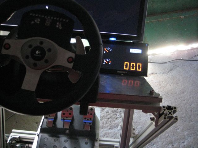

    What it's true is, that I have a problem with the x-axis, because of the position of the seat the GC is to high, and this makes that the x-axis movement does not end when it has to and it keeps on moving till the end of the cylinder. But I'm working on it. This is only the beginning of the work, I still have to install the 3 monitor system to compense the balance of the machine.
    Yes, that thing is my Simulator :mug1:

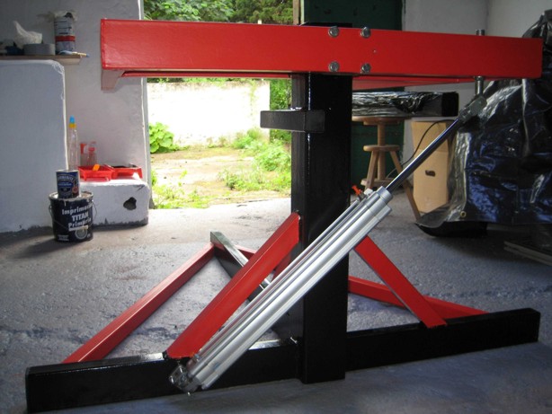

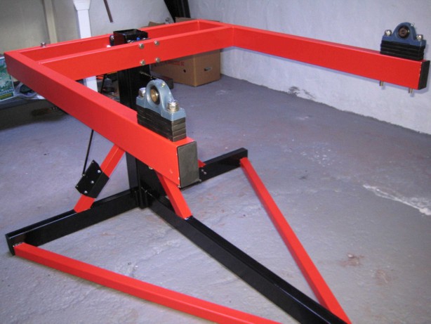

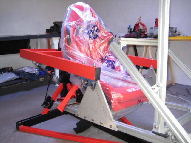

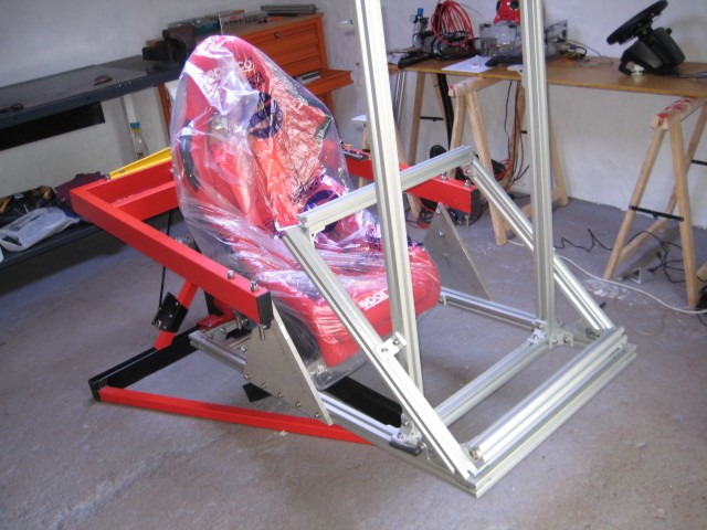

    Hello
    More photos.I hope you like it
    Regards

    Thanos is right. You have to balance it out! The seat is in a too high position. This becomes obvious, as it moves quickly to the sides, but has much trouble to get back to center position.
    Regards
    Christian

    Hi Christian
    as I told Thanos, I reducing the vertical axis motion of the simulator, to be able to put it down , and so improve the horizontal movement.
    I will put some photos in short time.

    Hello
    I have reduced the hight for about 20 or 25cm, now I have a cylinder with a range of 250mm. I hope with this change it's enough. I also have reduced with cushion of the x-axis with buffering.
    Regards
