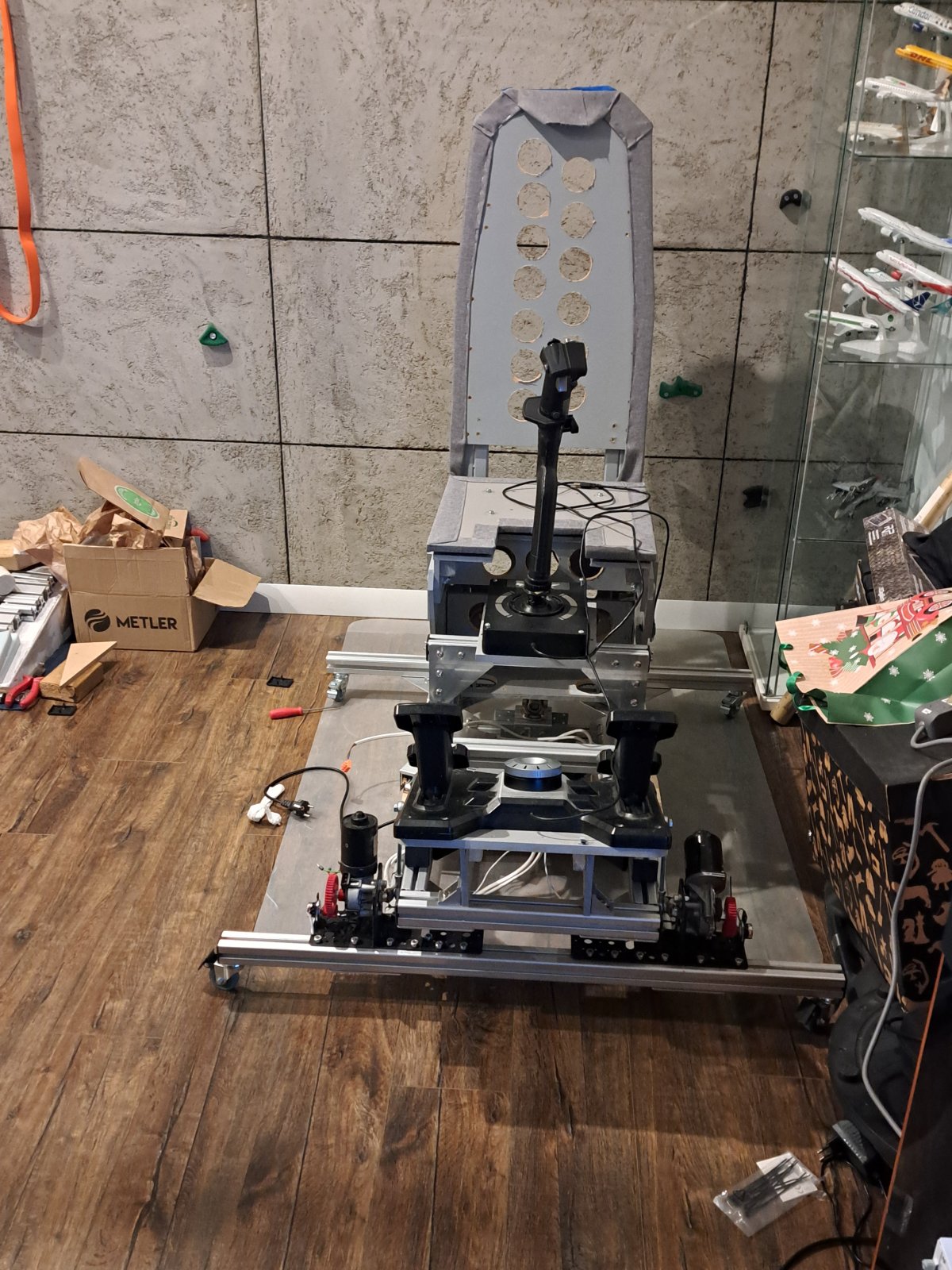

    Now I faced with Simtool - DCS problem - my rig is shaking dramaticly - please find below details of my setup, and on the bottom my issue description.

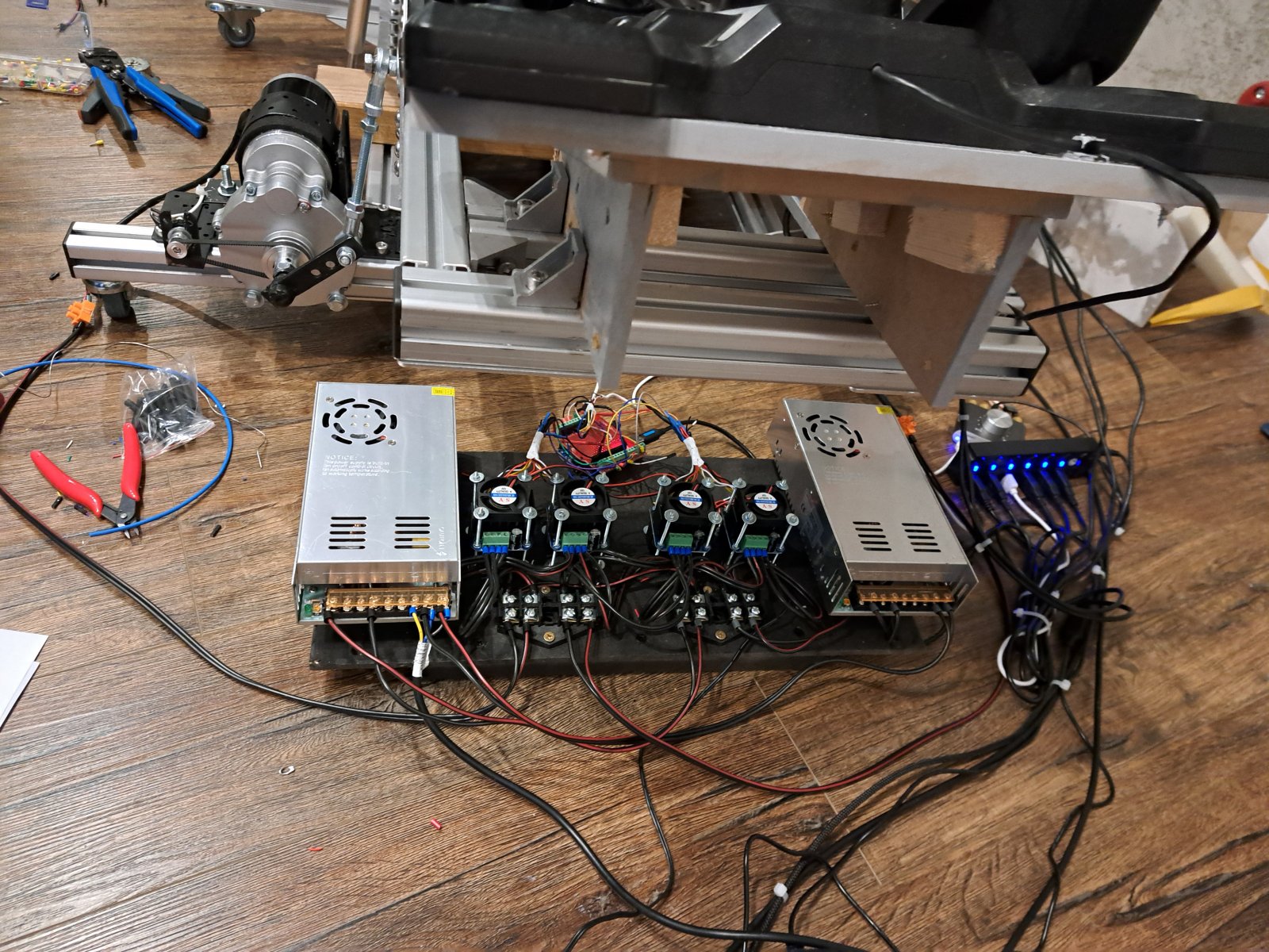

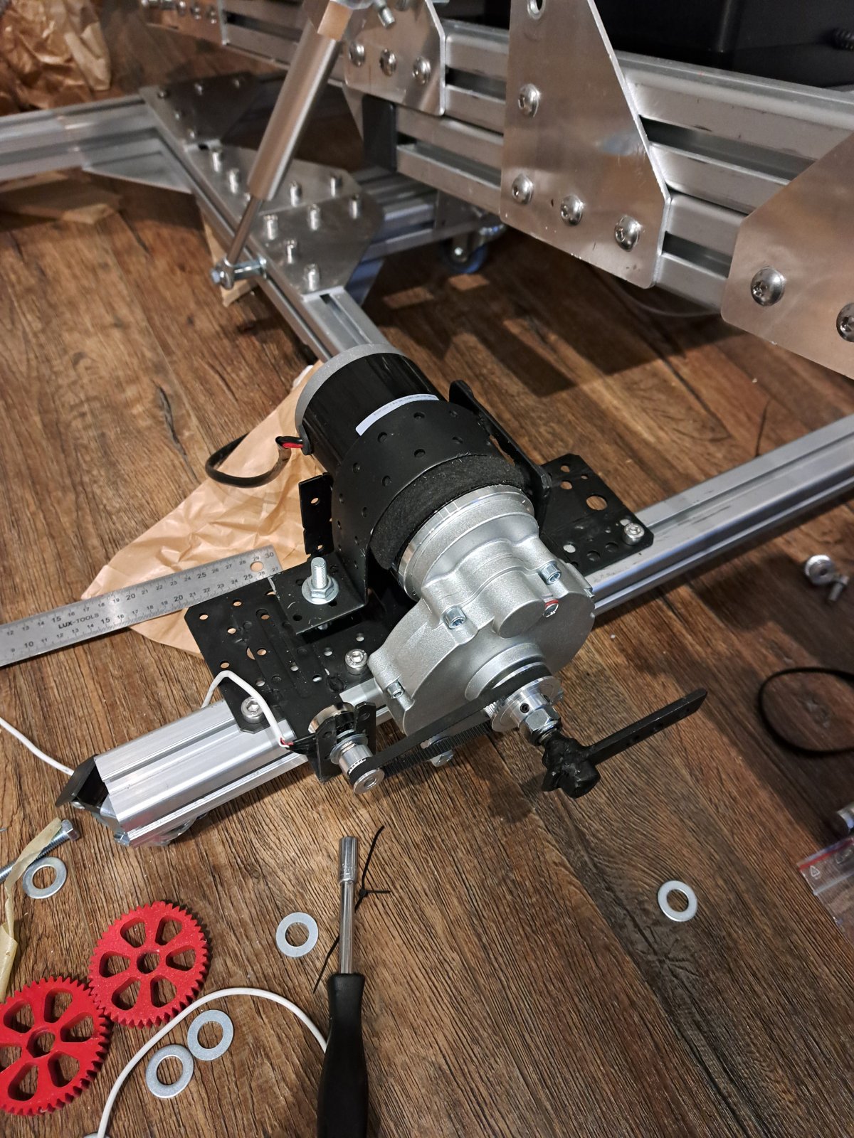

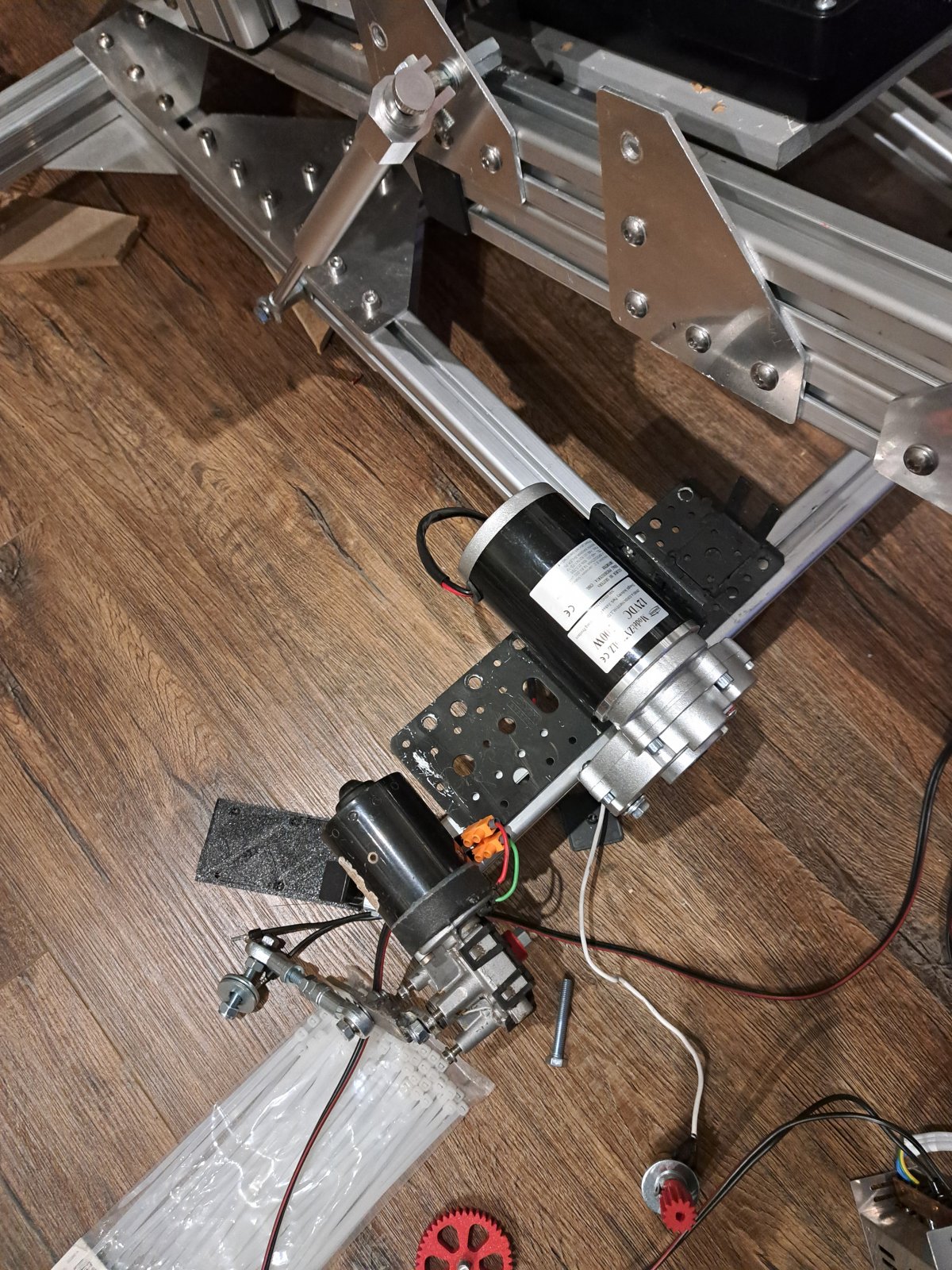

    MY SETUP;
    1. RIG is made from 4040 alu profiles
    2. Motors - 200 watt 12V 24Amp for wheelchair (at the begining I use 2 VW Golf wiper motors, but they overheated)

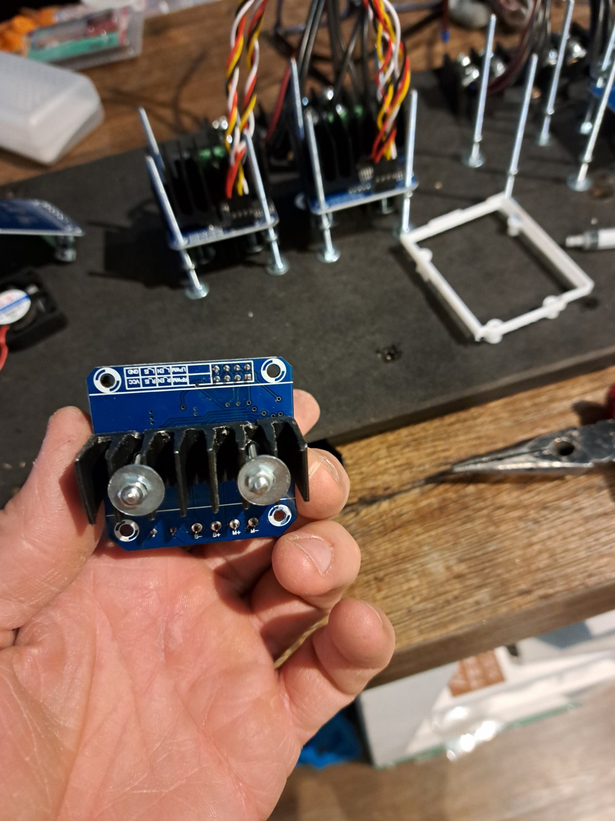

    3. Arduino UNO SMC3

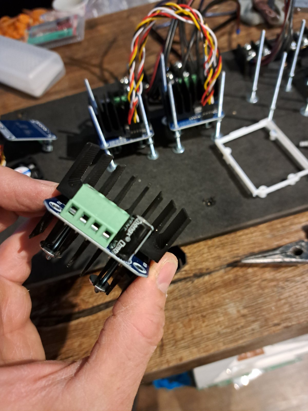

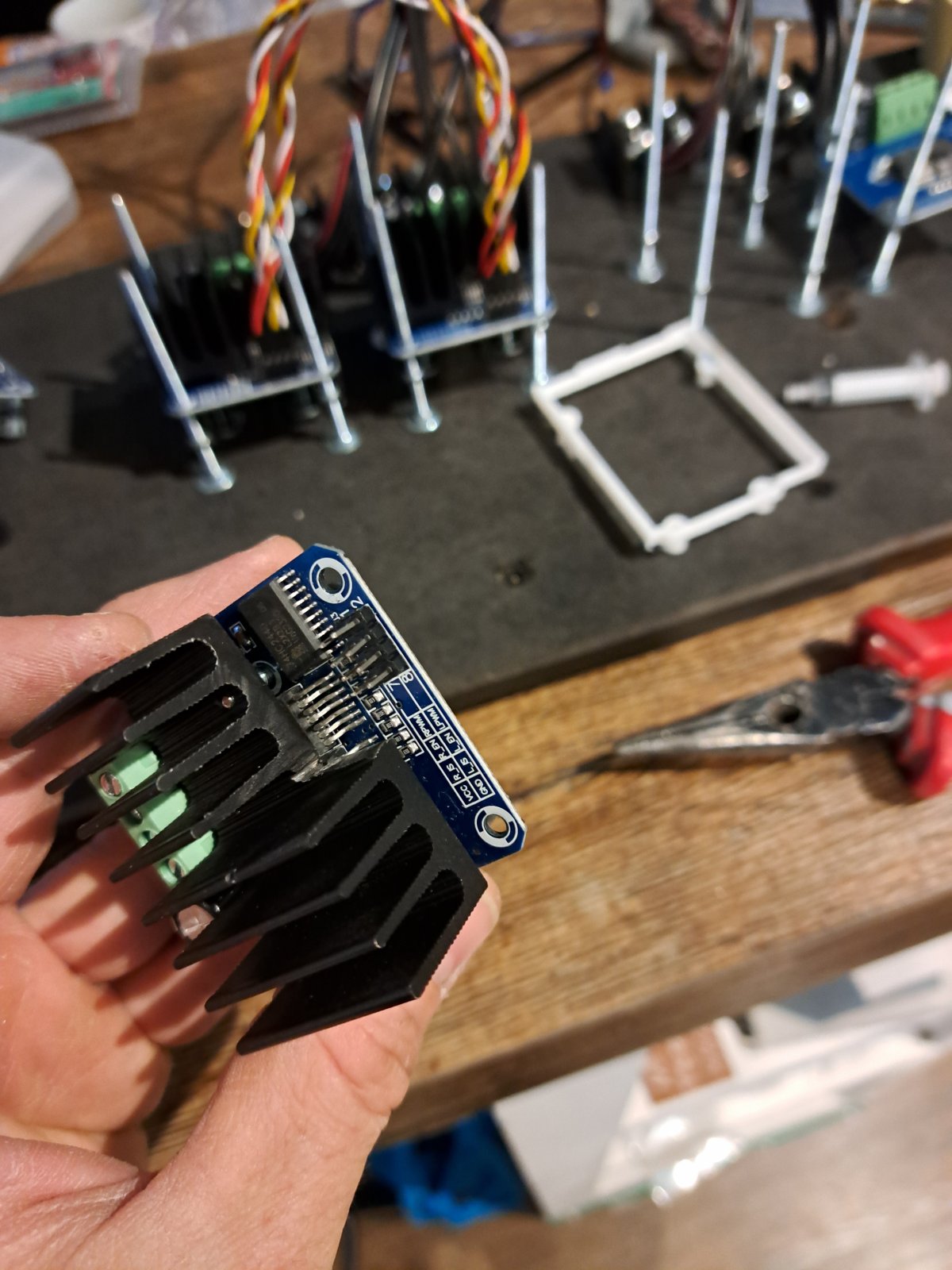

    4. IBT-2 - to for every motor with rebuilded cooling radiators. At the beginning I used one IBT2 per one motor, now based on forum tip I have 2 IBT-2 for one motor.
    5. SIMTOOLS V2 and V3 - DIY License
    6.
    7. Seat is made from MDF for B737, but prepared for rig (without bottom part and made it very light). Still is not ready - I am waiting for foam parts.

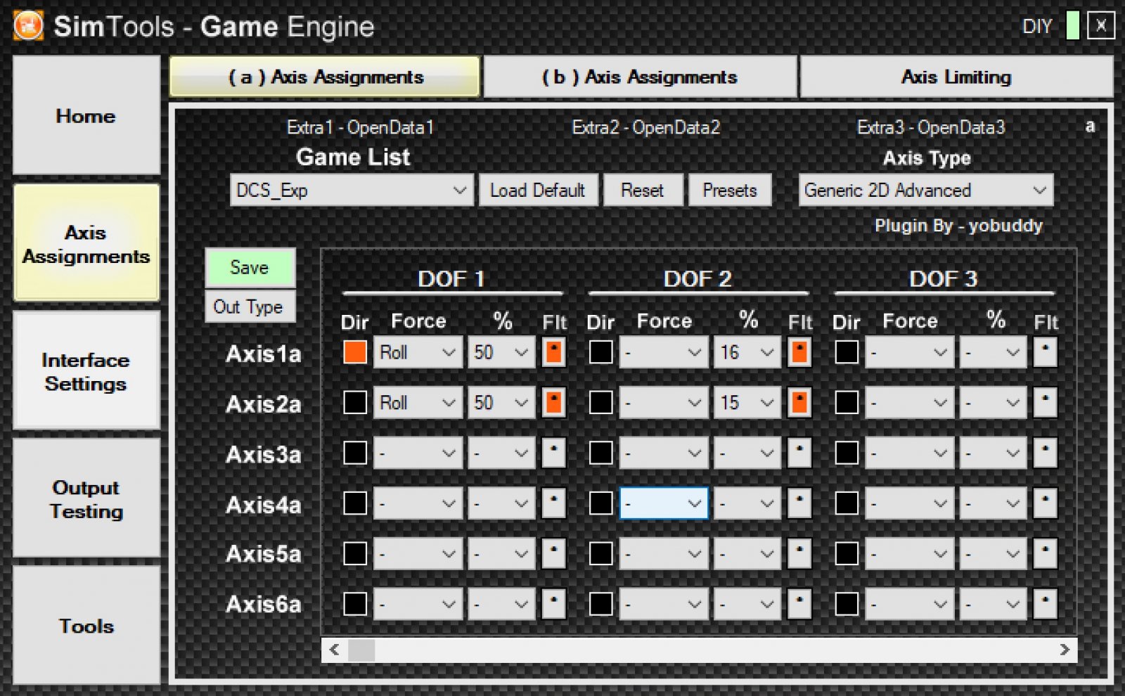

    MY ISSUE

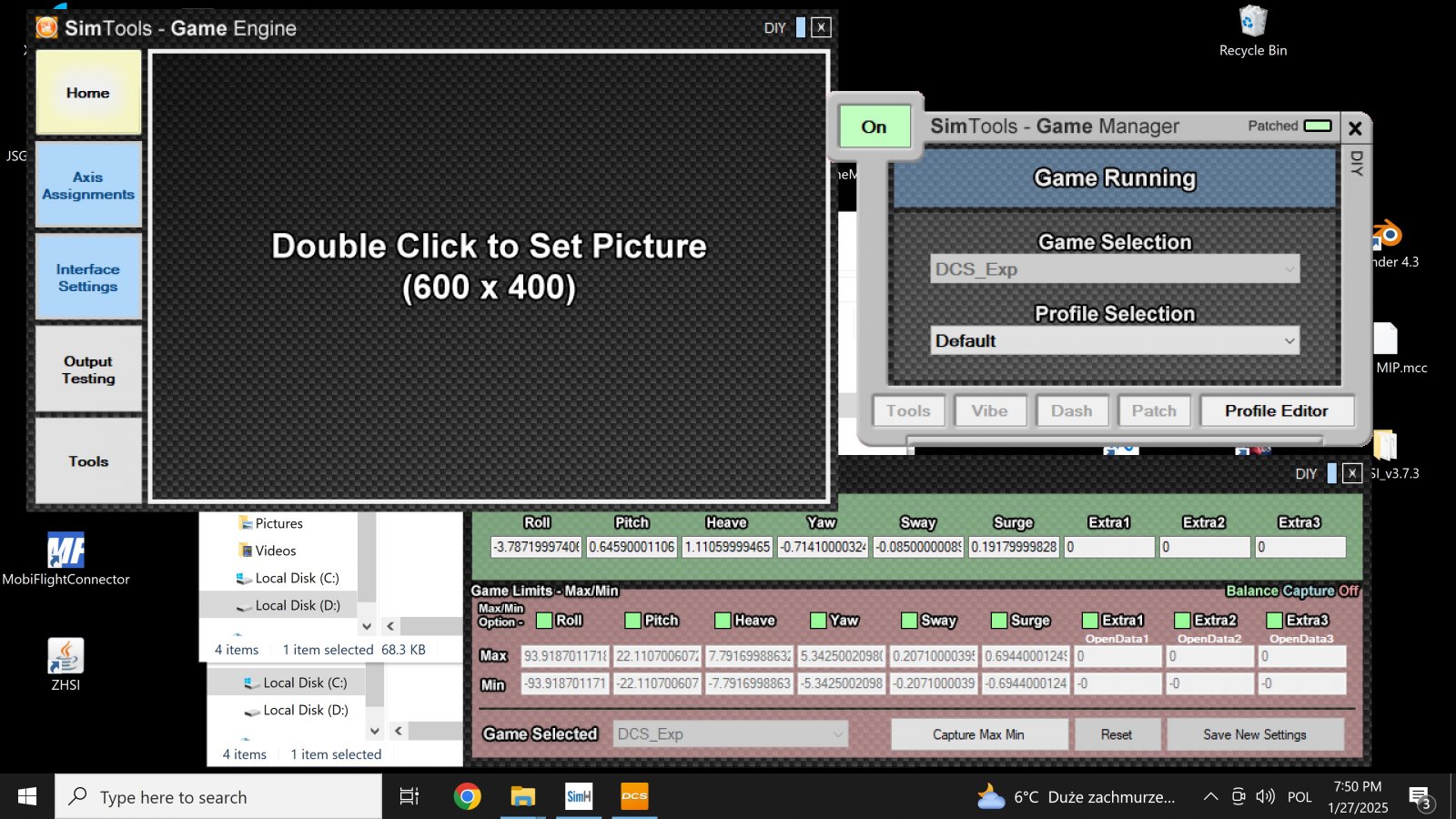

    I try to use my RIG in DCS but the it is strongly shaking.
    Currently I try to set it up only on ROLL axis - and it is moving - swinging from left to right.
    a. I have windows 10 - english US is installed and use as a main language.
    b. I have DCS plugin for Simtools 2 - DCS_Exp_GamePlugin v0.10
    c. Latest version of Simtools 2
    d. I tryed to connect pin 8 in AD UNO - but i thing this solution is for sabretooth, not for IBT-2
    e. Shaking apears in output testing too.
    f. In SMC3 utils I tryed several setting with load (myself - 85kilograms). In SMC3 motors are working smooth.
    I tryed to change a lot of Simtools settings - related to axis, tuning center - and also I tryed to change SMC3 settings. Nothing helped
    I stack after check hints and tips described in treads i fount in this forum - so finally I need your help.

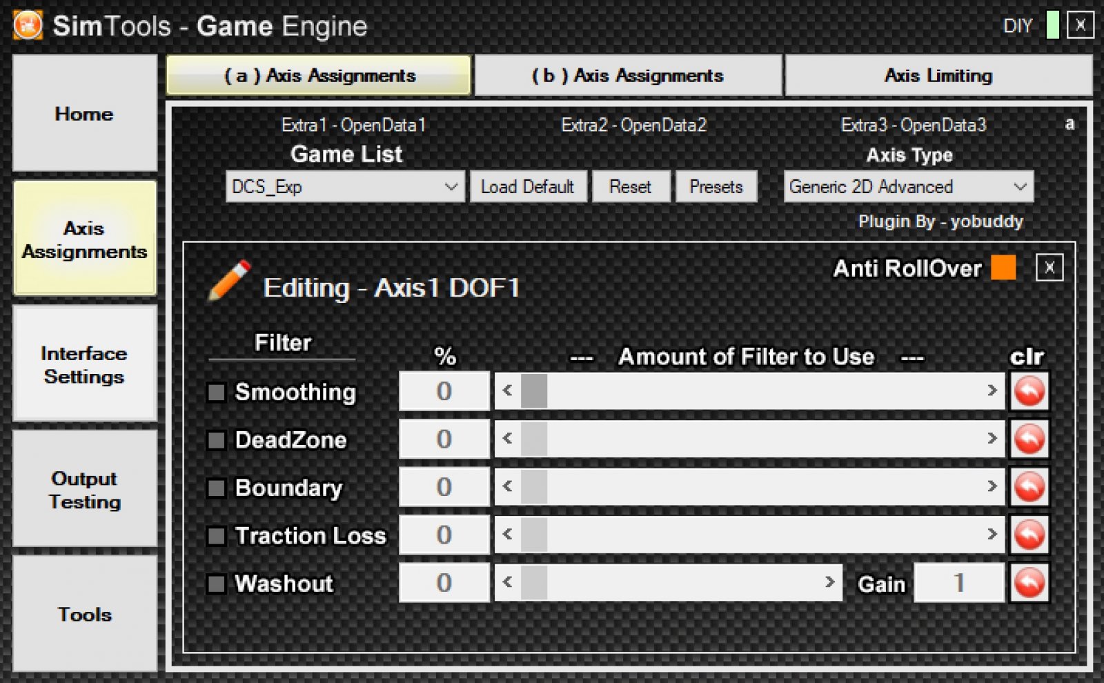

    Do you have filters set up in SimTools? This can reduce or eliminate what I think you are describing. You sort of expect flight to be silky smooth but for sim racing there can be some very sudden moves.

    Hello Joe,
    I tested three filters with different values:
    Smoothing
    Deadzone
    Boundary.
    What is weird for me, if more smoothing than more shaking.

    Is Roll the only axis configured in Axis Assignments and did you Capture the Min/Max values in the Tuning Center?
    You also seem to have Filters in use, my advice is to treat Filters as the last tuning step, after all other issues are sorted, so don't use them until then, just default settings.

    I tryed to use all forces except yaw with percentage from 10% to 100% , but maybe much more important is that during output test the axis movement is not smooth at all.
    Then I setup only one force - means roll.
    I realized that the % of force in axis assignement has an influence for decreasing shaking.
    Result: 10% very violent movements during the swipe the bar left or right - when 100% still violent movement but much smoother.
    At the evening I will start from scratch and I will make movies with every steps.
    One thing - at the beginning I setup in SMC3 low values PWmax and PWrev (initial setup), then rig movements in Simtools was smoot and nice.
    But ater I put heavy load (myself - 85 kilograms) on the seat i had to increase PWmin, PWmax and PWrev to have enough power to move the rig from the extreme/max left-right position, than those shaking has started.
    The same story was in my previous wiper motors.
    I also replaced IBT-2 and then I duplicated them for every motor.
    Maybe is an hardware issue - I can replace Arduino UNO to Arduino MEGA - currenrly I have one MEGA at home - but I have to find code for this AD model.

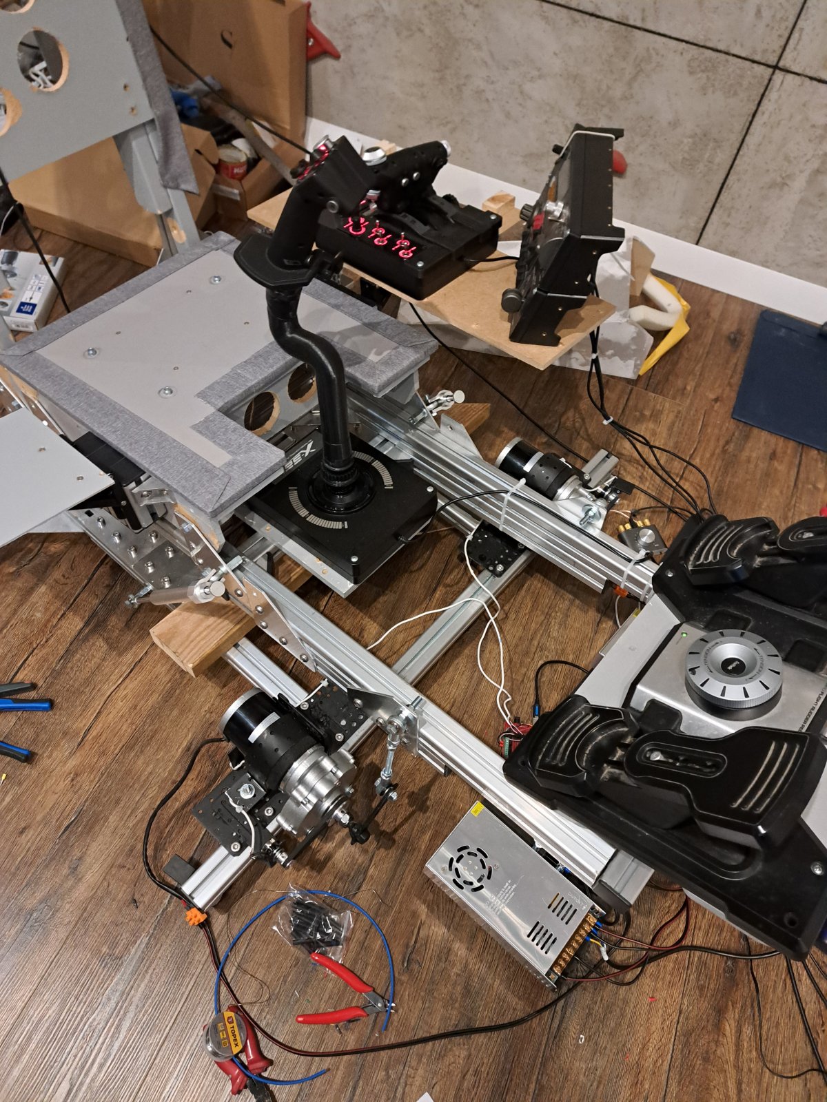

    I already shortend levers - not registered by photos. My engines are a little bit worm - 36-40 degree celcius after working with load.
    I bought new Arduino UNO - so I stop thinking about AD Mega;)
