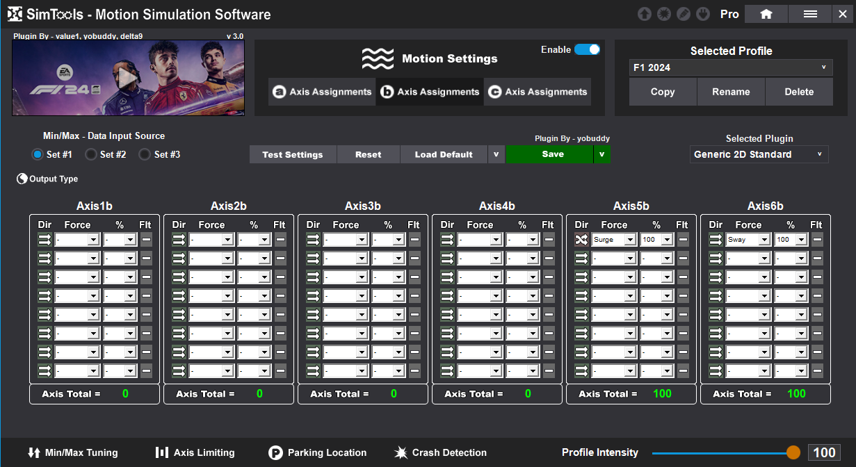

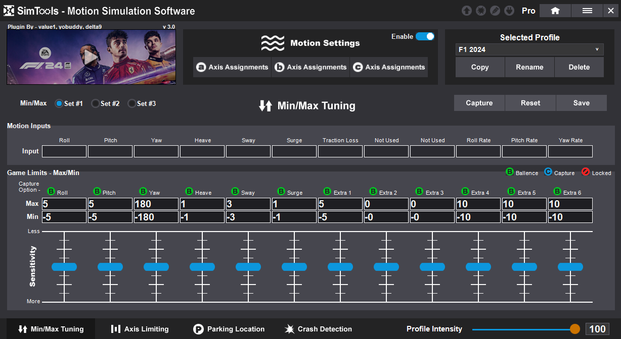

    Sounds like you need to capture max/min for traction loss is all.
    As a quick test, you can change the traction loss max/min number to +-25 and see if it's better.
    I would also increase your roll and pitch max/min to +-25 or so, as right now they are limited to only +-5 deg.
    Anyway, please give this a try, and let me know how it goes.

    now I‘ve tested both suggested settings with higher values of +/- 25, but unfortunately it makes no difference to my old settings. As I already wrote, I have the same settings at LMU, and in the past, it always worked with SimTools 2 and the older F1–Titels, too.
    So would be great, if you have a further idea!
    Thanks!

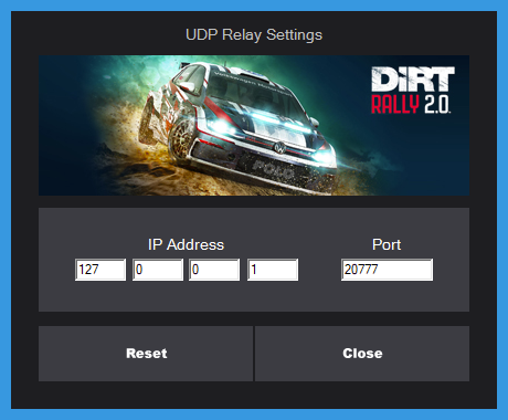

    Z1 and Simhub have released an dash-support for F1 2024, but both are only working with the UDP-port 20777 but Simtools allows only the port 4123.
    So my question is, if there is a chance to change it from your side to get it work. Russell Hodgsen from Z1 means that you maybe can help.
    Thanks!!
  15. yobuddy
    51,521Coins
    +5,204 / 19 / -0
    Only one app can collect data from a UDP port at a time. So we actually don't want the plugin using the default 20777 port. What we want to do is get the plugin working in SimTools, and then setup a UDP Relay from SimTools, and send a copy of the data to port 20777. (like in the pic below, but for F1 2024)
