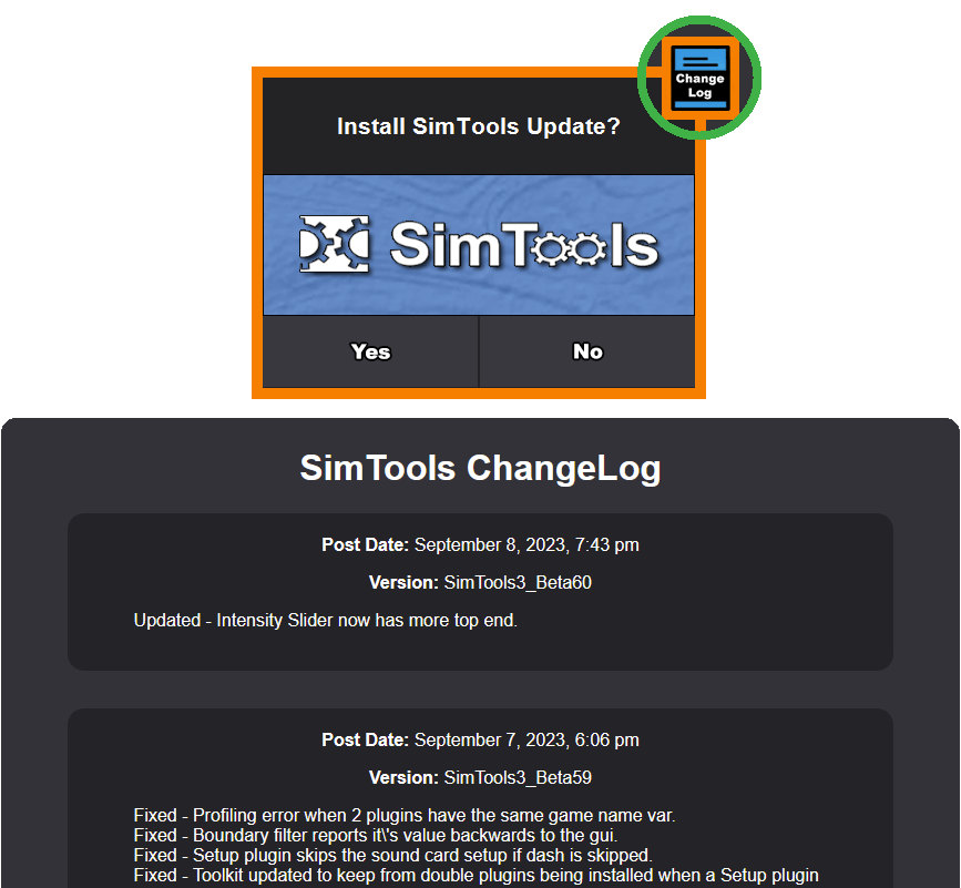

    Update pushed...
    The SimTools v3 Changelog is now available from the SimTools update page in v3.

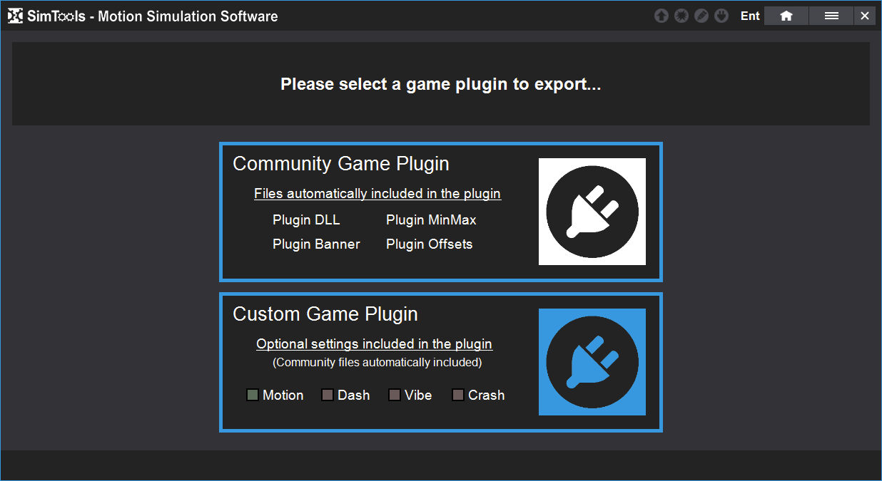

    In V3, can I save Min/Max Tuning into file for backup?
  4. yobuddy
    51,648Coins
    +5,204 / 19 / -0
    Yes, go to the Options page, then click the Export Wizard button at the bottom right of the page.
    Then select a Game Plugin, then select the game plugin you want to backup, then select a Custom Game Plugin. (with at least the Motion option added like in the pic below)
    This will export the game plugin with all of it's profiles intact.
    You can simply drag-drop the backed up plugin into the main gui at any time to re-install.
    Let me know how it goes buddy. :thumbs

    I missed the changelog while updating, is it possible to retrieve it somewhere else?
  8. richdelta9
    richdelta9 Member Gold Contributor
    May 16, 2014
    47
    8,850Coins
    +65 / 0 / -0
    The log will not show up until the next time you update, because it is not there until after you install this update.
    You can view the changelog at https://simtools.us/simtools-changelog/.
    You can also access this from the link on the SimTools website downloads-links page.

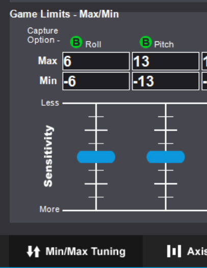

    You can fine tune your settings editing Max/Min Game Limits under Min/Max Tuning tab.
    To manual change values press Capture, edit the values, Save, then Stop
    EDIT: or use the sliders (but I can't stand not rounded numbers like 5,87564389. :D so I manually input them so it would be 6 or 5,5 or 5,75. Yes I know, I have problems...)
