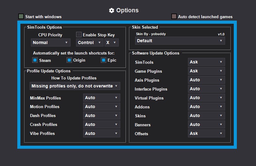

    Update Pushed!
    Added - Start with Windows
    Added - Auto Detect a Launched Game
    Both options have been added to the options page. :thumbs

    I had to look closely to see the box colour had changed. The 'start with Windows' has been selected and it works fine.
    However, 'Auto detect' crashes Simtools when the games start.

    Yes, skinning next so I'll get it fixed up.
    What game?
    Can you hit details on the crash prompt, and show me the log buddy?

    Update Pushed!
    Fixed - Auto Detect Launched Games? o_O
    Added - .url file type support for setting a games launch shortcut (this is steams default shortcut file type) :thumbs
    Take care!

    Auto detect crashes Simtools when the games start
    Asseto Corsa
    The log shows two errors.
    .NET Runtime

    @NjMotion,
    I believe the update I just posted above will fix it.
    Can you give it a shot?

    Are you clicking the play button, or auto detect?
    Is auto detect games on?
    thanks!

    SimTools3 now closes in both ways, manual and auto detect.
    I'm going to reset everything and try again.

    Auto detect, Simtools crashes.
    Play button, SimTools works fine.

    Update Pushed!
    Fixed - Auto Detect Launched Games - I think... lol

    Auto detect tested with Assetto Corsa and DirtRally2.0. It works perfect!
