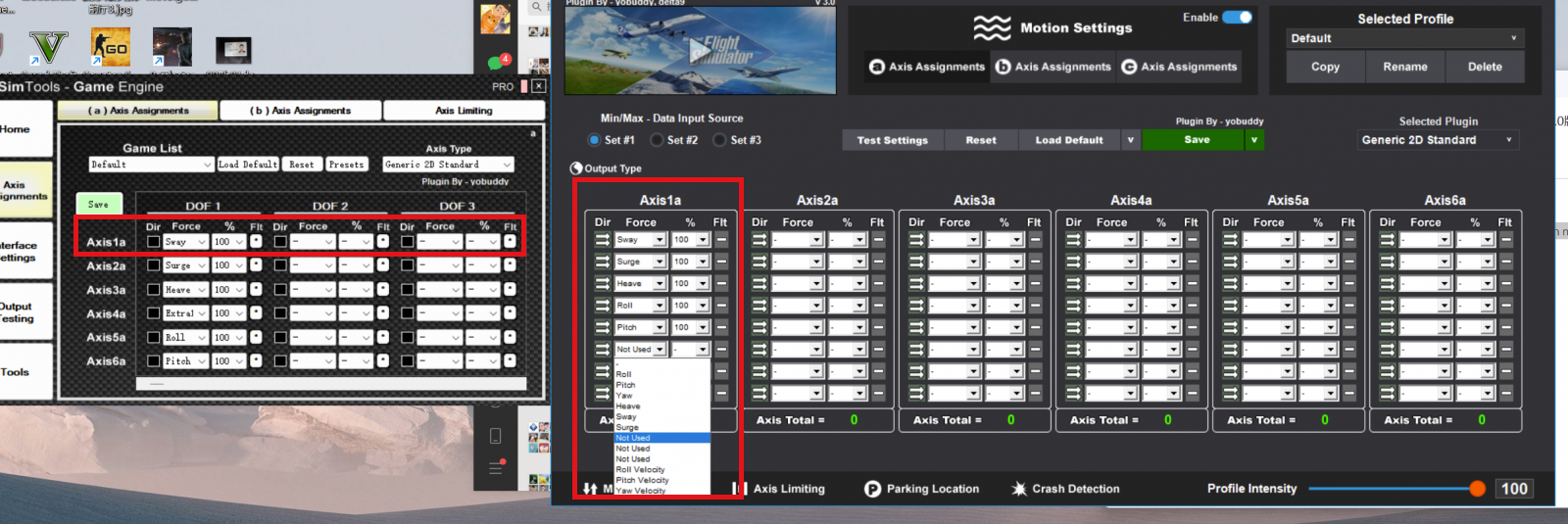

  1. yobuddy
    51,647Coins
    +5,204 / 19 / -0

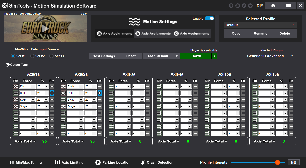

  5. deeph46
    deeph46 Member
    Mar 17, 2023
    117
    641Coins
    +16 / 0 / -0
    2DOF, 3DOF
    Have problem with ETS2, that after calibration, if truck moves at 60kmh above the rig will move right and left to the roll. And must turn down Sway sensitivity a lot.

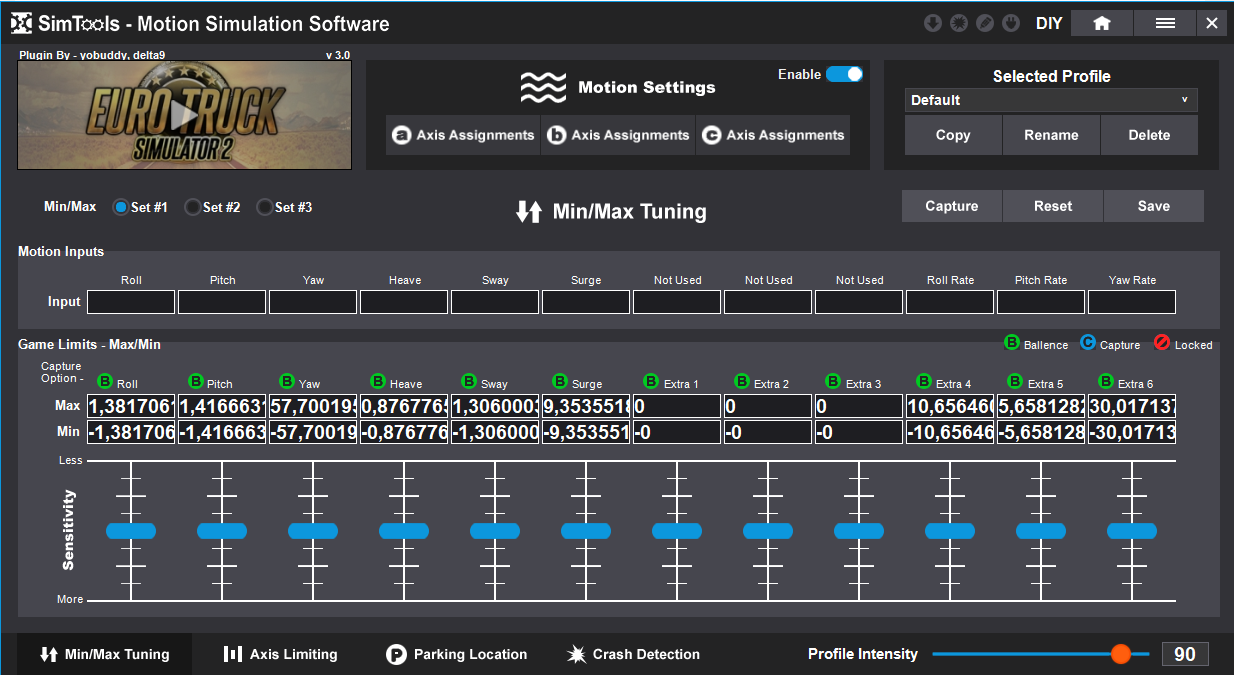

  6. huangwenkang
    huangwenkang New Member
    Jul 30, 2023
    47Coins
    I can't find Extral3 in version 0.1 software
    My dynamic simulator needs to set Extral2 in version 6.1, but I can't find this setting in version 3.0. How do you fix it?
  7. yobuddy
    51,647Coins
    +5,204 / 19 / -0

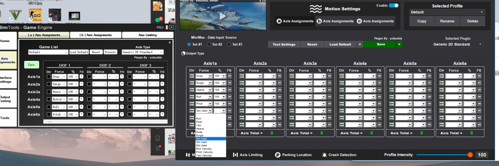

    @huangwenkang,
    Roll rate, pitch rate and yaw rate are still included, they are just extra 4 thru 6 now.
    its now Extra6
    Use Extra5
    Also know that in V2, the axis assignments per axis are horizontally orientated.
    But in v2 the axes are vertical.
    @deeph46,
    Seems to be working here just fine, may I see your axis assignments?
  8. deeph46
    deeph46 Member
    Mar 17, 2023
    117
    641Coins
    +16 / 0 / -0
    2DOF, 3DOF
    This my settings.
