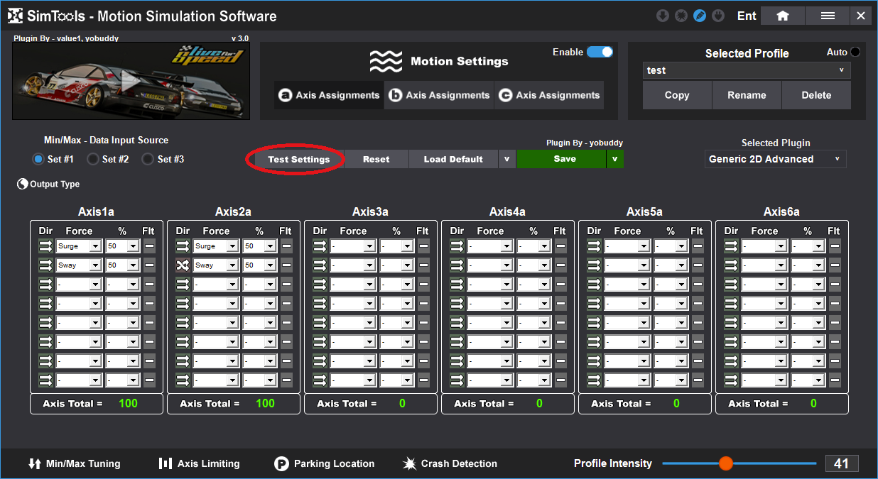

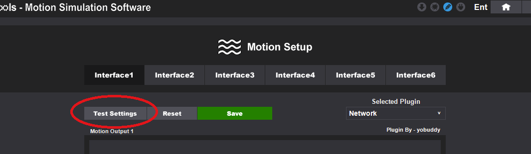

    First, check that you can Test Settings of your interface settings.
    Do your interface's work?

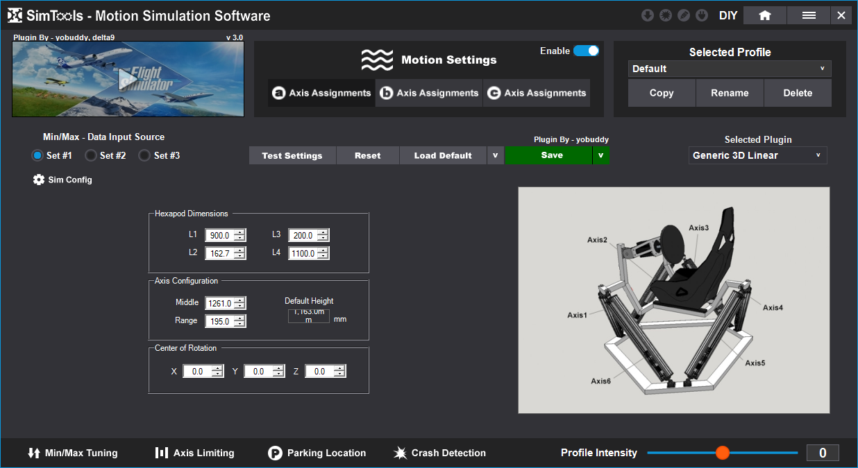

    You may want to use Roll, Pitch and Yaw velocity outputs, but that looks good man.
    I suggest opening the 3D Linear Virtual Window
    https://simtools.us/plugin/?varname=293&color=0e97dd
    With the 3D Linear Virtual Window open, test your axis settings and adjust them so you don't get any 'Out of Range' errors. Once you are done, you are golden to play the game.
    From there, you can adjust the Min/Max settings in tuning center for feel.

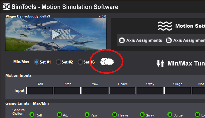

    (note that plane games have settings for both in the air and on the runway.)
    You can click the cloud/runway to switch between the two settings.

    Do you get some motion?

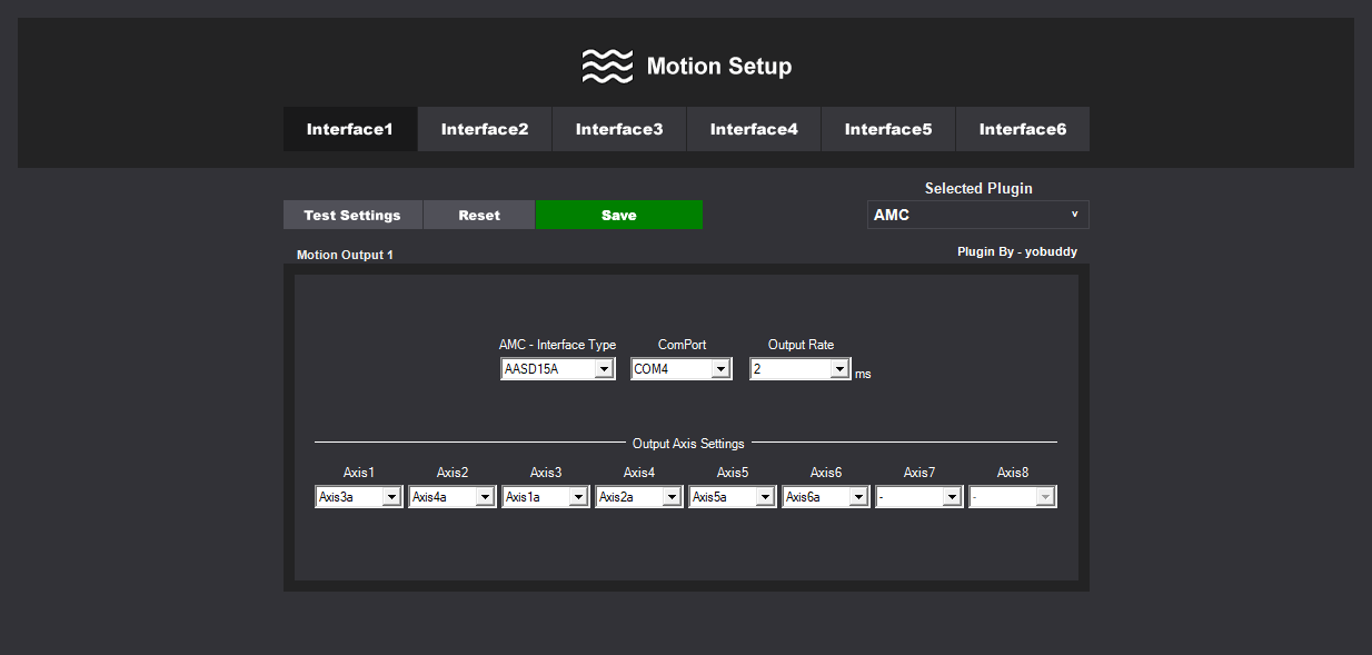

  19. 930175620
    930175620 New Member
    Dec 24, 2022
    15
    65Coins
    +10 / 0 / -0

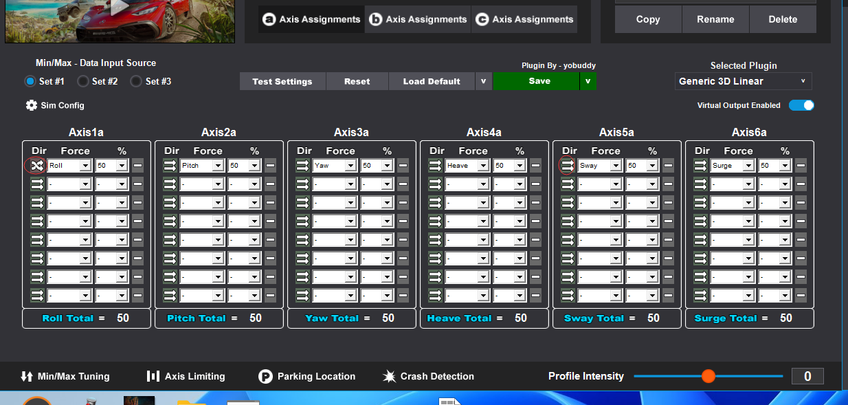

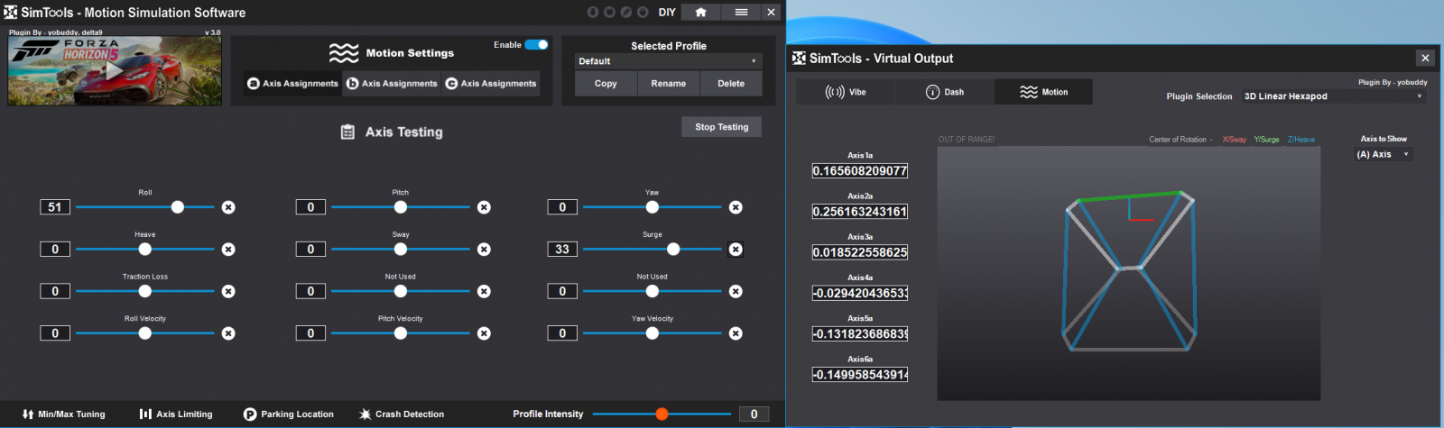

    My ROLL and Sway are opposite to Virtual Output in reality. Even after I click DIR, they are still the opposite. I use THANOS, my settings are as follows. What is the order of Simtools 3D LINEAR?
  20. yobuddy
    51,770Coins
    +5,206 / 19 / -0
    here you go buddy.[​IMG]
