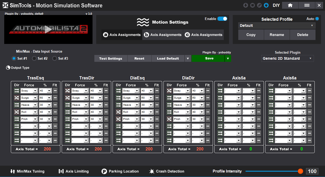

    Please help me! I configured the interface and the engines, during the tests in SimToolsV3 they move but during the game they don't.
    PS. I'm double-clicking the PLAY button to start the game.
    PS2. In SimToolsv2 it works better with values at 200%. Do not worry about this.

    At Assetto Corsa it's ok
