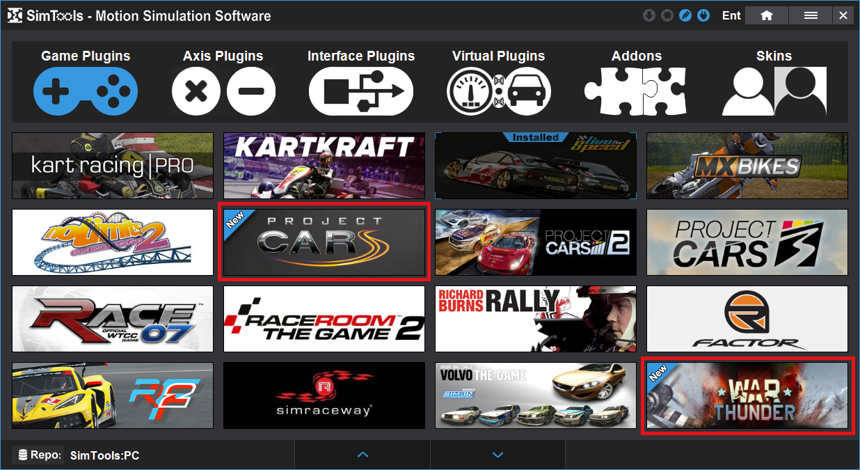

    Idiot question: I'm getting the blue Plugins icon, meaning there's a new plugin, but when I go to the plugin manager, I can't tell which one is new. I browsed all the tabs.
    How can you tell which plugin is new or has been updated? :confused:

    LOL! I looked at your image and was looking for a "red frame" around the new plugins. It literally took me like half an hour of going back and forth between your image and the plugins in ST before I noticed the blue triangle in the upper left corner.
  14. yobuddy
    51,738Coins
    +5,205 / 19 / -0
    Sorry buddy, I think the new plugin marker needs to be bigger, or a different color.
    They don't stand out as well as they did in the beginning with less plugins available.
    I will probably update it at some point.
