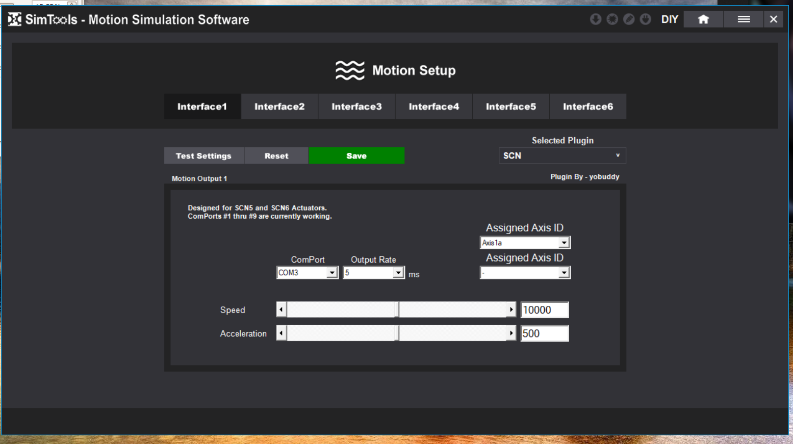

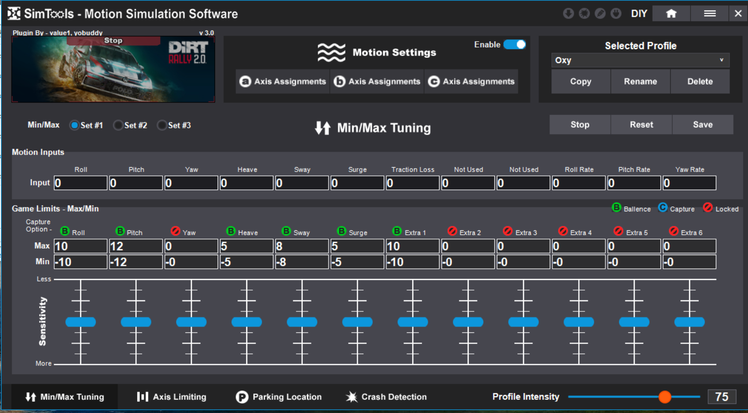

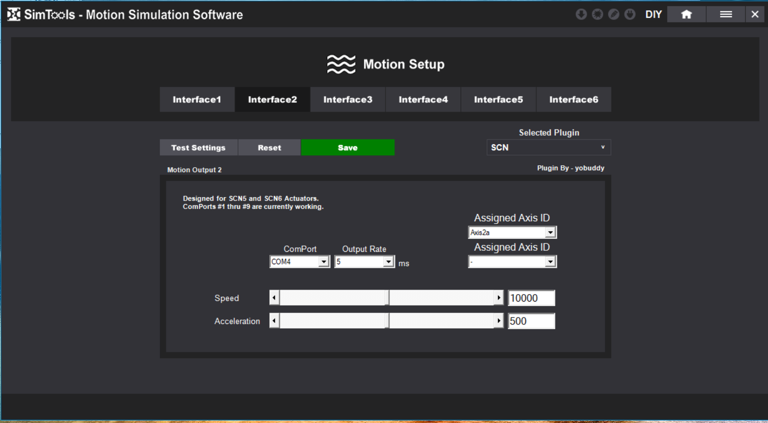

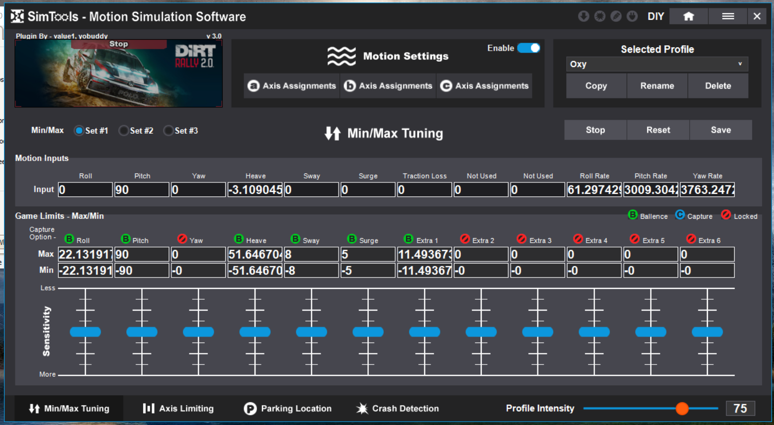

  12. Ochso
    Ochso New Member Gold Contributor
    Dec 17, 2019
    15
    CAD Designer
    UK
    - 60Coins
    +10 / 0 / -0
    3DOF, SCN6, Motion platform
    Thought I should post : Screen grabs will follow later as not at machine atm
    Simtools V3 version : Current (20/02/23)
    Motor plugin : SCN
    Motion rig : Prosimu T1000 3M
    Game plugin : Dirt Rally 2 - patched
    Problem : Pitch not working / Registering a value of 90 for pitch input on tuning control.
    resulting juddery experience relying on Heave/ Surge.
    Fixes tried. -
    Removal / reinstallation of patch - no change.
    Removal re download plugin - no change.
    Repeatable Side note . Hard to put into short phrasing
    Running Sim tools V2.55 Dirt rally 2 game after patching the V3 version game exhibits exactly same problem as v3 ( 90 pitch) -
    Removal / addition of V2.55 game patch resolves the condition . but returns if Patching of game for v3 done afterward.
    Start up cycle of Actuators on initialisation of V3 : Return to park after cycle - very sharp .
    Didnt know if you have had a preferred bug format .
    System PC - Win 10 ( 21/H2)
    Rzyen 5900X 32Gb X570 Rig connect via USB on exclusive USB 3 header added to Mobo ( not a PCie riser)
    Hope this helps
  13. Ochso
    Dec 17, 2019
    15
    CAD Designer
    UK
    - 60Coins
    +10 / 0 / -0
    Screenshot 2023-02-25 124738.png Screenshot 2023-02-25 124810.png Screenshot 2023-02-25 124838.png Screenshot 2023-02-25 131219.png Screenshot 2023-02-25 133229.png Screenshot 2023-02-25 134353.png
    As I drive in VR the last 2 grabs are the before I start and after finish in the capture moment.
    Most probably doing something terribly wrong but its one plug in ~I cant use for V3..
  14. Thanos
    Jul 6, 2017
    1,379
    Electronics Engineer
    United States
    2,917Coins
    +1,079 / 10 / -0
    That is not bug. Usually when you stop motion data from the PC, the actuators will move to standby position 50% for a few seconds, to level the platform if the motion stopped with the rig positioned on angle. Then after a few seconds will lower all actuators to park position.
    Now if you start the motion before it reaches park position, it will not engage the soft positioning to ready position (50%) but instead could jump to whatever positions the motion software is sending as it thinks its still in on-line mode and needs to move in real time.
    Do you have the spike filter enabled? It should handle such situations preventing jumps from motion data spikes.
  15. yobuddy
    51,651Coins
    +5,204 / 19 / -0
    @Ochso,
    The 2 plugins are not 1:1, so you can either play this game with v2 or v3.
    If you want to go back and forth between the two, you will need to repatch for the version you want to use.
    This is fixed in the newest version.
    Please remove the plugin and restart simtools v3.
    Then reinstall the plugin from the repo and see how it goes.
    Take care!
