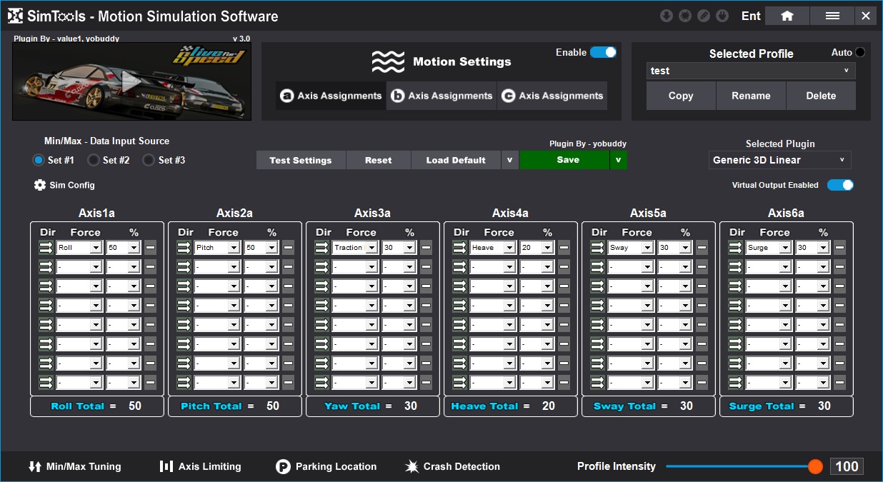

    Roll output is the degrees you sitting at.
    It's a static output, the car is sitting at 30deg.
    Roll Rate, is how many degrees a second the input is changing.
    So the output is the amount of change from one input to the next.
    (normalized over 1 second)
    So if you come to a complete stop, the rate outputs will always be zero.
    You can think of it as changing the roll output into an acceleration rather than a static degree.
    I suggest you set axis 1a to roll and axis2a to roll rate and take a look at what happen in the virtual output sliders plugins when it runs.

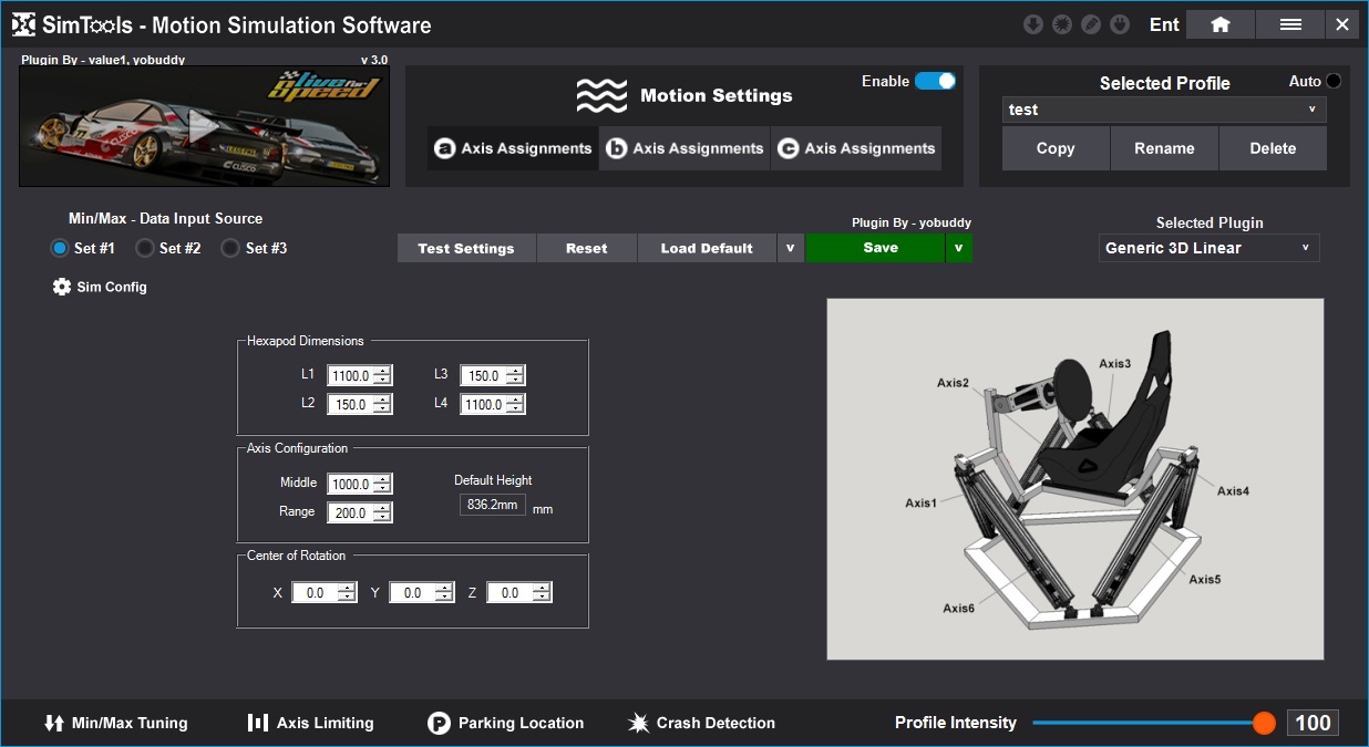

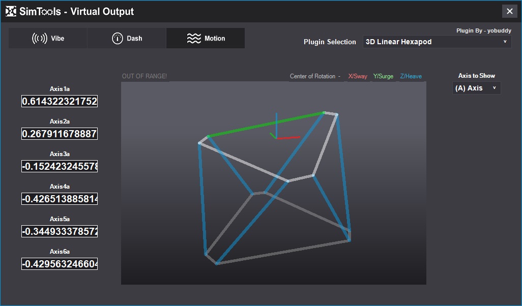

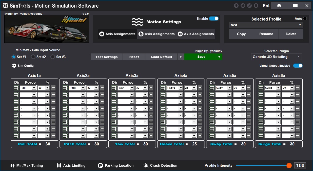

    Now available for SimTools v3...
    Linear Axis and Virtual Stewart Plugins :thumbs
    1) Generic 3D Linear Axis Plugin (Stewart platform support)
    Sim Setup
    2) Generic 3D Linear Virtual Plugin
    Please let me know how it goes...

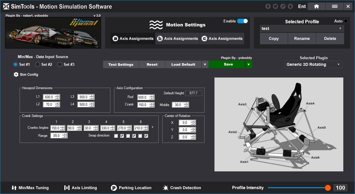

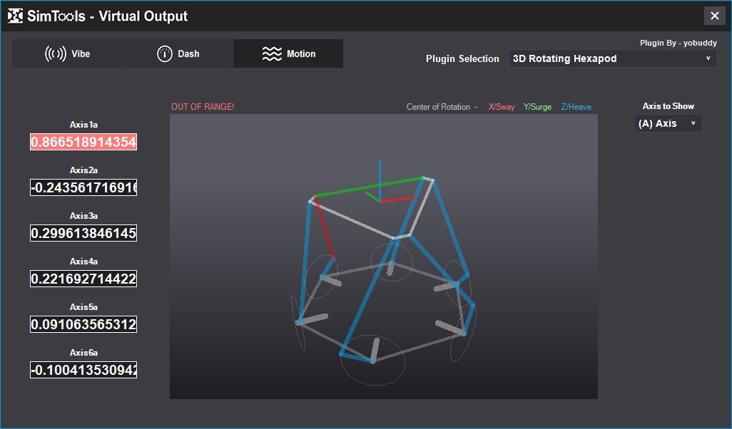

  11. yobuddy
    51,759Coins
    +5,206 / 19 / -0
    So yea - we need Rotating version also...
    Rotating Axis and Virtual Stewart Plugins :thumbs
    1) Generic 3D Rotating Axis Plugin (Stewart platform support)
    Sim Setup
    2) Generic 3D Rotating Virtual Plugin

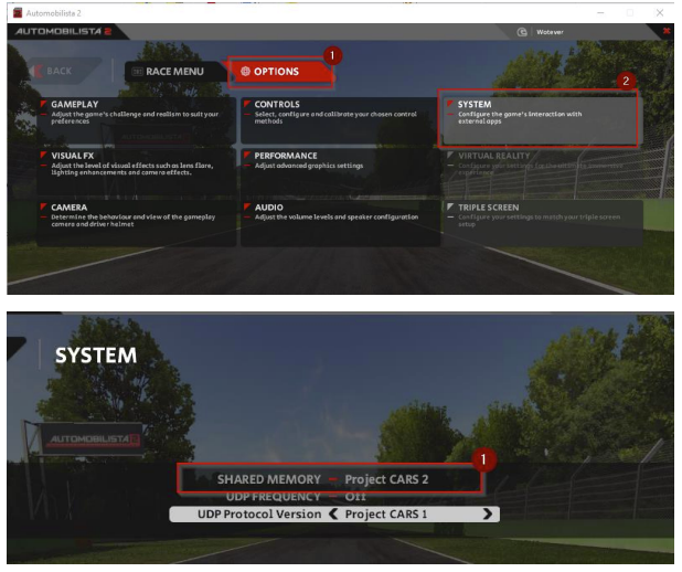

    Can some one tell me what upd port AMS2 use ? Where ist the setting file location? I trie to setup simtools and simhub.

    Hi you dont need any UDP ports to make AMS2 work with Simtools and Simhub just set up the in game telemetry and both will work
