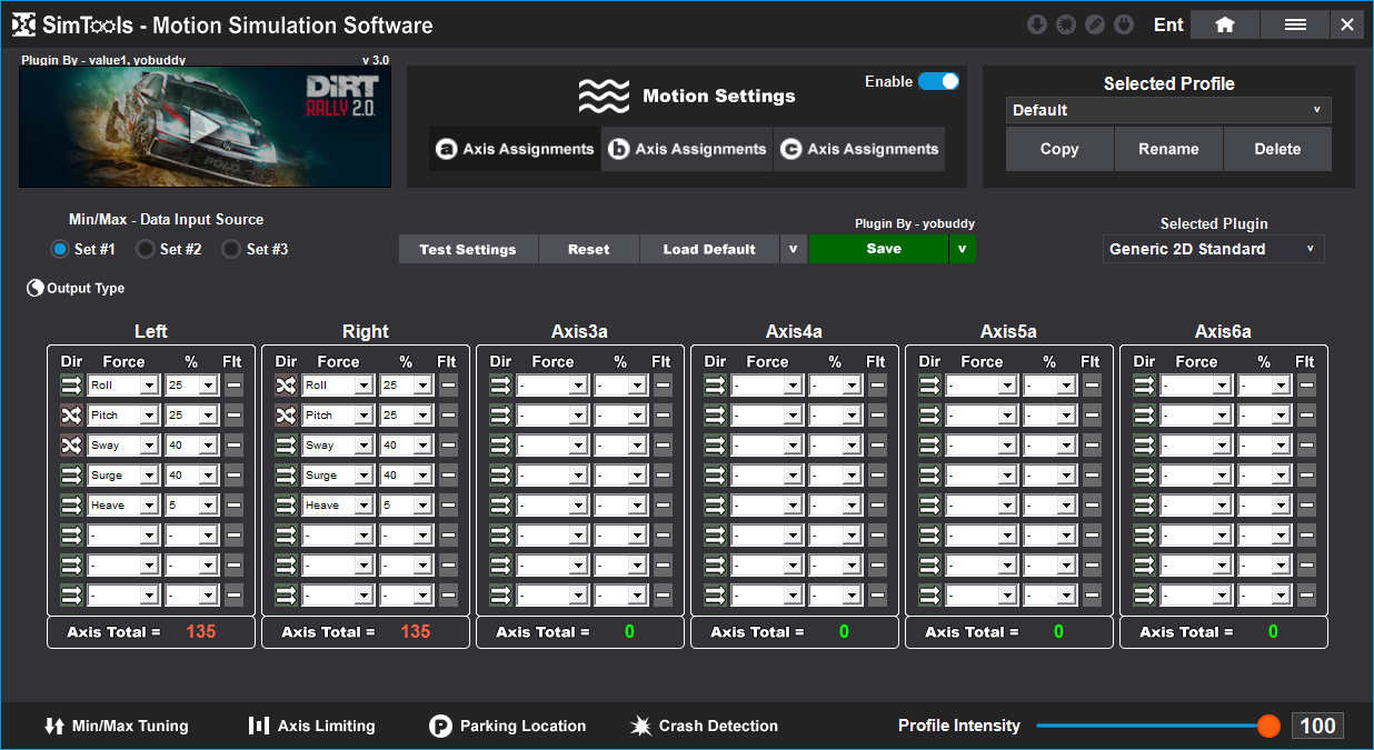

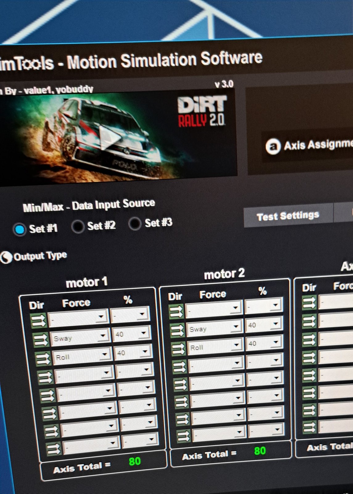

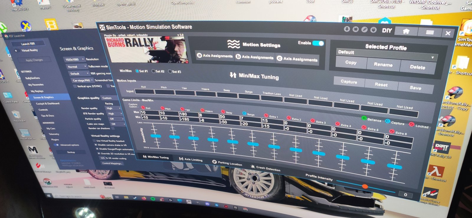

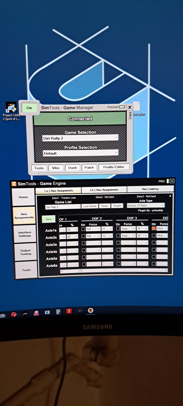

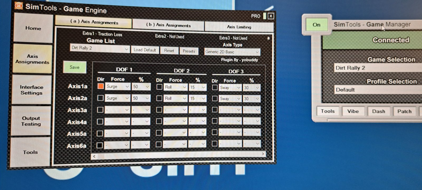

    I tried Dirt Rally with Roll force only activated on even terrain in free roam , but still has problems , when I enter the race the rig is tilting on one side then start violently move from side to side like Sway , but without Sway being activated. I noticed that Roll and Sway are both on same direction of travel , but in V2 works ok. Can this be the issue? Isn't Sway direction opposite to Roll? In test mode I need to set them like in the picture to give to right output. 20230124_094252 (1).jpg 20230124_094104.jpg

    I posted an updated Dirt Rally 2 plugin. this should provide good values for all outputs now. You want to have Sway opposite the other Sway and Roll opposite the other Roll. I attached what I was testing with on my 2DOF simulator. We are going to try and get all the plugins spitting out the data the same for each game so that global profiles should work with all plugins when we go back through them, but for now it is configurable.

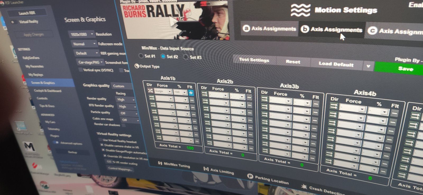

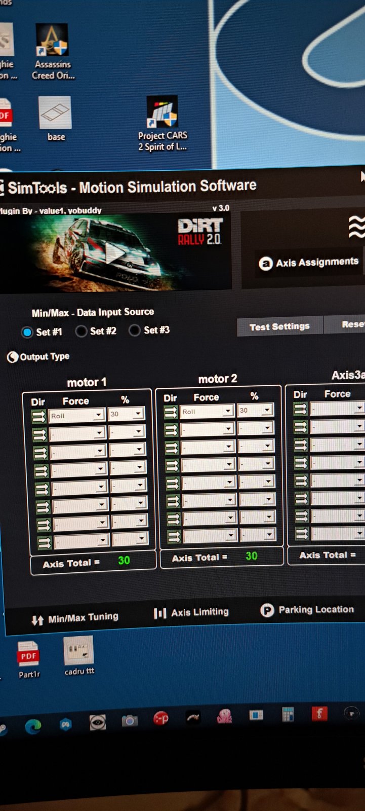

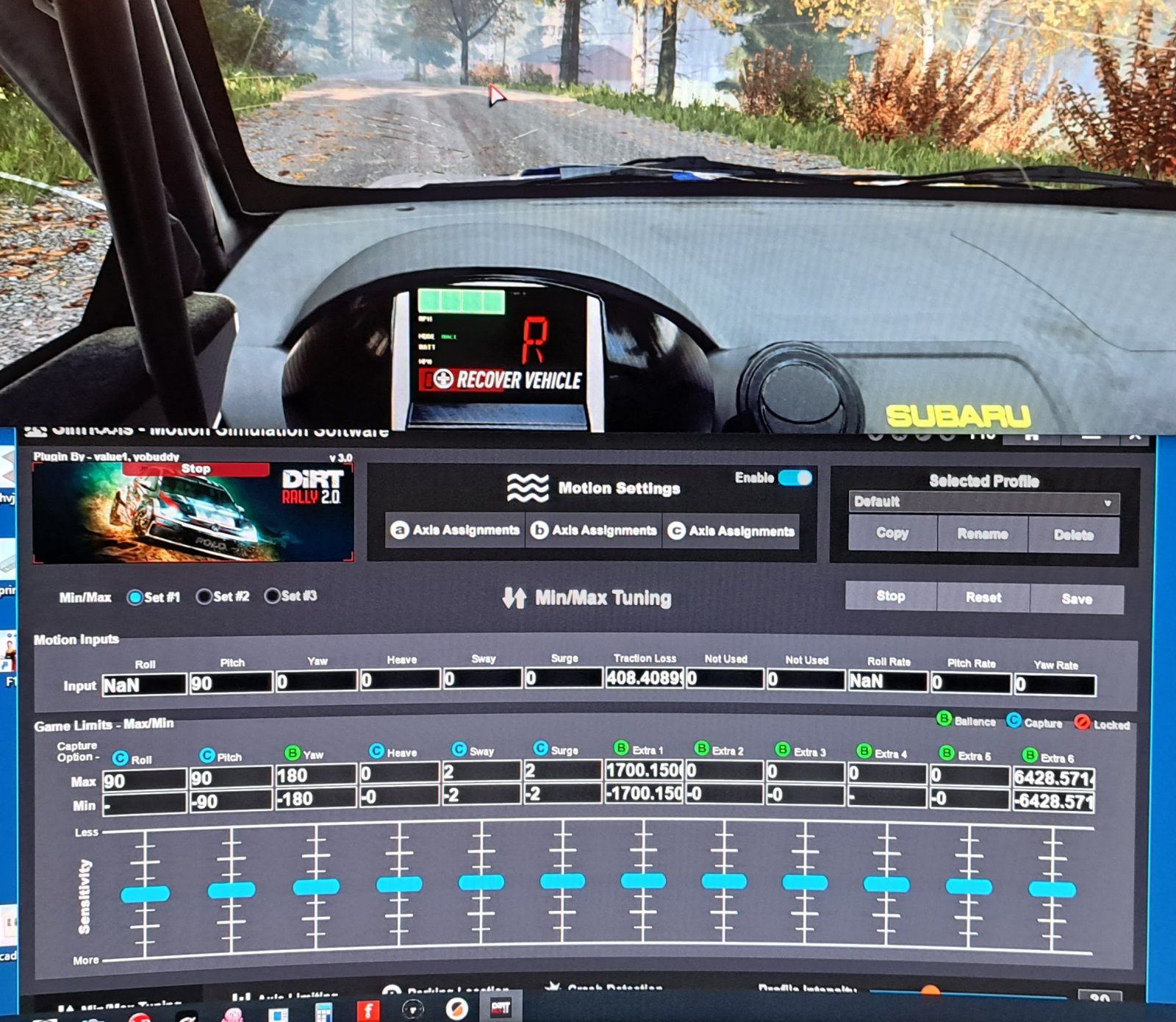

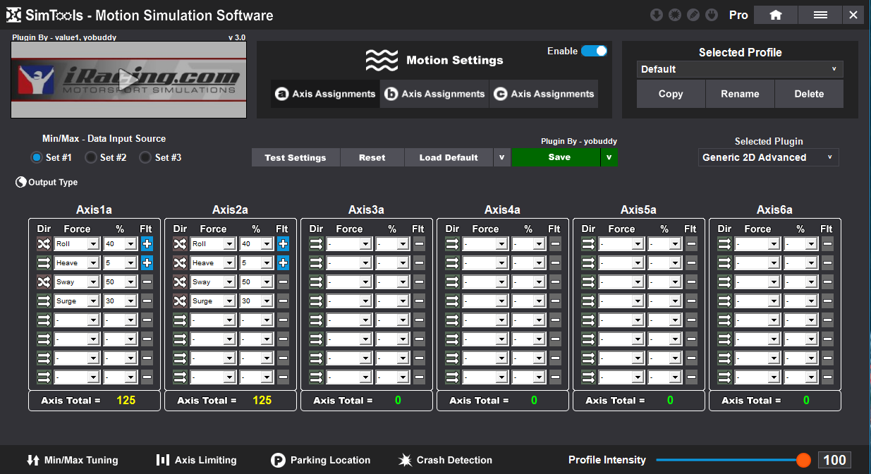

    I made another 2 videos to see difference from V2 which is working with no problems , but in V3 now with only roll activated the rig goes to one side at the start of the race on flat surface and start to shake . I had to stop it at the end of the video so nothing goes wrong. In the below pictures are my settings for both V2 and V3.
    V2 video
    V3 video
    https://youtube.com/shorts/EomSECZyy3Y

    What is your max/min value for roll in v3?
  13. ivan jack
    ivan jack Member
    Mar 10, 2019
    53
    412Coins
    +29 / 1 / -0
    10 , -10

    When trying to capture min/max settings "NaN" appears in both Roll and Roll rate fields.

    Please remove the plugin and restart simtools.
    Then reinstall the plugin from the repo and see how it goes.

    working now! thank you !

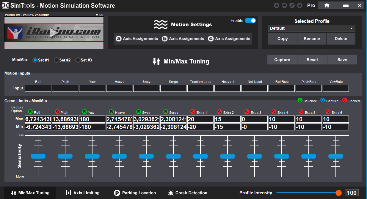

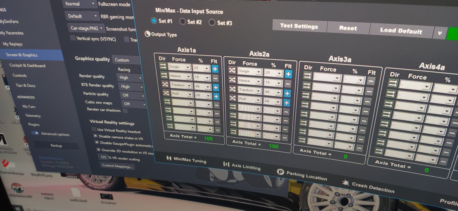

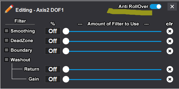

    Hello, I finally got it to work with the new software, I made these configs and I have some doubts, to capture max min can I always do the track I'm running or is it enough just on a track and use these settings for all? I also added antirollover to roll I read something out there that had to be used I don't know if I'm right or wrong. stay with the settings images
  19. noorbeast
    22,115
    154,316Coins
    +11,179 / 57 / -2
    When capturing a Max/Min it pays to use a mid-range track and car, then those results can be tweaked for other cars and tracks with specific profiles.
    Antirollover relates to what happens when the limits of the physical rig are exceeded by the game telemetry. For example, with traditional roll in a flight sim game the physical rig can't replicate the inversion of the transition to upside down, and will snap in an unrealistic manner to the opposite end of the axis movement range. Antirollover compensates for that in advance.
