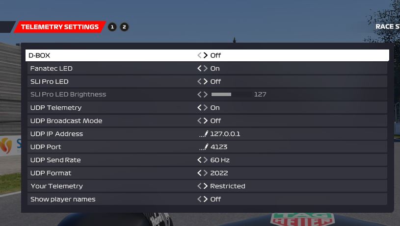

    I'm trying to setup F1 22 for GameDash and there are some weird telemetry values for rpm and gear (and maybe more). Speed seems to be ok. Did not touch game's telemetry settings after installing the plugin.

    I will take a look when I get to the office Monday morning.
    I will take a look when I get back to the office.

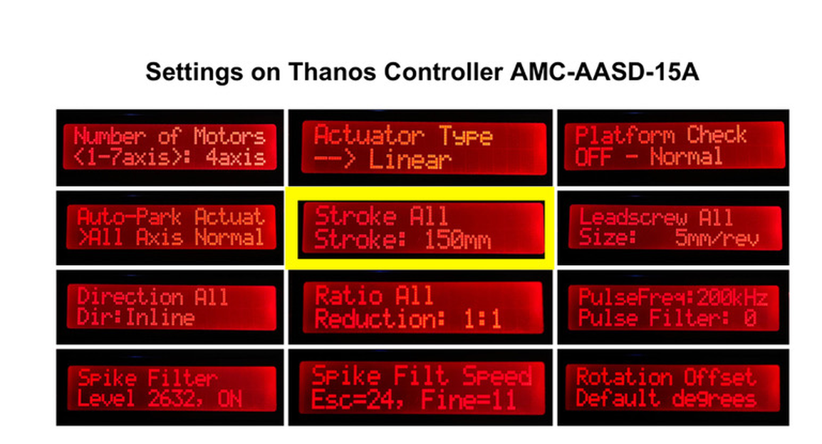

  14. lVlemphiz
    lVlemphiz Member Gold Contributor
    Jul 21, 2022
    41
    Automotive Engineer
    252Coins
    +15 / 0 / -0
    3DOF, AC motor, SCN6
    I do have anti-rollover on. How do I check the filters? Is that in the Thanos Controller? If you're asking about the controller, then here are the settings.
  15. lVlemphiz
    Jul 21, 2022
    41
    Automotive Engineer
    252Coins
    +15 / 0 / -0
    Unchecking anti rollover fixed my issue completely. I just need to tune the motion now. Thanks

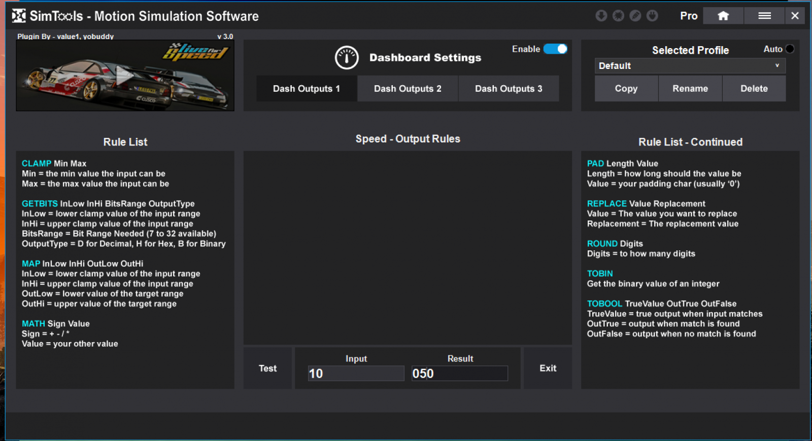

    Hi, trying to use Simtools V3 with wind sim. In V2 there was a save button on the dash edit page, I do not see one in v3 when done editing and I lose my settings every time I leave the screen and come back. I'm just trying to type in the:
    Math * 5
    Round 0
    Pad 3 0
    and save like in V2, but I can't figure out how to get the text to save... let me know what I'm missing (probably looking right at it, doh) Thanks for any help!

    @Richard Ortengren,
    Your settings should get saved when you click the 'Exit' button?
