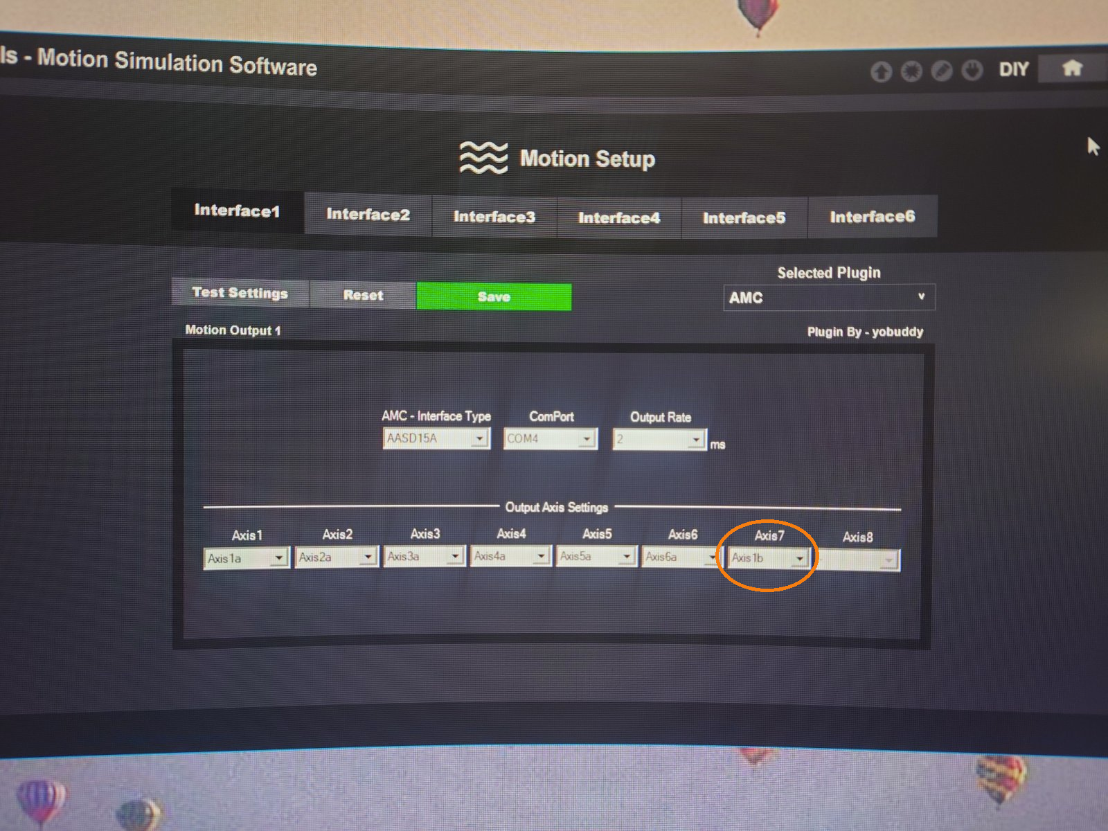

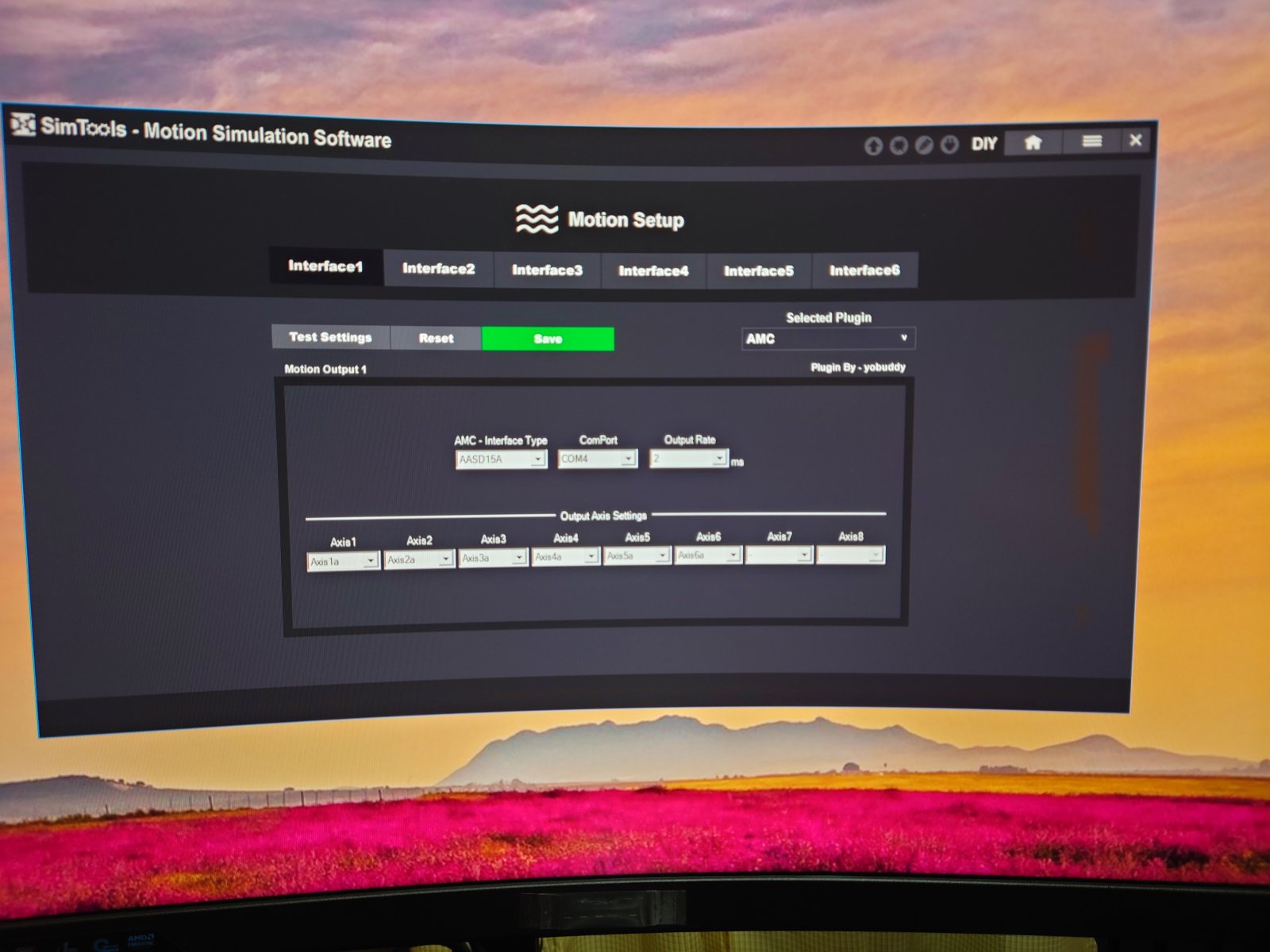

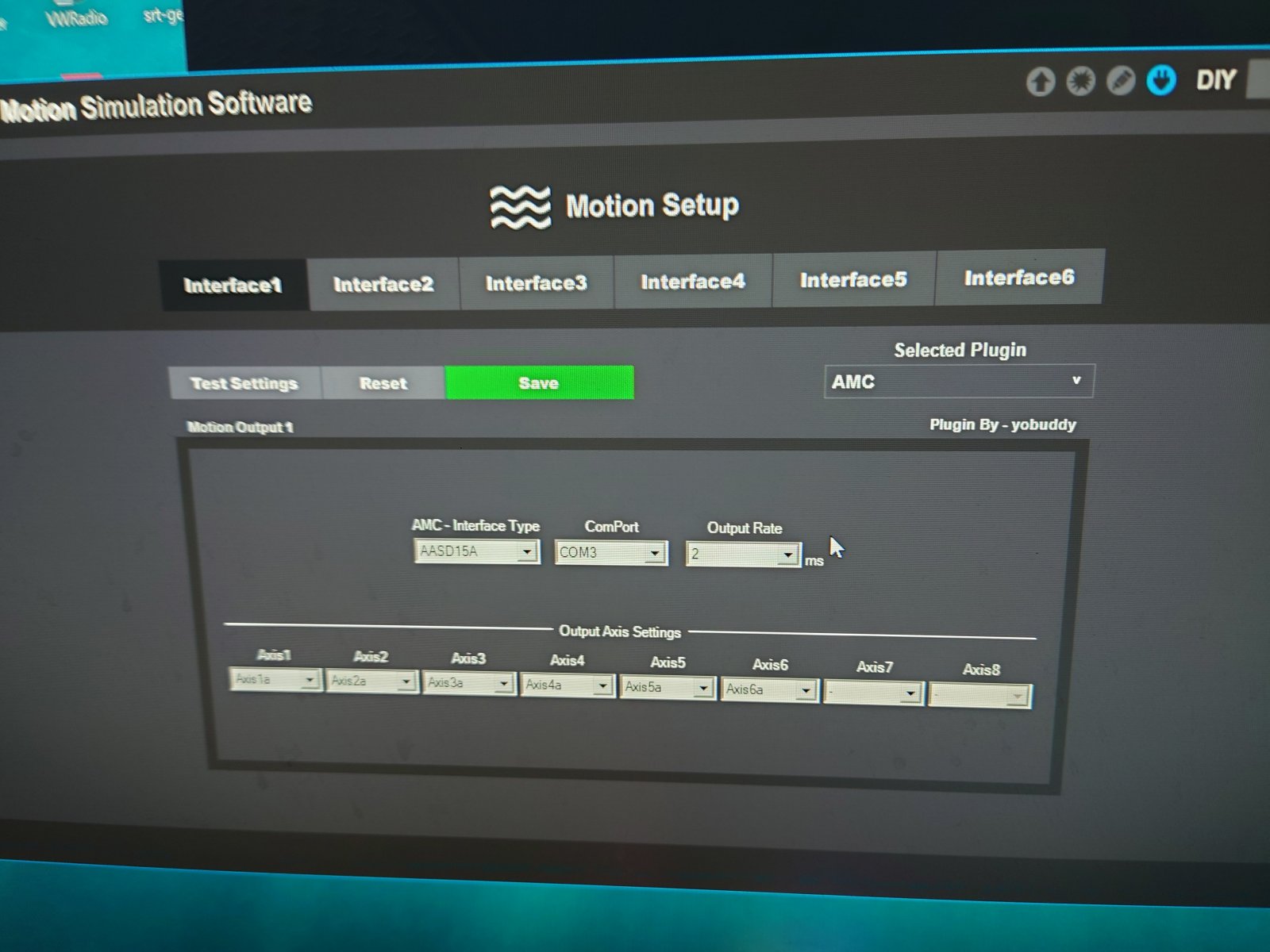

    +5,203 / 19 / -0
    The only difference I can see, is your sending the axis locations for 6 outputs in the ole settings above. But your sending the outputs for 7 on the new PC (as seen below).

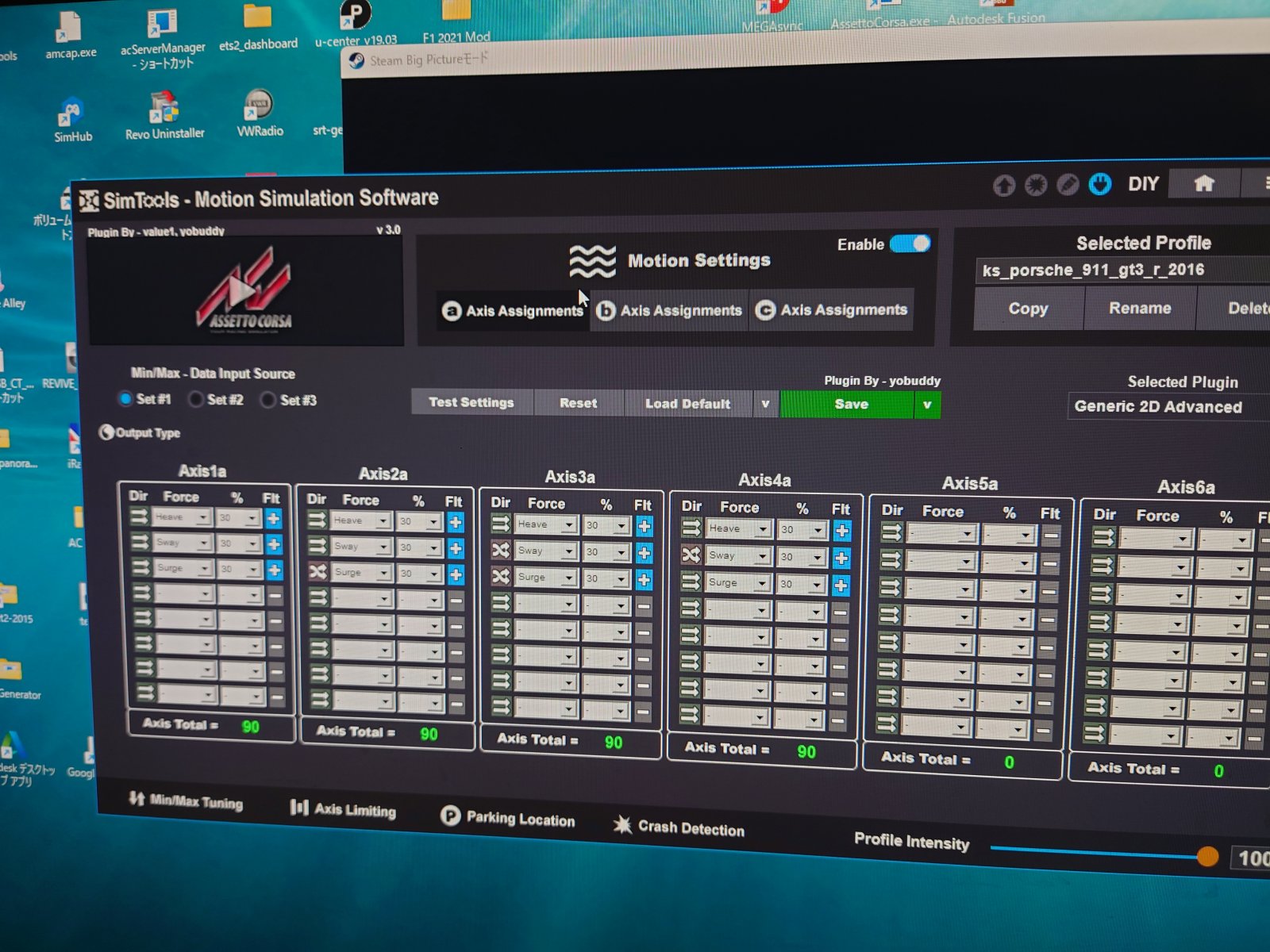

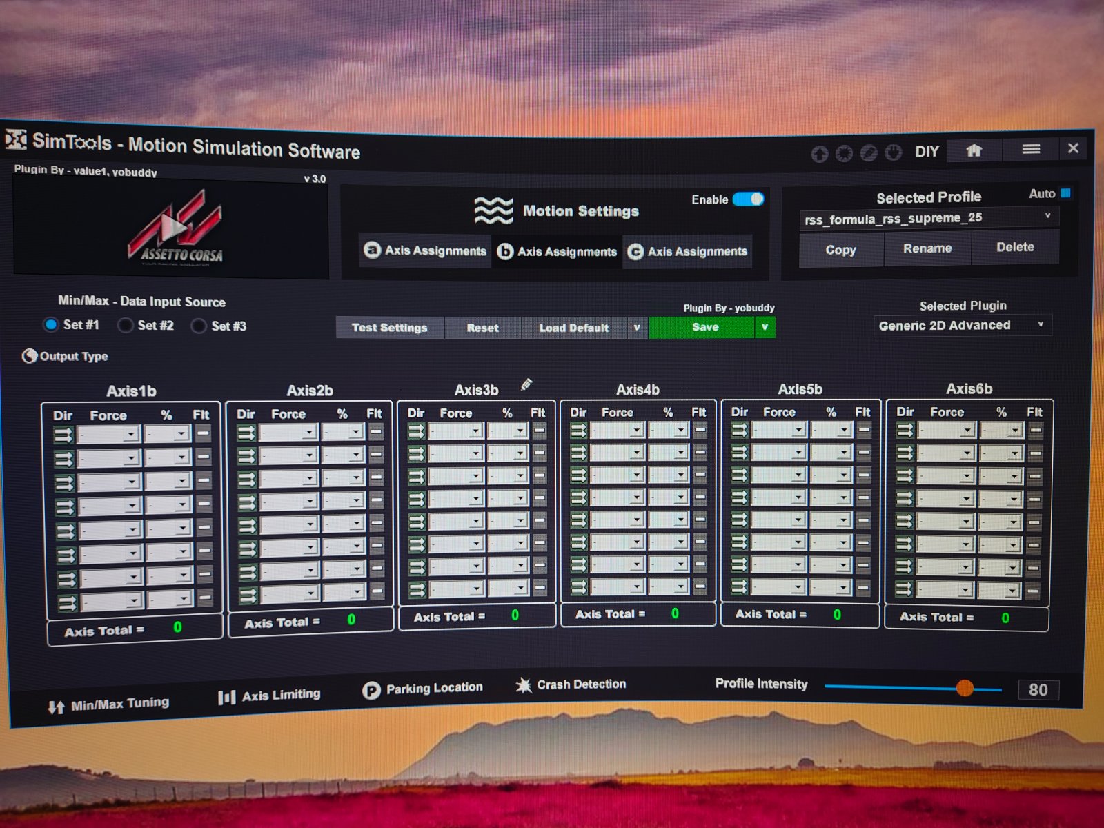

  4. saiRyu
    saiRyu Member Gold Contributor
    Jul 1, 2017
    32
    japan
    271Coins
    2DOF, SCN6
    I fixed the interface axis and added axis B, but the actuator still doesn't move.

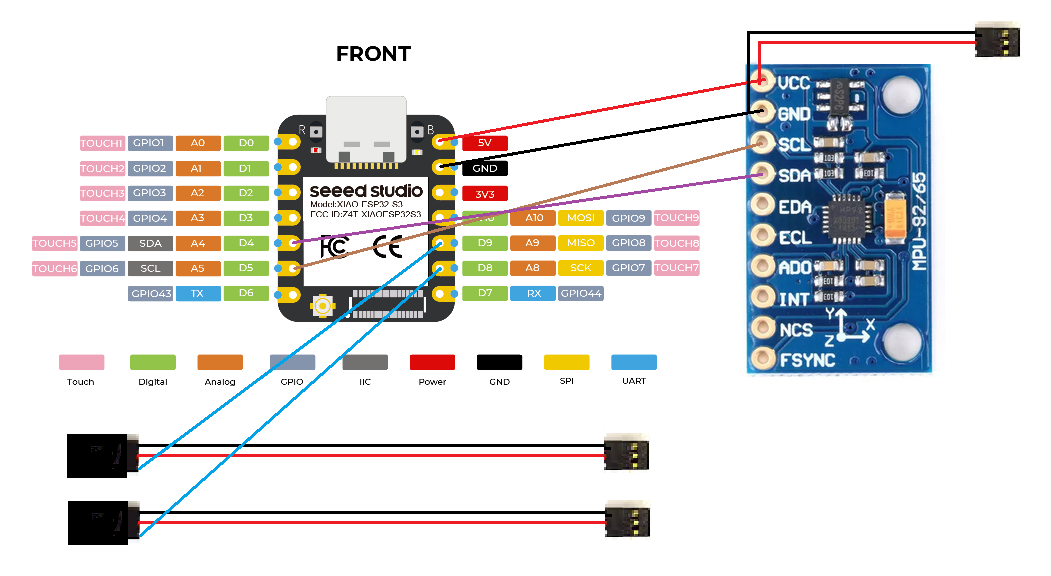

    @deeph46,
    I have been playing with an idea for v3 where 2 esp's directly connect to each other (over esp now) to not only receive rc-rider data, but also drive the rc car from the simulator itself. Esp now has been clocked to have a 1ms connection link that should make the ride a ton better.
    I'm not using this accelerometer pcb in this pic, but it gives a good idea of how the rc car side of things may look. This version connects to the original receiver for power, but a version that fully replaces the receiver is possible also with an added low battery alarm.
    And then the PC side of things
    I see no reason to think this would not make an super fast connection, but I have yet to give it a test to know for sure.
    May I ask what your setup looks like?
    Chat soon!
