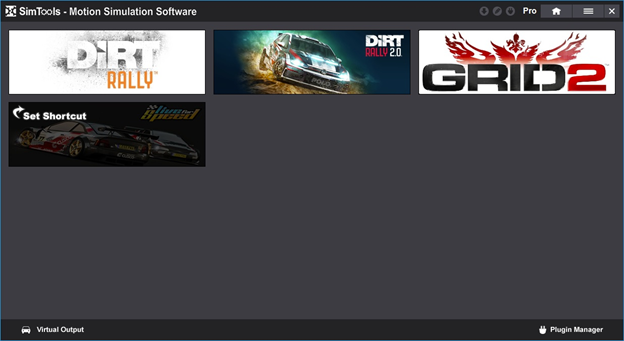

    The plugins for DCS and IL2 for SimTools V3 are both steam based. I am using DCS and IL2 non-steam based. Is there any plans to modify these plugins to a non-steam based version?
    If I had the source for the existing steam plugins I could attempt it.
  6. yobuddy
    51,774Coins
    +5,206 / 19 / -0
    I can't think of any reason why they would not work for both versions (steam and non-steam) with a simple shortcut update for the non-steam version. (so it will launch the right version).
    You may find that some game plugins do not set a launch path for a given game plugin, or the path is setup for a different version of the game than you have installed. To update a launch path for any game plugin, simply drag and drop the games exe or shortcut on the banner for the given game plugin.
    Let me know how it goes,

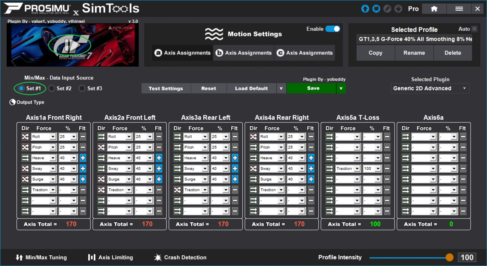

    Help Automating "Set #1" and Starting Motion Profile via CLI in SimTools 3
    Hello SimTools Community,
    I’m trying to automate the process of selecting Set #1 and starting the motion profile in SimTools v3 (for my Gran Turismo 7 plugin). I’d like to achieve this using the command-line interface (CLI) or any supported automation method to streamline my setup process.
    Here’s what I’ve attempted so far:
    1. Running the following command from Command Prompt:
      "C:\Program Files (x86)\SimTools3\SimTools.exe" -Set 1 -Start
      Unfortunately, this results in an error:
      "The process cannot access the file because it is being used by another process."
    2. I’ve ensured SimTools is already running in the background (system tray), but it seems like the CLI is trying to launch another instance instead of communicating with the active one.
    My Goals:
    • Select Set #1 (or any profile set, like Set #2).
    • Start the motion profile directly.
    Questions:
    1. Does SimTools v3 support CLI commands like -Set and -Start when SimTools is already running?
    2. If not, is there another recommended method to control SimTools (e.g., a scripting API, hotkeys, or external tools)?
    3. Are there any specific settings or configurations I need to enable for CLI commands to work?
    Any help or guidance would be greatly appreciated. Thank you for your time! Screenshot 2024-12-16 230915.png

    That is what is implied by the manual. I did drag the .exe onto the plugin and clicking on the plugin it did not start DCS. Is there a directory where this data is located to check the change?
    The game plugin tutorial mentions ;
    _GameOrigin : I am interpreting the text as Not steam so it should be CD ? so,
    Create_LaunchShortcut(IPlugin_Game_V3.Shortcut_Type From_Exe, MyPath & "DCS.exe")
    How ever the way MyPath variable is assigned.
    I believe that this is at the compile level of the plugin to change this?

  10. yobuddy
    51,774Coins
    +5,206 / 19 / -0
    Did you double click the play button?
  11. BrassEm
    BrassEm G-Seat + SFX100 Builder Gold Contributor
    Apr 15, 2015
    135
    NE of YMML
    1,102Coins
    +51 / 0 / -0
    DC motor, AC motor, 4DOF
    Did not even think of that. I saw the play image and kept single clicking to play. (I watch a lot of youtube vids daily so it was an automatic response single click.). DCS starts up now. :thumbs
