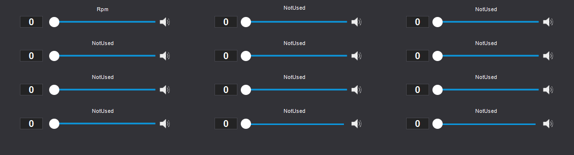

    Is RPM the only GameVibe effect available in iRacing plugin?
  2. yobuddy
    51,704Coins
    +5,204 / 19 / -0
    Yes, for right now anyway.
    But I will go back and deck it out later.

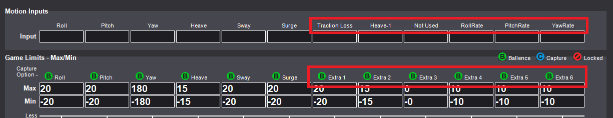

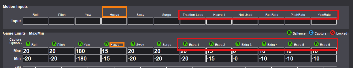

    Just to be sure what I was mentioning:
    Those 2 lines are "duplicated", but with different labels.
    I was suggesting making the second equal the first.
    I didn't understand the "5 or 6 charts" you mentionned.

  9. yobuddy
    51,704Coins
    +5,204 / 19 / -0
    I understand, but the bottom one has less room because of the button.
    Top one has 2 rows for text, bottom one has one row because the buttons in the way.
    We could move the button, but I'm not sure were yet.
