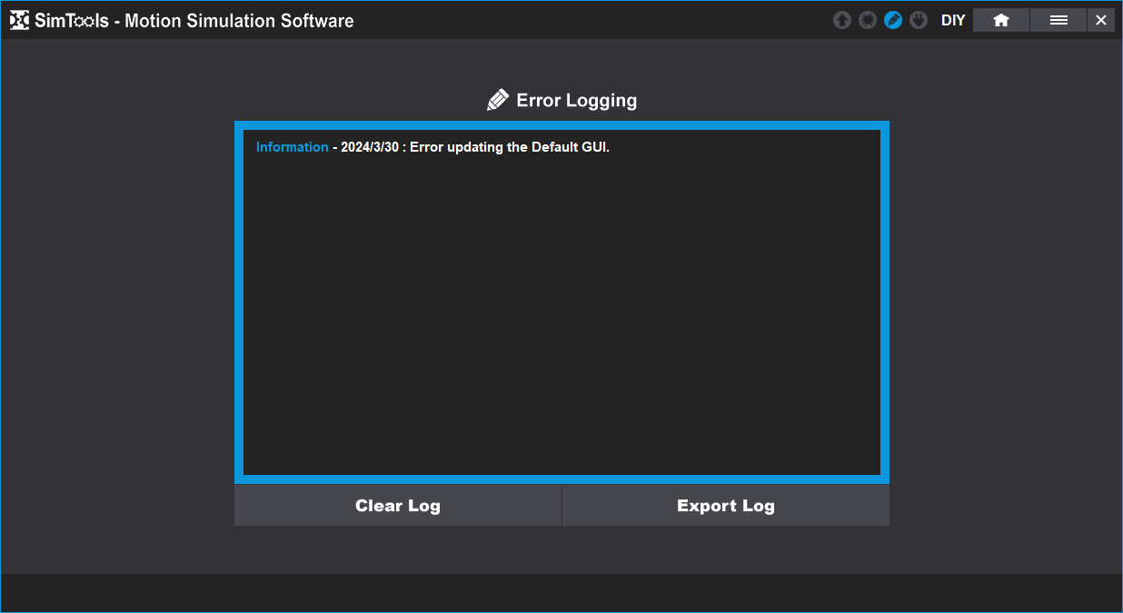

    My computer suddenly disconnected, SIMTOOLS Error updating the Default GUI.

    What should I do about it
  13. yobuddy
    51,531Coins
    +5,204 / 19 / -0
    If your using the alpha version still, it's definitely time to switch to the beta version.
