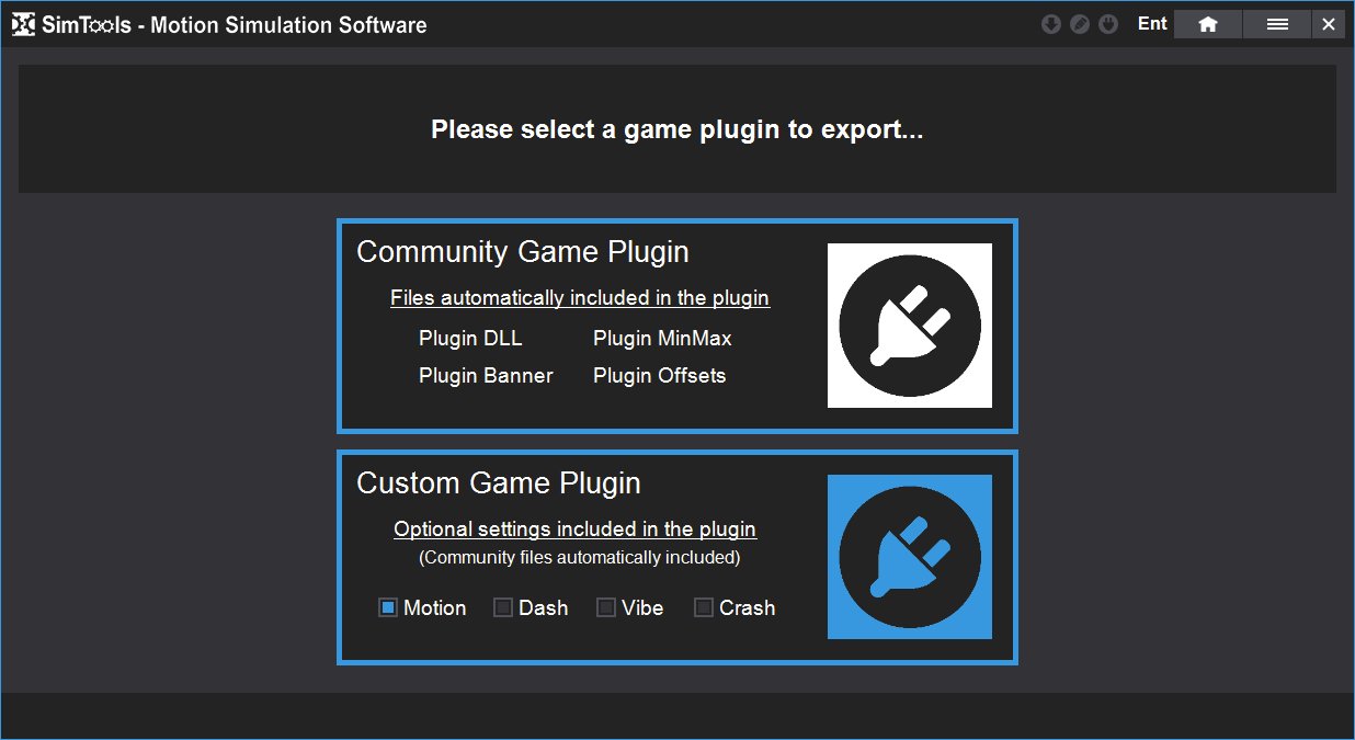

    Next, it takes time to configure games, so we should be able to back these up also, and now we can.
    Goto the "options / exports" and select Game Plugin, then custom plugin
    Notice you can add all of your motion(axis profile), Dash , vibe, and crash settings to the plugin.
    Lets export a custom game plugin now!
    Ok, sweet we have both a Setup plugin and a Game plugin!

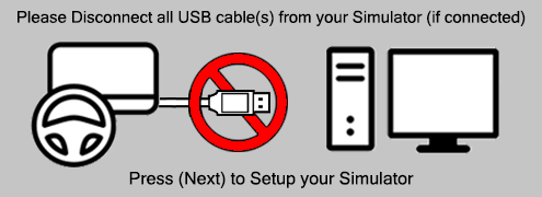

    If we now remove SimTools from our PC, and install the current version of v3, we can re-setup by simply drag- dropping the setup file into the main gui!
    It will ask you to unplug you simulator and replug it in so it can correct a com port if a com port is used in your interface settings.
    We disconnected and press next (not shown here)
    We connect it and it does this:
    SimTools restarts and everything is setup.
    Meaning all your interfaces are setup and the axis plugin are setup.
    Next we drag-drop in or game backup, and bam! lol its all setup again with all of its axis profiles.
    We just need to hit play!

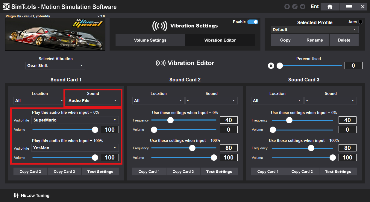

    Bug/Error? When trying to test the gear shift sound in Vibration editor this error occurs. It locked the program up the first time but after a restart it no longer locks up the app when the error occurs.
    Critical - 3/26/2022 : SuperMario audio file could not be found
  13. yobuddy
    51,535Coins
    +5,204 / 19 / -0
    LOL, its looking for my test file.
    Please under 'Sound' de-select audio file.
    Looks like weapon flairs is like that too.

    So GameVibe has a few new tricks up its sleeve!
    You can, as always, create live sounds for any of the inputs.
    But now you can also trigger audio files!
    You can trigger a audio file when an input hits 0 and/or when it hits 100%.
    So take landing gear as an example, you can create a sound for landing gear up and one for landing gear down.
    And then trigger them to play with the landing gear input. (auto de-bouncing is applied)
    You can Drag-Drop mp3 audio files directly in SimTools (main gui) and then use them in game vibe!

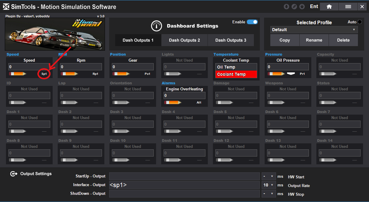

    Pushed an update with all the Dash plugins (except memory mapped).
    So dash should be fully usable now!
    To assign dash vars with v3, you use the label for the entry, example shown circled in red.
    If little white down 'tabs' appear (you can see one on Pressure) you can select an entry to show, as the section has more than one entry.
    Hope that makes sense, chat soon!

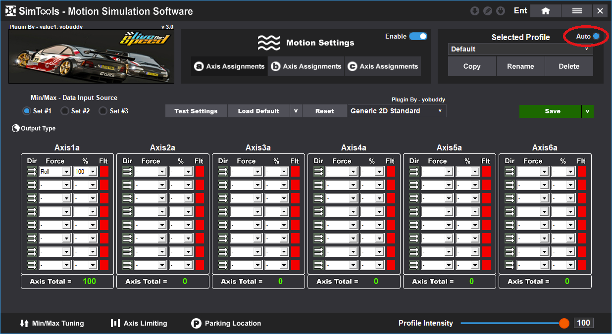

    For a game that supports auto-profiling, you can turn it on here!
    And it will auto select/create a profile for the vehicle currently being used in the game.
    Chat soon!

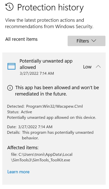

    I like the automatic update, but is there something we can do about windows blocking it every single time?
  18. yobuddy
    51,535Coins
    +5,204 / 19 / -0
    Windows defender? lol
    The files are digitally signed, so once the cert has enough street cred, it should not be a problem anymore.
    With that said, I have tested AVG free and Avast Free and they are working great!
    I may have to submit the end file to get defender to chill out lol.
    but I'm updating so much right now it does not really make sense yet.
    White listing simtools in defender may be a good option too.
