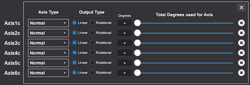

    All Axis Plugin Updated!
    New Advanced Axis Plugin Available which has native support for Seat Belts and G-Seat platforms. (Axis Type)
    The Advanced Axis plugin allows the user to put an Axis in Normal. Gain Only, or Decrees Only mode. When in Gain Only, or Decrees Only mode, the full range of the axis is used with only the positive inputs from a given DOF. Gain Only mode moves the axis from negative to positive (usually extending an actuator), where Decrees Only mode moves the axis from positive to negative (usually collapsing an actuator).
    Please let me know how it goes!
