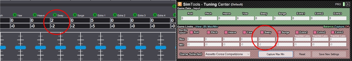

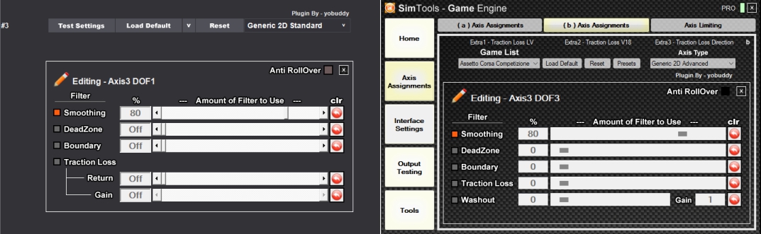

    It was actually set to <Sp1> If I set startup to <221><0> it crashes. If I set it to <221> it doesn't crash but the fans don't start.
    Regarding the smoothing issue, here are the axis and tuning centre settings compared.
    Here's the video showing the different smoothing.
    You can see from the sliders, especially sway and axis 3b the smoothing is completely different.
    I hope this helps :)
  8. yobuddy
    51,704Coins
    +5,204 / 19 / -0
    They both look like they are smoothing to me?
    The engine of v3 is faster for sure, so you may want a bit more smoothing.
    Also the screen update rate of the 2 virtual windows may be different, I would have to check that.
    I'll take a peek at the startup dash line, see if i can see anything.

    We must be seeing different things ;) V2 output is slower compared to the input but with far more smoothing. V3 is on 80% now so I'm running out of head room if it's faster.
    The sway on 3b on my system is throwing over 250KG from side to side and it's undriveable on the V3 software.
  12. yobuddy
    51,704Coins
    +5,204 / 19 / -0
    Please try setting the limits to +-3, with a bit more range they should calm down a bit.
    Making it so there is more smoothing headroom is possible also.

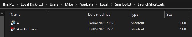

  19. early_m
    early_m Active Member
    Jul 28, 2016
    345
    Chelmsford
    899Coins
    +360 / 5 / -0
    OK, so here's what I've discovered.
    The shortcuts folder had a shortcut in it called '90' which was linked directly to AC in steam. So everytime I clicked play it was doing what it should.
    So I deleted that and dragged in the content manger exe to the banner and got this:
    Clicking play did nothing.
    So I changed 'Assetto Corsa' to '90' and it successfully opened content manager. But it does not launch the game, you still have to click 'go'. But thinking about it, I don't think a content manager user would want it to go straight into the game as you'd then be unable to change car/track/settings etc. Personally, I'm happier to launch AC via Content Manager and then start the plug in manually.
    Anyway, this didn't have any result in fixing the wind sim/dash issue (if it was meant to?!).
    I've discovered with dash that there is no 'pause' or 'reset' feature like there is with motion. For example, when I pause the game the motors return slowly to their resting/parked position, and when I resume the motion picks back up again. When I pause the game dash doesn't seem to do this and the fans spin at their last data speed sent by simtools. It would be good if they did the same as motion. So when I pause the game, the fans power down and then pick up again when I resume the game. The same is for when I exit the game. The fans seem to stick on the last bit of data they were sent. If I start a new game (loading from CM) they just spin at max speed and have no control from simtools.
    Any ideas?!
    EDIT: thinking about it - the motion soft start may be due to the SMC3 code, so perhaps the wind issue I'm having is also down to the arduino code?
  20. yobuddy
    51,704Coins
    +5,204 / 19 / -0
    Big help buddy, I see the problem here.
    It needs to use the online ID, '90' in this case, rather than the plugin name...
    I'll get this fixed, I should be able to get a lot done this weekend.
    Once we add content manager to the plugin. we can have the play button launch the content manager, and when content manager launches the game it all will just work. In fact SimTools will think the game is running until content manager is closed. Should work a treat I think.
    It's setup to do this, must be a bug, I will get it fixed this weekend buddy. :thumbs
