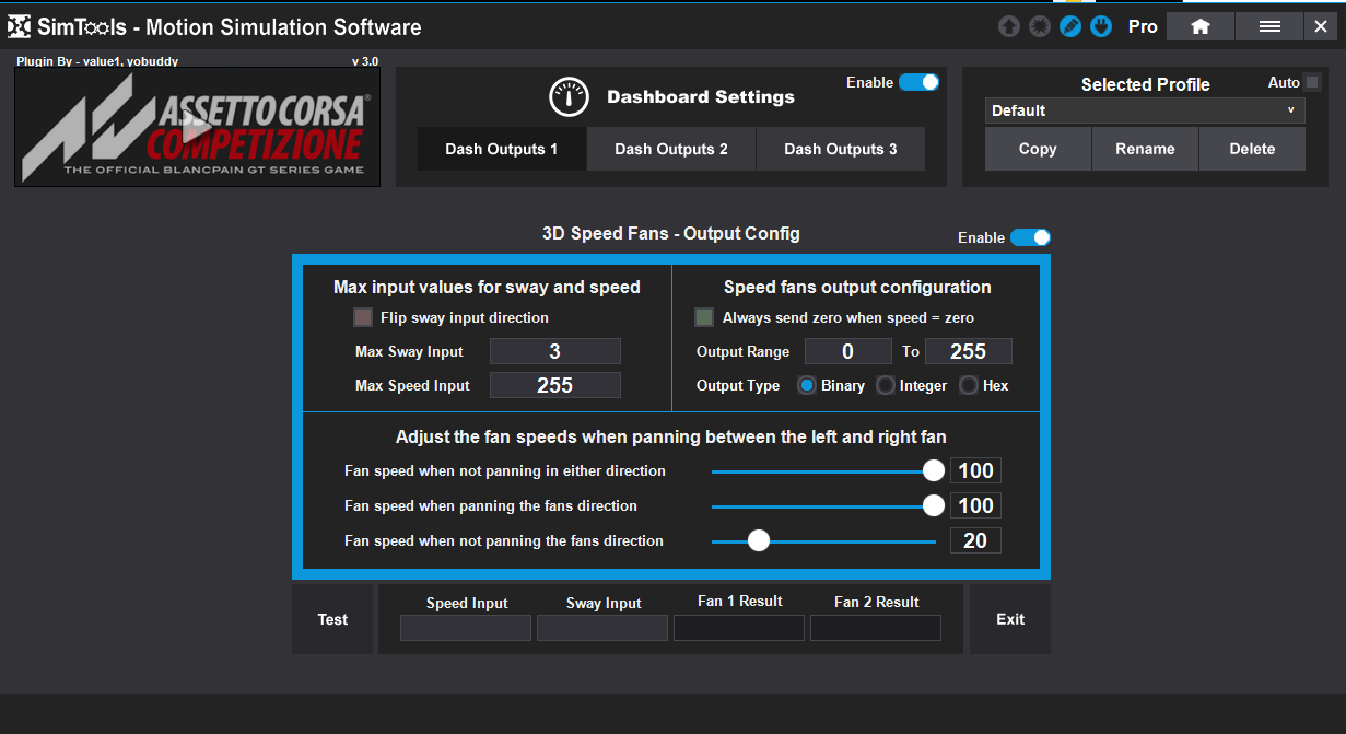

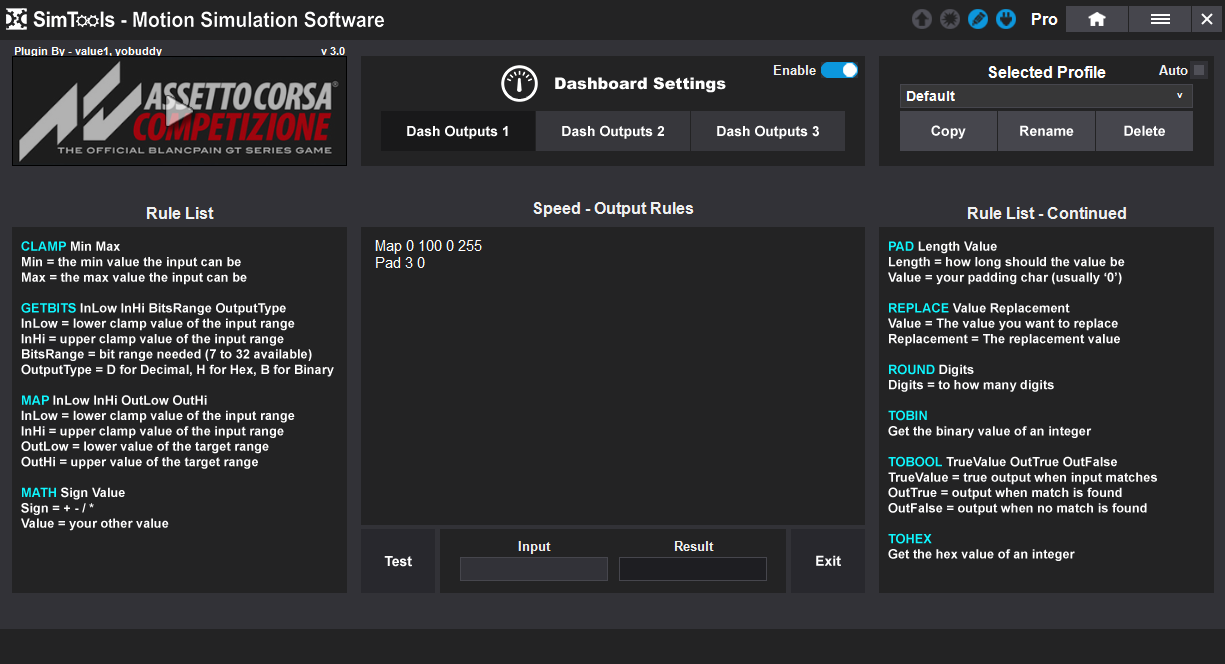

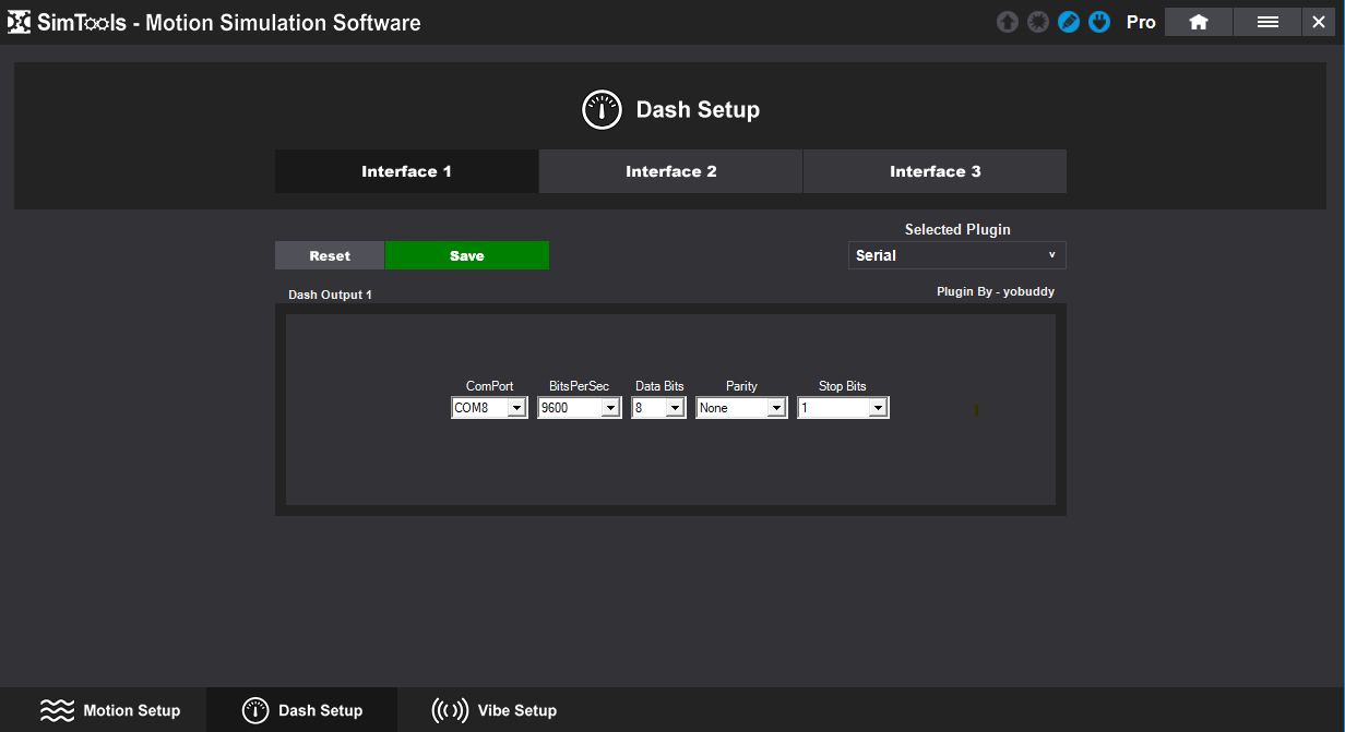

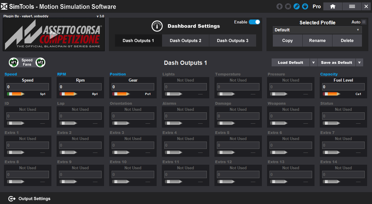

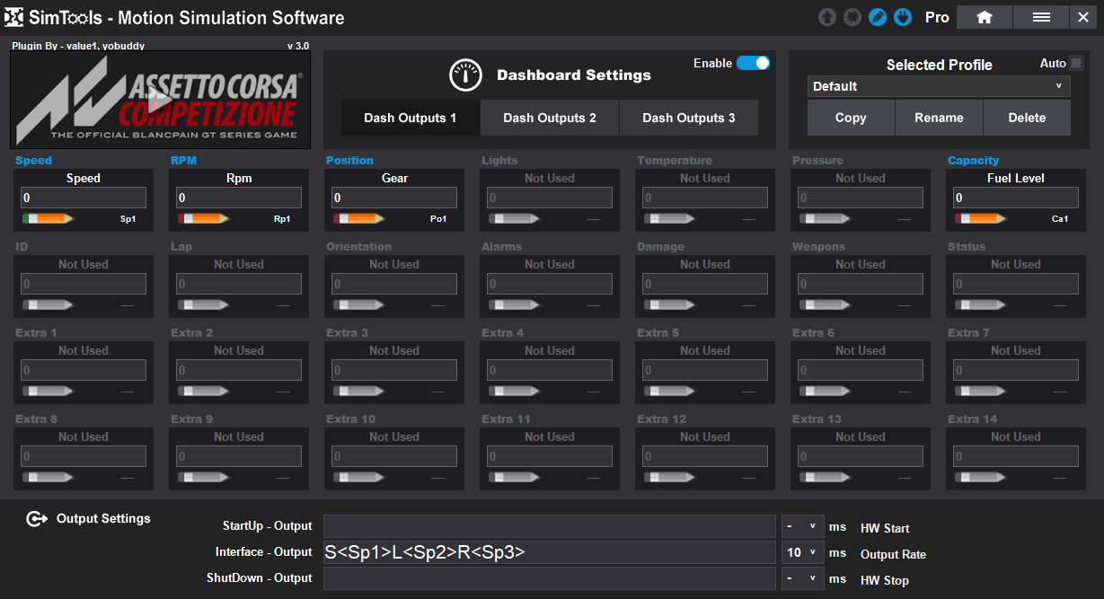

    Now lets get to the SimTools settings:
    Screenshot 2026-02-06 112035.png Screenshot 2026-02-06 112054.png Screenshot 2026-02-06 112107.png Screenshot 2026-02-06 112120.png Screenshot 2026-02-06 112133.png
    The settings are still not perfectly set up (for my point of view). But at least this is a working setup and the rest is fine tuning.
