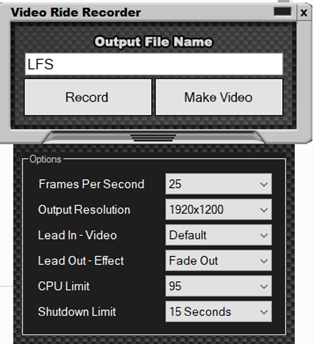

    Here are a few more details on the Video Ride Recorder. :thumbs
    Frames Per Second: the Frames Per Second you want your video at.
    Output Resolution: Upscale and Downscale as needed.
    Lead In - Video: the clip shown before the ride film. (gives you time to sit back and get ready.)
    Lead Out - Effect: The end of video effect you want for you flick.
    CPU Limit: The maximum Cpu value.
    Shutdown Limit: Stop recording if Cpu Limit is reached for x seconds.
    And here are the setup screenshots (also included in the zip file)

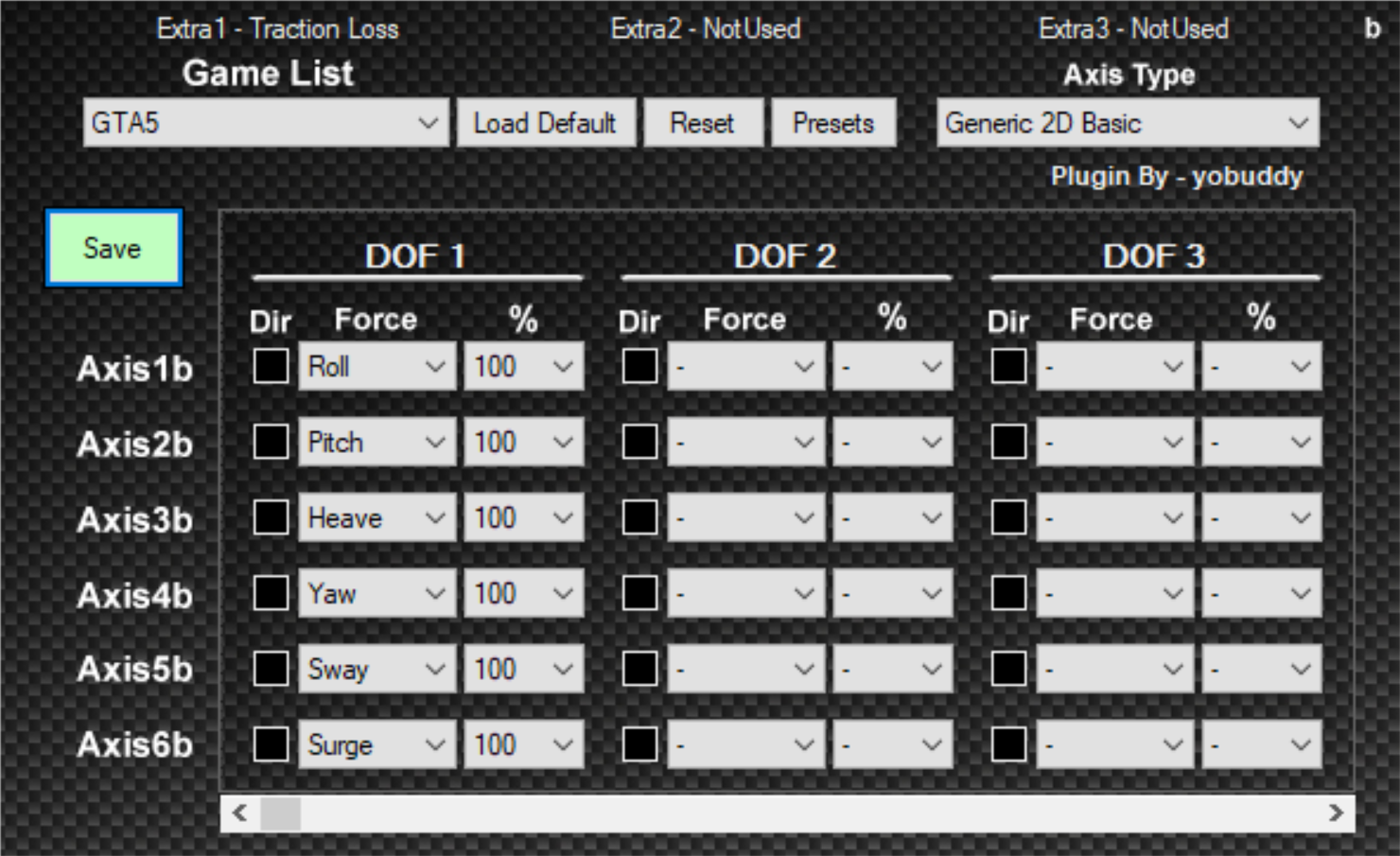

    Notice I'm using the ( b ) Axis Assignments.
    (If there is no Traction loss, use Yaw for the output show as Extra1 below)
    That's all there is to it! :cheers

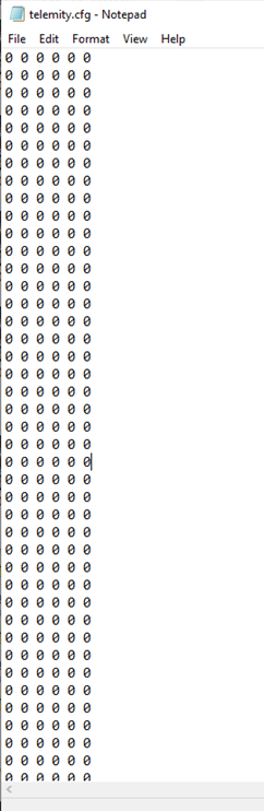

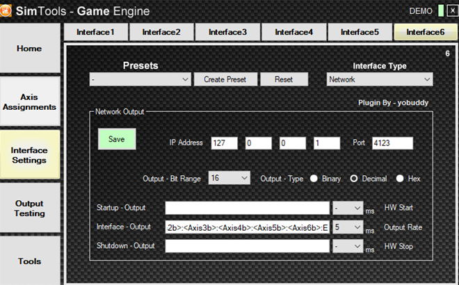

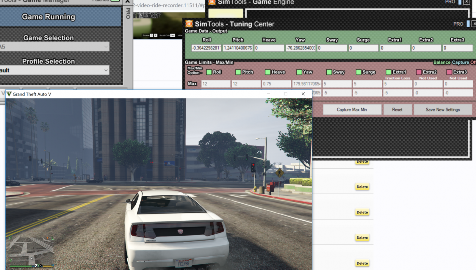

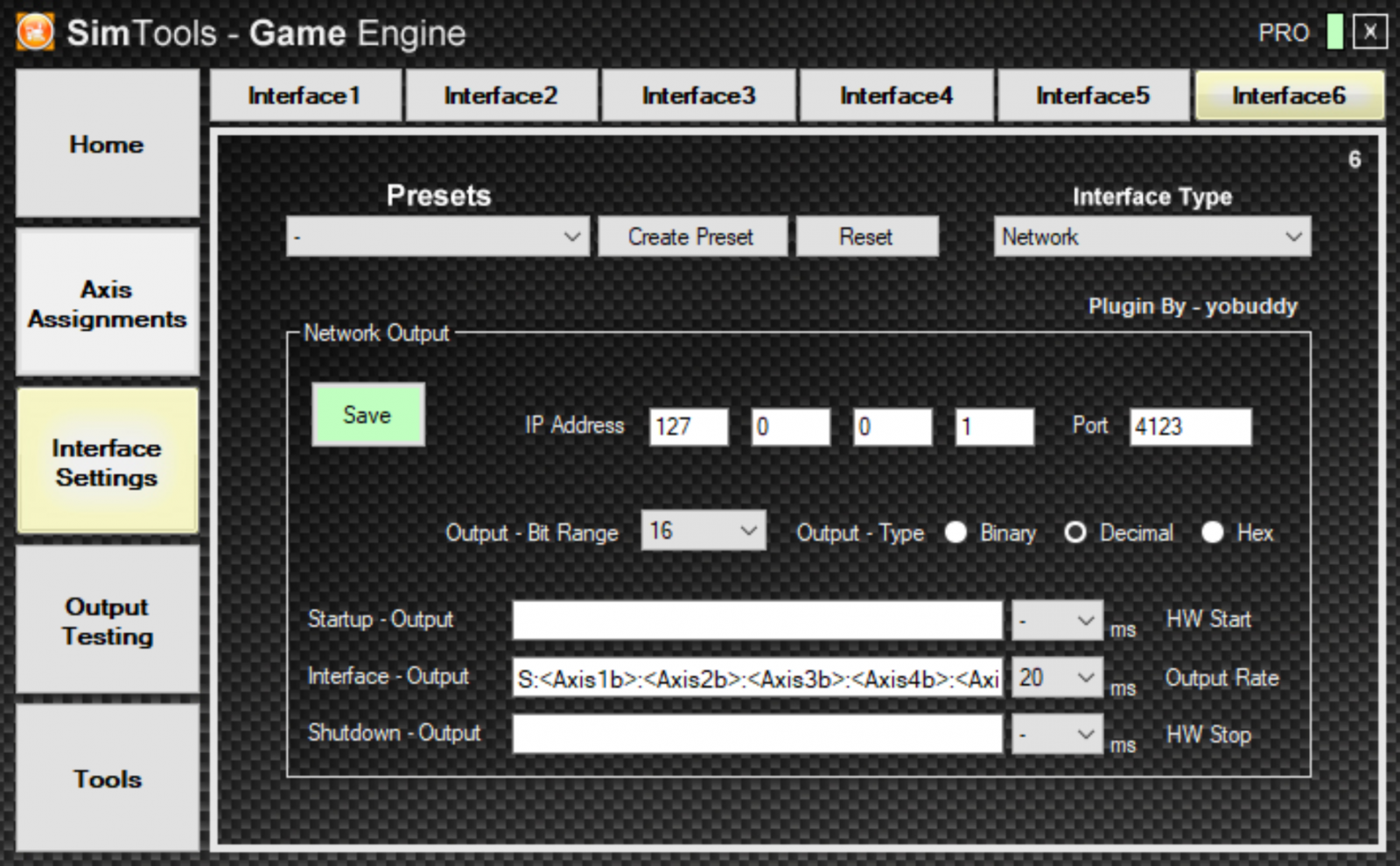

    I used this recorder to record GTA5 but there was a significant telemerty data loss.
    There were only very few lines that were not zeros.
    This is just part of the telemetry log.

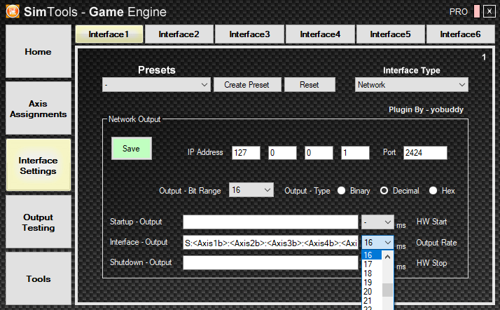

    This is my game engine interface setting:
    And my recorder setting:

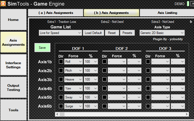

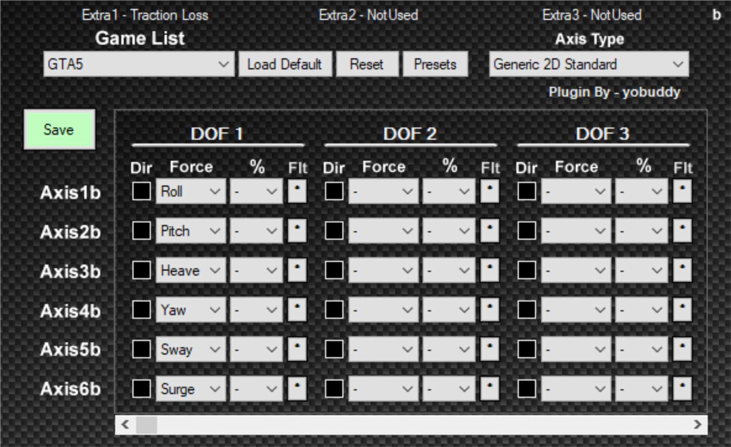

    Did you setup the axis assignments for the game?
    If so, then refine the max / min settings for the game.
    And you will get better data.

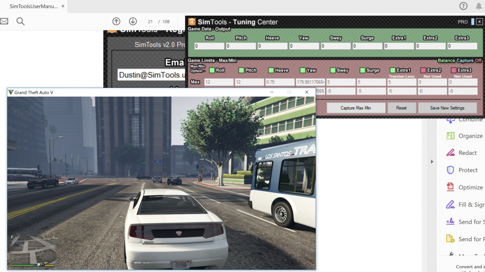

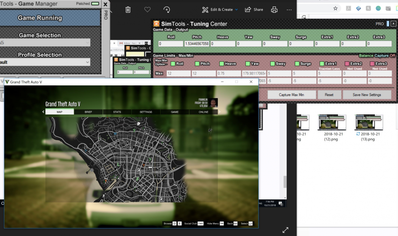

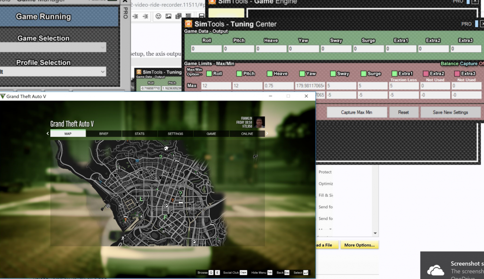

    I used the axis assignment as follows

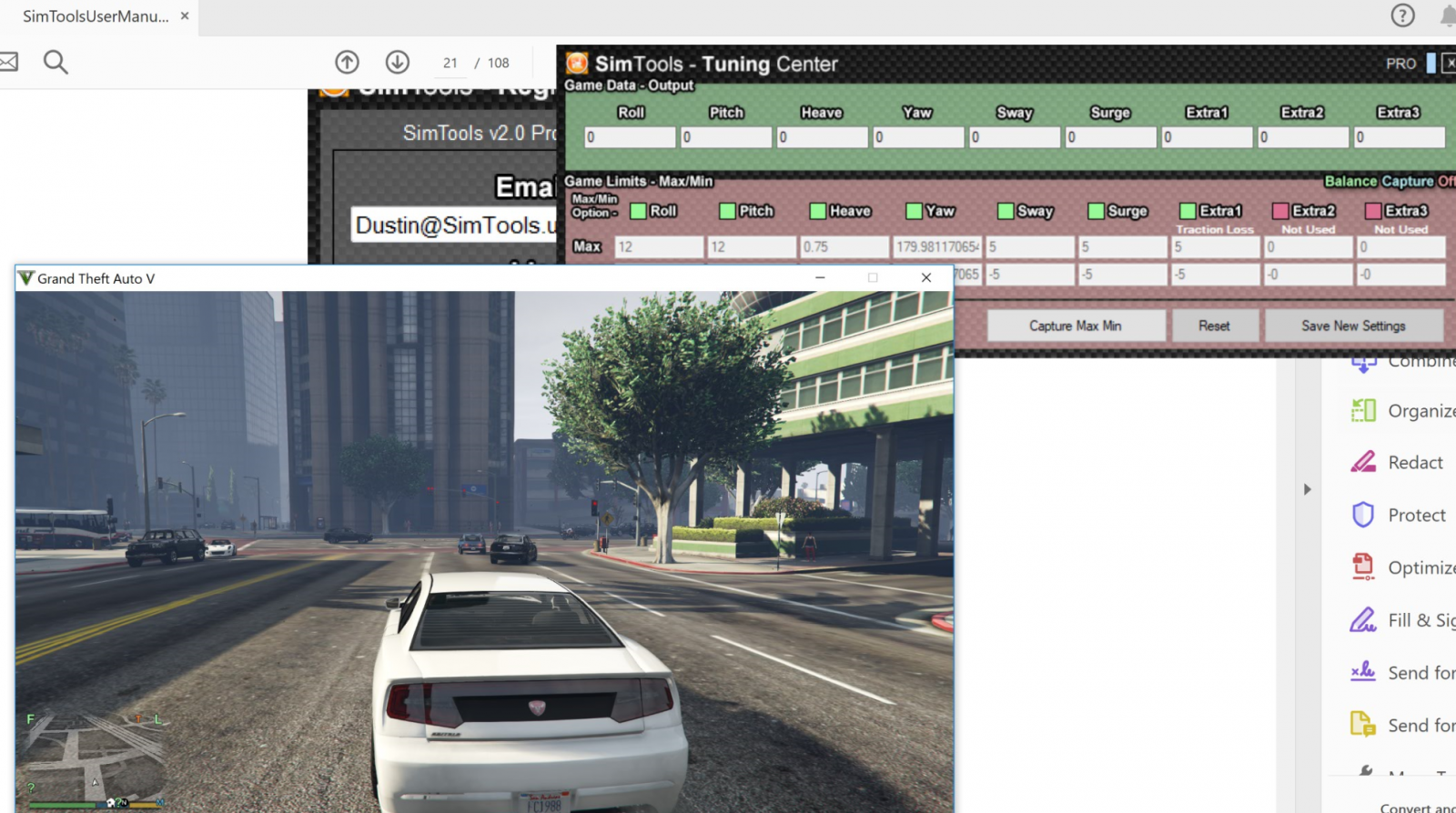

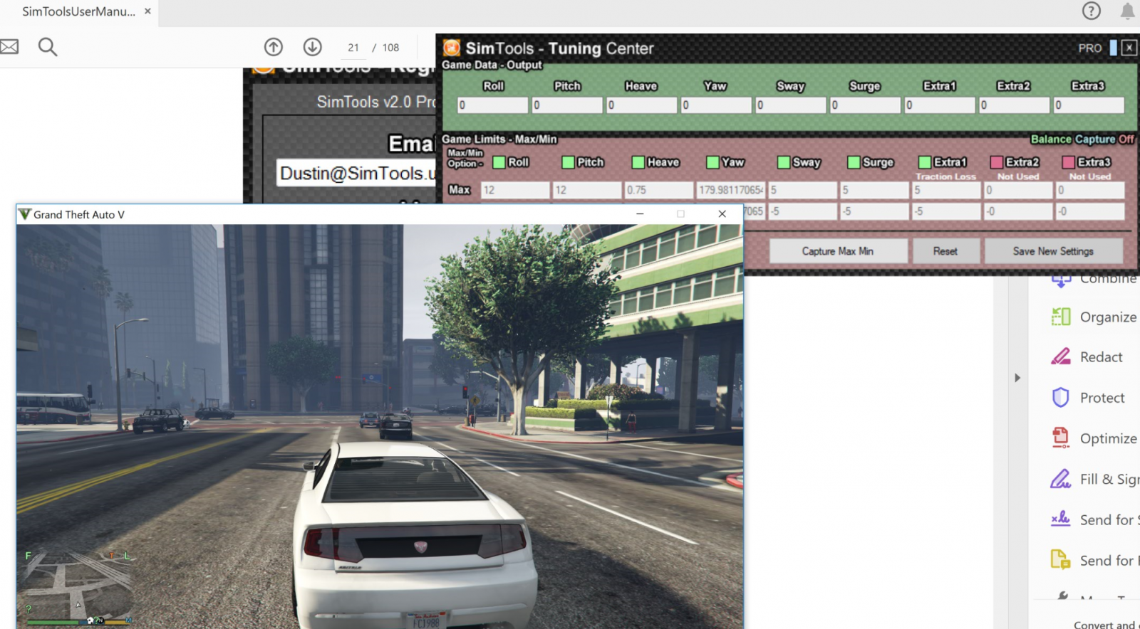

    And I found that, if I use the suggested interface setup, the axis output will maintain zero for the most of time and only output occasionally:
    As you can see, I printed screen 4 times in a row, only 1 of the 4 pics were showing the correct output.
    And even if I am in the pause menu, the simtools kept sending wrong outputs.
    The GTA5 plugin works perfectly when interface setting were reset.
    Could you please help me with this abnormal functionality if I use the suggested interface setting? @yobuddy Thank you very much!
  7. yobuddy
    51,736Coins
    +5,205 / 19 / -0
    Please try a different game, so we can isolate the problem.
    Seems like a plugin problem, not a Video Ride Recorder problem.
    Let me know what you find buddy!

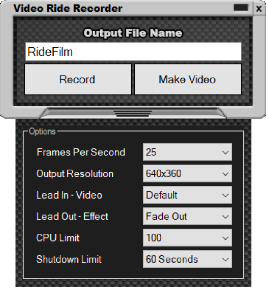

    I am using the following setting for the simtools
    The profile for the plugin
    Video recorder setting
    raw telemetry data
    this is an updation following the GTA5 issue.

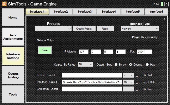

  10. yobuddy
    51,736Coins
    +5,205 / 19 / -0

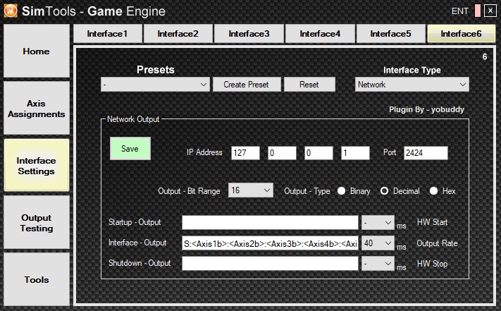

    The port number for the interface setting should be 2424.
    (like in the setup pic)
    Since your settings is for a 25 fps video, you can set the output rate to 40.
    (Because there is 1000ms in a sec, and 1000 / 25fps = 40.)
    Also, since this game has Traction Loss, use it instead of Yaw in the Axis Assignments.
    Please adjust your settings as needed and try again buddy!
    Take care,
  11. HAOTIAN SU
    HAOTIAN SU New Member
    Aug 10, 2018
    12
    3Coins
    @yobuddy Thank you very much! The recorder is now working on both LFS and GTA5.

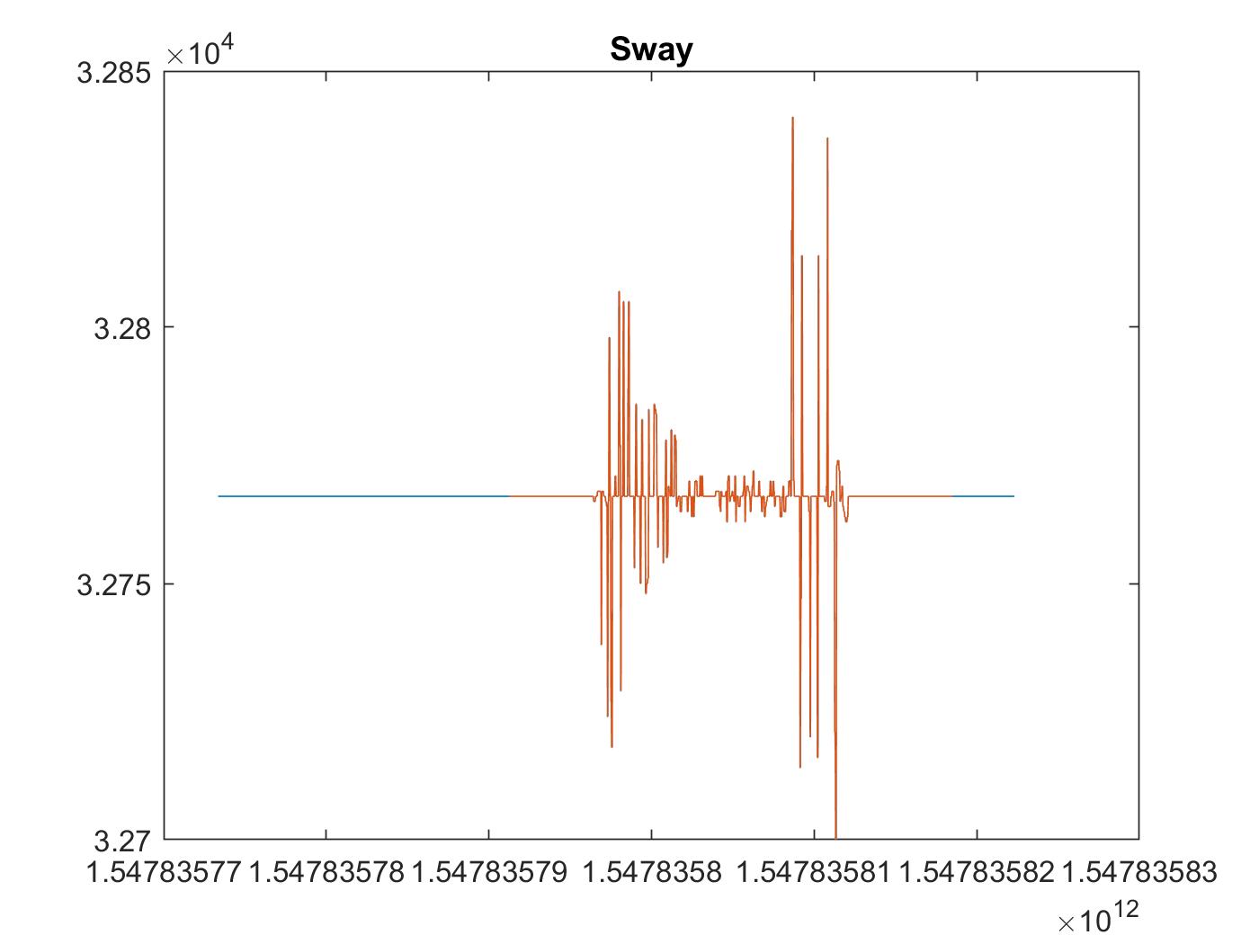

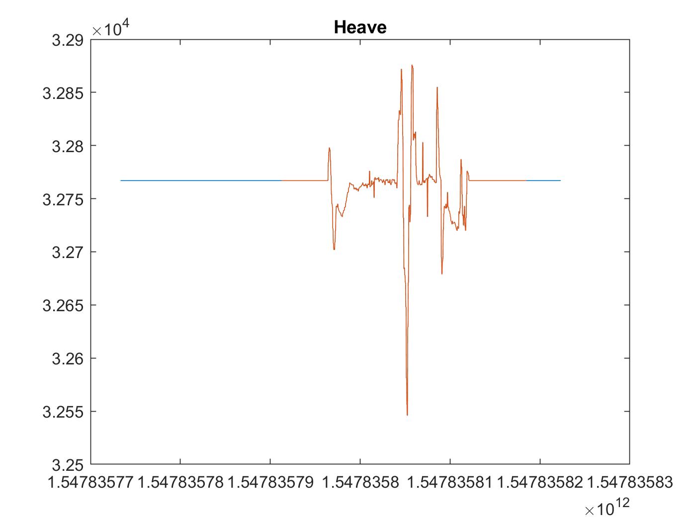

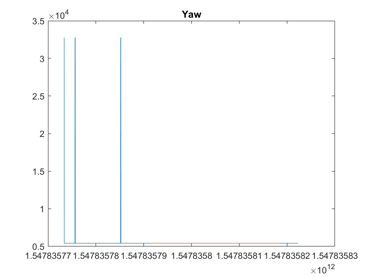

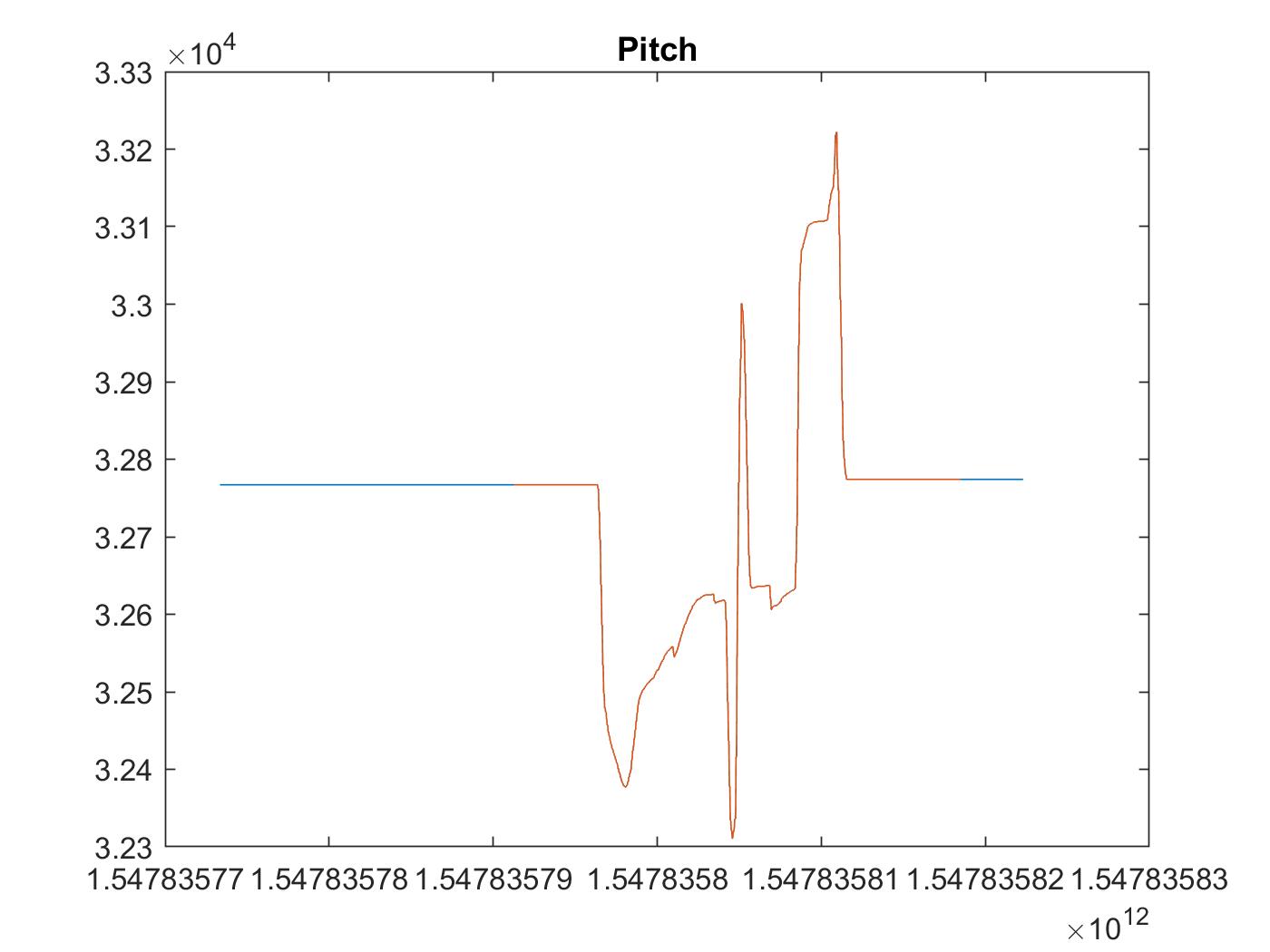

    Hi! I have found alternative way in which I can record video and motions at the same time.
    I was using Fraps for video capture and a UDP server to log the DOF data with timestamp. Then I manually edited the DOF log to match the time of the video.

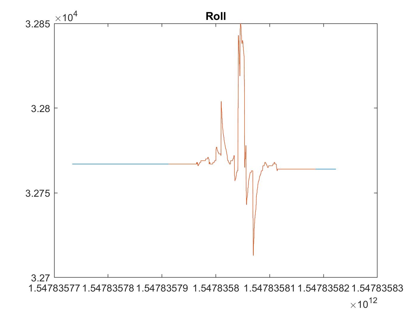

    But later I came up with some small issue. The DOF data logged from the server seems to have an offset at 32767, which is clearly the limit for 16-bits interger. The offset occurs with roll, pitch, heave, sway, and surge, except yaw.
    Would you please give me some idea on how to process with the DOF data? Thank you!
    Some pics for the DOF data:
  17. yobuddy
    51,736Coins
    +5,205 / 19 / -0
    Take a look at the Video Ride Creator buddy.
    You can open a video file with it and then import the data needed, and swap it around and all that good stuff.
    Scale it smooth it etc..
    It would be better if you could capture a even number of telemetry points per second, rather than time stamps.
    I mean it will be easier to sync in the end.
    (You can read just the center location too)
    Take care!

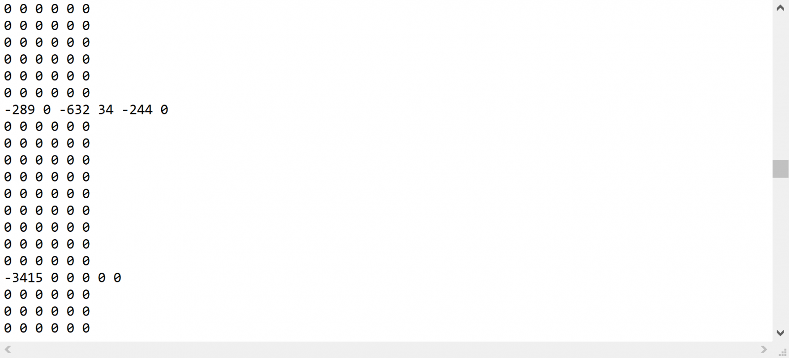

    I tried recording a video but it doesn't work with my game. I know that it's not a plugin or axis assignments issue. My simulator gives near perfect results with the AMC 1280 USB Interface. I get correct values in the tuning center as well.
    I modified the interface as shown:
    I only get 0's in my telemetry file though. What did I do wrong here?
    EDIT: I managed to fix it, it actually WAS that I forgot to switch to the (b) Axis Assignments tab. Also, is it intended that the max/min is not possible to edit for the video ride player? I guess that would explain why my values are so high numbers because they are being mapped between 32767 and -32767? Interesting. :) Anyway it all works now!!

    I could use some help making sense of the CFG file guys. :) I have the following interface:
    Output rate is 16ms. So that should mean one line per 16 miliseconds in the CFG file.. however for a 57 second video I have 1390 lines of telemetry in my CFG file. In 57 seconds there are 57000 miliseconds which means divided by 16, 3562 lines of telemetry. Why do I get 1390?
