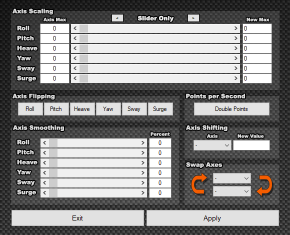

    Click on the Tools button and you can fix the range for input.
    (Scale it up or down as needed)
    Let me know how it goes!

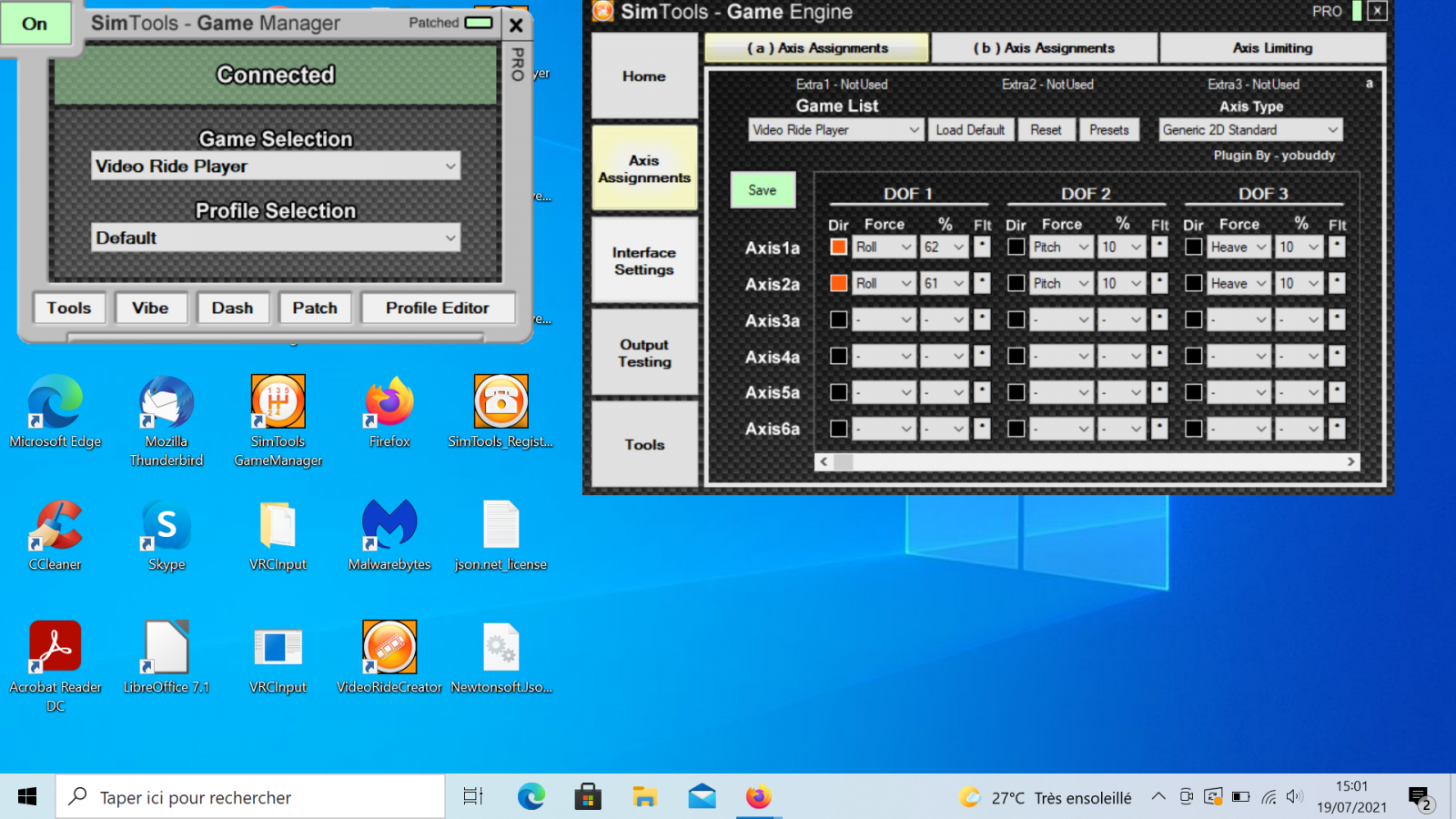

  10. accelero
    accelero Member
    Jun 30, 2015
    64
    france
    293Coins
    +12 / 0 / -0
    2DOF, AC motor, Arduino
    Hi, yes at the moment I am only working on Roll, ...... first trying to master easy stuff :)
    In game Engine DOF1 Axis1a is Roll 62% Dir is orange
    Axis2a is Roll 61% Dir is orange
    Oh guys I ' m lost trying to rewrite a data file with Video Creator and realizing the GUI is no more the same than in the examples
    thank a lot to you spending time to solve this kind of problems

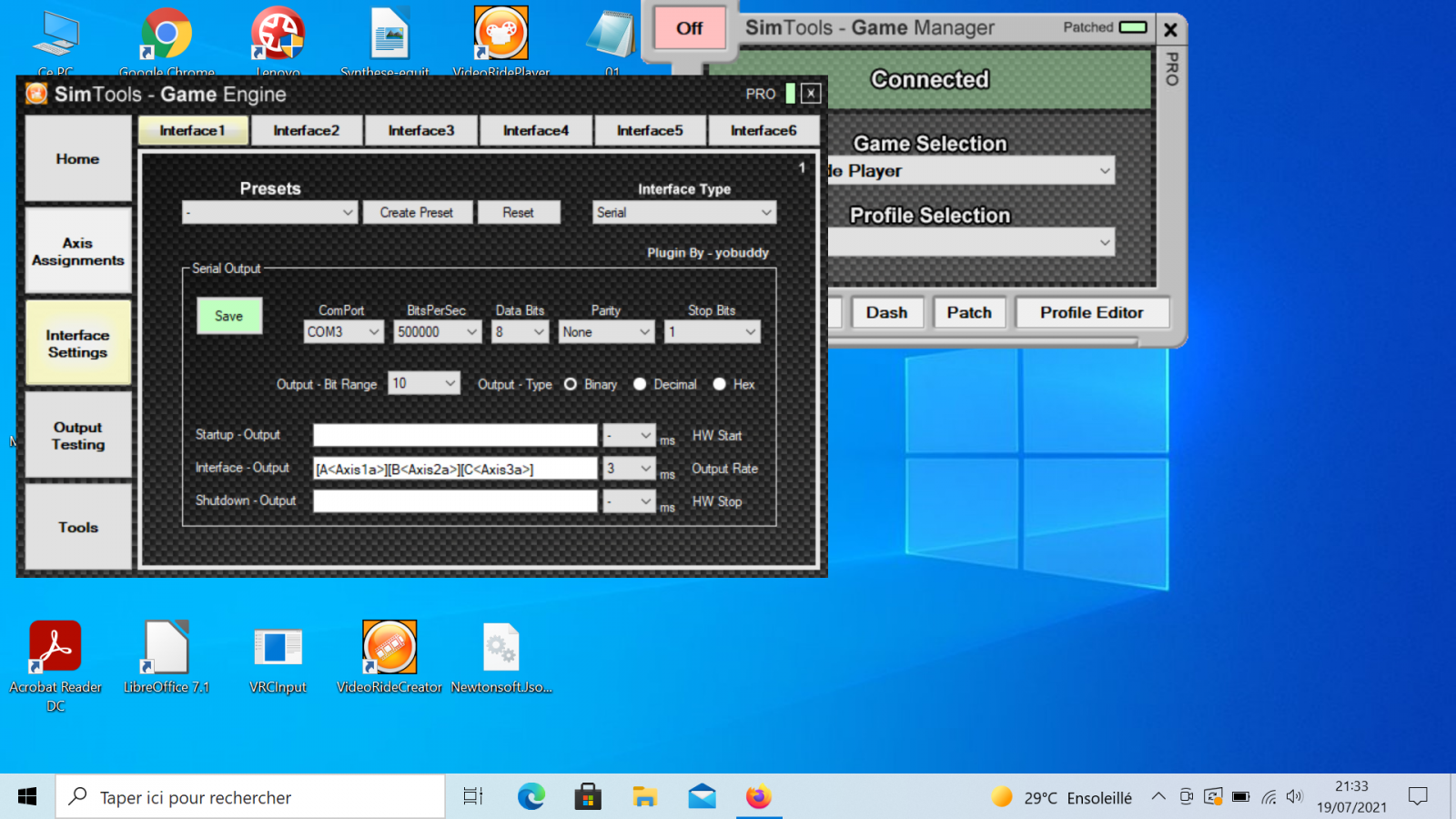

  12. yobuddy
    51,749Coins
    +5,205 / 19 / -0
    How we configure Roll or any of the DOF's will depend on the sim and where the motors are located on the sim.
    But we know roll is configured for output here, so let's move on.
    Next would bu to check you interface settings and be sure that <Axis1a> is being sent to the sim.
    May I have a pic of your interface assignments?
    And just to make sure, have you tested that output testing is working correctly?
    Have you seen you sim move at all when connected to the PC?
    thanks man, chat soon.
  13. accelero
    accelero Member
    Jun 30, 2015
    64
    france
    293Coins
    +12 / 0 / -0
    Yes I have seen the sim moving with Output Testing in this configuration
    I am asking myself if it's not a problem with the data format

  18. yobuddy
    51,749Coins
    +5,205 / 19 / -0
    First check that you have axis assignments settings for the VideoRidePlayer plugin.
    If you do, and it still not moving, open the video you made with the VideoRideCreator and it should load the corresponding telemetry file.
    Play the video and watch the telemetry dots go by and look for movement in telemetry.
    It may be that the data recorded is so tiny it looks empty, so you may need to scale the recorded data into range.
    Please let me know what you find.
  19. accelero
    accelero Member
    Jun 30, 2015
    64
    france
    293Coins
    +12 / 0 / -0
    Axis settings is labelled ' videoplayer' in the little window
    output testing is ok
    Telemetry data flow from -23000 to 23000
    still no movement ......can't figure out what's going wrong
  20. yobuddy
    51,749Coins
    +5,205 / 19 / -0
    Sorry buddy, but I don't know what "little window" means, could we have some screen shots?
    Please include Axis Assignments pic's for both the Default and the VideoRidePlayer please.
    And maybe a tuning center pic when running.
    chat soon,
