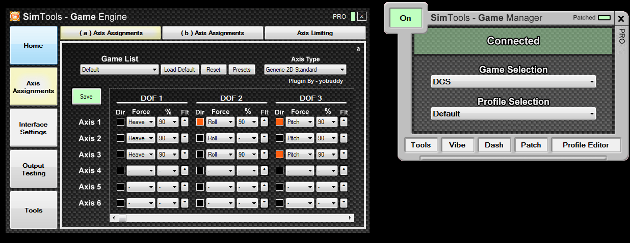

    The patch now is applied, but no hook the telemetry when i start the video ride software.
    Question? When i applied the patch, this no ask the place where is located, maybe this is the problem
    Regards.

    Are you playing a video file with a corresponding telemetry file?
  8. yobuddy
    51,751Coins
    +5,206 / 19 / -0
    You have to use the Video Ride Player to actually "ride" the film buddy.

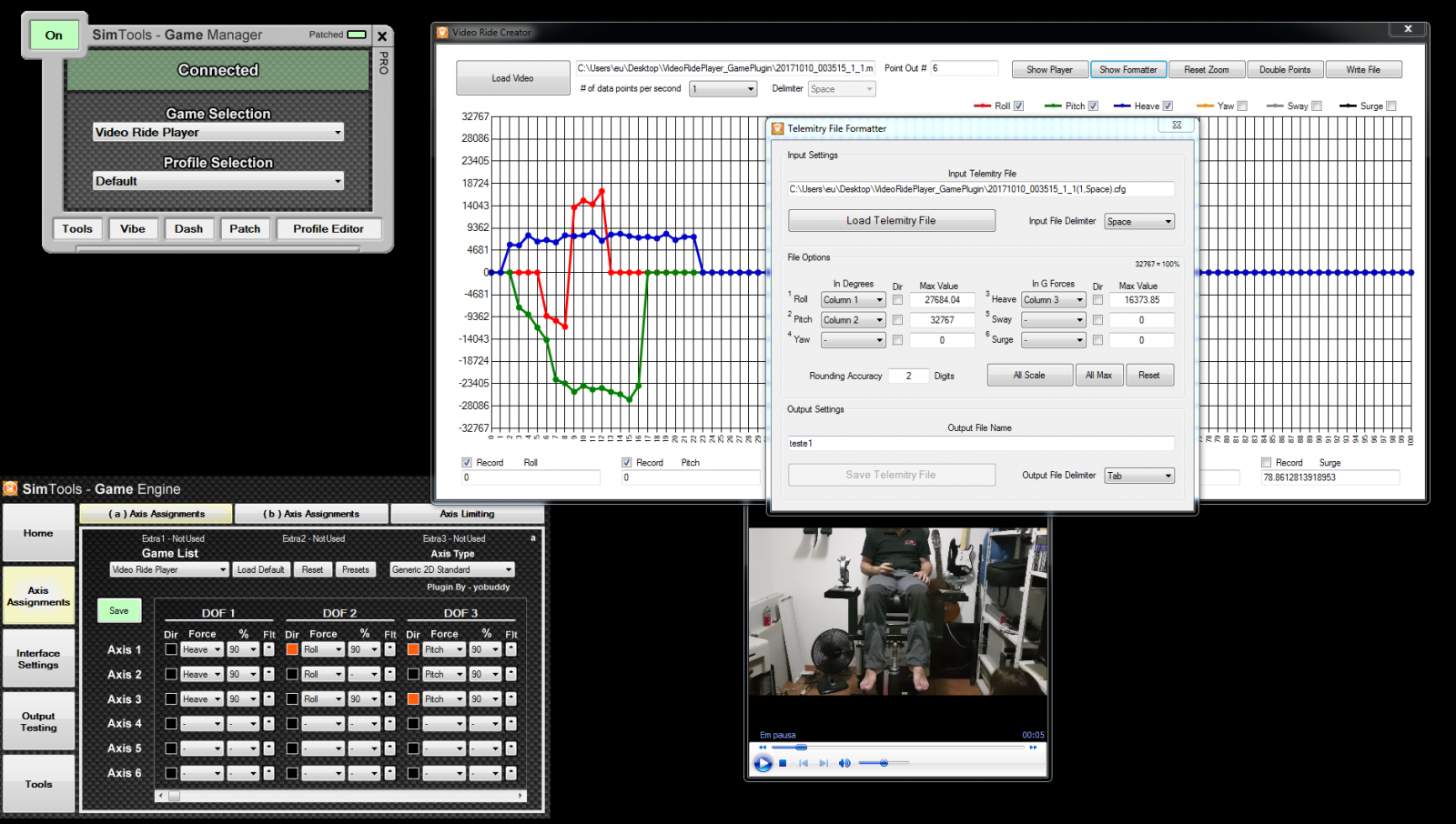

    Yeap. I`m running the players, but no motion.
    Even after apply the plug-in, i no have motion
    I have telemetry, but game engine dony hook the platform ;(

    you don't need to be using the telemetry file reformatter.
    Maybe that is messing it up?

    I'm having the same issue ...
    Same configuration, using the player, and a video with telemetry.
    I see there's a connection to the manager, but no telemetry is being sent. Latest plugin, latest SimTools, latest player.
  12. yobuddy
    51,751Coins
    +5,206 / 19 / -0
    What is the name of the video file?
    And what is the name of the telemetry file?
    The names should match like this.
    Video file name = "Snow Coaster.mpg"
    Then telemetry file should be "Snow Coaster.cfg"
    Do you have it like that?
