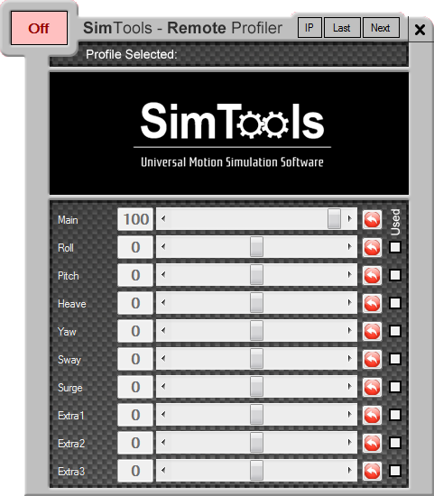

    This is just GREAT! I don't have to ALT+TAB anymore and I can use my tablet for on the fly tunings!

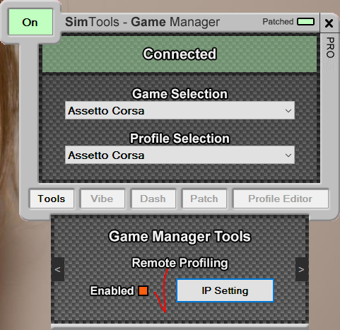

    I couldn't manage to make it work. I tried different PCs at home, all with Windows 10, all updated, .NET ok, firewall ok.
    The remote profiler never sees the Game Manager (not even on the same PC where GM is running - but this shouldn't be an issue, I don't know if it should work on the same PC)
  17. yobuddy
    5,402
    50,631Coins
    +5,159 / 19 / -0
    It should work find on the same PC.
    In fact you only need to setup IP addresses if its not on the same PC.
    Did you turn it on in Game Manger?
  18. Blame73
    Blame73 Well-Known Member
    Nov 6, 2014
    1,215
    8,303Coins
    +1,128 / 4 / -0
    Nope. I never noticed the arrows! I assumed it was on by default
    Thanks, I'm gonna try again
    Edit1: works on the same PC
