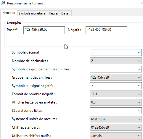

  11. riton
    riton Active Member
    Jul 6, 2007
    600
    1,006Coins
    +103 / 3 / -0
    Hello, I still have this problem, is there a solution?
    thank you :)

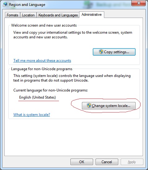

  12. yobuddy
    51,775Coins
    +5,206 / 19 / -0
    @riton,
    For now try this buddy,
  13. riton
    riton Active Member
    Jul 6, 2007
    600
    1,006Coins
    +103 / 3 / -0
    ok , I will test this solution , thanks . ;)
  14. vthinsel
    vthinsel Well-Known Member
    Feb 20, 2015
    439
    FRANCE
    6,059Coins
    +570 / 2 / -0
    Arduino, 4DOF
    It worked for me. It is because in France we do not use the same separator for csv Which is used by gamevibe
  15. yobuddy
    51,775Coins
    +5,206 / 19 / -0
    Not sure yet.
    I took the coma and period into account when I wrote it.
    And a test yesterday left it working with coma as the separator?
    So I'm just not sure yet.
  16. vthinsel
    Feb 20, 2015
    439
    FRANCE
    6,059Coins
    +570 / 2 / -0
    Arduino, 4DOF
    No problems here
    with that:
    "." as decimal separator and "," as list separator
    Hope it helps
  17. yobuddy
    51,775Coins
    +5,206 / 19 / -0
    @vthinsel,
    Is that a coma or a period in the pic?
    Did you try it with both options?
    Thanks buddy,

  19. vthinsel
    Feb 20, 2015
    439
    FRANCE
    6,059Coins
    +570 / 2 / -0
    Arduino, 4DOF
    coma as list separator, point as decimal separator
    before I had : coma as decimal separator and semi colum (;) as list separator and this generated popups.
  20. yobuddy
    51,775Coins
    +5,206 / 19 / -0
    Why would the semicolon cause problems I wonder?
