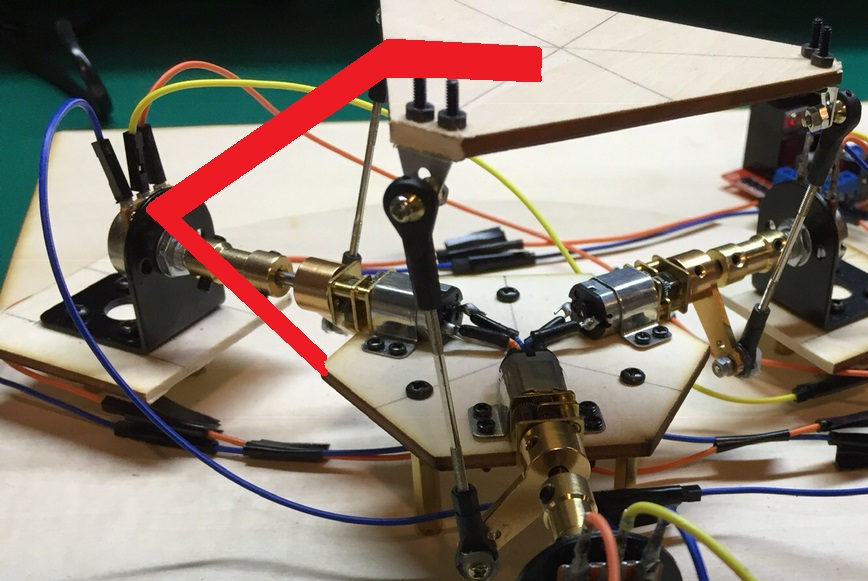

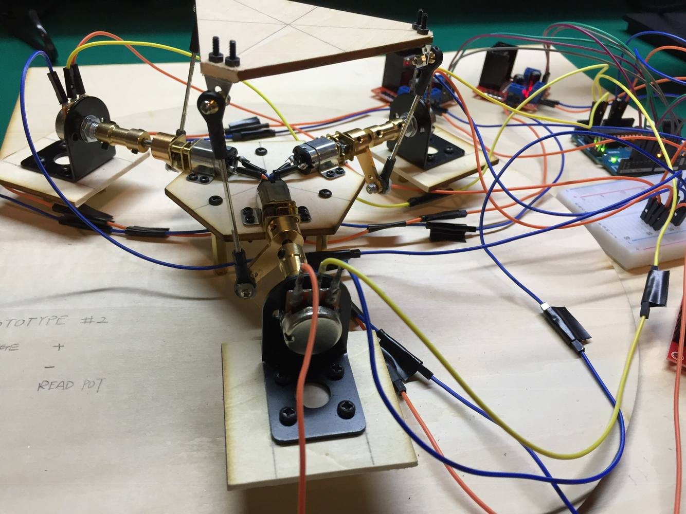

    I just started my model of 3DOF simulator, based on Arduino+L298N drive+ DC motor+Potentiometer. Now the model can work with SMC3 code and Simtools v2.o. The wire connection and communication is good. Great thanks to @RufusDufus and @yobuddy .

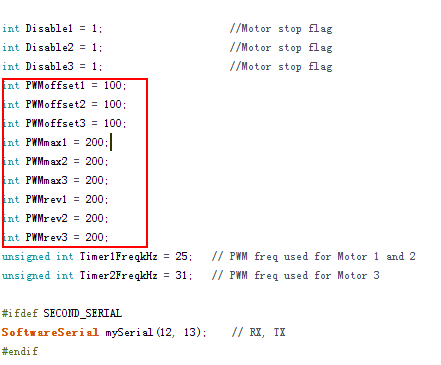

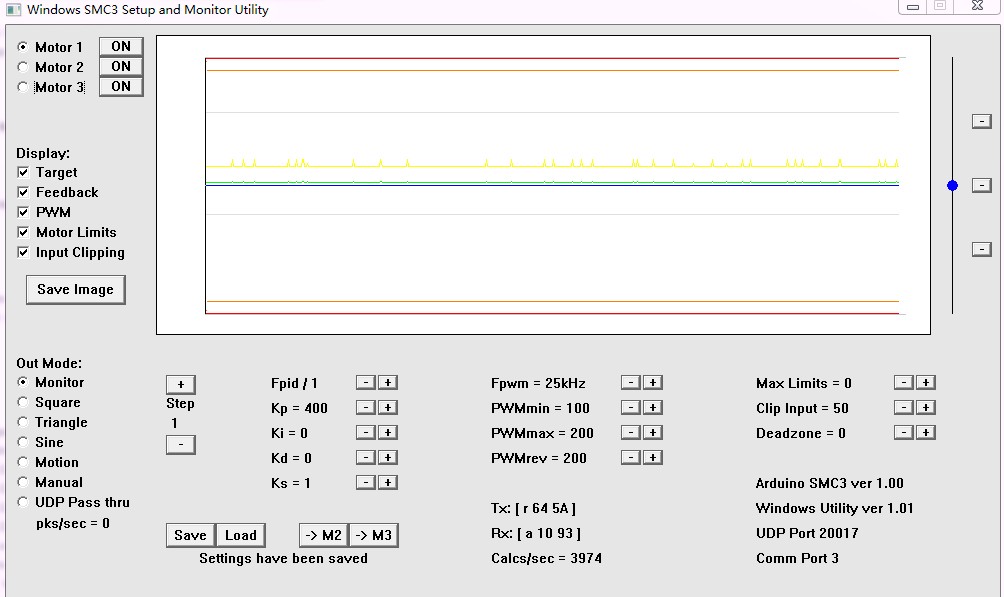

    In SMC3 code, the PWMmax and PWMmin is 200 and 100 separately. And when I test the motor by manual mode in SMC3 Windows Utility, the actual speed is correct. The motor moves fast. But when I run Axis Testing in Simtools, the motor is very slow. The max speed looks like about pwm 100+. Does Simtools reset the PWM value?
    SMC3 code

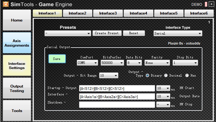

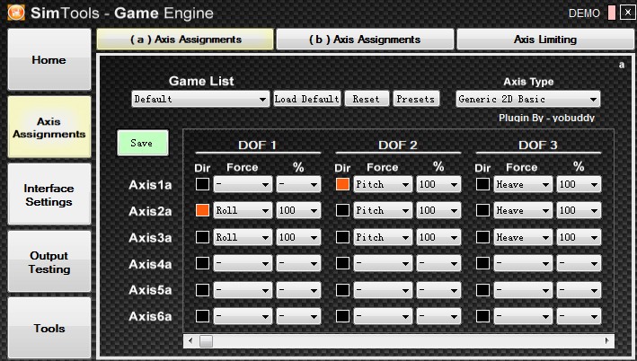

    At last, my settings in Simtools is below for reference.
    Interface Setting
    Axis Assignment

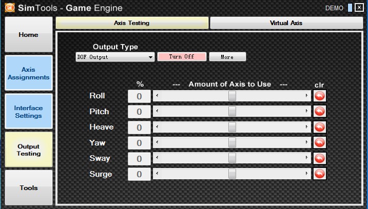

    Axis Testing

    Just so you are aware, in your Axis Assignments the actual full movement range is 100 total, and you are trying to allocate 300 total, something it can't physically do.

    What keeps the models top platform from twisting clockwise and collapsing?
    I think you need some sort of anti-twist setup for the model.
    Like even a cardboard hinge maybe.
    (drawing terrible but I could not find a pic of a real sim with a hinge setup)

    Hi @yobuddy , thanks for suggestion. Actually, I am also thinking about how to keep the model from twisting ~40 degree clockwise. I will try the hinge setup. Any thoughts about the questions above about the startup position and speed in SimTools Axis Testing?

    The startup position SimTools sends depends on your output bit settings.
    If you select 8 bit output, with 256 position possible (0 to 255), you can get the center location buy 256 / 2 - 1 = 127
    So for 10 bit 1024 position possible (0 to 1023) you would go 1024 / 2 - 1 = 511.
    SimTools will send a 511 for the center location for 10bit.

    Simtools has nothing to do with pot values.
    Simtool doesn't control the PWM value either. When you make changes with smc3 utilities they are saved to the arduinos eeprom including the PWM settings. So the default values at the top of the sketch are overwritten when the eeprom is read if you made changes. Btw, why PWMmin set to 100? That means when your motors start they run at 39% full power for minimum speed. If you need much you've got bigger problems.

    Hi noorbeast, thanks for reminding. Do you mean allocate 300 total such as pitch heave? Based on my understanding, the percentage of the force of the axis should depend on the value range of the potentiometer. Yes, the model physically can't do something. For example, when the motor turns to the lowest position (zero degree), the potentiometer reading isn't the minimum value. But if I adjust the percentage as 70% or 80%, both the highest position and the lowest, which the motor is able to get , will change. The motor avoids the physically impossible part, meanwhile it cannot reach the top (180 degree). It's a little dilemma for me.
    21,487
    150,542Coins
    +11,017 / 55 / -2
    I mean SimTools presumes an axis total movement is 100%, hence if you allocate more than one axis force it gets a partial allocation of the 100% that is available. So if you have pitch, roll and heave allocated to one axis, and you hit a huge embankment that triggers all 3 simultaneously, then the allocation for each should not really exceed 100% or clipping can result. In practice you can get away with a little over the 100% total, but not the 300% you have allocated.
    See here for tips on creating and refining a motion profile: https://www.xsimulator.net/community/faq/steps-to-create-a-motion-profile.228/

    Thanks for description, Yobuddy. My understanding is 100% same as yours. The startup position depends on output bit setting. I select 10 bit output, so the position range is 2^10=1024 (0-1023). The center should be 511. But it's weird when I turn on Axis Testing, all motors go lower position with potentiometer reading ~350... Even I set Startup-Output <512> in interface, the result is same...

    I think you should set these to 511.
    SMC3 code
    Please open your axis assignments and load the preset for XD Motion. (remember to click Save)
    It should work pretty well for that platform.
    Are you by any chance using any axis limiting?
    Chat soon,

    Got it, thanks, BlazinH. Yes, I have to set PWMmin 100. In the model, the friction force from the pot is too big for the gear motor (6V 30RPM). If the PWMmin is smaller, sometimes the motor is stalled in motion.

    Also for a simple test, in Output Testing (in GameEngine), select "(a) Axis Output" in the Output Type drop-down box.
    (This skips all the dof testing and allows for direct output to each axis)

    I'm afraid the Output Type drop-down box (Output Testing->Axis Testing) is in locked. There is only "DOF Output" in the box. I cannot see the selection you mentioned. :( My SimTools version is 2.3.1 demo.

    You have to turn it on first buddy, then you can select it.
