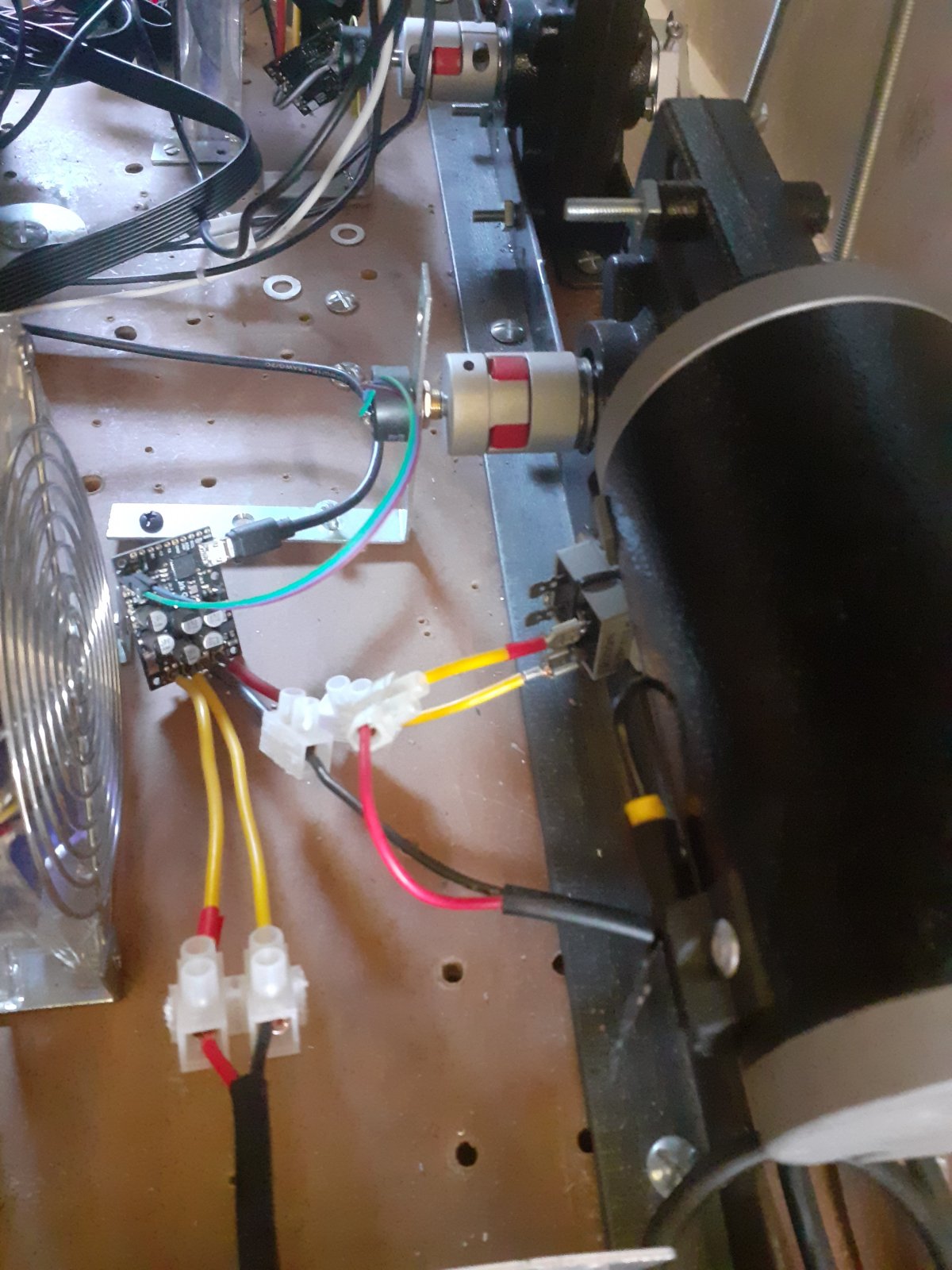

    Had my simulator working previously fine.
    Then I setup GPbikes to work, it worked great until I fell off the bike (on-screen)
    GPbikes sent my seat out of range and the motor arm jammed.
    By the time I cut the power, my JRK G2 had overloaded and failed.
    So I replace the one JRK G2 controller with new wires (the rest work fine)
    still using previous 180 deg Hall Pot and powerful motor / wormdrive as before.
    Same PSU working fine, as before
    I tried to put setting in JRK G2 as before (as best I can remember).
    Using the JRK setup utility to test... the new JRK G2 / motor moves fine, up / down under load
    all working fine - no errors reported, does not drop out.
    However, within the useful SimTools Engine Test utility,
    going slowly up / down in small jumps works, but big jumps or quick change,
    then Simtools crashes and I only get option to "Close"
    Withing Windows Event log,
    I get:
    Faulting application name: SimTools_GameEngine.exe, version: 0.2.4.0, time stamp: 0x5d118216
    Faulting module name: KERNELBASE.dll, version: 6.1.7601.24384, time stamp: 0x5c6e2226
    Exception code: 0xe0434352
    And:
    Application: SimTools_GameEngine.exe
    Framework Version: v4.0.30319
    Description: The process was terminated due to an unhandled exception.
    Exception Info: System.ComponentModel.Win32Exception
    at Pololu.WinusbHelper.WinUsbDevice.controlTransfer(WINUSB_SETUP_PACKET, Void*)
    at Pololu.WinusbHelper.WinUsbDevice.controlTransfer(WINUSB_SETUP_PACKET)
    at Pololu.Jrk.Jrk.setTarget(UInt16)
    Exception Info: System.Exception
    at JRK_Interface
    Simtools utility runs other motor & JRK G2 fine, no problem.
    No difference is settings between the two.
    Any ideas, of where to look at next ?

    I attach picture of my setup
