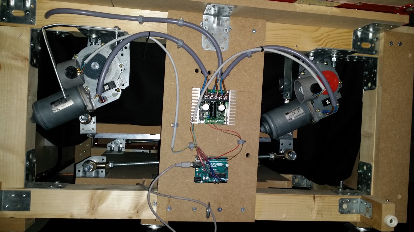

    Here is a photo of one of side of my simulat simulateur cote droit.jpg Here is a photo of one of side of my simulator, I use 2 arduino, one on each side it is can be the problem there, I saw that some use an arduino microcomputing...

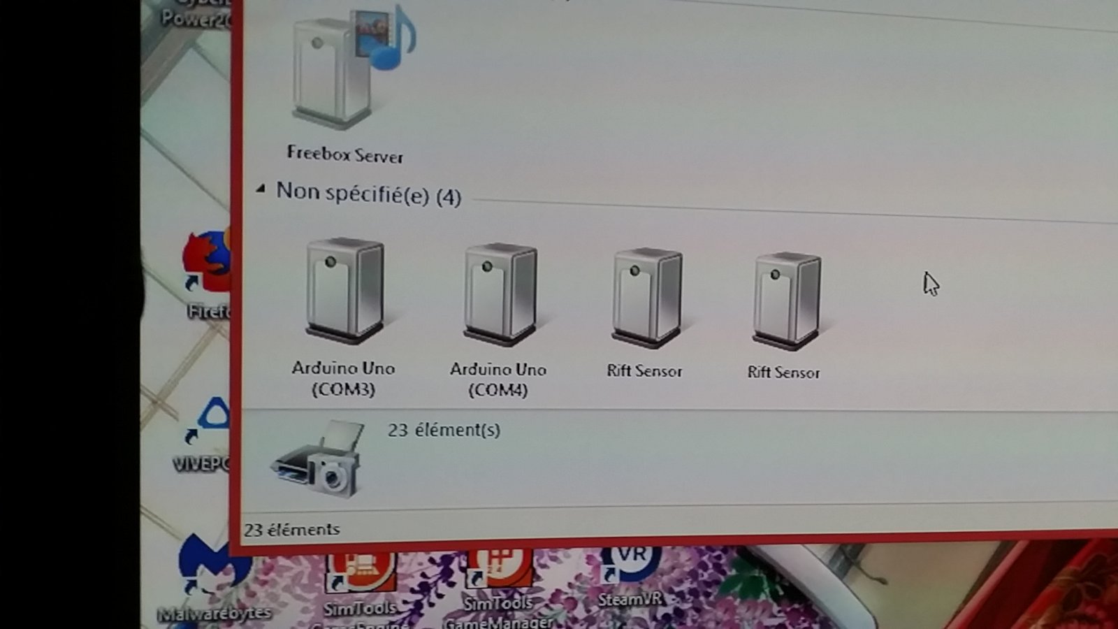

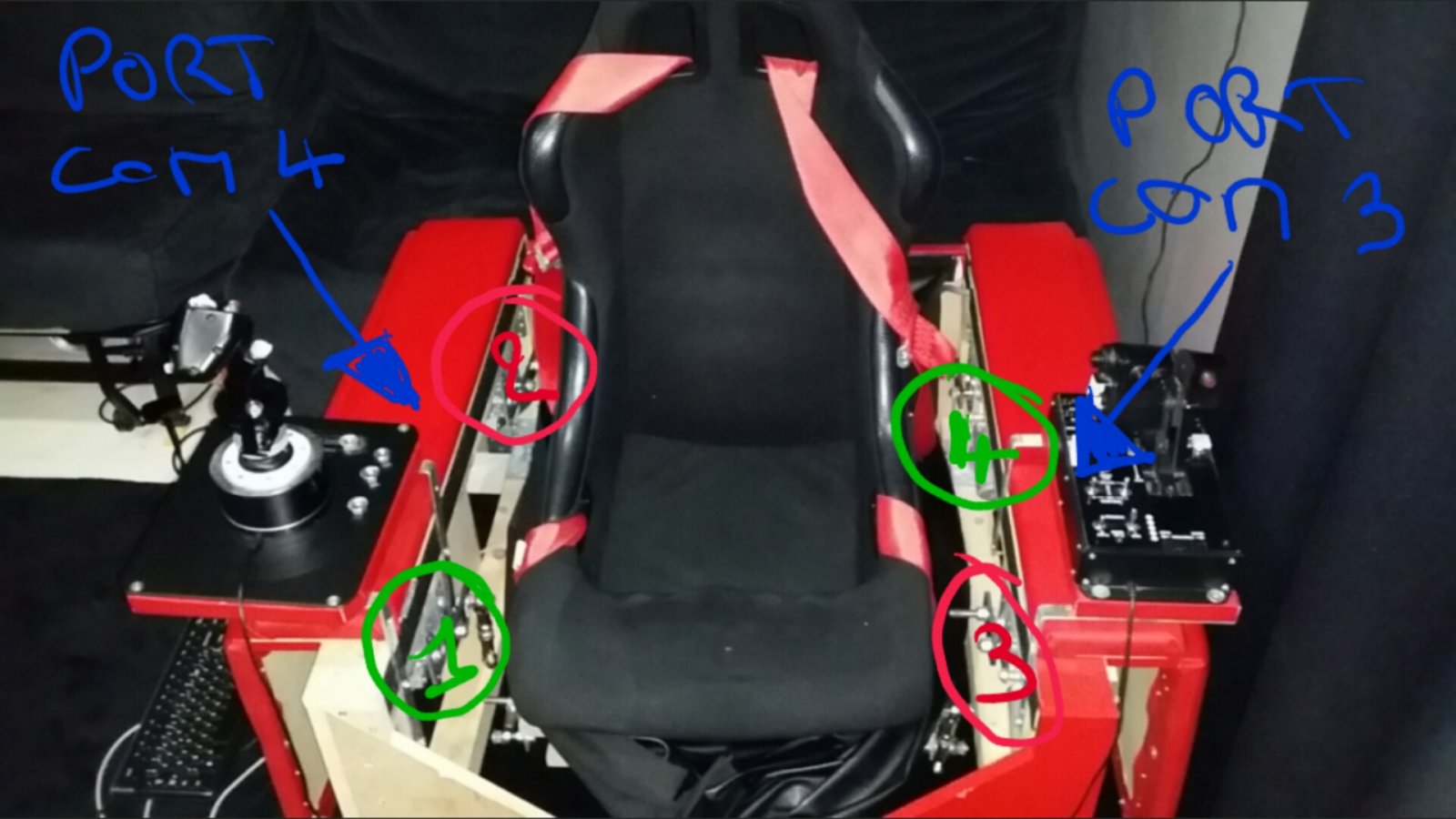

  6. STEPHANIE
    STEPHANIE Member
    Oct 19, 2016
    45
    HOYMILLE
    414Coins
    this picture of my simulator :
    1,2,3,4 = motor
    port com 4 =arduino 1
    port com 3= arduino 2
    MOTORS GREEN = PERFECT MOVE WITH SIMTOOLS 2
    MOTORS RED = Dont move whit SIMTOOLS 2

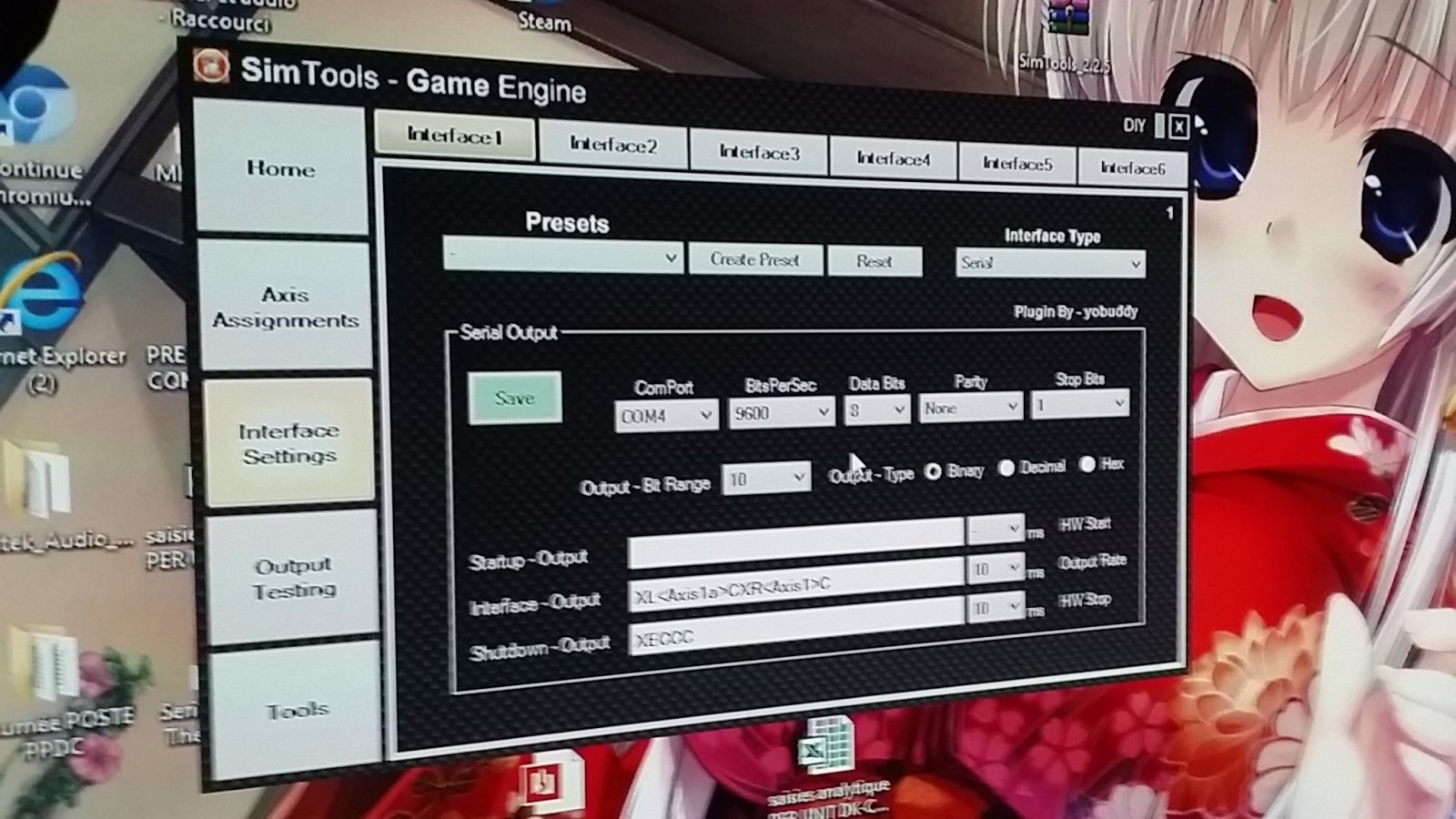

    With SIMTOOLS 1.3 everything worked perfectly.
    Nevertheless SIMTOOLS 2 re-knows 2 well cards(maps) arduino, but runs only the only one engines on 2?

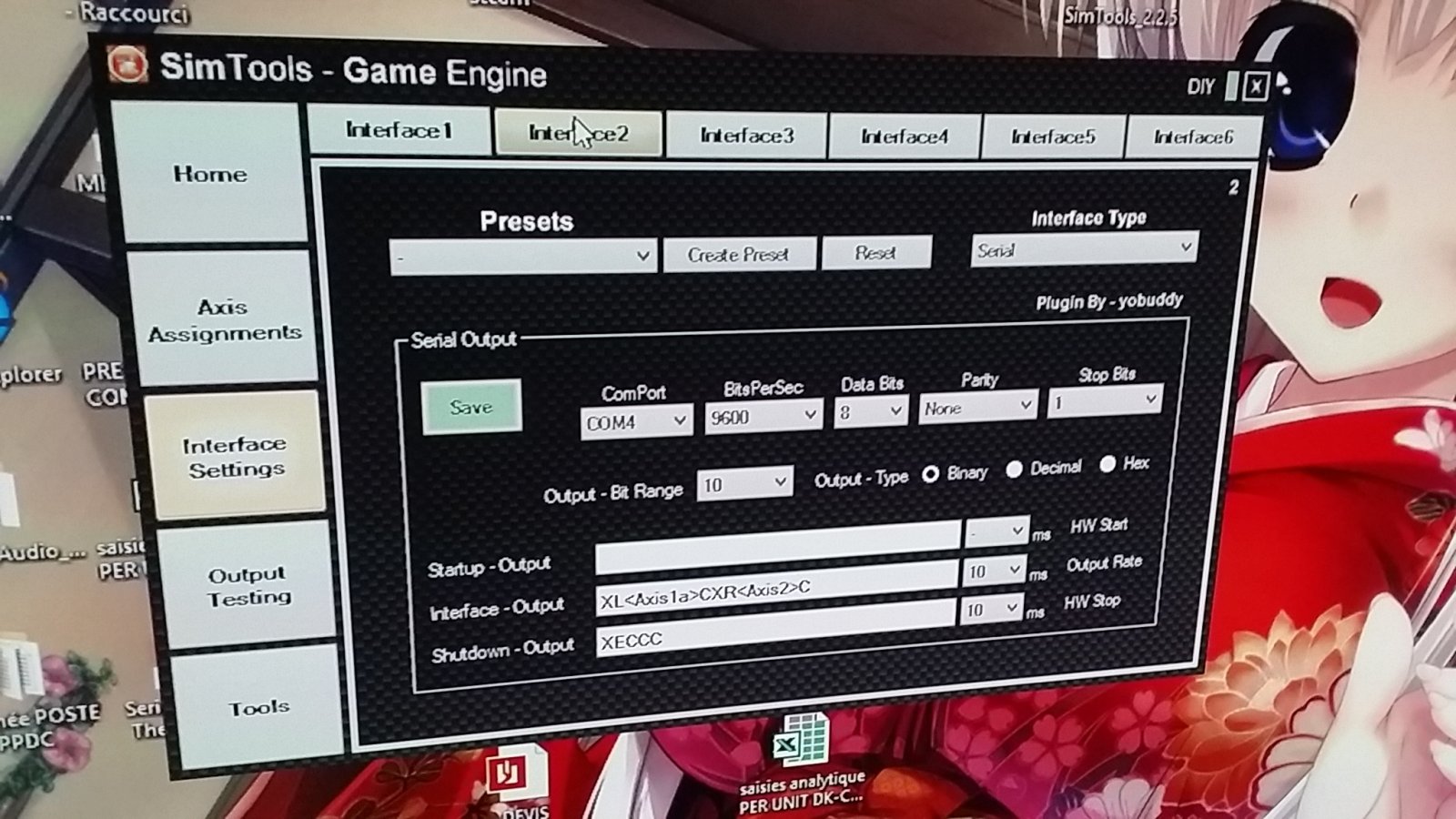

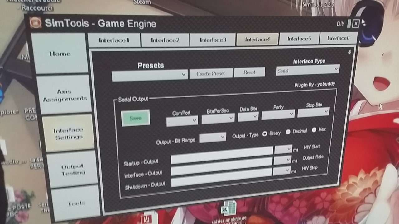

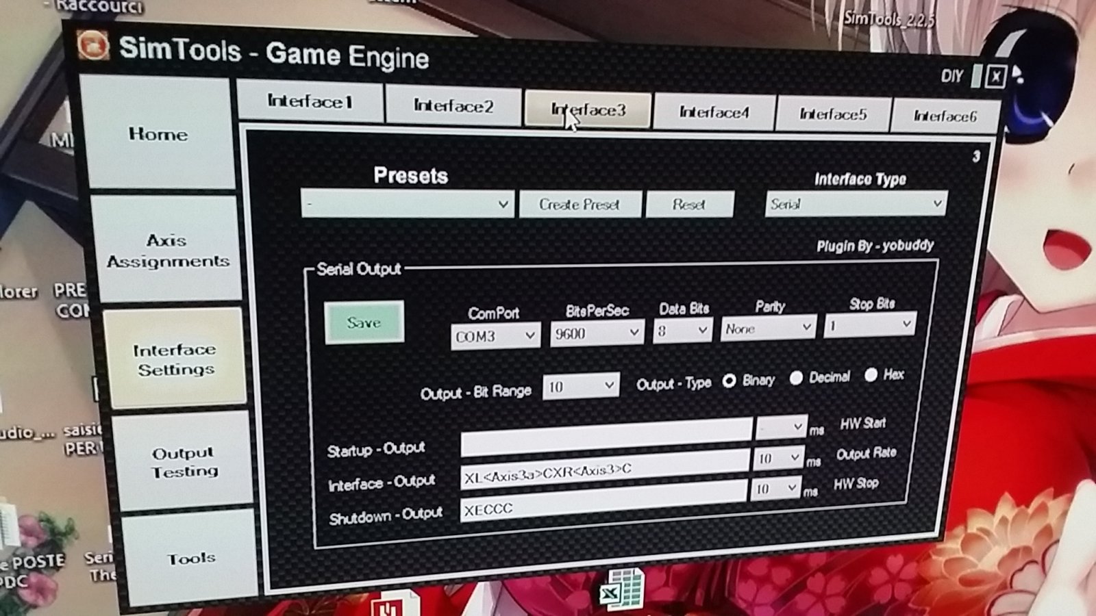

    21,526
    150,776Coins
    +11,021 / 55 / -2
    Are you using the SMC3 code or something else on the Arduinos and do all the motors respond properly on the hardware side.
    If so please post pictures of all of your SimTools settings.

  16. noorbeast
    21,526
    150,776Coins
    +11,021 / 55 / -2
    @STEPHANIE for SimTools 2 your Interface Settings should be like this: XL<Axis1a>CXR<Axis2a>C

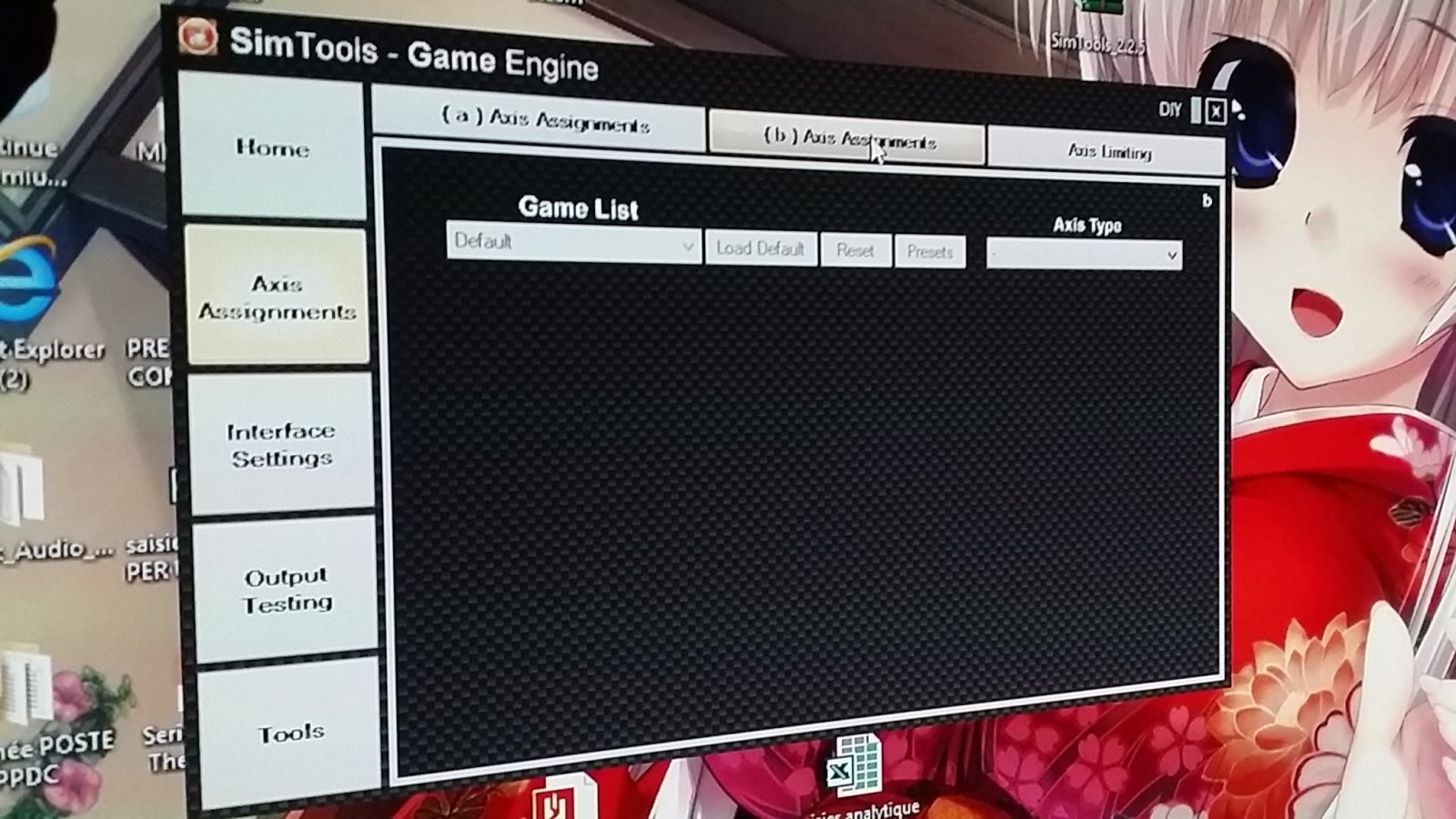

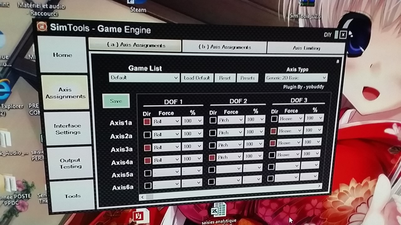

  19. STEPHANIE
    STEPHANIE Member
    Oct 19, 2016
    45
    HOYMILLE
    414Coins
    Incredible!!! THAT walks(works)!!! XL<Axis1a>CXR<Axis2a>C
    I thus filled(performed):
    Interface 1: XL<Axis1a>CXR<Axis2a>C
    Interface 2: XL<Axis2a>CXR<Axis2a>C
    Interface 3: XL<Axis3a>CXR<Axis2a>C
    Interface 4: XL<Axis4a>CXR<Axis2a>C
    You are the best !
    On the other hand I do not arrive has to change the sense(direction) of the engine 4 ( axis4a ) in axis assignements, I shot well "dir" but it does not walk(work)...
