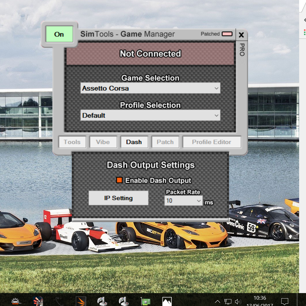

    At the moment they are doing so:
    1- I downloaded the AC plug-in and loaded it with simtools pluginupdater
    2-I started game manager as administrator and select Assetto corsa, open dash and click on enable dash output

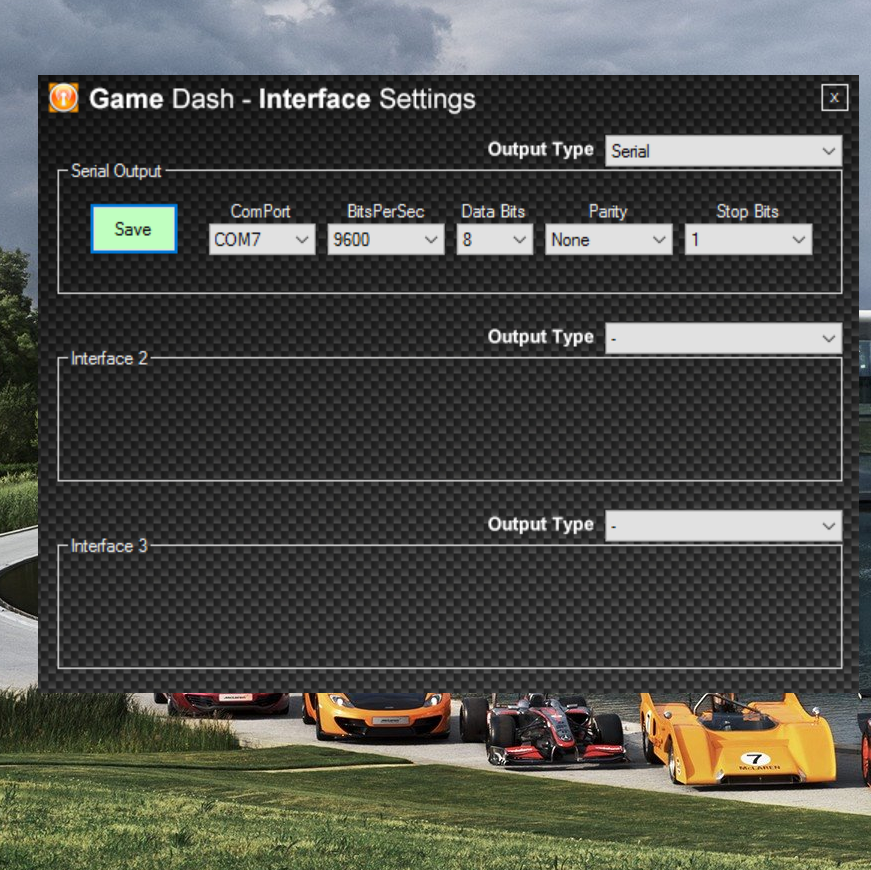

    3-open the gamedash 2.0 and his interface setting, on the first interface i have setting the serial output (comport of arduino ecc ecc) and click save

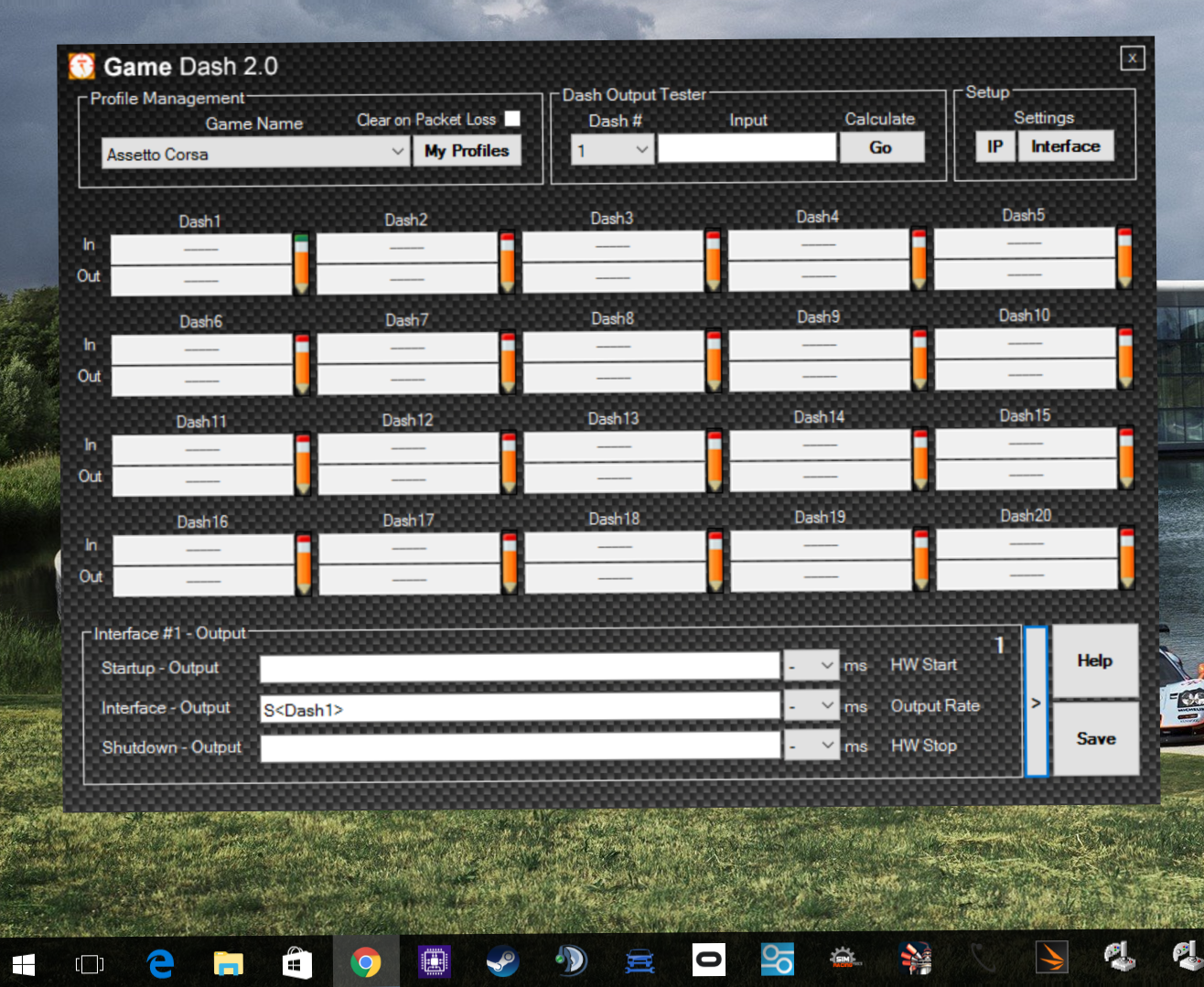

    Screenshot (6).png 4- open the gamedash,select the game and then in the Interface Output i have put "S<Dash1>" and click save

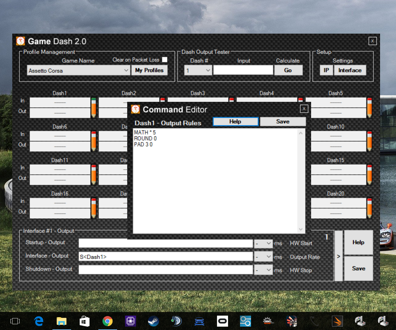

    5- next open the pencil to Dash1 and on the command editor i have write this sequence and check save:
    6-At this point I start steam and running Assetto Corsa but the game manager remains not connected, nothing is happening.
    Of course I'm forgetting something,but I do not know what else to do.

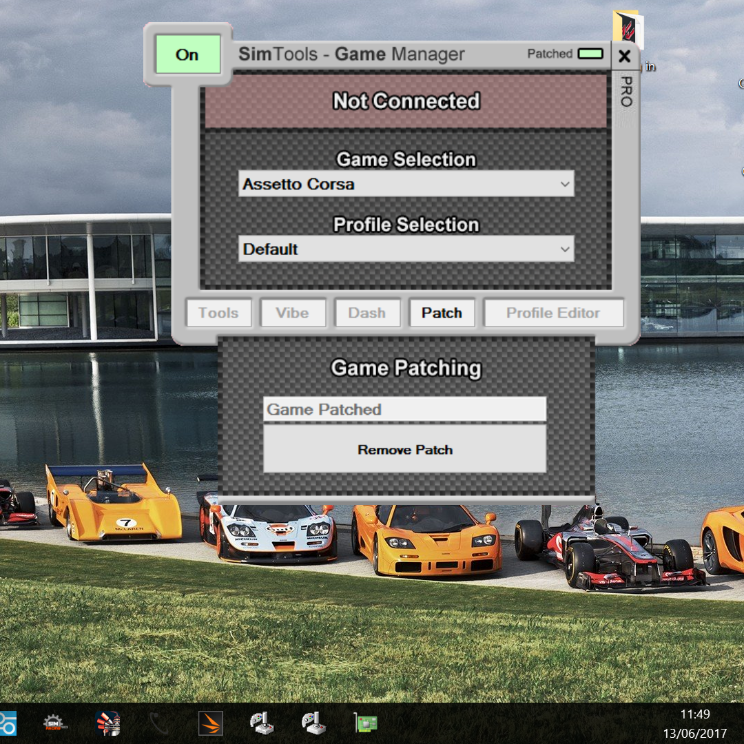

    Now, reading the manual, I've also tried the patching game, the game is patched but sim tools continues to be not connected when i'm in the game: Screenshot (10).png

    May be that I have to install game engine, even if I do not use motion with sim tools?

    Just came back, installed everything, including game-engine, moved arduino from usb 3.0 to usb 2.0 and everything seems to work at last. Thanks to everyone for the advice

    @IIISLIDEIII,
    Nice work finding the solution buddy, but yes, you still need all of the software installed somewhere.
    Weather it be a single or dual PC setup.
    You see, some game plugins collect Dash Data in different parts of the game plugin.
    Sometimes its collected on the Game Engine side of things, and sometimes its on the Game Mangers side.
    Either way, all the data gets collected and combined in Game Dash.
