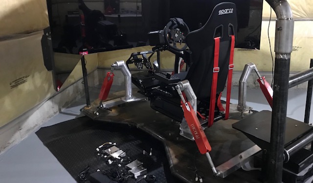

    Hello Everyone,
    I have a question regarding Simtool's homing command/direction.
    My understanding of Simtools is that it is programmed on startup to home the actuators and find the center point by fully extending and retracting the stroke which in my case is 200mm.
    My only issue is I have a setup where the sim has four actuators (one on each corner) with a center pivot point that are all fixed to the baseplate.
    My question, is there a way to reverse the direction of the homing command in Simtool. Having a fixed center pivot point, I need the front and rear actuators to home in opposite directions in order for them not to fight each other. The only way around this I found it to have the front actuators disconnected and swapped the fixed connection with feet that are free floating and set my homing timings of the rear and front actuators timing it so the fronts have clearance to home using TBVST 4.5. This is not a great solution and looking for an alternative option.
    Any help is appreciated, guys ... I am open to ideas and suggestions. I'm maybe missing a function in Simtools that I have overlooked that maybe a solution, but I am stuck at this point.
    Thank you
    JC Dionne
  2. Gadget999
    1,952
    11,941Coins
    +483 / 10 / -0
    Yes, you tick a box to reverse direction
  3. Gadget999
    1,952
    11,941Coins
    +483 / 10 / -0
    However it sounds like you have a 2dof with 4 actuators
    It can be done with only 2 actuators
    Do you have a picture
  4. JCDionne
    JCDionne Custom Sim build
    Jul 8, 2021
    GM
    Canada
    - 29Coins
    4DOF
    Thank you,
    I am assuming you are referring to the checkbox under the axis assignment screen. I understand that you can set up the axis/actuator to act in the correct direction by checking or not checking the (DIR) box in this setup screen. But does that direct carry over to the homing ? I don't think it does.
    And... you are correct, I am running pitch and roll with support of two extra actuators on the front end to help with the weight.. Thank you
  5. JCDionne
    Jul 8, 2021
    GM
    Canada
    - 29Coins
    4DOF
    see attached for layout
  6. SeatTime
    2,573
    28,320Coins
    simtools in your case may trigger a homing sequence of those actuators, but not manage it.
