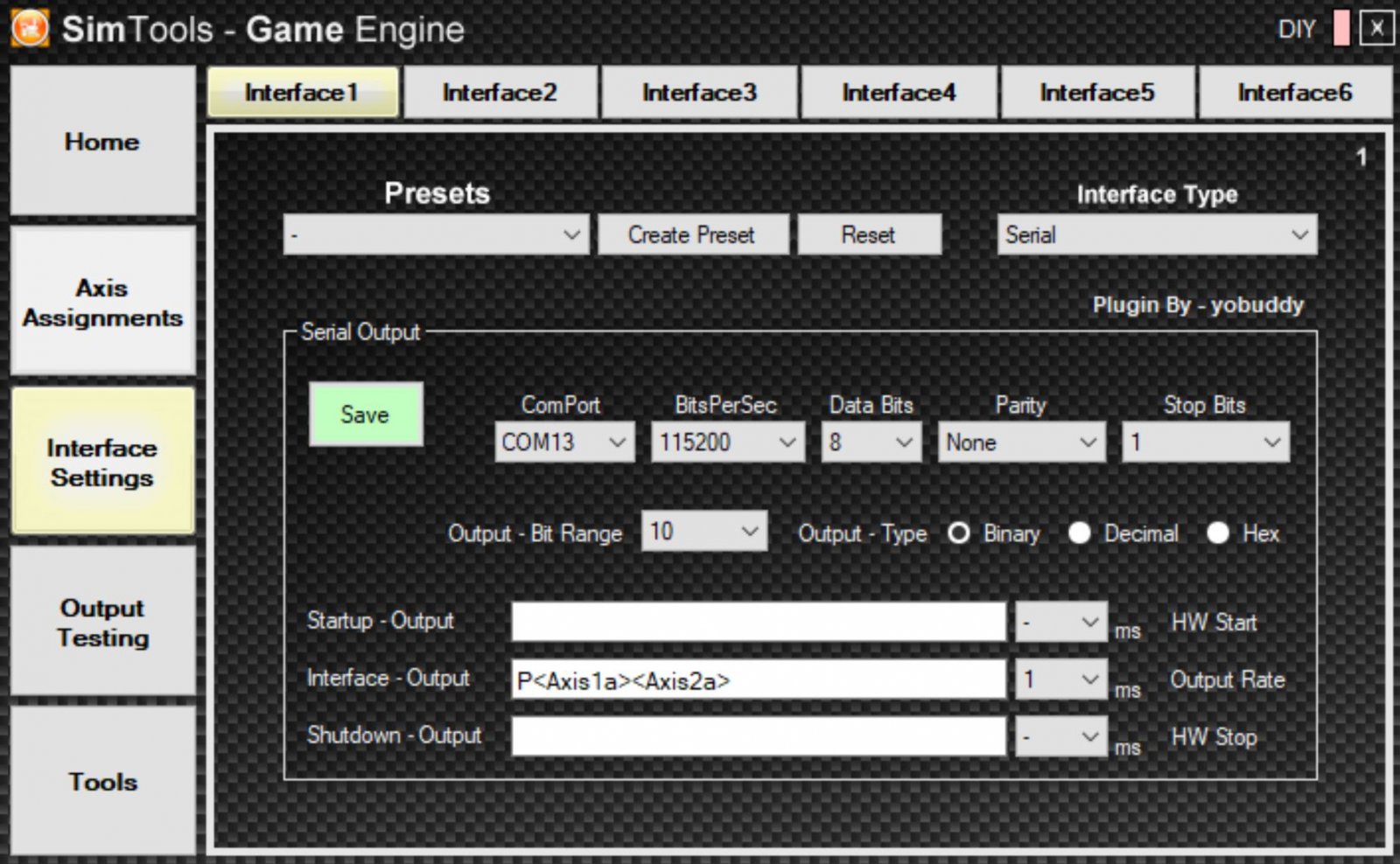

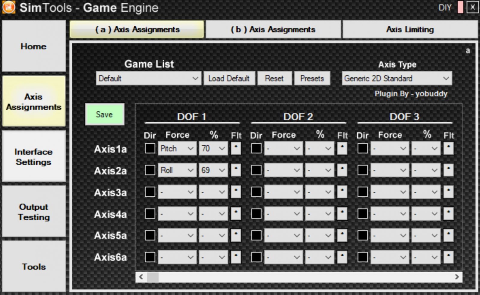

    Hi !
    I am rebuilding 2DOF my motion simulator. It uses an Arduino Uno, but it doesn't work. I am using the same code as last year, and the motor doesn't move. I use Simtools v2.41 (Simtools output : P<Axis1a><Axis2a>, Data bits : 10 bits, Parity : None, stop bits : 1)
    I am using two stepper motors. The code is the following :
    It works as follow :
    SimtoolsReader(); //Get the pitch and roll target from Simtools
    CommandWorker(); //Convert the position targets to pulse numbers (m1stepsToGo and m2stepsToGo
    moveMotor(m1stepsToGo,m2stepsToGo); (move the motors, at each step, we change m1Position and m2Position to keep trace of the position.)
    moveMotor works, the arduino board works (I have another code to manually control the motors), the motors works.
    I think the problem is between Simtools and Arduino...
    usually, it's 8 bits... are you sure of this setup?
  3. Lebois
    Dec 10, 2018
    353
    Math teacher
    2,566Coins
    +210 / 3 / -0
    data bits : 8
    Output range : 10
    I tried two different computers, and two arduino boards (Uno and Leonardo...)
